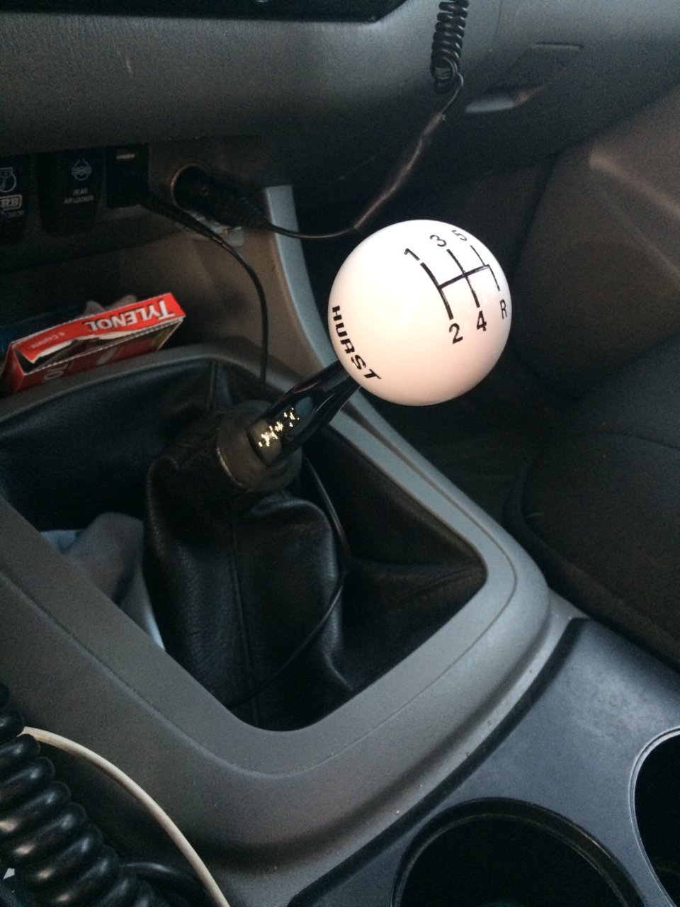

    Swapped my shift knob out for a white one tonight. Also the core shifter for the R156F came in as well. Theyve been sold out for a few months until just recently. Adding that to the 4wd conversion box of goodies

    How do you like that ball in your hand? I've got a wrx knob in mine and I think it fits the truck quite well.

    I like this one a lot. I have the TRD shift knob in my other truck and it feels too big. This one is a little smaller and feels just right

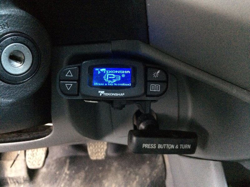

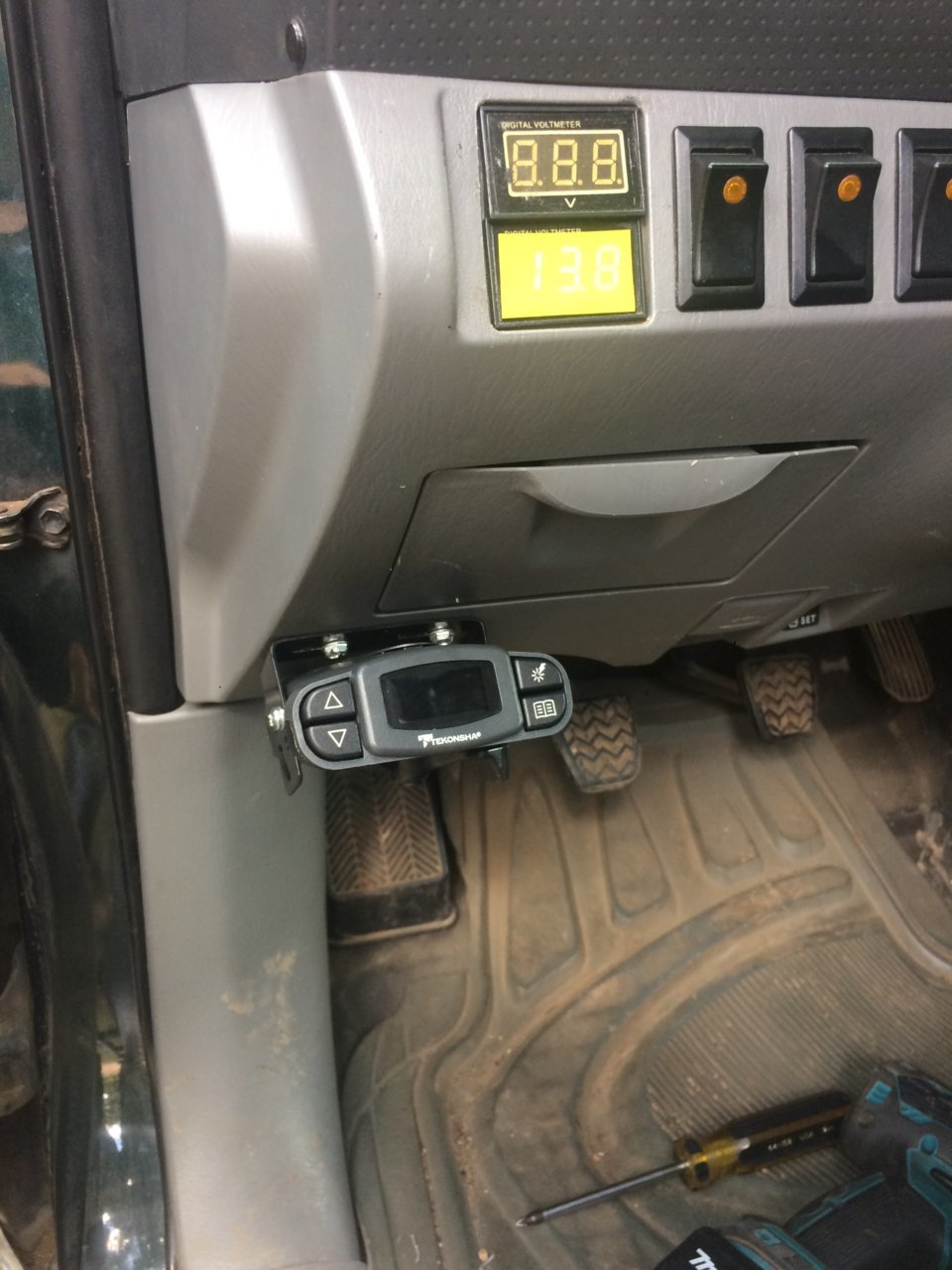

    Well i've gotten the itch lately to buy an old project car/roller that i can build from the ground up. So, I've been doing some research the past few days and i'm going to be adding the 7pin connector and build a harness to add a brake controller and make the 7 pin functional so i can find a car hauler first. I already have a Curt flat 4 harness in place, so i'm going to use one of these and build the remaining harness for the power, electric brakes, and brake signal inputs since my truck didnt come with the factory tow package. I opted for a Tekonsha p3 and the plan based on what i've found is to mount it here:

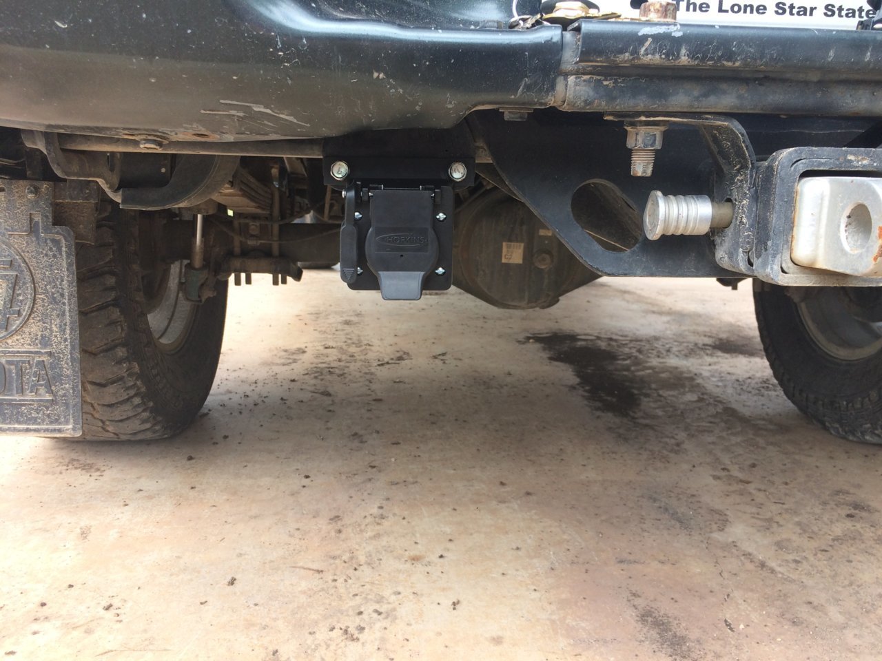

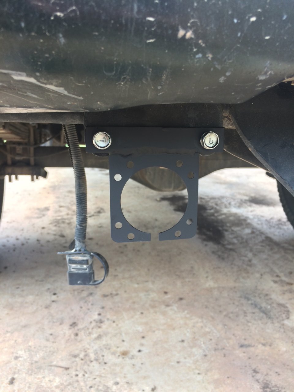

    Got the 7 pin connector mounted yesterday. The bracket they sent with it came with a 90* bend on it, so i cut that off and welded on a little piece of steel flat bar so i could mount it in the stock location.

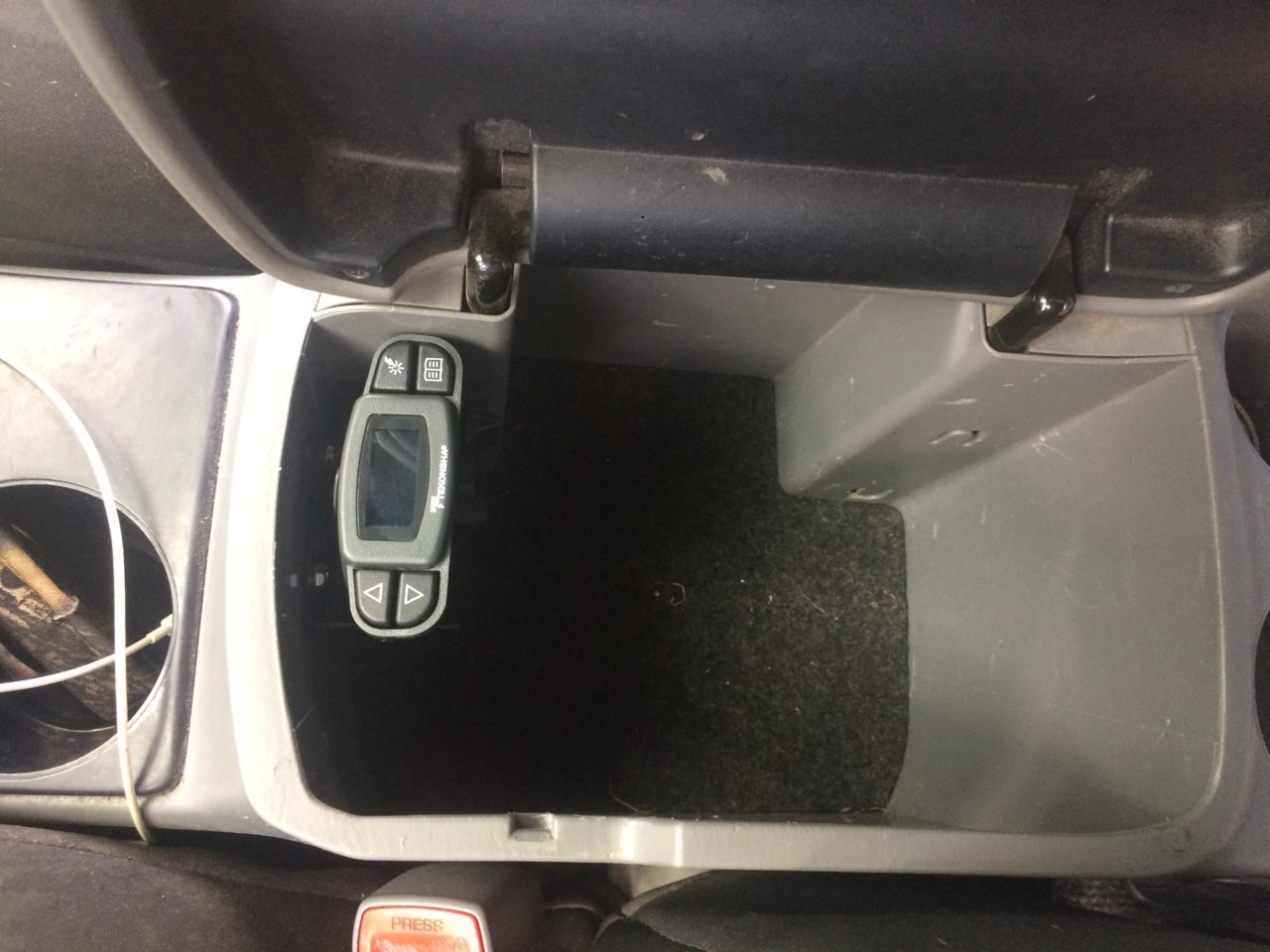

    Then got the brake controller mounted this morning. Went back and forth on where i wanted it but ultimately i didnt want to drill into the dash and couldnt figure out a decent looking bracket to mount it near the ebrake. So i ended up putting it in the center console since i have to build a harness for it already. Speaking of which that is next. I’m going to run three wires for the 12v+, electric brakes, aux 12v power from the plug to the cab. And then another smaller wire from where i have already tapped into the driver side tail light harness for the camper shell 3rd brake light. I am going to use this for the 12v cold side brake switch input to the controller so i dont have to cut anything under the dash
    Edit: went back and actually read the directions for the brake controller and had an oh shit moment lol. It has to be mounted horizontally so the sensor in it can work to determine how hard you’re braking so, i relocated it down below the coin tray. Not really thrilled with how it looks here but it will have to do

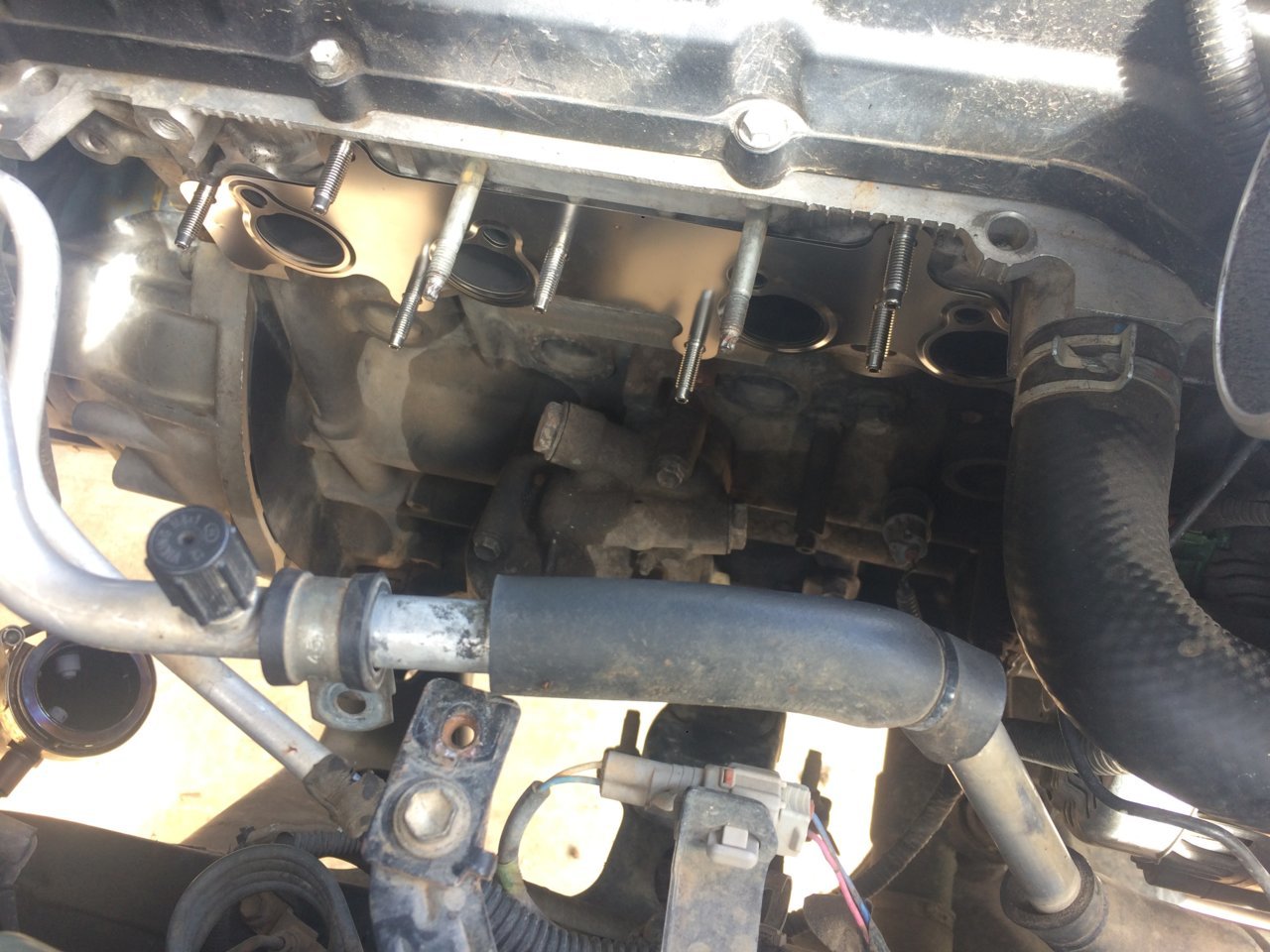

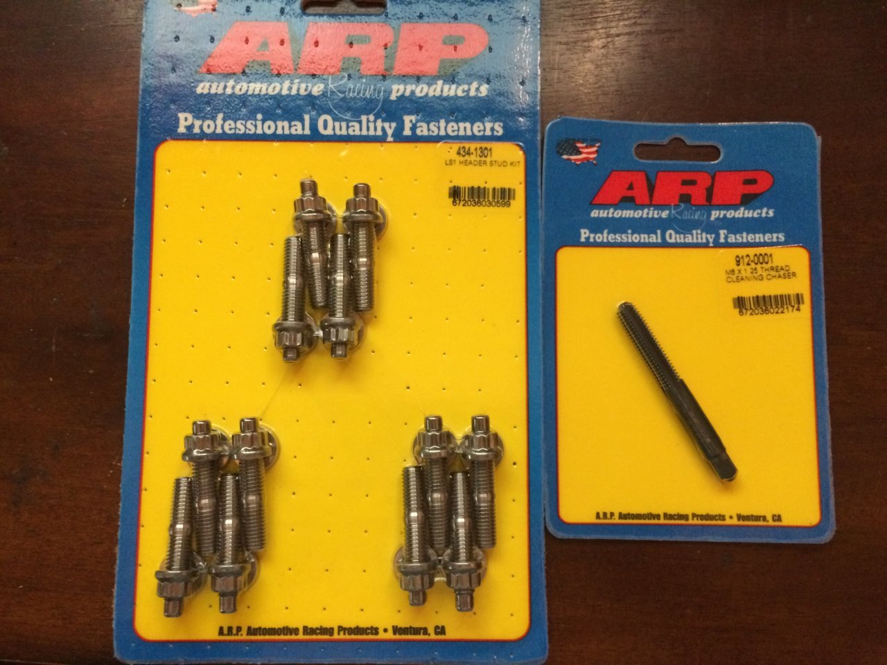

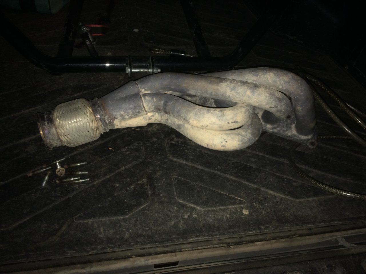

    Got the header off tonight and to my surprise, i was able to easily remove all of the header studs. I guess having all of them out 5k miles ago when the head was resurfaced made a big difference. I was expecting them to put up a fight. Ill chase the threads and install the new studs tomorrow morning if all goes as planned

    That's lucky... I'm not looking forwards to mine :bananadead:

    I think mine came out pretty easily last time too, but i hit them with pb blaster and let them sit overnight before trying to break them loose. Hopefully yours dont give you much trouble

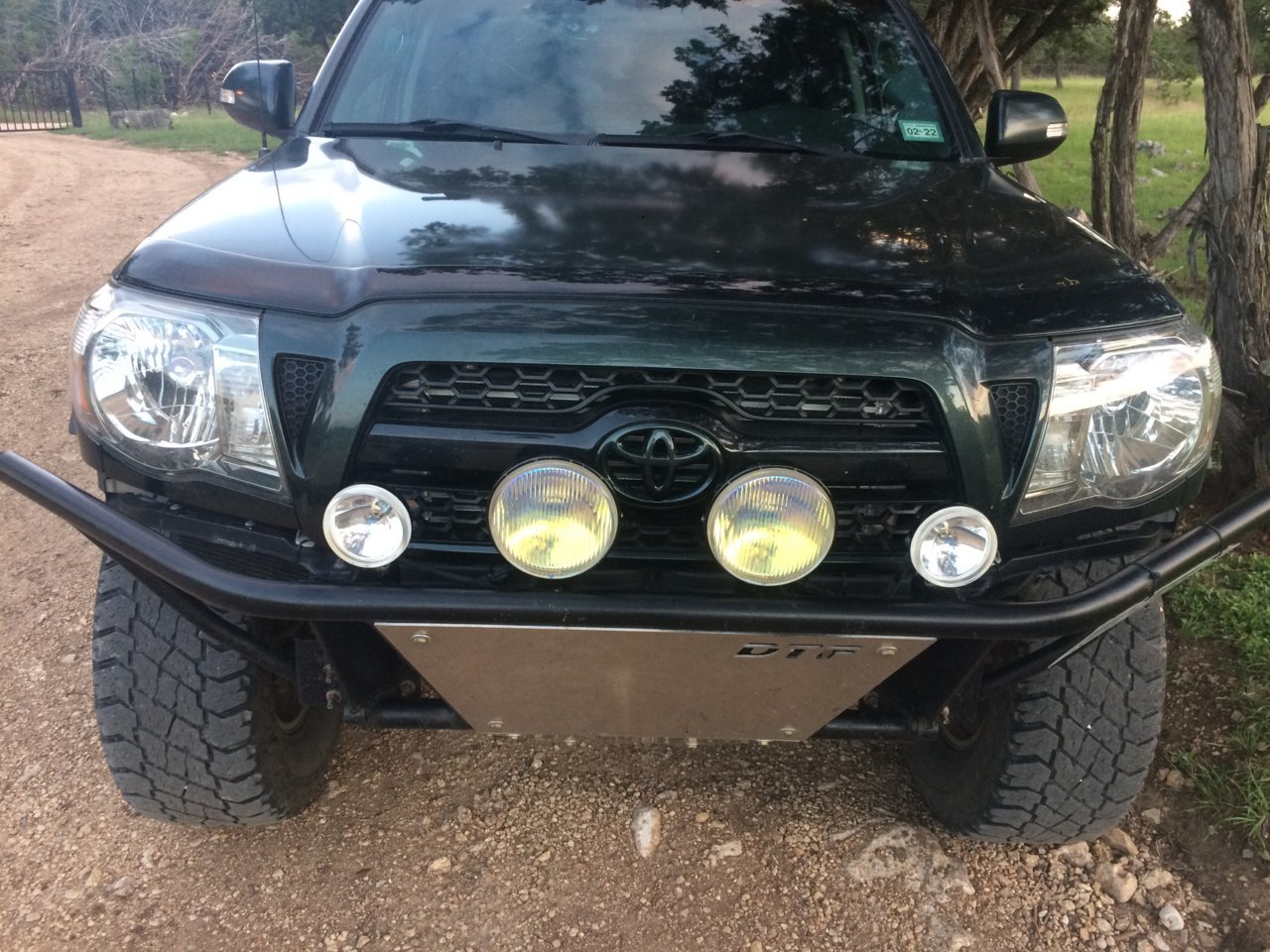

    Reinstalled my honeycomb grille and color matched the emblem

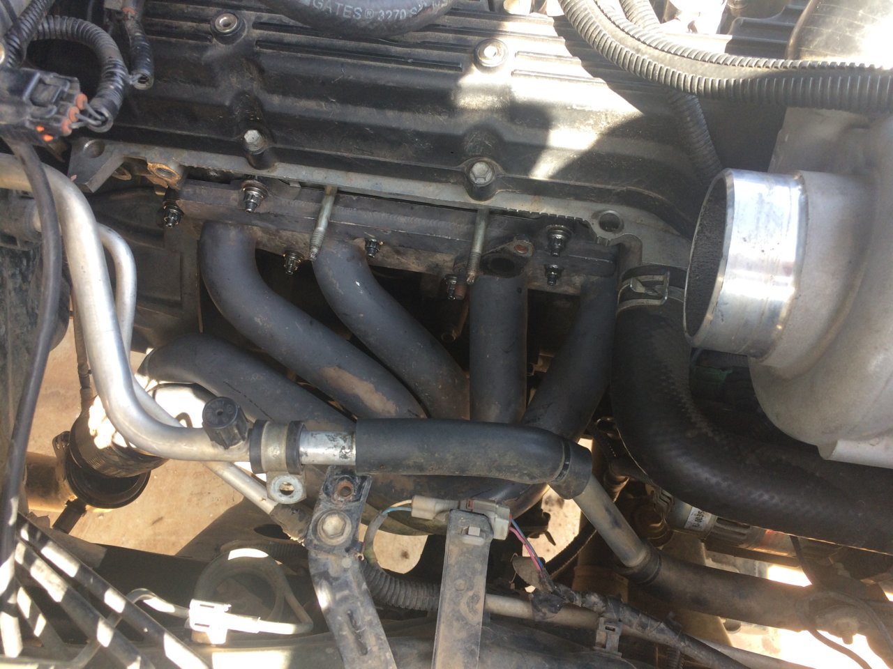

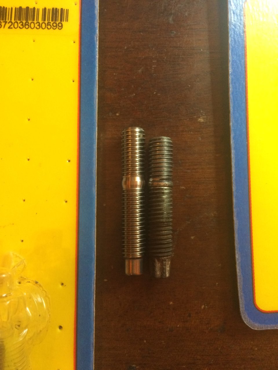

    Then moved on and chased the holes and installed the LS1 ARP header studs. They were a little longer than the stock ones but i decided to roll the dice and see what happens. It does appear that they bottom out before being stopped by the lip on the studs in the middle, but i didnt figure it would be an issue since they dont require much torque. Also went ahead and replaced the exhaust manifold gasket while i was in there as well
