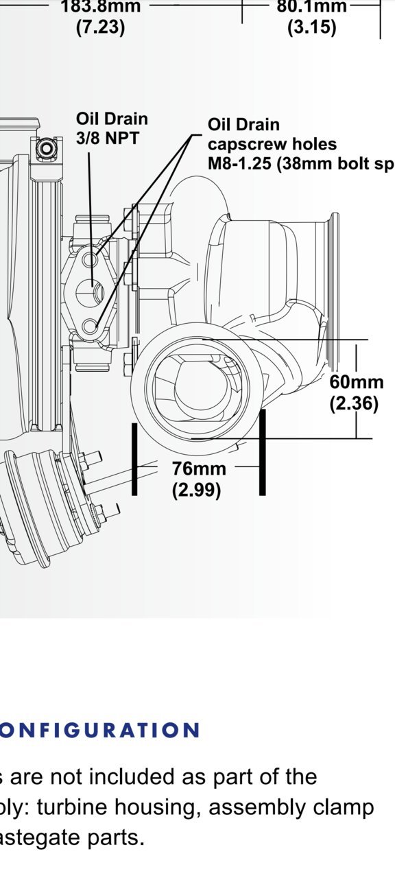

    I was doing some reading on this, and i was wondering if an external wastegate would be better for more/easier adjustability? It looks like the internal wastegate is easier with packaging and not needing additional piping but there are trade offs. Is there one or the other you'd recommend based on your past experiences? I am not really sure which way to go
    I think i am going to continue to use my HKS BOV for now and just redo the piping on the hot side if that would work. Do you see any issue with this? i see where you mentioned the BW EFRs have an integrated BOV. If i was to go this route, would i just cap off my current one and use that?
    I appreciate the offer buddy, i might take you up on this, but i am going to have to do some more research. Which one did you end up going with for your build? I am leaning towards just breaking down and buying a good one that has some room to grow for when i eventually build the motor down the road.
    Howdy John :cheers:
    i did some more looking into this today and i have been eyeing the BW EFR 7163 with a .85 A/R. Does that seem too big for what i want to do? I still dont fully understand what would be best, i just know the bigger the A/R the slower the spool but it has more top end potential. The G25-550 i was considering was a .72 A/R but i'm not sure how much of a difference that would make.
    That is a good point on the outlet size of the G25-550. So if i went that route i'd need to go with some type of reducer to run from the 3.5" to 3" exhaust that i plan on doing. Both of the turbos above use a 3" v-band inlet i believe in the configuration discussed. Question on that.. Is there a big performance loss running a v-band inlet vs doing a t3 or something that you could use for a twin scroll setup? Sorry for all the questions lol. I am trying to learn as much as i can here and this is all very new to me
    Specs/measurements:
    EFR 7163-F(v).pdf (bwauto.com)
    G25-550_G25-660_flange-diagram.pdf (garrettmotion.com)
    G-Series G25-550 The Most Powerful Small Frame Turbocharger - Garrett (garrettmotion.com)

    Torspd Custom Turbo kit [] Borg Warner 9180EFR Turbo [] Haltech Elite 2500 [] TiAL Q BOV [] TiAL V44 Wastegate @ 15psi [] CP Pistons [] CP Carrillo Rods [] ARP Head studs [] ARP Main Studs [] ARP Header - Head Studs [] Ported Heads w/ 1mm oversized valves intake/exhaust [] Brian Crower Forged Stroker Crank [] Darton M.I.D. Sleeved Block [] Kelford Camshafts [] Torspd 160* T-stat mod [] APR Large Fuel Rail [] Walbro 460 LPH E85 Fuel Pump [] FueLab FPR [] APR T56 Conversion Kit [] KP RACING Built T56 [] McLeod Racing Custom Twin Disk Clutch [] One Piece Aluminum Driveshaft [] MGW Shifter [] Custom lowering kit [] Ohlins Front Coilovers [] QA1rear shocks [] Custom Ron Davis Radiator [] Dual SPAL Electric Fans []
    I think the 7163 will be a perfect fit. However. The turbine inlet size is just under 2.5".
    Highly responsive, and less changes to get the exhaust to work.
    Just make sure you order the inlet and outlet flanges and clamps to go with it.
    I don't see you pushing 45 psi, but internal or external in this case comes down to packaging. Should it fit in your desired location with the internal wastegate mounting?
    You also have the choice to go with the hinged Turbosmart IG wastegate. If you wanted more control.
    Internal, has the benefit of the exhaust sounding much much cleaner, for an on road setup. Plus less exhaust work.
