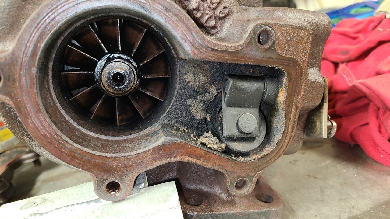

    That was what was originally on the Prerunner build that I just finished. Might have been an "x" instead of a W. Spooled very quickly on that V6.
    However, that particular diesel turbo's wastegate outlet had a problem. 1: that cover for the wastegate, which also integrated the turbine outlet, was too close to the wastegate outlet cap of flap( whatever it is called, and seen below)
    That flap could not open near enough because it would hit the cover. There fore, becoming a restriction, and actually aiding in allowing the turbo to spool, even without a wastegate actuator attached.
    2: the w/g exhaust port, was very small. Much too small. Too small to allow a lot of blow by for a low boost setup. Especially considering that the turbo came with a 45 psi w/g spring, and the intended engine was a ~3k max rpm engine. It didn't need much blow by.
    3: it was made for roughly 500 hp.
    4: its turbine a/r was probably around a .68.
    All of those things combined, created a perfect storm for an engine not ready.
    My only point to that is, we could not properly control that turbo on the gas engine. Very likely we could have with a different turbine housing.
    So @BananaMan , make sure your turbine housing doesn't do what I encountered. Or you'll very likely have problems.

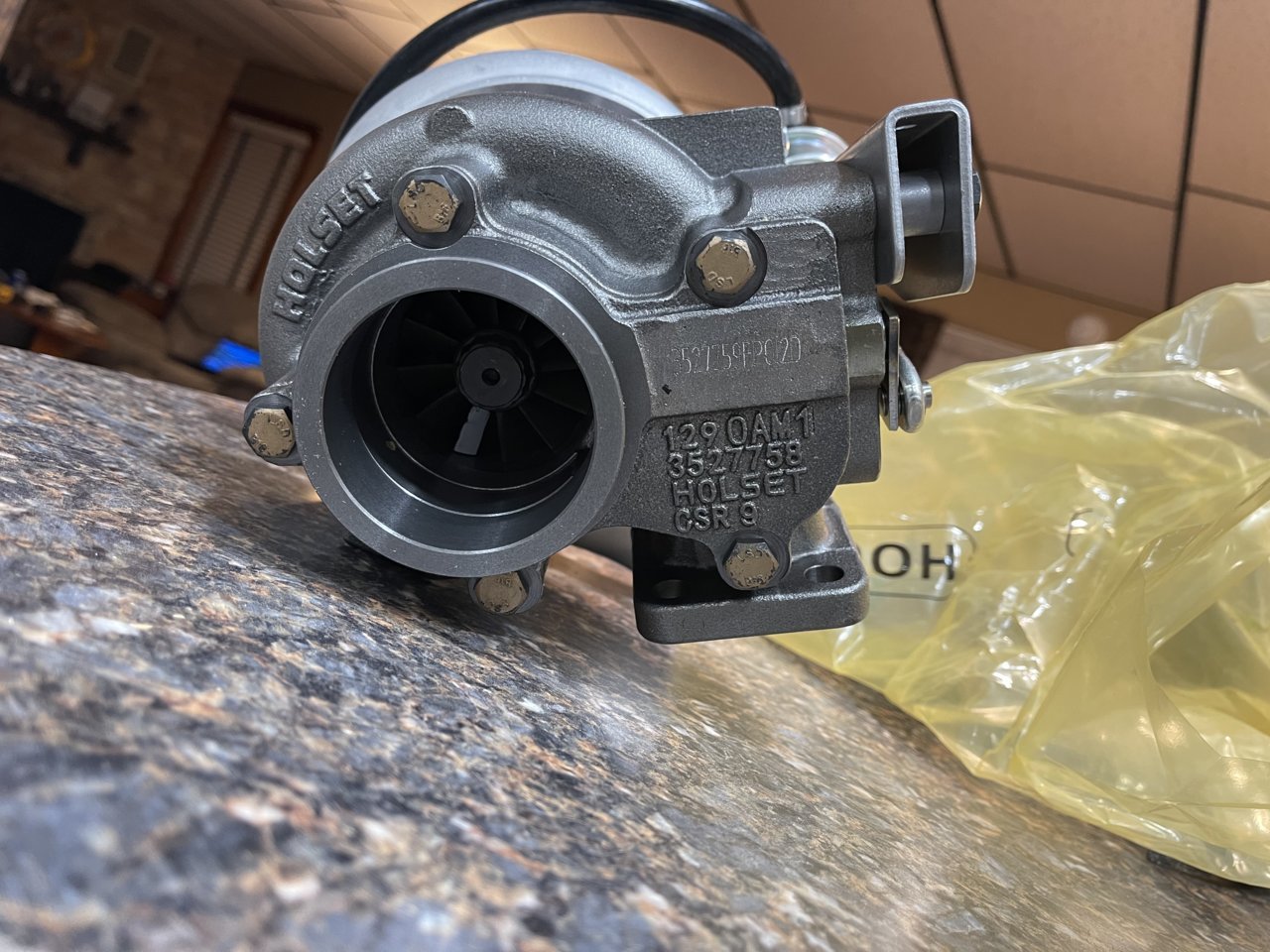

    Judging by the picture I have, I'll probably have to look into this. I think I may end up doing like you did with the welded on external gate directly on the housing. D1995F50-1F35-4D71-8F9A-94A623A6B2BF.jpg

    I even went so far as to use a die grinder with a Benchmark Abrasives flapper wheel, grind a volute to help prioritize flow, in the cover. As well as letting the flap open a little more.
    Pull your cover and check your clearance.

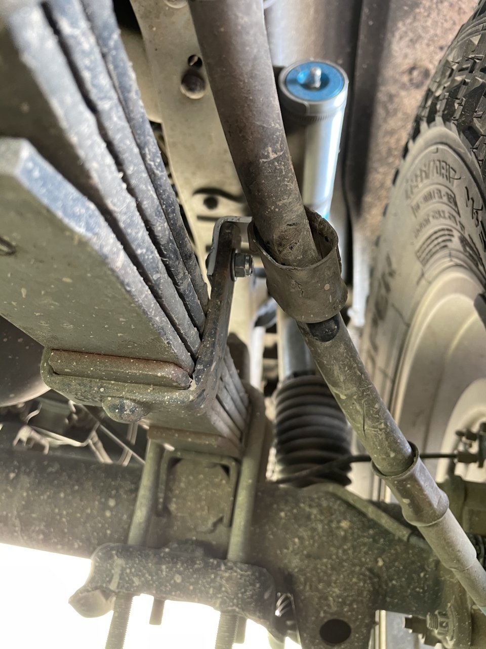

    I also made some 90* brackets out of aluminum to relocate the rear brake lines since they were rubbing on the leaf springs

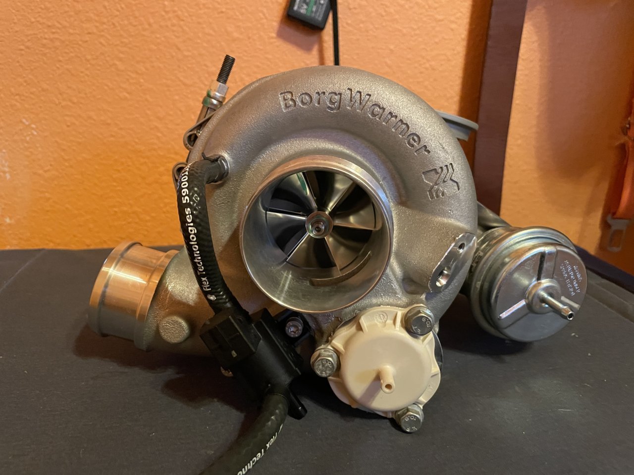

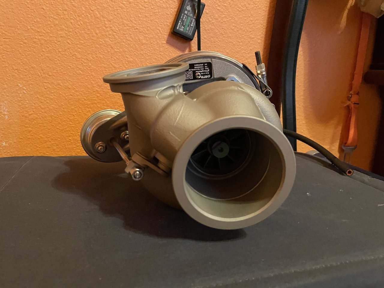

    This came in today, Borgwarner EFR 7163 w/ v-bands in/out and .85 a/r. Should support from 300-550hp on a 1.5-3L motor. I’m hoping it’s pretty spooly on the 2.7. Id like to turn things up on the stock short block and push around 300 rwhp. If I could do that, I’d be pretty happy. I opted for the titanium grey ceramic coating on the exhaust housing. Can’t wait to head down to Houston and work with Torspd to build a manifold for the 2TR. I’m getting excited :D

    Nice metal snail ya got there
