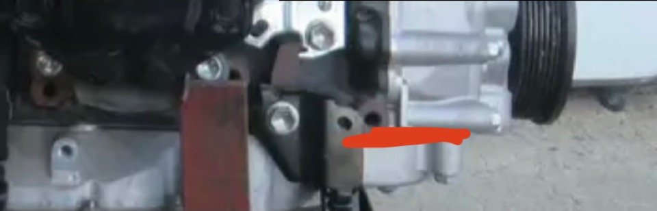

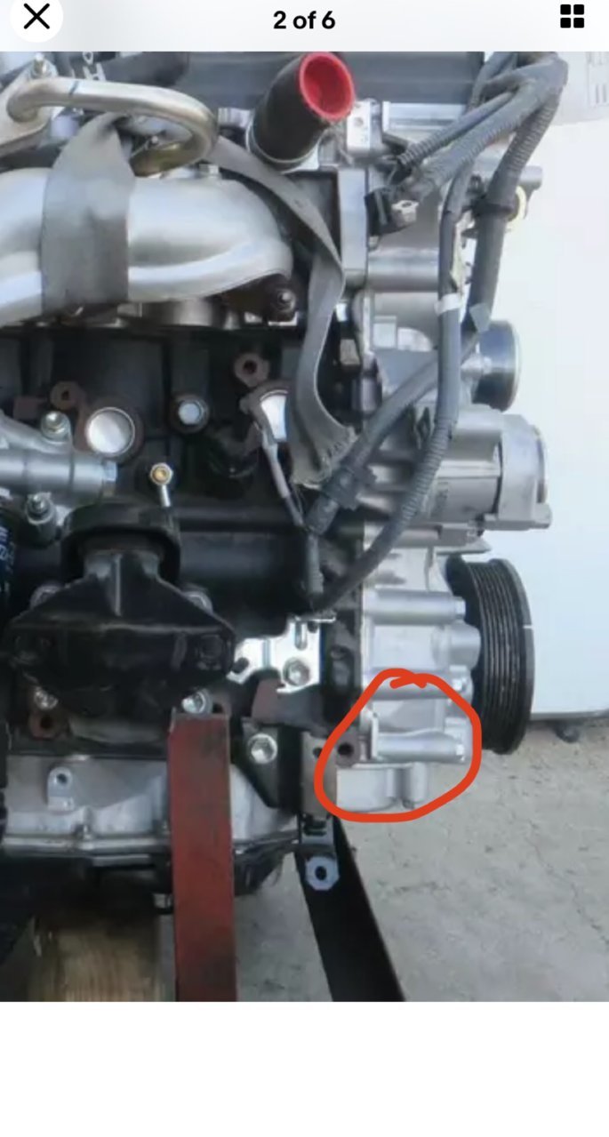

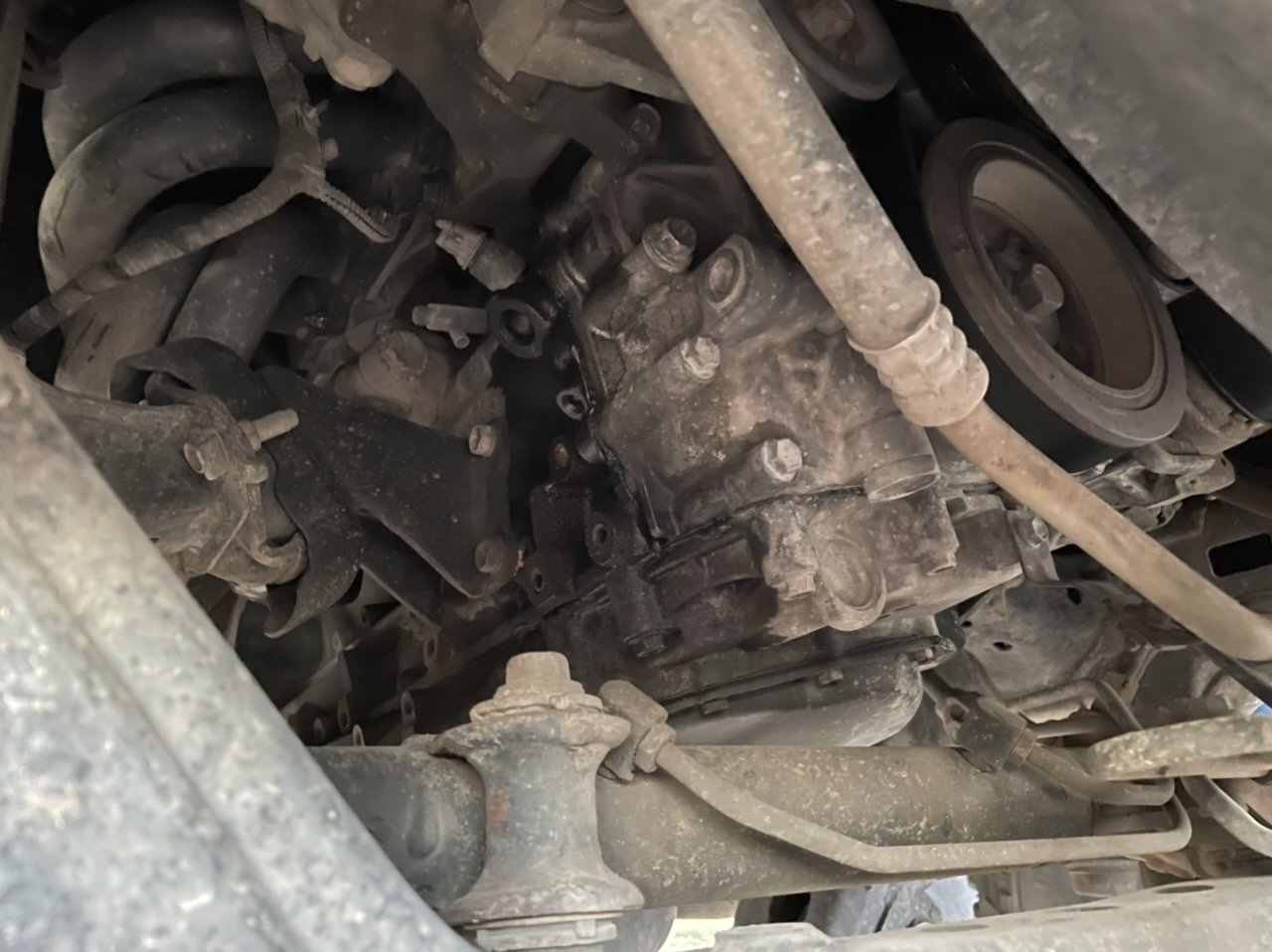

    Afternoon Robert! I’ve got a small leak coming from this area, definitely oil. Could it be a gasket? Or a loose screw?

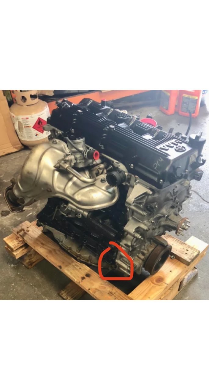

    I would start by checking all the bolts on the oil pans near there, but it's likely a gasket. Toyota uses FIPG there in place of a gasket. Worst comes the worst, i would drop both oil pans, and reseal them that way. I must ask though, what is with the extra motor?! you having one built? Hopefully you're not having issues.

    lol no just stock google images, wanted to relay were the leak was since im not at home and dont have a pic. Ill take one when i get home. It was on my mind and i didnt want to forget haha. My engine oly got 117k so just broke in lol.
    Looks like gasket sealer was used there. Its a white gasket.

    It's a little hard to tell from the pic, but is the oil coming from between the block and the timing cover? if so, you can remove the timing cover and reseal it without removing the oil pans, that's how i did my head gasket job

    Oh okay, good deal, glad you're not having any issues with yours. I think i have a similar very slow leak/weep on my new engine. I sealed the timing cover up per the manual, but there is a slow seep from somewhere. I've kinda chocked it up as normal since my old engine had the same leak. Although, i think mine is higher up behind the alternator

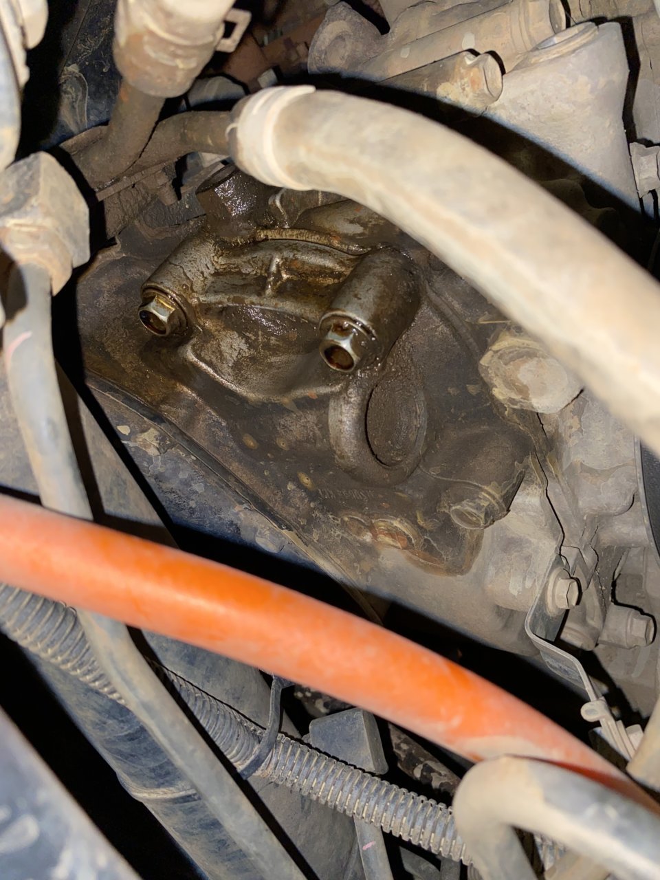

    leak is coming from either one of the bolts down there or the gasket area in pic below

    Okay yeah, then that fix would be dropping the lower and upper oil pans and just resealing them. How bad is it leaking? Enough to leave spots where it’s parked?

    No not yet that bad but im proactive and want to stop it before it becomes a bigger issue. I removed all the skids so this would be a good opportunity. Plus if its leaking that mean water could possibly be getting in when i go through water crossings and stuff.

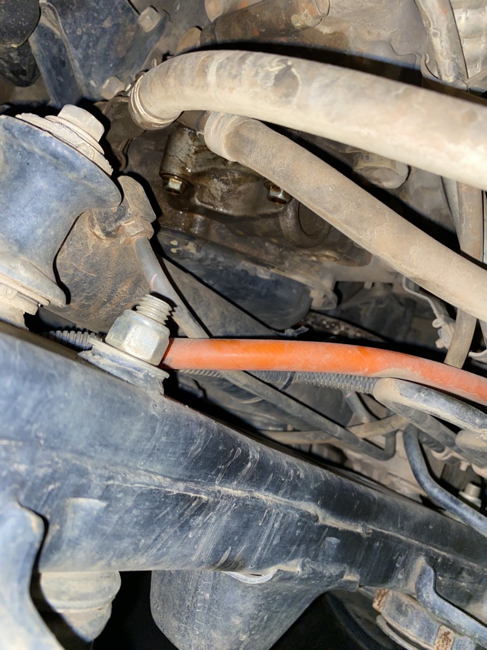

    Here’s the leak

    I’ve got a similar slow weep even after sealing mine up per the factory manual when I did my head gasket a few months back. Hard to tell from your pic but yours might be coming from up above where the timing cover meets the block too0FE4011E-91E5-4D22-BF7B-8CD78C22ADAB.jpg
