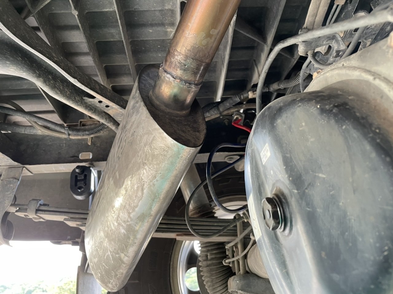

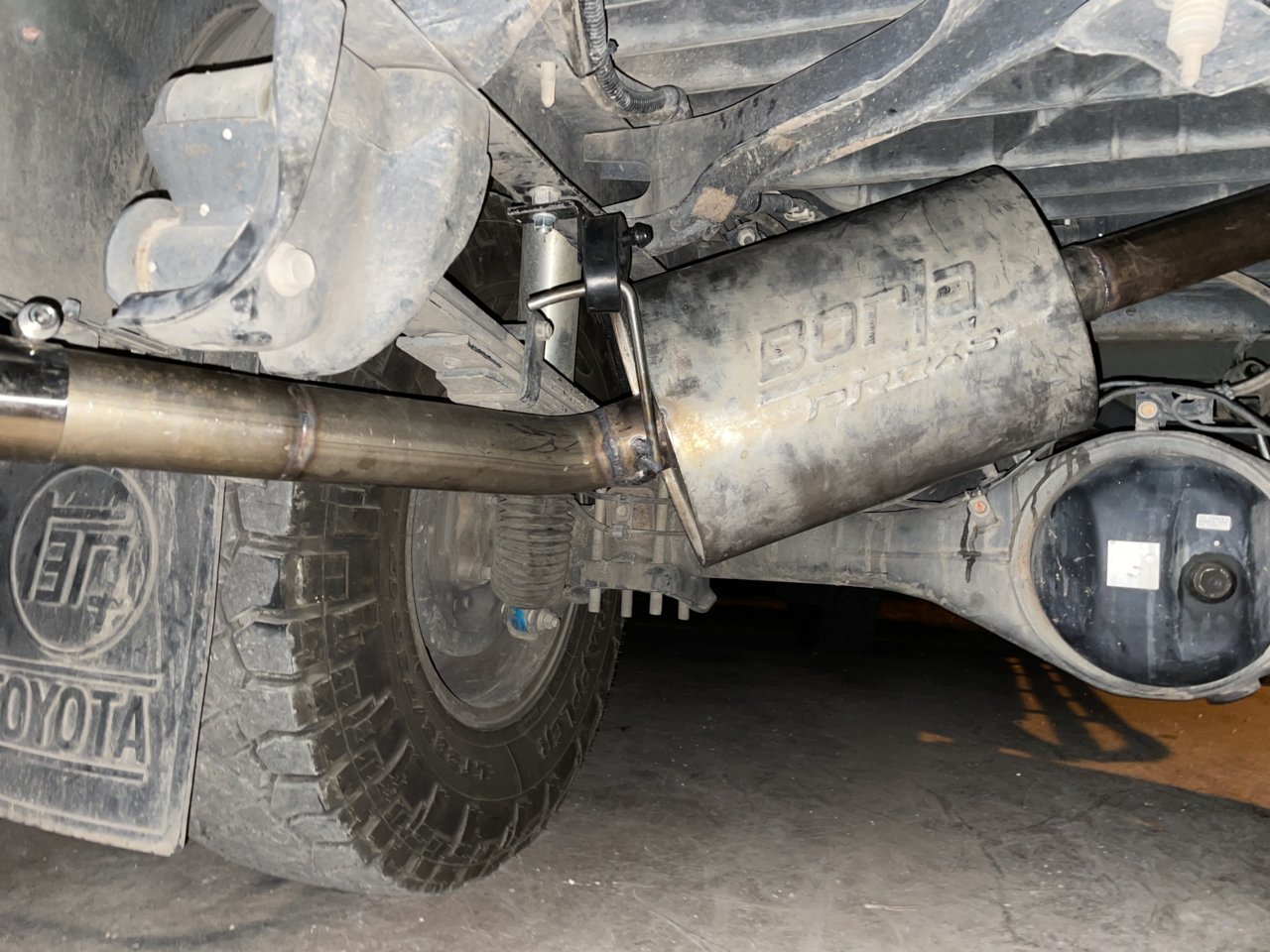

    Progress on the driver side tail pipe. Got a 1.5ish inch extension welded in, turned the piping, welded that in, and then fitted the muffler and got that welded as well. Started fitment for the tail pipe and it started getting dark so I’ll finish that up and do the hanger tomorrow. The other borla 40364 muffler should be here Thursday for the passenger side. In the meantime, the AWD taco will be back on daily driver duty

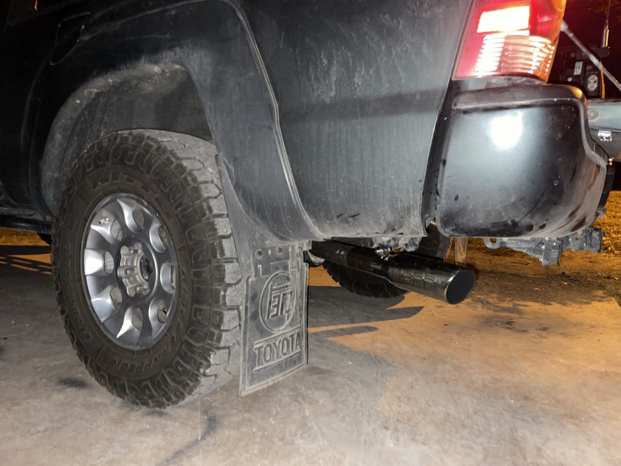

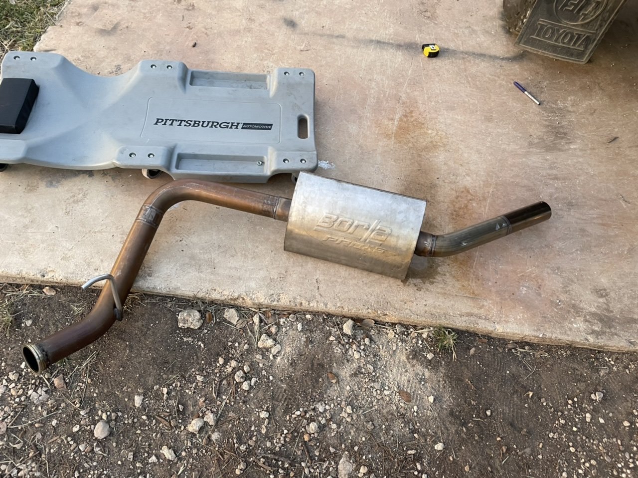

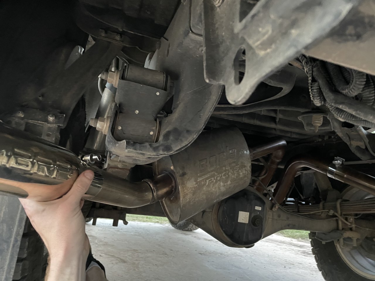

    Alright got it wrapped up today, had to weld an extension on the bend I was going to use for the tail pipe that came off the muffler. Fit all that up and then finally got the hanger put on, which was the most difficult part. Gonna daily it tomorrow and see how the noise level is but it’s weird there’s a lot more noise coming from the passenger tailpipe now lol. Need a piece of stainless for a hanger and then I will work on redoing the other side

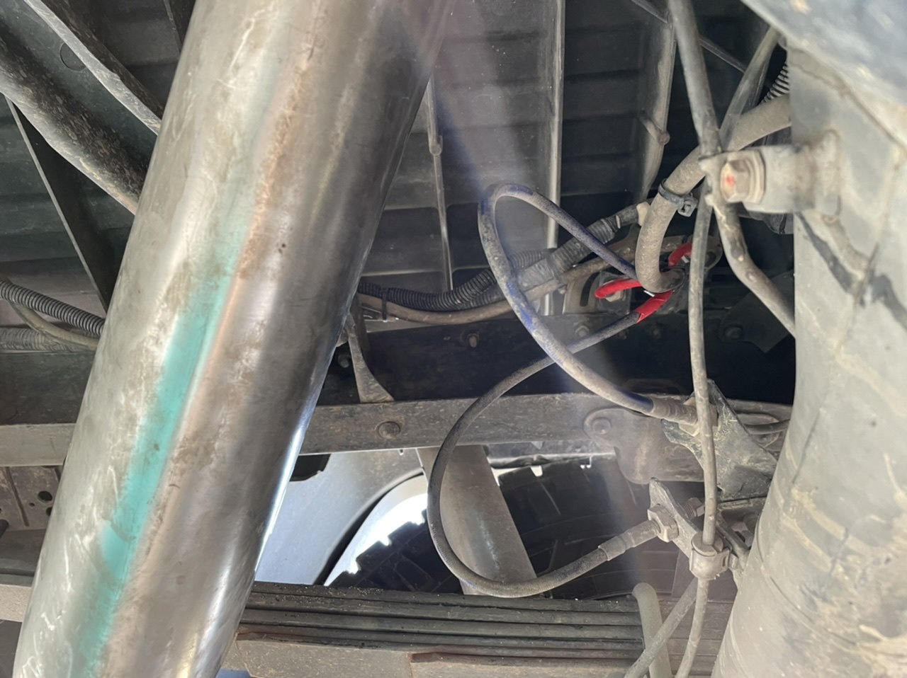

    shot of clearance near the diff/brake lines

    Path of least resistance?
    Those mufflers are not directional are they?

    That's just the path i took using the bends from the old piping. I am going to have to match the other side when i rework that one. And no sir, these are not directional, any which way will work

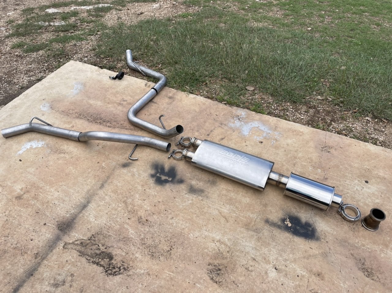

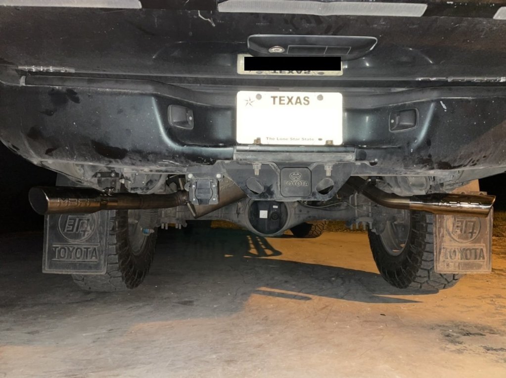

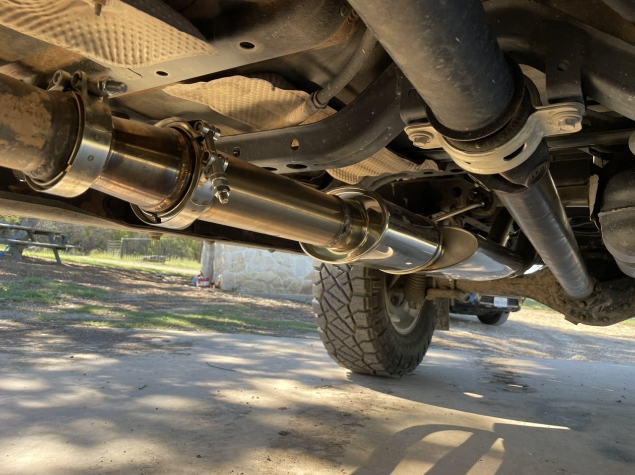

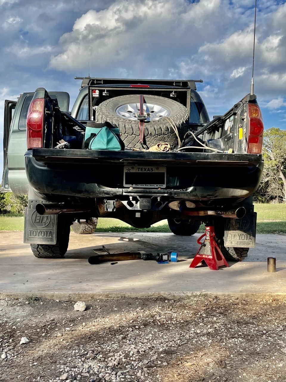

    Got the passenger side started and ran out of gas. So I mocked it up with tape and I’m gonna go get some more tmrw morning. This side was quite a challenge to get it to match. I think I got it pretty close

    Looks good from where I'm browsing.

    Should sound really good in no time.
