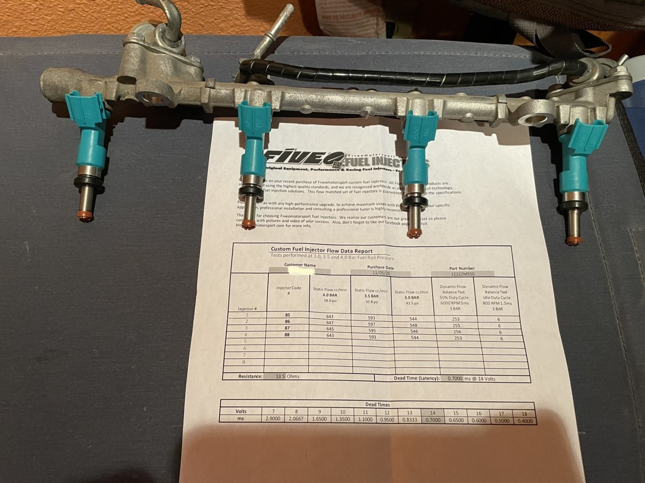

    Got a set of 550cc flow matched injectors in for the turbo build and test fitted them in my spare fuel rail. Looks like they’re gonna work perfect! These along with the larger 80lb 5th should be plenty of fuel for what I want to do with the stock short block for now
