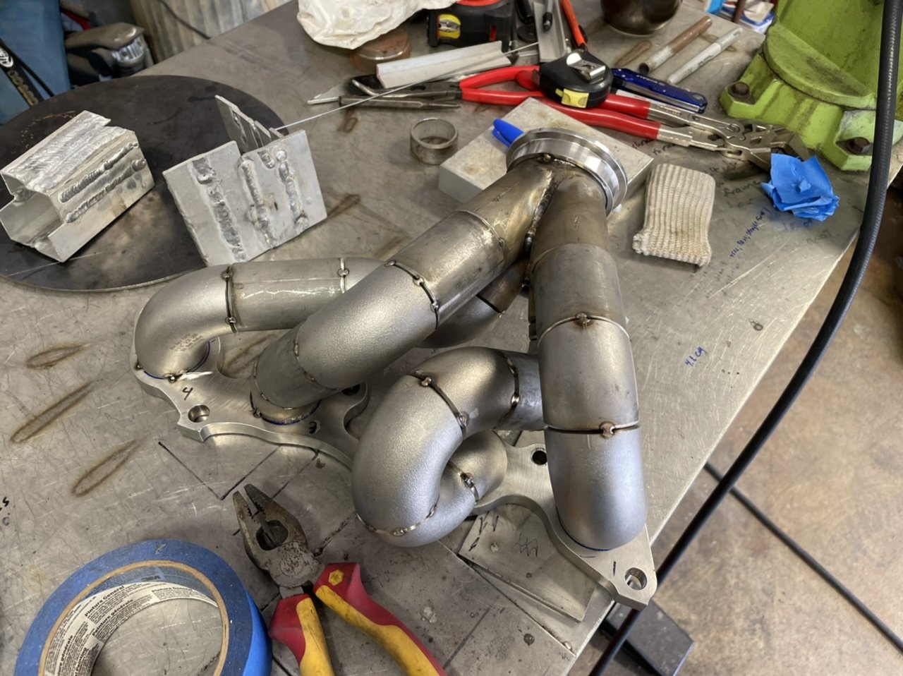

    It came down to the desire to try to make equal lengths more than straight shots. Which would totally changed the design, location, etcetera.
    That being said, exploring the idea of an underslung turbo is still on. It would just require a completely different style header design. Which I pondered heavily last night. So much so that I dreamt about it even. Lol.
    We're making "wants" happen. :D Coincidentally, the design ended up being quite close to the last header I made, without trying to do so.

    Nice fab sir :thumbsup:

    All courtesy of Torspd! I was just there to assist/learn

    This was the Squires Turbo System. STS Rear mount turbo kit. I originally had one on my truck. Not worthy. Under engineered.

    Excellent on both of ya

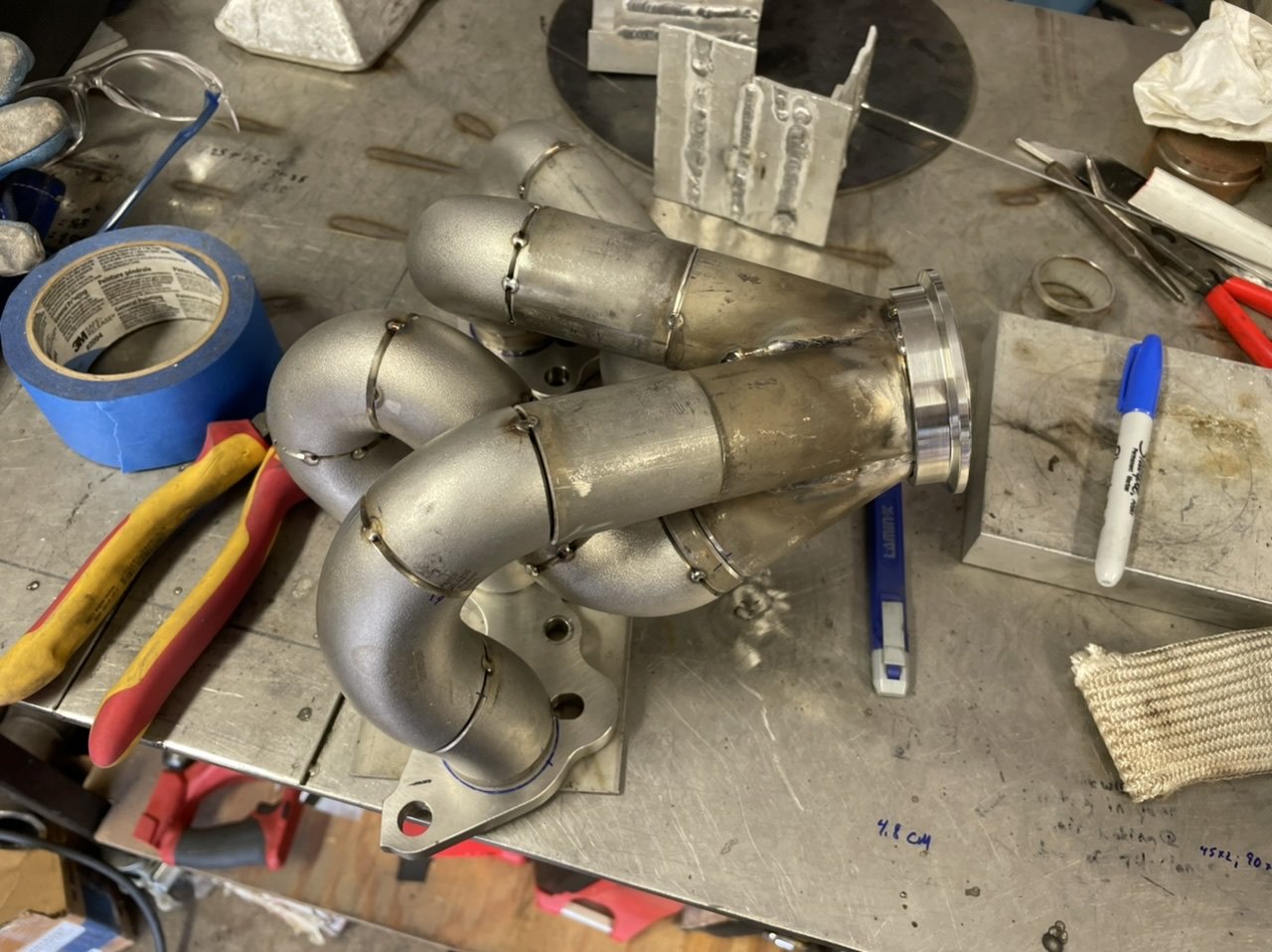

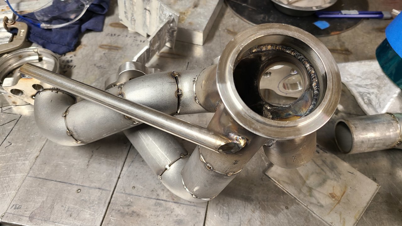

    Hoping to have this manifold fully welded by the end of the week. Very exciting to get this one finished for @BassAckwards, and to see how it performs compared to the Rotrex. Although I already have an idea. :D

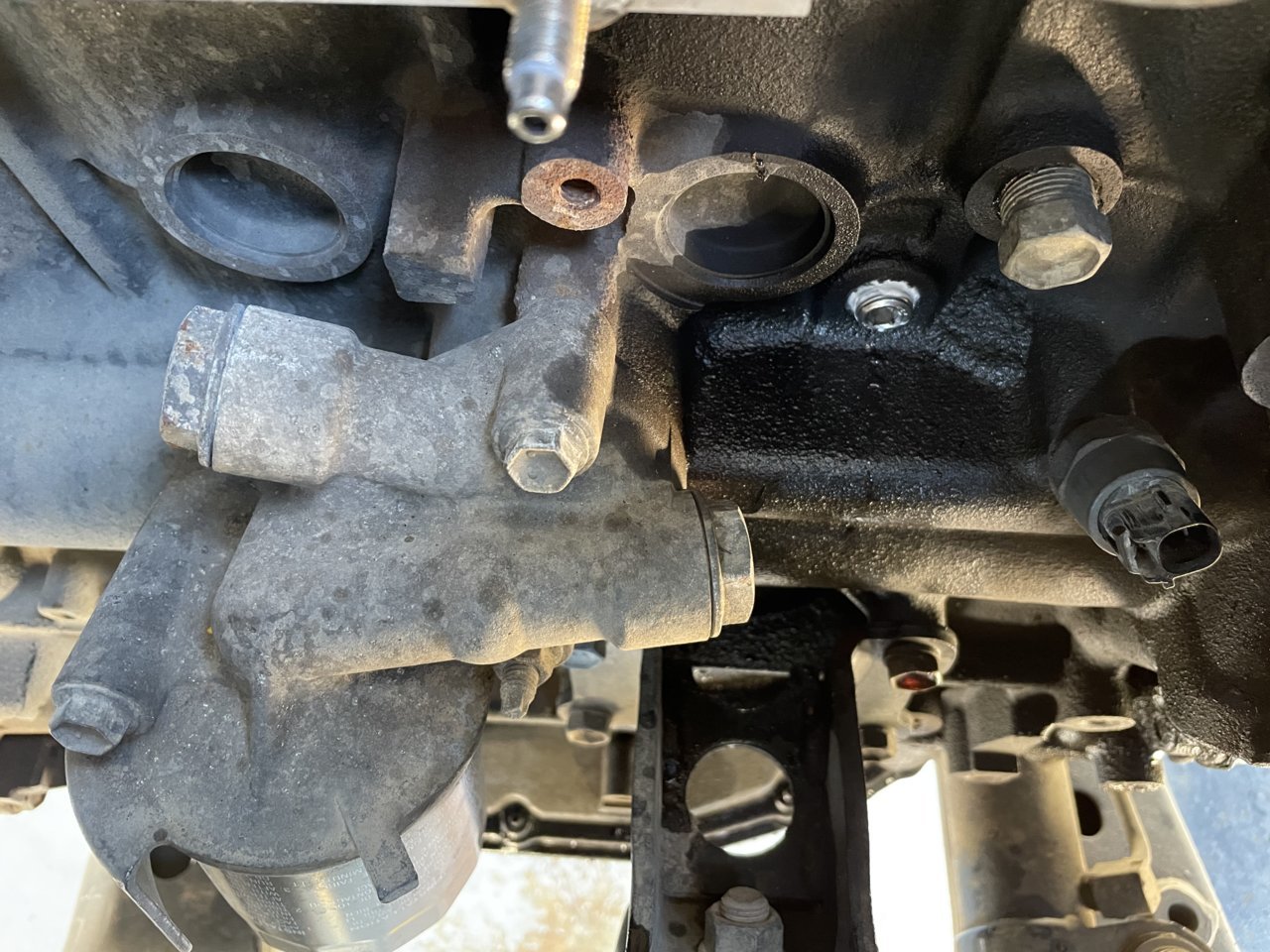

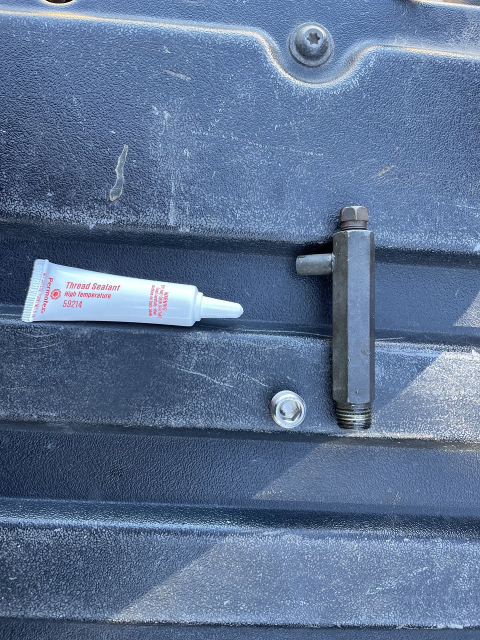

    Prepping for turbo plumbing today. Removed the old coolant drain and replaced it with a stainless 1/4” bsp tapered hex plug to gain clearance for the new turbo oil feed fitting. Coolant flush was a necessity as well as some minor disassembly to gain access to the old drain. About to put it all back together now after a little intake tube mockup
