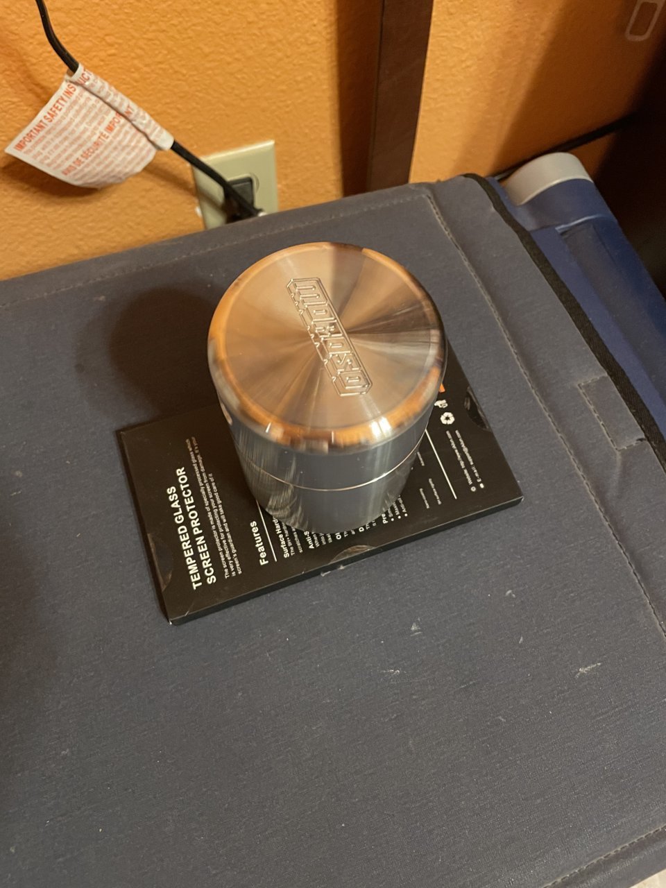

    Thanks for the info here, this will definitely come in handy. Question on your catch can, so are there two inlets and an outlet on yours? And also why the need to drill out the pcv?
    Got this in a couple days ago, perfect timing:D

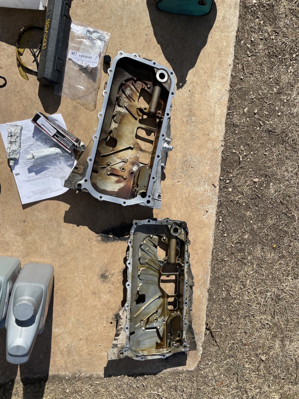

    Got sick of fighting the stock ecu, so did this exercise again tonight. Gonna start saving for a standalone but will be running the stockers and 840cc 5th to start with the new turbo setup

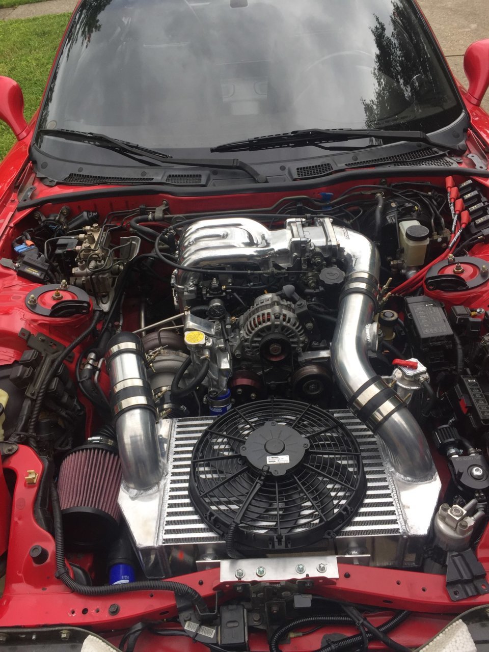

    Haltech is good stuff. My buddy's RX-7 is managed by one. They’re based right here in my home town....so I've been to a couple of there tuning days. Lots of fun.

    Oh no....no drop! We put a new JDM long block in it not quite 2 years ago. Dumped the OE twin turbos for a single Borg Warner EFR 8374. Exhaust, intake, fuel system work of course. All controlled by a Haltech Elite 1000 which he literally drove 5 miles down the road to buy.
    Lots of suspension work as well. He auto-x's it regularly. It's not his daily driver.
    2700 pounds, 400+ hp. You do the math.
    Zoom Zoom :D

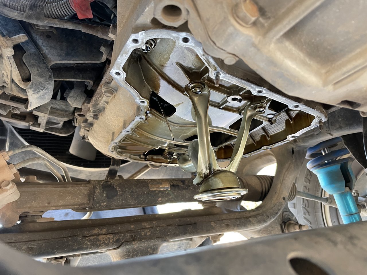

    well im neck deep in an upper oil pan swap and i just found out i think i ordered the wrong o-ring for the oil pump:bananadead:

    Can you reuse the old one, and or add gasket maker to the top of it?

    Yeah thats what i opted to do, little bit of fipg on top of it and throw it back together. Just finished up, waiting to fill it with oil for a few hrs

    No kidding, its the best, i try to keep a tube around for these occasions

    On most modern Toyota engines, except for the valve cover (head cover in Toyota speak) gasket, the entire engine is sealed up by FIPG.
