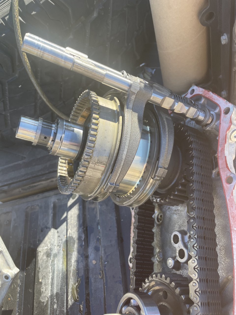

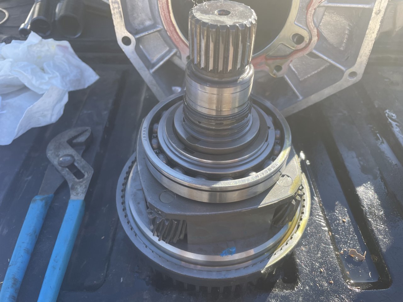

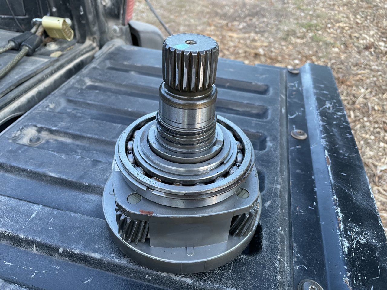

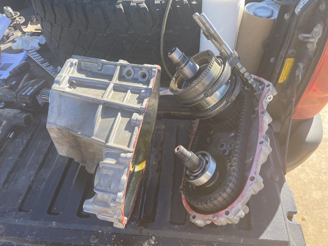

    Got the AWD case split yesterday and overcame several hurdles due to a lack of instructions for the VF4B. Ended up referring back to the FSM for the FJC and was able to get the input shaft removed. But that’s where my luck ran out, and i was unable to separate the gear that needs to be swapped over to the NWF input off of the old input. Tonight i made a tool to be able to use a jaw puller on it though, so im going to give it another go tomorrow once that arrives. Here’s a bunch of pics i took yesterday.
    also i found this interesting. On top here is the tacoma input shaft from the Part time 4wd case behind the RA60F 6 speed. And on the bottom is from the AWD case behind the RA61F 6 speed out of the FJ cruiser. They look quite similar and same 22 spline input, but the one out of FJ is much larger at the base

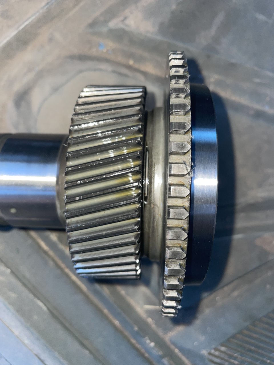

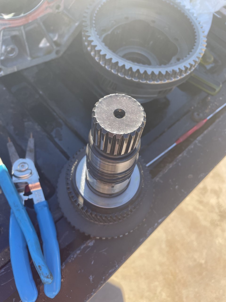

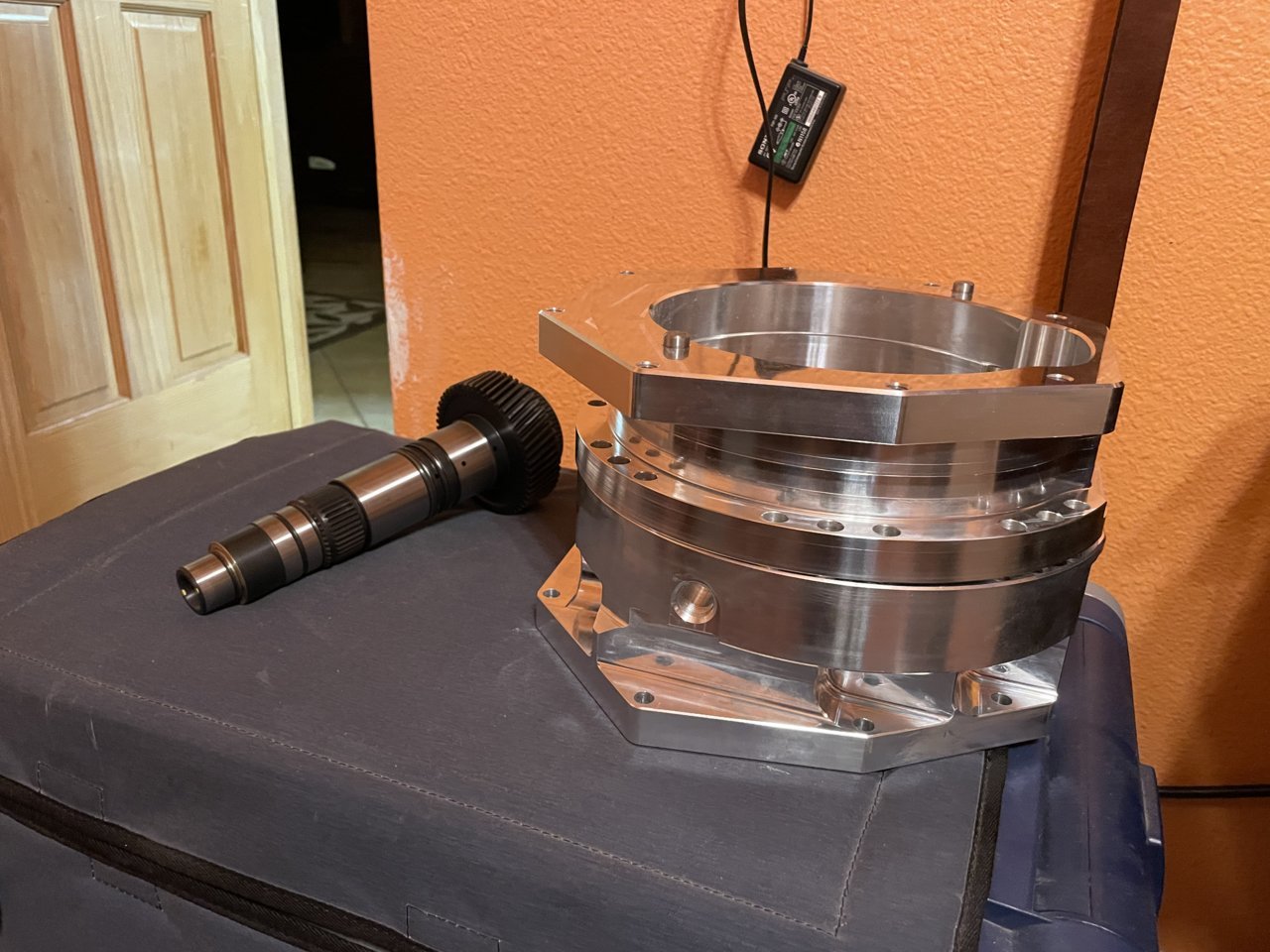

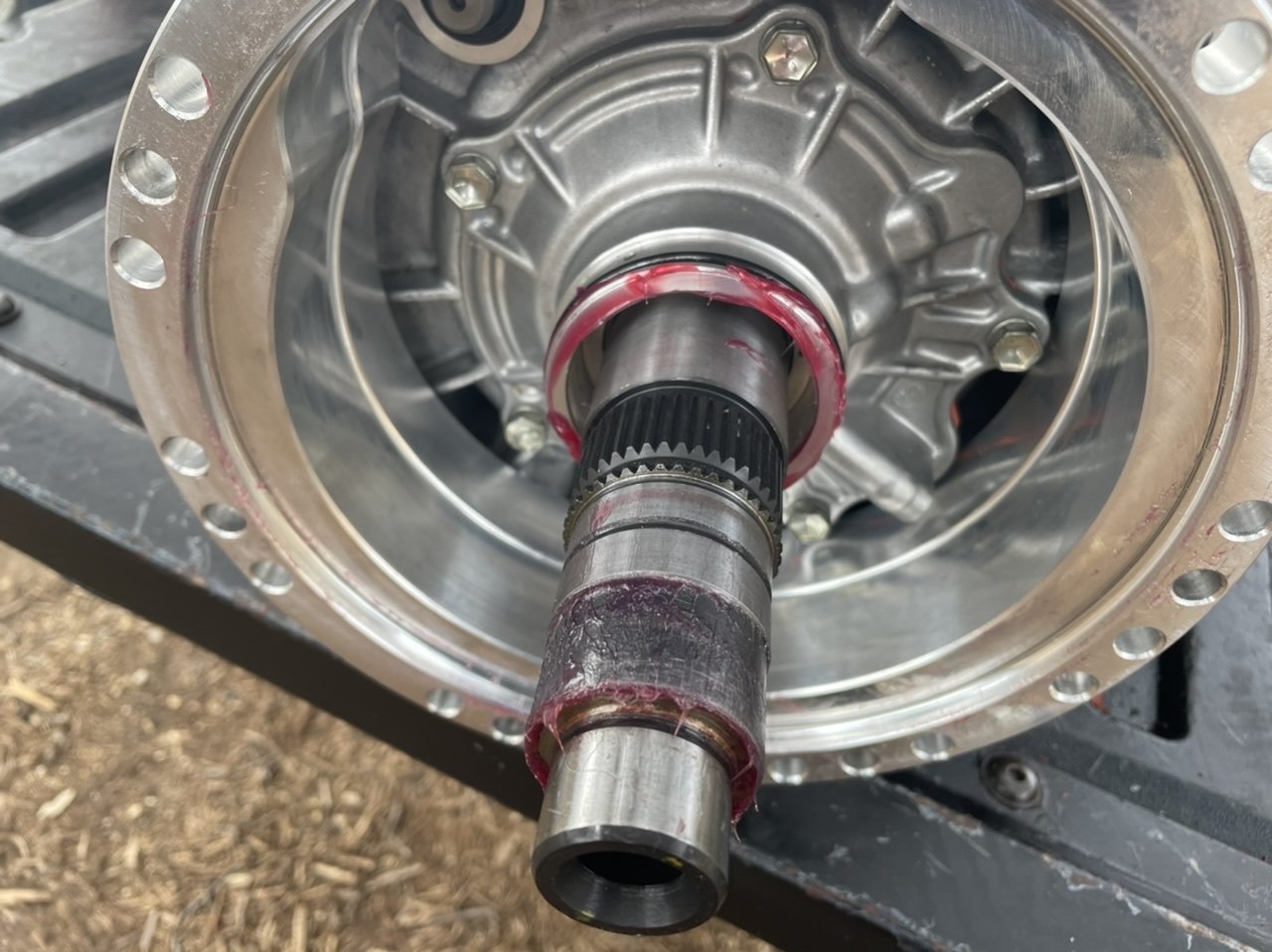

    Well, got the gear off of the old input shaft with a 3 jaw puller and the tool i made, but as usual, i hit a road block. Tried freezing the NWF input and baking the gear at 450*F for 30 minutes, but still only got the gear on the new input about half way. So it's looking like i get to buy a 20 ton press now bc it's about an inch too long to fit in the vise. Thanks a lot murphy lol

    I'm all for excuses to buy new tools, but you might try a local shop or fellow TW member in your local threads and see if they could press on that last little bit for you for a couple bucks.
    I got the impression that swapping the input shafts was a lot easier than this from the other guy that put his NWF box together, as he didn't mention any challenges like this. I'm not surprised honestly. I will definitely be reaching out when I go to do mine.

    Yeah i'm a little hesitant to try a local shop around here, as i have a general distrust for shops and i live in the middle of no where. Also, if something gets messed up, id much rather be the one to do it so the blame is on me..
    I did as well, i figured this project would be a cake walk as i have split about two or three VF2A's and taco cases to swap inputs. These damn press fit parts have been eating my lunch every step of the way though. I will 100% be giving my honest review of how difficult everything was once i finish up the process, and i'll probably post it in the crawlbox thread so others can get another take on things.

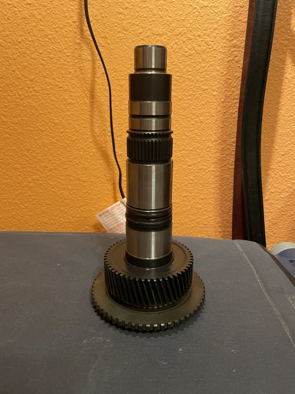

    Success at last. As usual, it’s all about having the right tool for the job. 20 ton press laughed at this thing :D

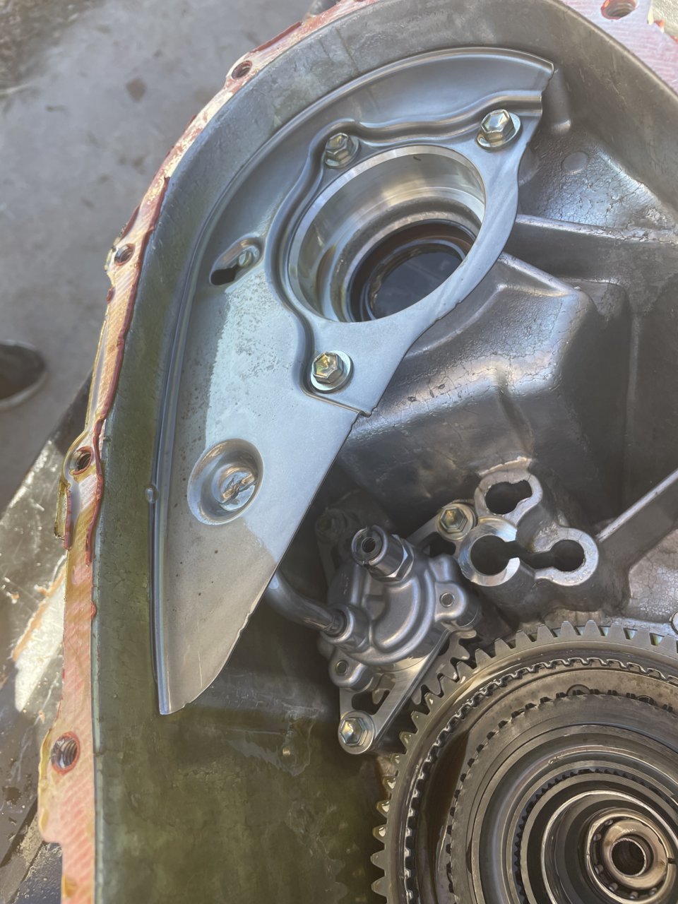

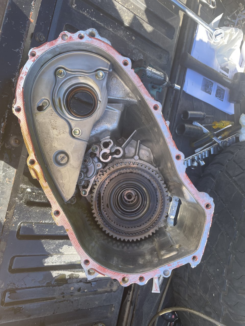

    Well, it’s been a busy weekend wrenching. Started out by reassembling the AWD case which quickly turned into another battle lol. Got the input swapped in Friday and figured I’d try to test fit the front side of the case. The case would not seat all of the way, so i knew it had to come back apart. Well that went south shortly after when the center diff lock shift fork got pushed from the unlocked to the locked position. This would be like the equivalent of shifting from 2wd to 4wd in a part time case. When this happens and the case is split, there are three keepers and two springs pop out of place and have to get put back in.

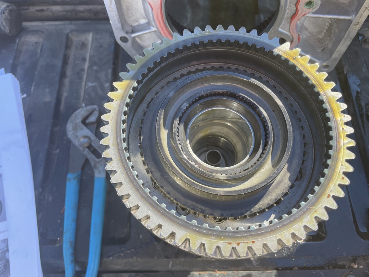

    So here’s what I was looking at now. At this point I also determined why the case wouldn’t seat all of the way, there were two balls and springs for the shifter that I didn’t remove and they fell down in the shift rail’s slot.
    After much deliberation, here’s how the springs and keepers get installed on the VF4B.
    And the shift rail retainer has to be flush with the back of the case. When reviewing some pics i took during disassembly this is how i figured out the issue with the shift rail springs & balls.
    While i had it apart I swapped in a magnetic drain plug I had.

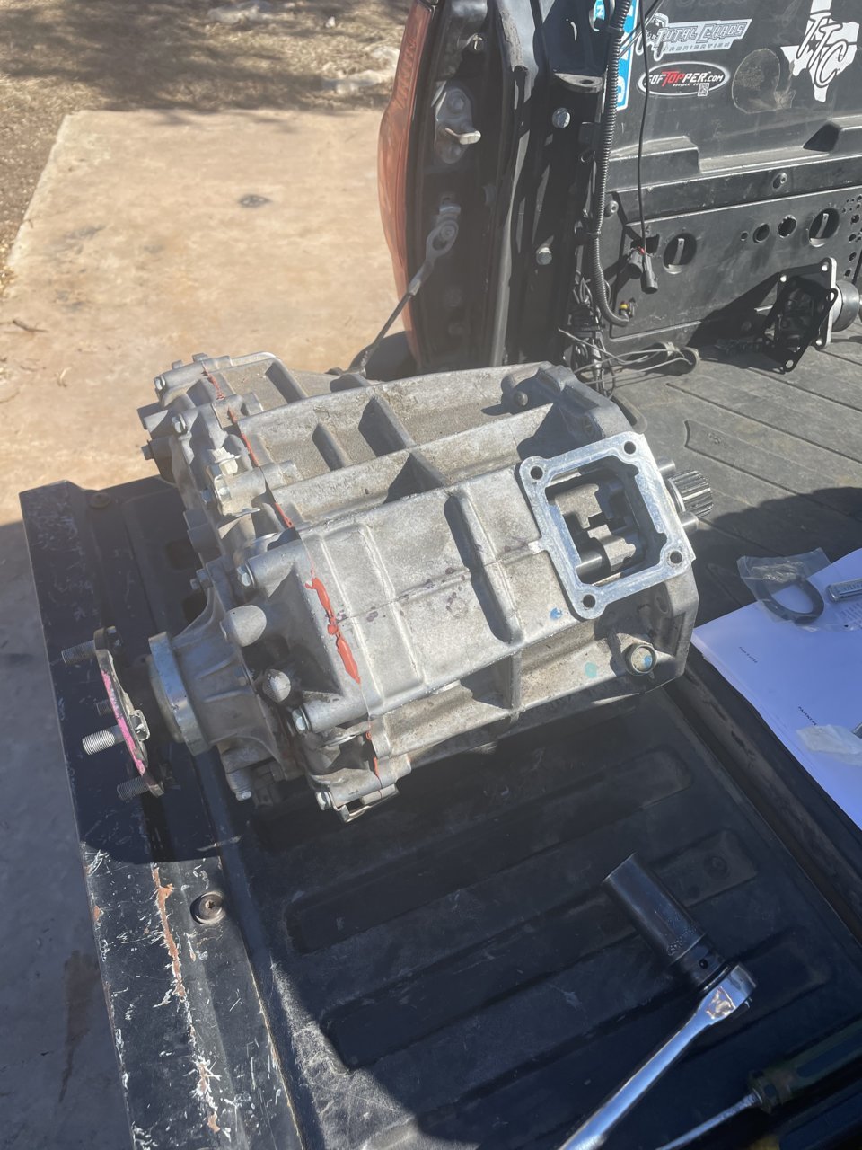

    And a few hrs later finally back in one piece. It was a big victory to get it back together after things literally fell apart lol.
    Now onto the fun stuff, gutting a part time 4wd VF2A and building the EcoCrawler
    hit a minor set back this morning, figured out why double low wasnt engaging. It turns out the bearing retainer/front cover that seals around the input shaft for the AWD transfer case is too large and is interfering with the gear that engages low and high range on the Ecocrawler
    My fix was to pull the auto t-case retainer/cover off the cover and see if it’d fit on the AWD case and it turns out it does, and it also allows double low to engage now. So i’m gonna buy another A/T retainer/cover for the EcoCrawler since it needs one too.
    Both cases assembled and functioning

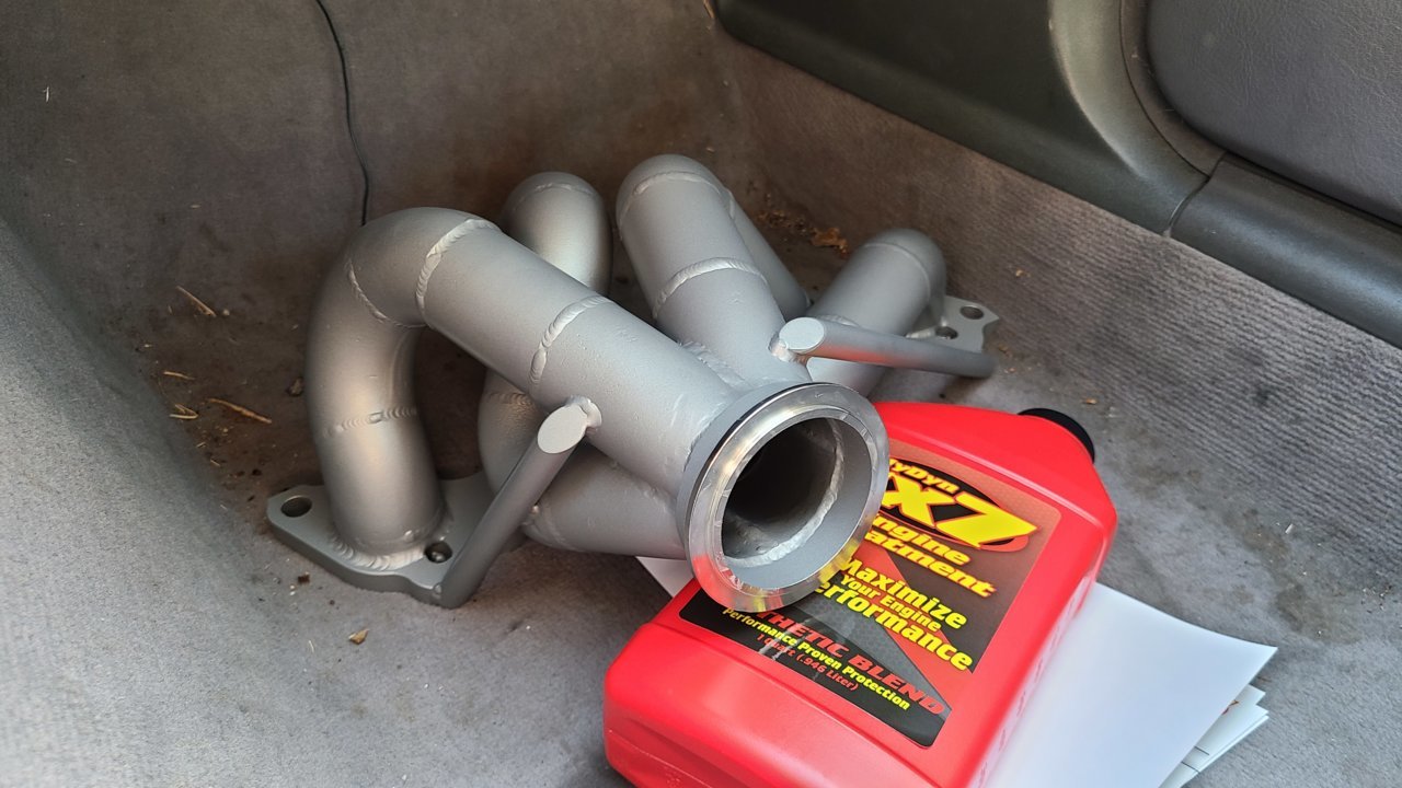

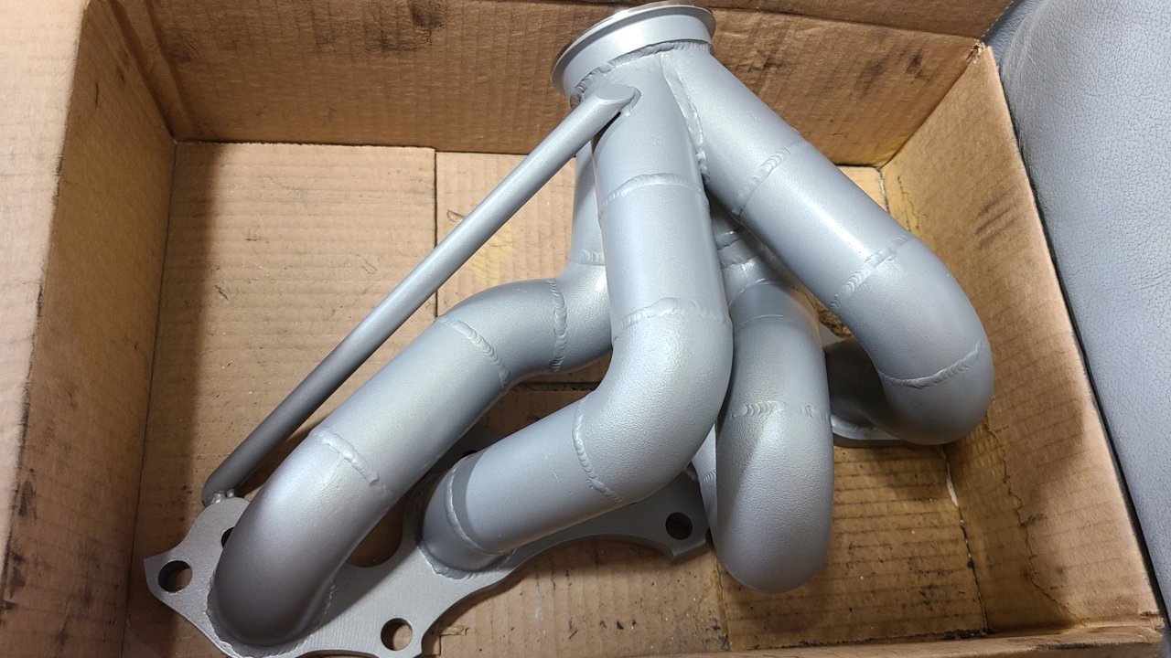

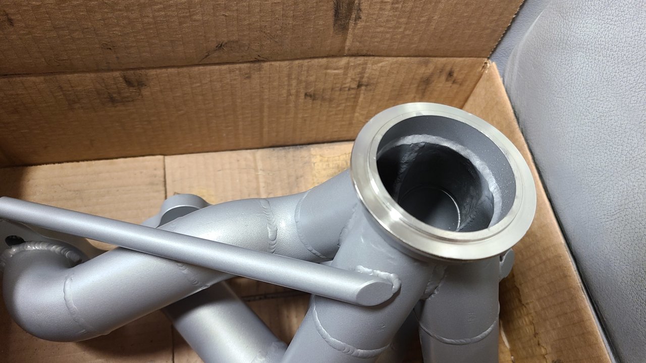

    Thanks Russ! Just got word that the turbo manifold is ready to be picked up from the ceramic coater.. So that's going down this coming weekend finally :headbang:

    Can't wait to see this in action with the turbo powering it!
