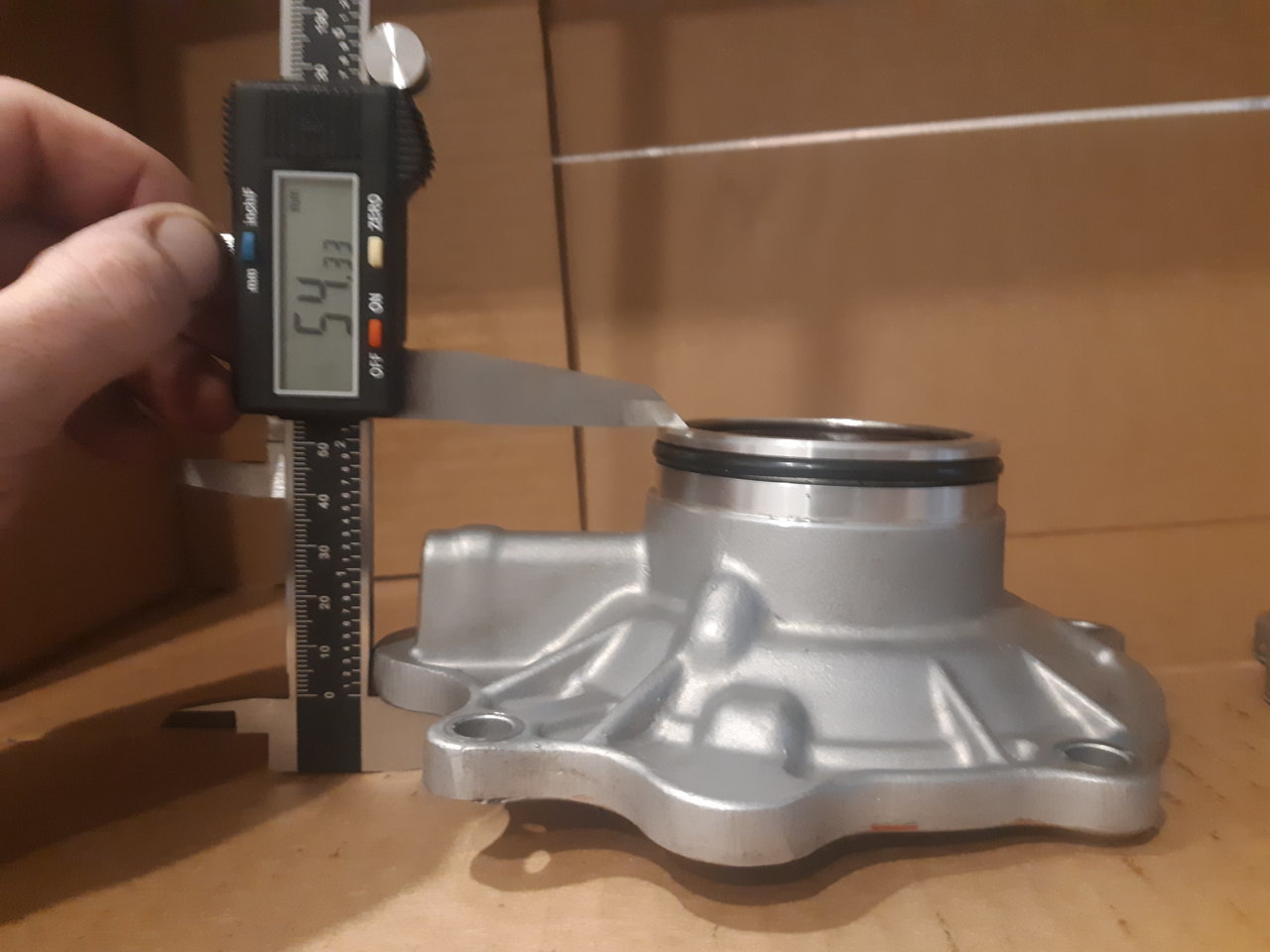

    Thanks that's super helpful and exactly how I thought it should be. I'll match my flange and input. You have now done the same thing, matched the flange on the NWF box with the one that would normally come behind your trans.
    Said differently, the flange itself wasnt the problem in shifting to hi-lo on the NWF box, but the flange being the wrong one for your trans was the issue. Correct?

    My issue was that i tried running the RA61F flange on my AWD case since i knew i needed the auto flange for the crawl box to seal the trans. In other words, the o-ring flange will not work on your rear-most case with the crawl box in front. You must run the AT flange on your rear t-case so that the crawl box can shift into low because the RA61F flange is a larger O.D.
    Hope this makes sense, let me know if i need to clarify. And thank you for the offer! I will keep this in mind in case the one i ordered doesnt work. I found one on ebay for $16 bucks so if that comes in undamaged, that will be a score

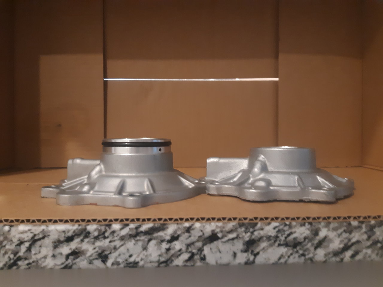

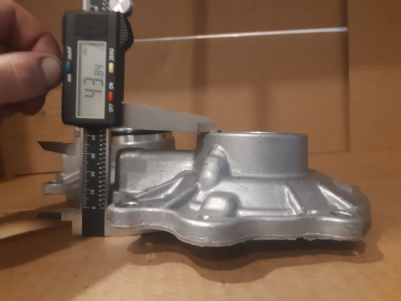

    That makes perfect sense. I can easily see how a longer flange on the rear case would prevent the shift rail on the NFT case from going all the way back.
    6speed taco flange left versus auto FJ right.

    Good pic for comparison, thanks for that! So maybe it was the overall length that got me and not the diameter of it.
