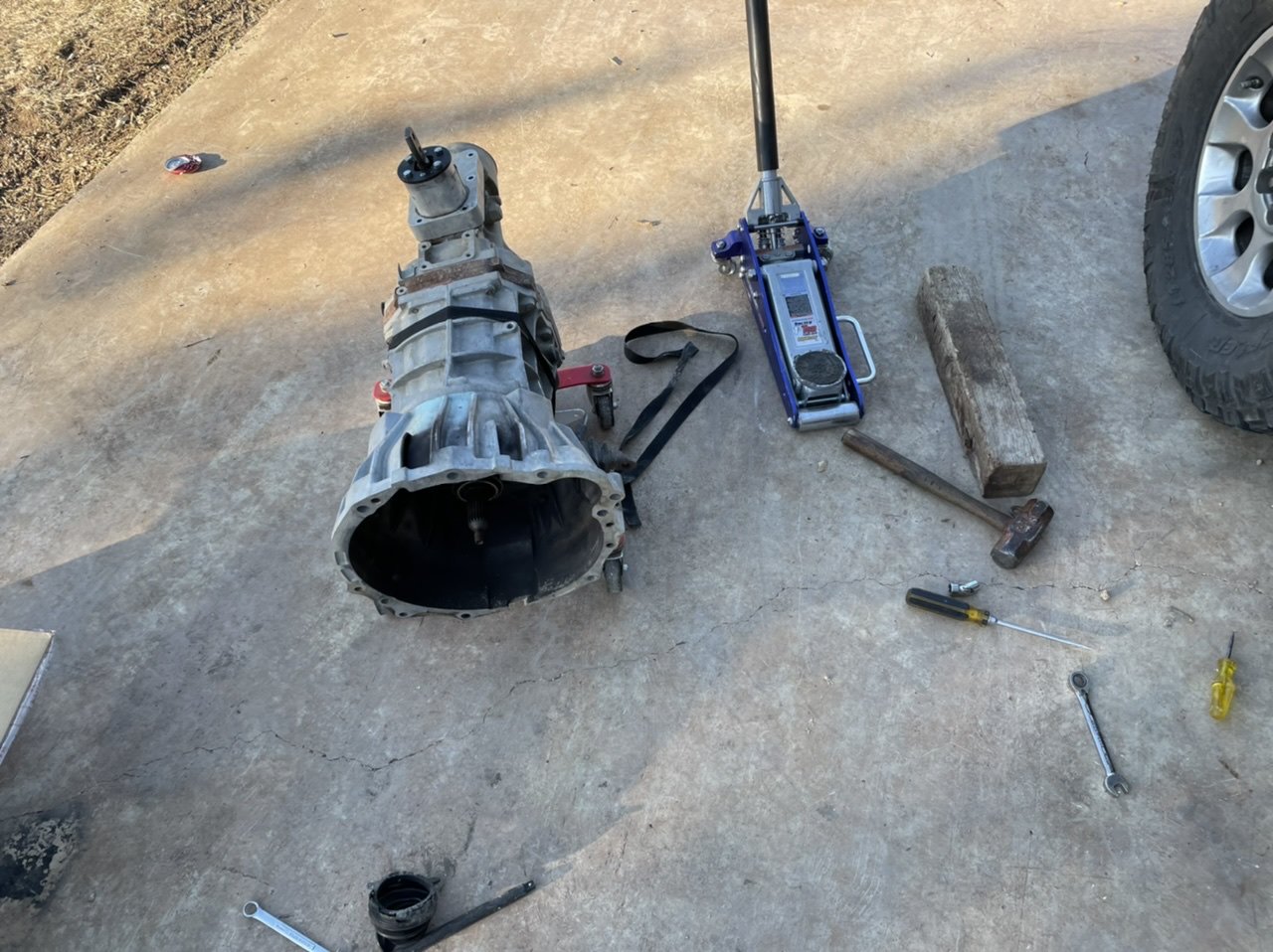

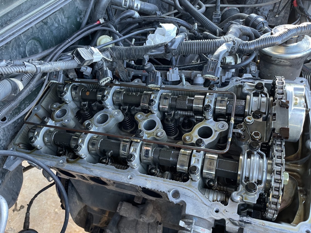

    Tear down is going quick. Trans is out, and mostly everything disconnected. Have a few coolant lines, and misc things to disconnect, but then itll be ready to pull next weekend and hopefully drop the old one back in. Valve train looked okay as expected, so problem is likely in the bottom end. Havent drained the oil yet or pulled the pans. Probably will do that once i can get it on the stand
