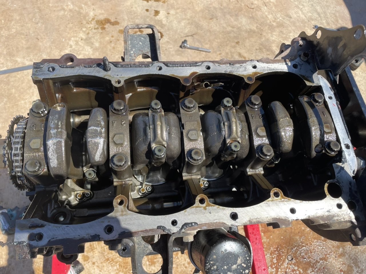

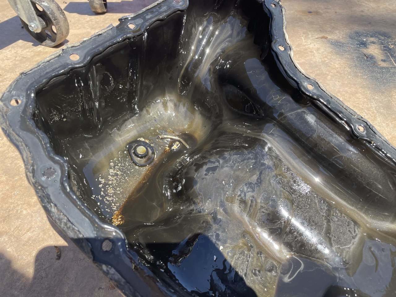

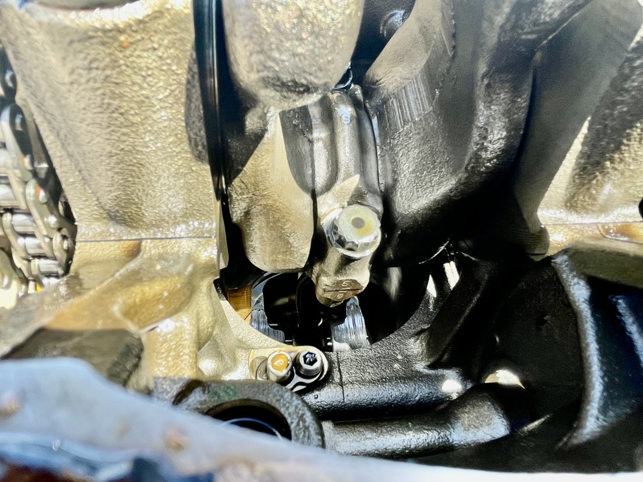

    Quick update, got the hurt motor on the stand today and took the pans off. Bent the connecting rod on cylinder one, that took off the oil squirter for the piston, and then the crank counter weights started to eat the bottom of the piston. BA4DAA6B-7A61-40A0-97FE-B7FBDC771C97.jpg

    Were you able to get that rod/piston out of the cylinder? I'd like to see uncle Rodney.
    Plus that'll give you access to viewing the whole amount of damage. As in how recoverable the damage is.

    Here is a positive note. You get to keep saving money, by re-using the ARP head studs. :D
