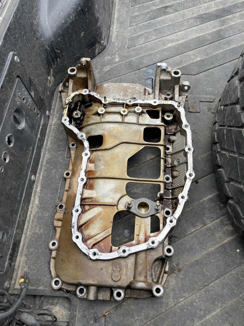

    Also pulled the upper pan off the 05 motor. Gonna swap it on my 09 block next weekend since it has the drain bung for the turbo. New welding helmet should be in this week, then I can start mockup for the downpipe & midpipe.

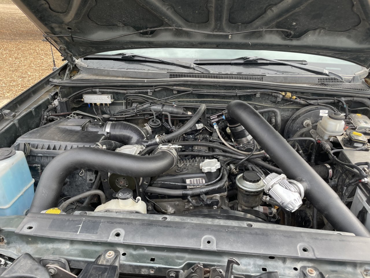

    Reinstalled the stage 1 urd kit today. Gonna run it like this while i fab up the downpipe and midpipe to complete the turbo setup. Still have to swap the oil pans out, so this will help make the truck less of a dog until I can get everything else installed for the borgwarner

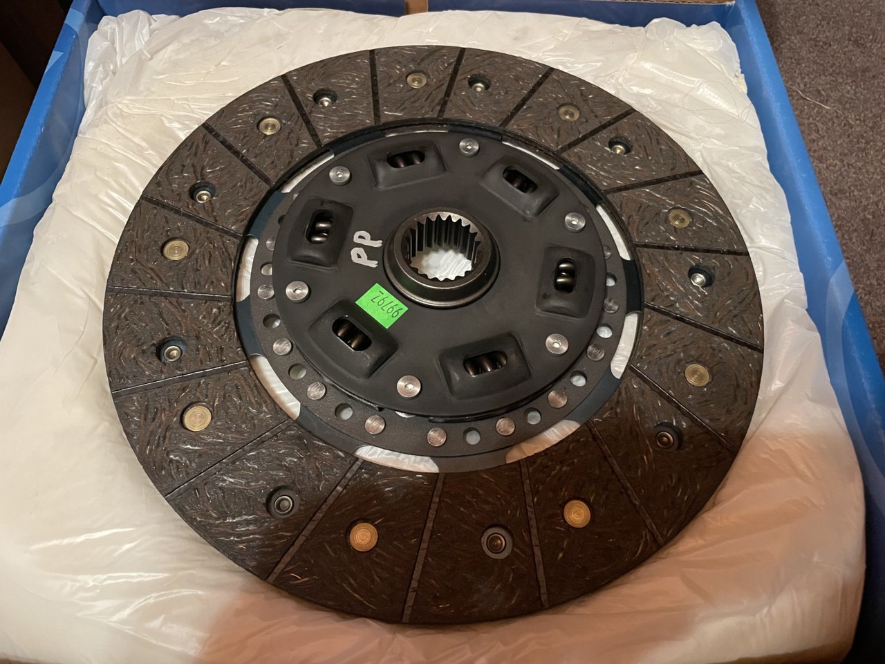

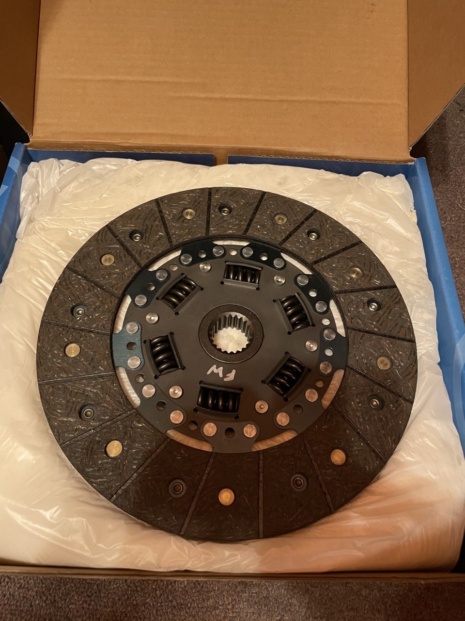

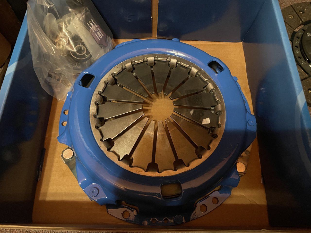

    Replacement clutch came in today. I have a LUK 16088 in the truck right now and I was not sure how long it’d hold up with boost. My old Spec stage 2+ as well as the LCE dual comp clutch I used to have both had very bad vibrations while accelerating and decelerating in specific rpm ranges, so im going to give this one a try when the LUK gives out. This is an M-Pact 16-094-ST1X from Rockauto. I have never heard of this brand, but it’s rated for around 300tq and has 2200lb clamp force, so decided to give it a try.

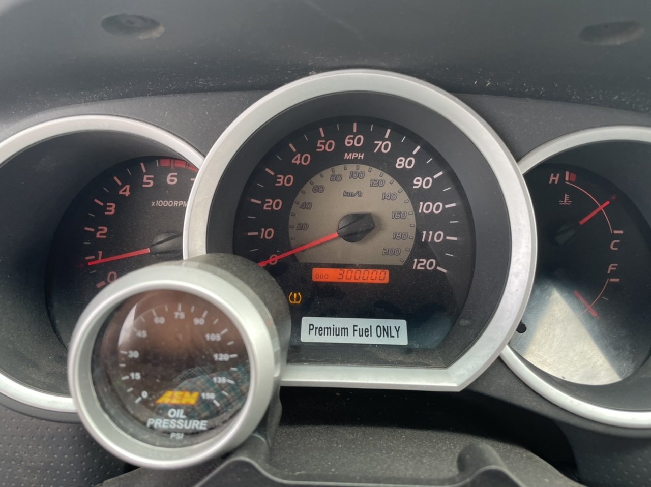

    Still running fantastic, nothing new to report, but did roll past 300k today

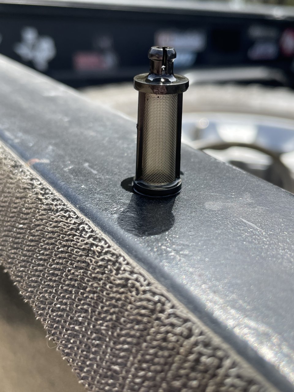

    In this photo, we had the vacuum routed to the incorrect port on the wastegate. It has since been changed to the front or top port.
    To confirm our conversation last night.
