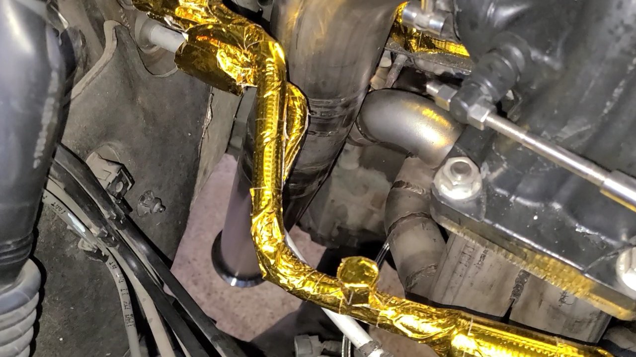

    Typically more towards the passenger side.
    However, it could self clearance. ;)

    You’re correct. I looked at this tonight and it does move about 1/4” or so when revving it. Hopefully it doesn’t do much more than that under load. I’m kinda concerned I am gonna be redoing that downpipe now

    Vice it. ;)

    An option indeed, but man it feels wrong to do that after spending so much time on it lol. I guess I’ll cross that bridge when I get there

    Wish that I had a better set of photos to share, than this. As a reference to yours.

    Damn, his looks super close to the ac lines and rear primary just like mine. This makes me feel a little better

    The picture doesn't really give it justice. Somewhere between a .5 - 1" of clearance.
    The plastic clamps, and the wiring loom were the most important to shield from the convection heat.
    On mine, for the added clearance, is where I welded on the bent right out of that plastic and cleared up a ton of room. Already sent you that picture though.

    I’m going to start wrapping stuff this weekend and try to get a better idea what I’m up against. I think I’m somewhere around the 3/8”-1/2” range for clearance on that ac line. I will check that though when once I have everything bolted up again.
