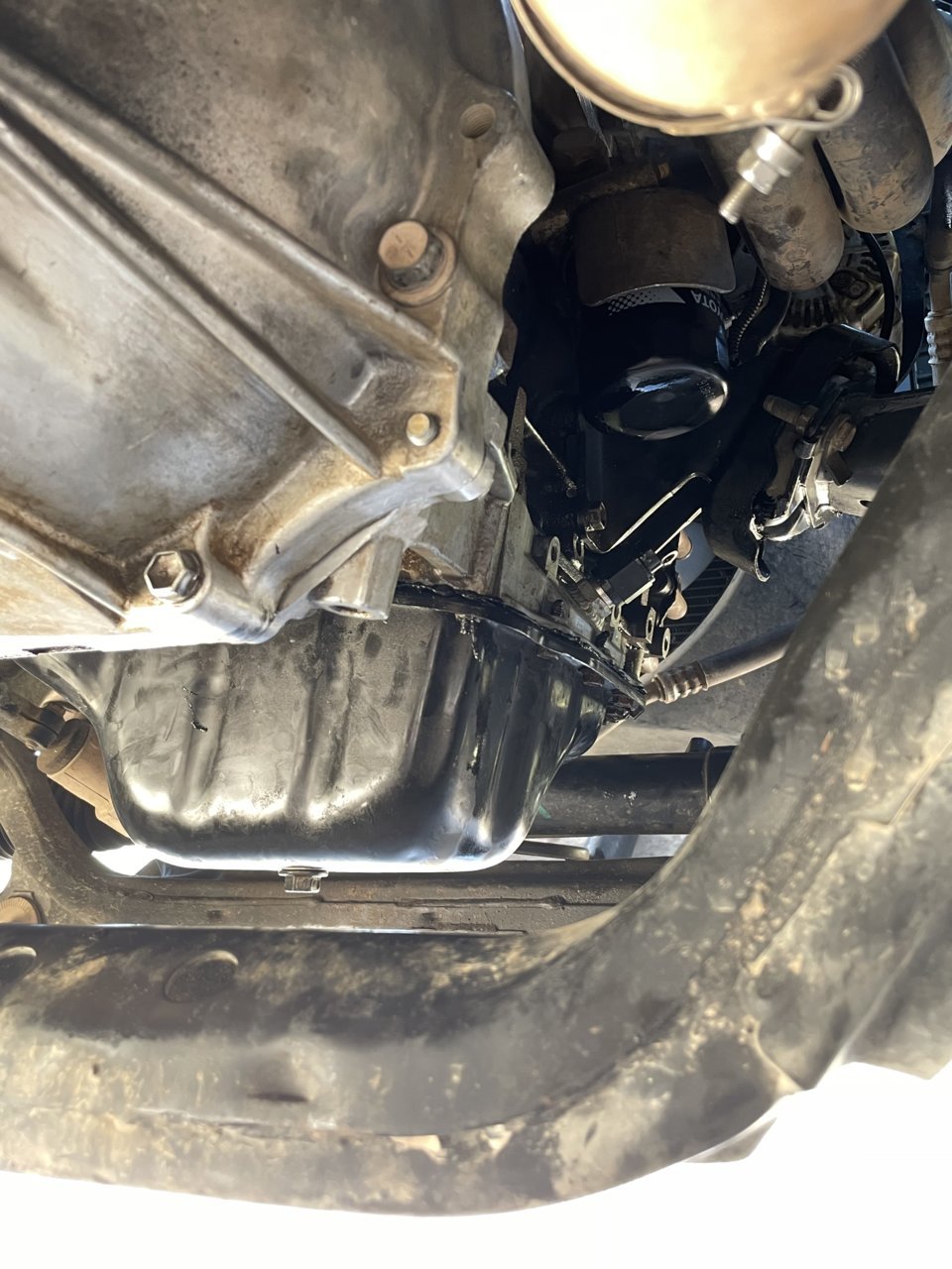

    Got the upper oil pan with the turbo drain swapped onto the 2009 engine today. Glad that one’s over with lol, not the most enjoyable job with the engine in the truck. Now I can move on to other stuff to wrap up the turbo project. Havent filled it with oil yet though, so fingers crossed it doesn’t leak.

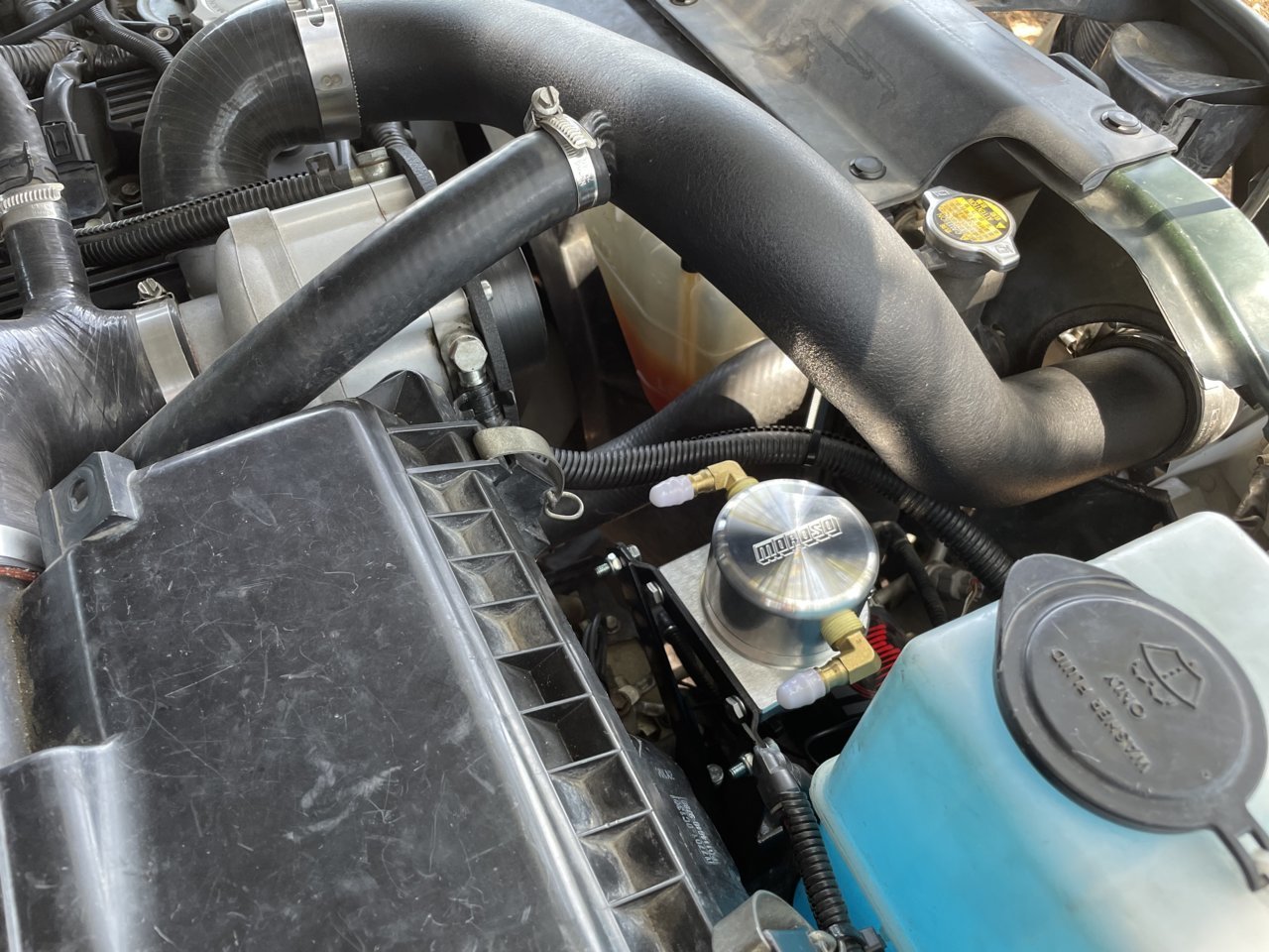

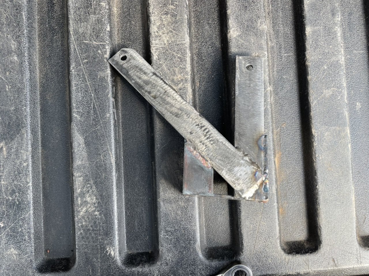

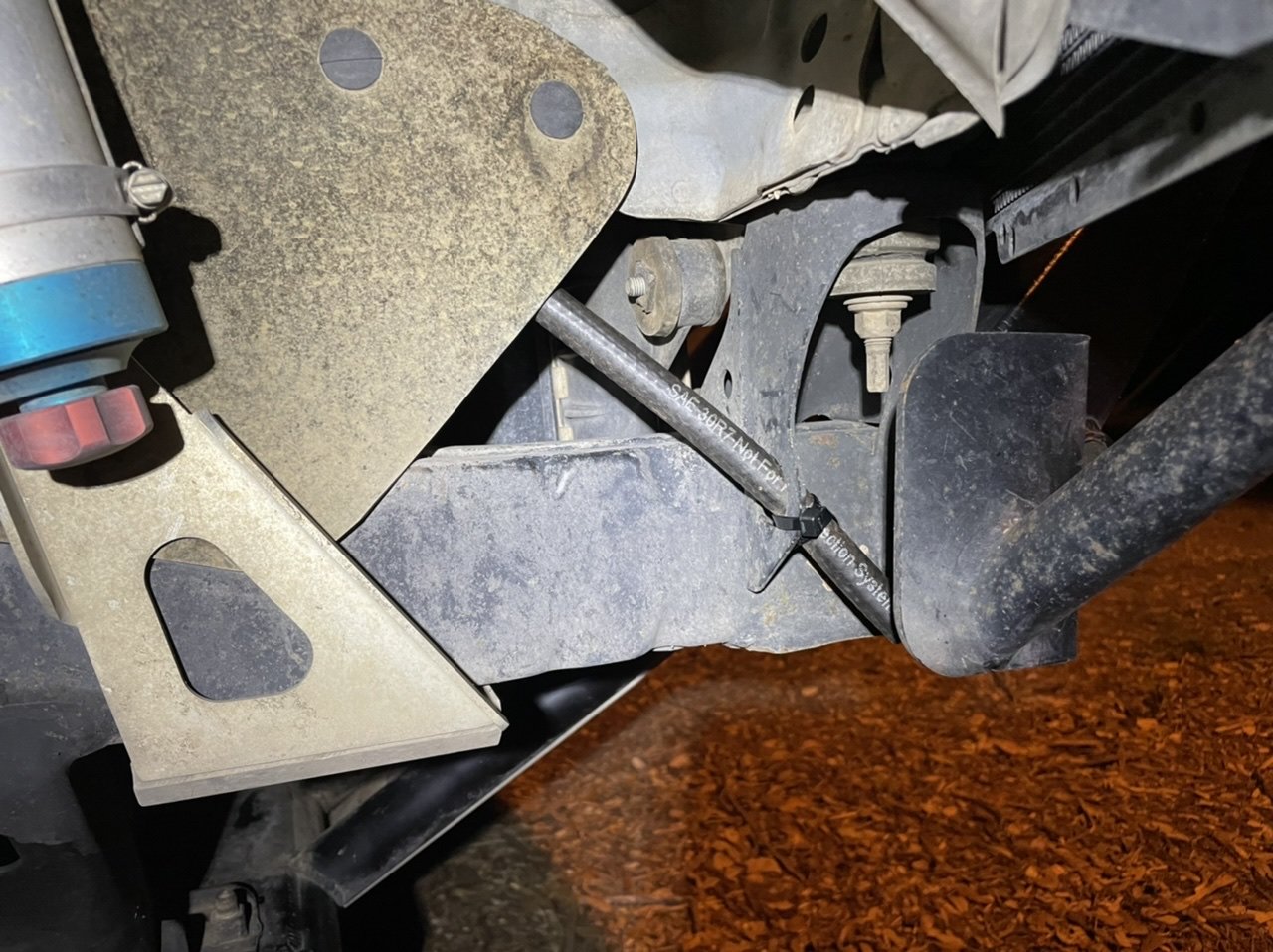

    Well I’m 95% of the way there with the catch can. Got the bracket built mostly but I need to add another brace to stiffen it up some. Fits good though and mocked up where the hose is going to run down by the bumper so i can flip a valve and drain it easily. Going to try to wrap the additional bracing up tomorrow and then repaint it.

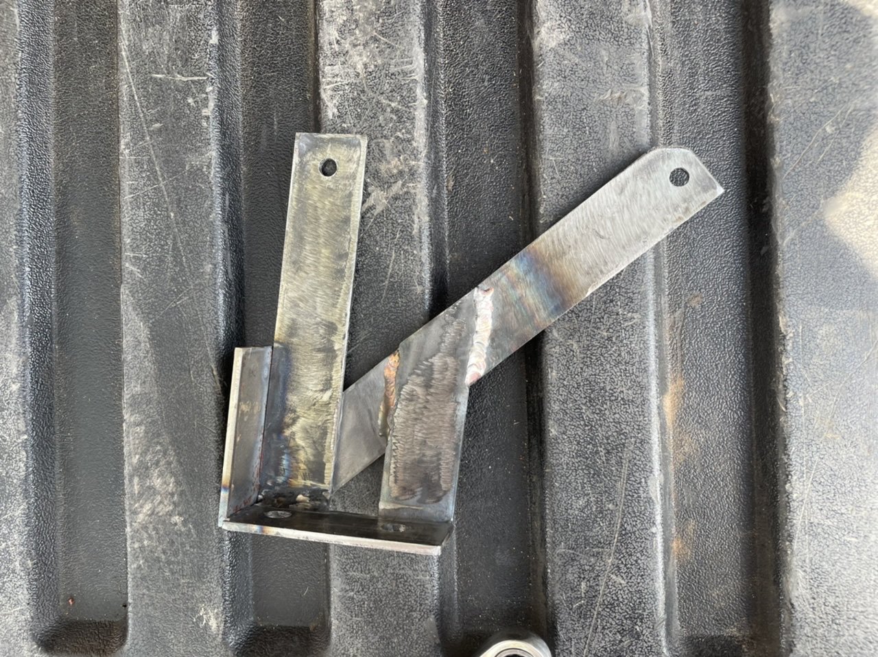

    Take two. Much sturdier now

    You weren't joking. That is a tight spot.

    Yeah space is a premium for sure. The stock air box will be gone with the turbo though so that will help some. Have to make room for that big air filter though

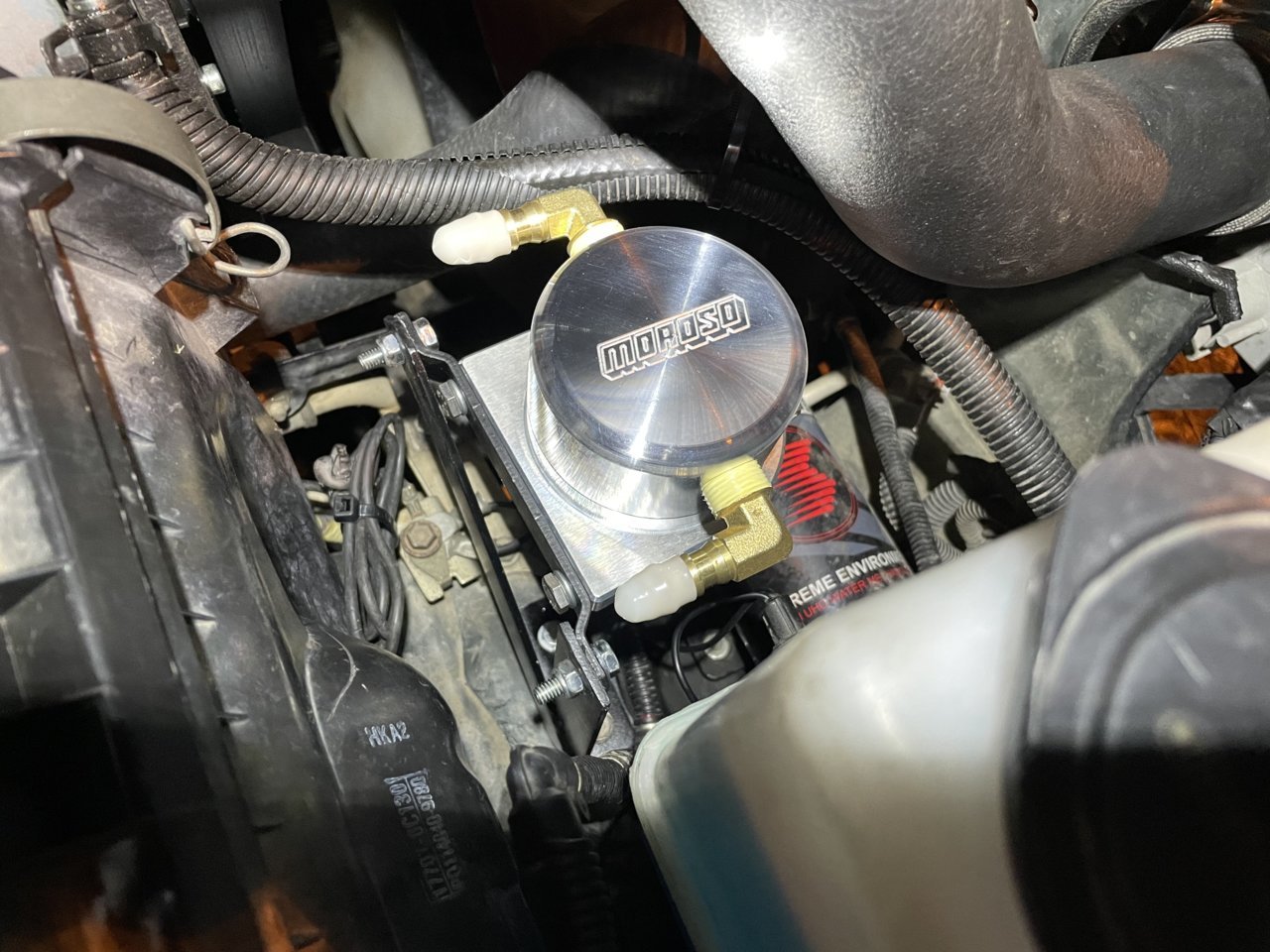

    Finished the bracket and mounted it on the truck today. Had to order a 5/8 to 3/8 brass reducer, but then I’ll be ready to plumb it up. Moving back on to the exhaust to try and wrap that up

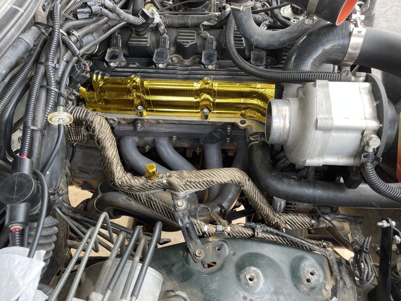

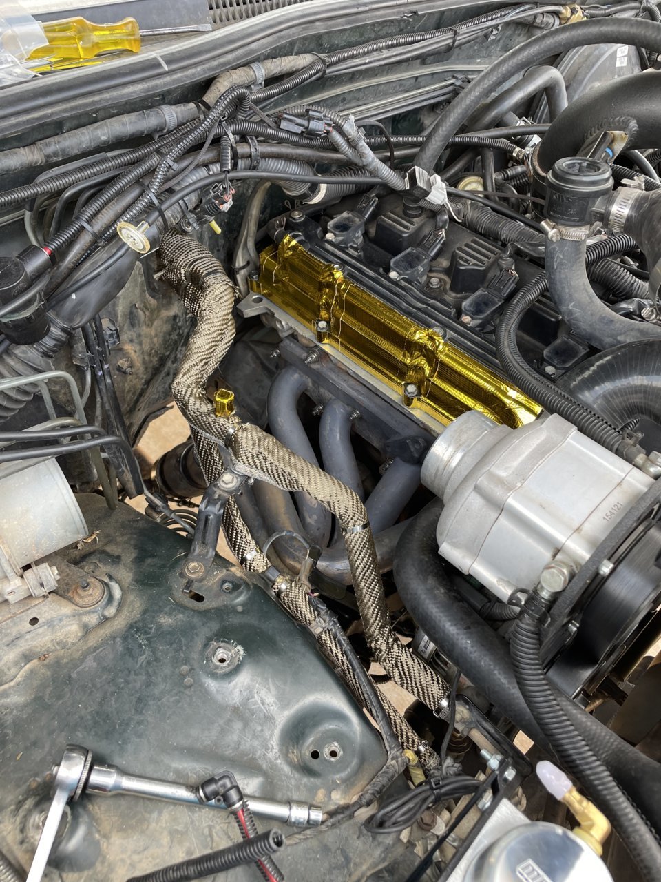

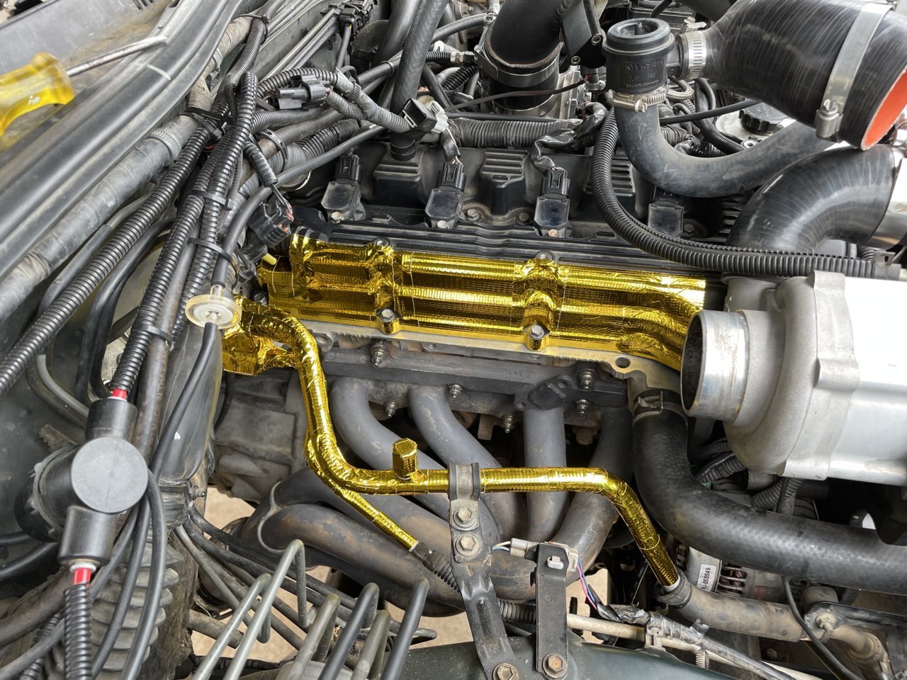

    Opted for some easier projects today. Started heat wrapping and prepping everything in the engine bay. Went a little crazy on the gold tape, but better safe than sorry imo. Then moved on to wrapping stuff in PTP lava wrap. I have a piece of that for the wire loom as well but im waiting till I redo the vacuum routing to do that. Coming along nicely though

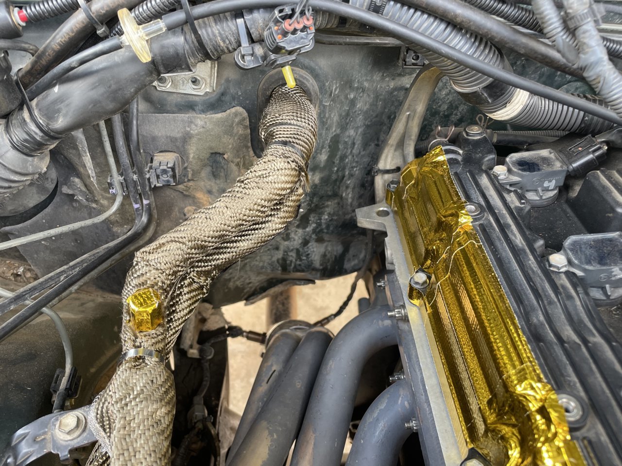

    That ABS plug's bracket, if it is too close to the heat, drill a new hole in the bracket to scoot it away from the turbo.
    BassAckwards[OP] likes this.
  17. May 30, 2022 at 11:46 AM
    #3537
    BassAckwards
    BassAckwards [OP] Well-Known Member
    May 3, 2016
    #186002
    27,954
    2009 Tacoma AWD Turbo 2TR-FE
    Full-time AWD & BorgWarner EFR 6258
    Good spot, I will make sure I look at this next time I have it apart for mockup. I’m not sure how close it sits to the turbo

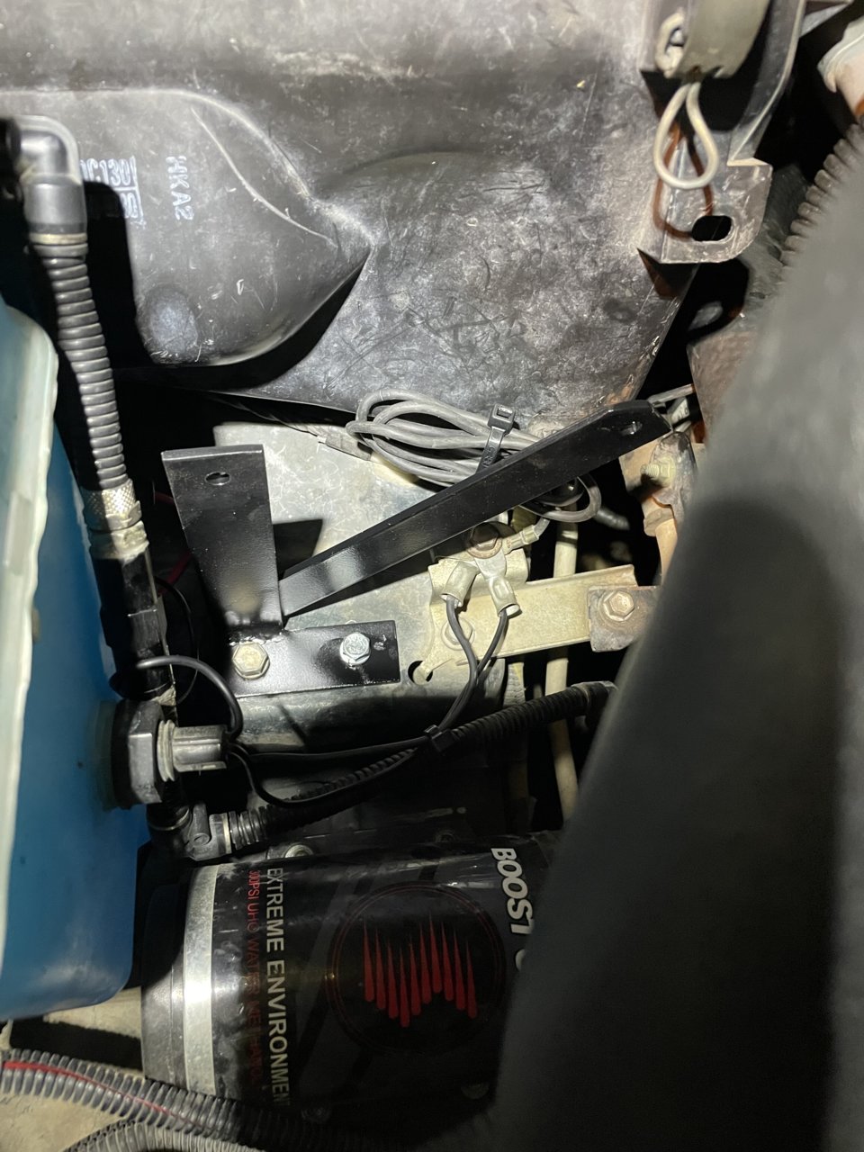

    Here’s a better angle, looks like it needs to move away from the collector
