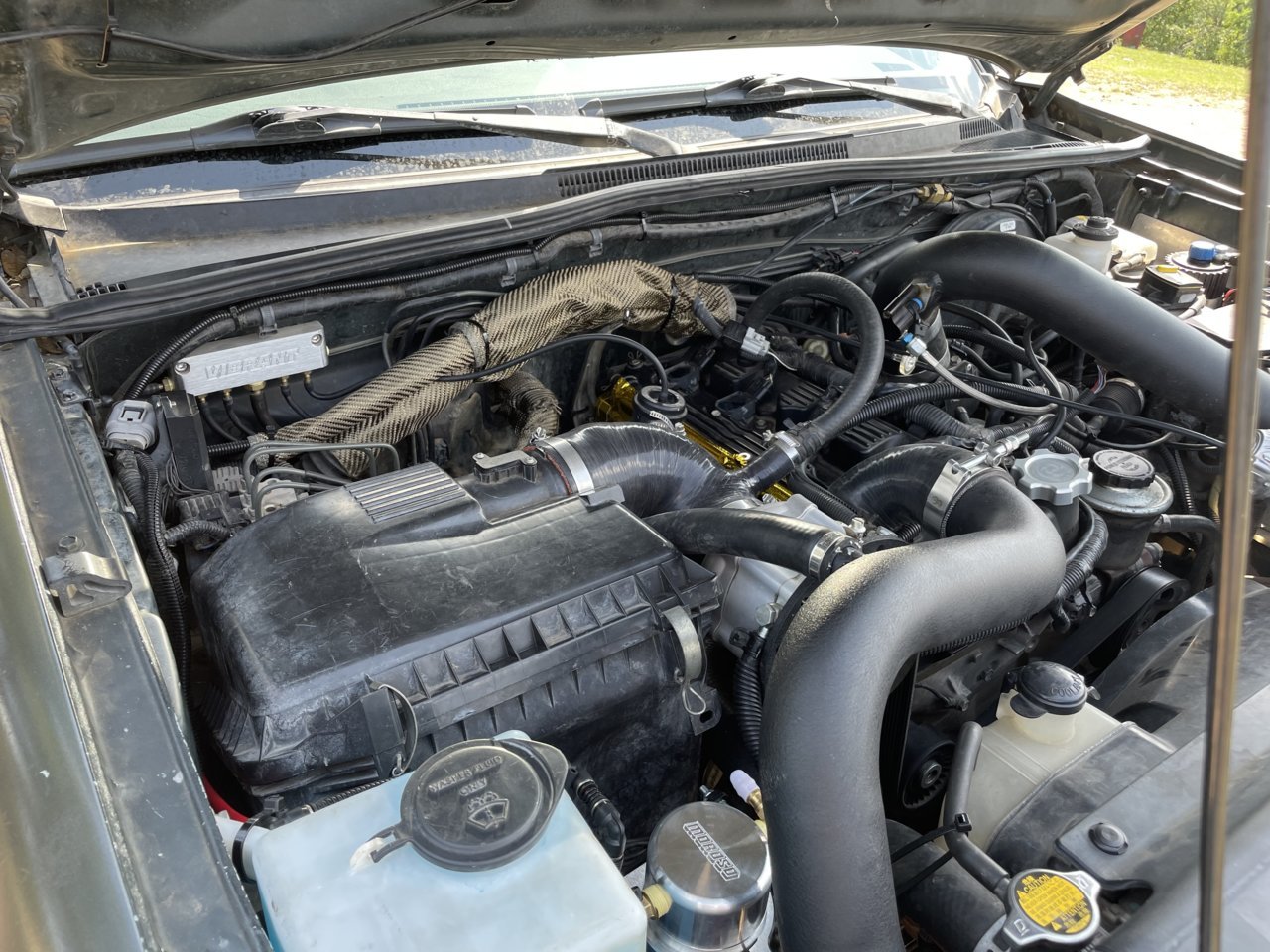

    May I ask if the gold tape has any insulation on the backside or is it just tinfoil, gold tinfoil?
    Also may I ask where you’re got the "PTP lave wrap?
    I found some gold insulation tape / covering with velcro in a few sizes on Amazon.
    Thanks!

    This is the reflective gold tape I used. Good for up to 500*F continuous operating temps. I am not sure how it’s made up, but it feels like some quality stuff.
    https://www.ptpturboblankets.com/co...rs/products/ptp-gold-adhesive-thermal-barrier
    here’s the lava wrap I was referring to. My mistake it is called lava heat sleeve
    https://www.ptpturboblankets.com/co...n-sleeves/products/lava-heat-sleeve-hook-loop

    Ok, one more question what size did you use around the AC lines?
    Oh, in case you didn’t know this is what the gentleman who purchased our 2015 did with it. God I wish I had the funds for this kind of stuff!

    1/2” on the small ac line and 3/4” on the big one. Then near the firewall on those plastic clamps, I wrapped that with some 2” wide exhaust wrap of the same flavor. Tied it all in place with stainless zip ties from harbor freight

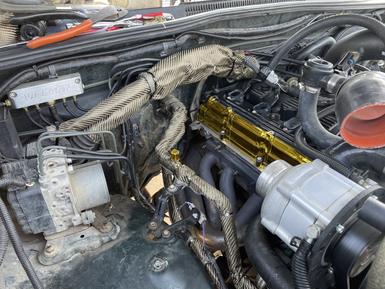

    A little more progress. Wrapped the main wire loom and a few accessories as well. Also ditched the stock wire loom plastic clips and moved the loom up above the bracket that holds them. Still have some minor stuff to rework but I’m stoked to have the vacuum lines and everything tucked away
    All back together and ready for daily driver duty:D

    I was going to mention that about the loom clip. :thumbsup: Nice and tidy now.

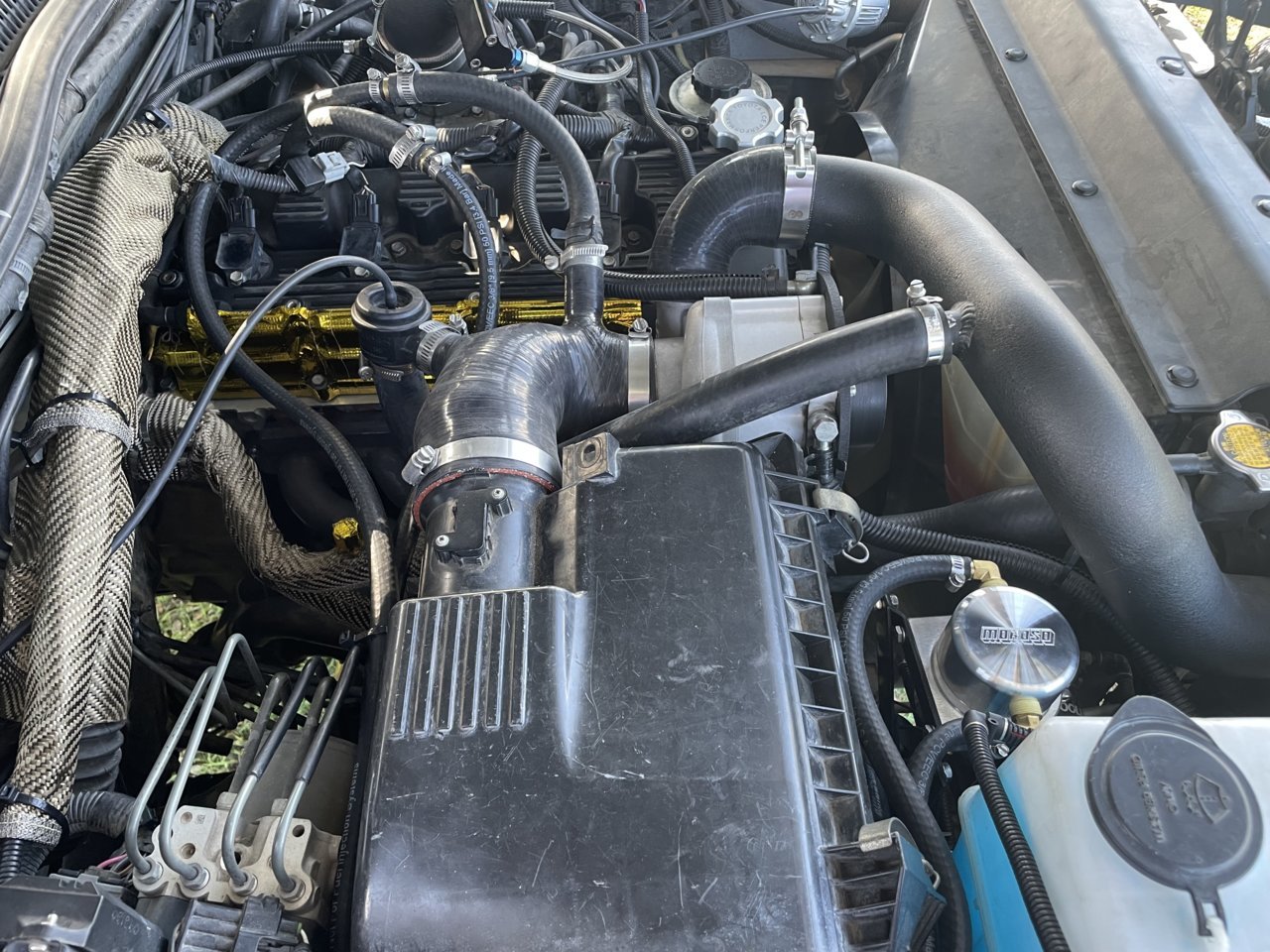

    Got the catch can plumbed to the sc setup and no vacuum leaks. Very happy with the final product

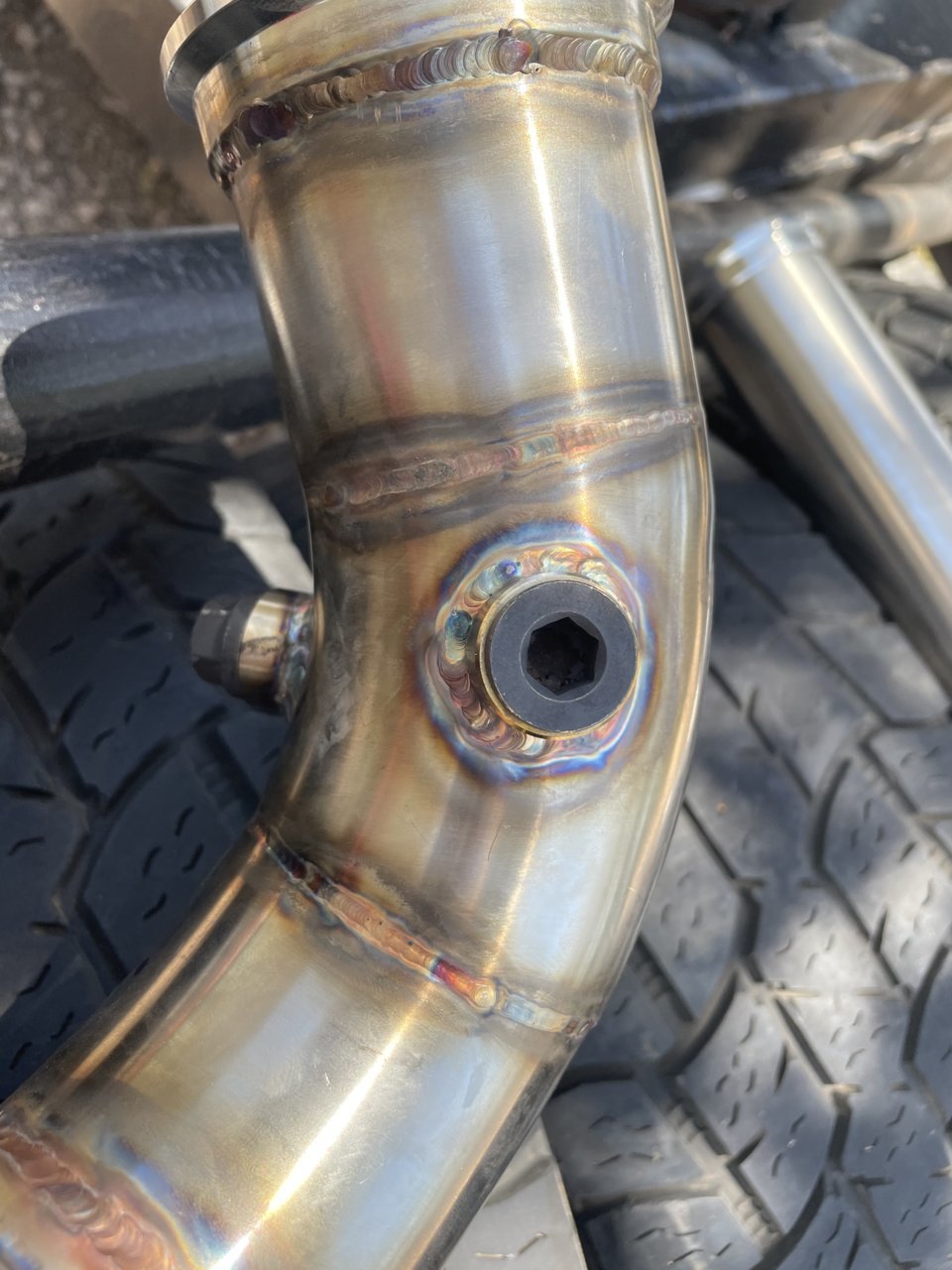

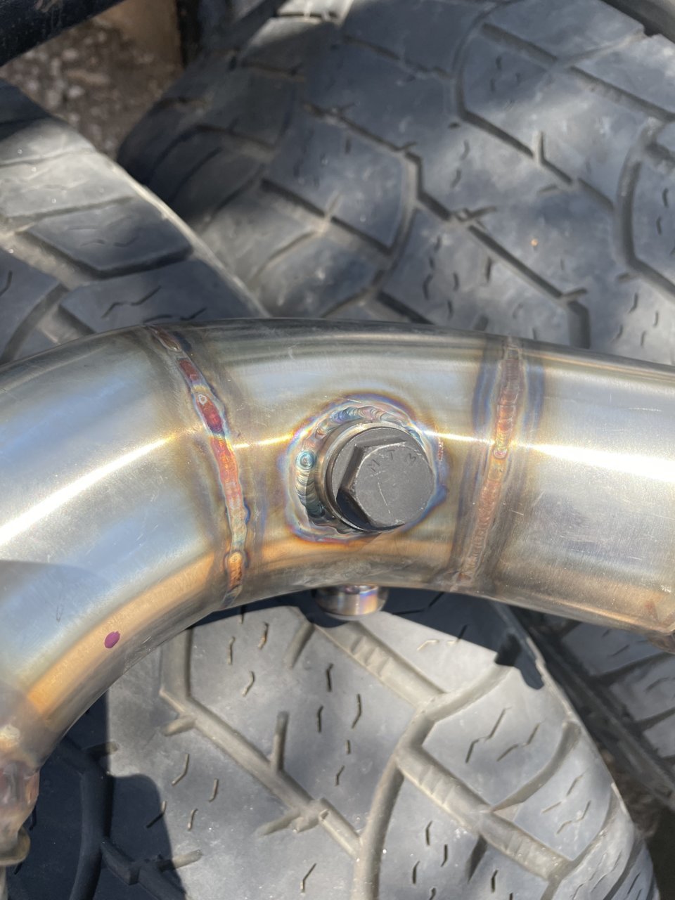

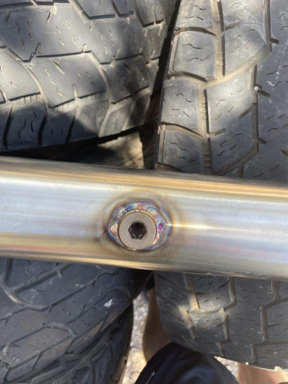

    Downpipe is finished. Got O2 bungs added to that and the mid pipe and also built a hanger for the midpipe. All that needs to be finished is welding up the rear v-band flange, but final fit went well.

    Now I really want to see how your system performs compared to the Magnuson 2TR. With the ~7psi spring in yours.

    Man you're getting good at this welding thing!!

    Robert may I ask if you are purging the inside? To tell the truth IDK why exhaust is purged.
