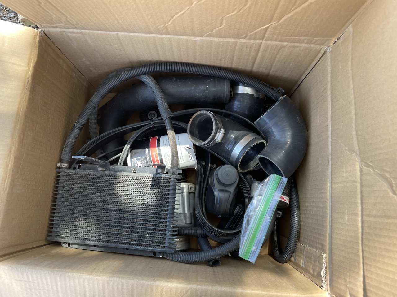

    Replaced the last bit of silicone from the URD kit today. Got this from intakehoses.com. It’s about twice as thick as the stuff provided by URD. Speaking of which, I will have most of a URD sc kit up for sale soon if anyone is interested. I am still using the MAPECU3, driver side charge pipe, and intercooler, but everything else is there. And actually the MAPECU3 and jumper harness will be removed soon too if all goes as planned. FB731ED0-9295-4C74-8FA9-4801C7843305.jpg

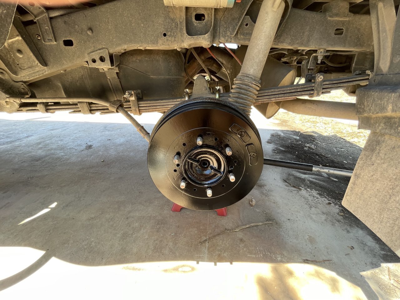

    Started this morning removing the 1” aluminum blocks. I wasn’t happy with how high it sat out back, so back to just the 1.5” aal. Also took the wheels off the back and cleaned up and painted the drums black yesterday.

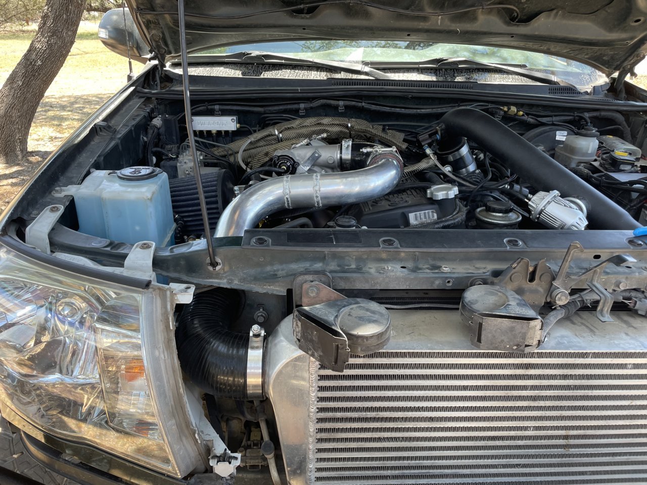

    Here’s what I’ve got currently. Rotrex c-30-94 with about 35k miles, URD sc bracket & mounting hardware, two belts, stage one and two sc pullies/idlers, quart of sx-150, filter recently changed, hayden oil cooler, Rotrex oil reservoir, silicone couplers, bypass valve, and passenger side charge pipe.20496905-85B6-408D-B350-A1AC0F7461C4.jpg

    I was thinking about painting my drums. What did you use for that?
    Also great work yet again.

    Thanks amigo! I used just regular rustoleum semi gloss black for it, so we’ll see how it holds up to the heat. Had to clean them up quite a bit as they were rusty

    Being that your turbo has a BOV, you could put that charge tube in the box as well. Just make your own charge tube.
    As that charge tube has the provision for the 5th injector, which will no longer be needed in the near future. Which would make for a more complete kit to pass along.
