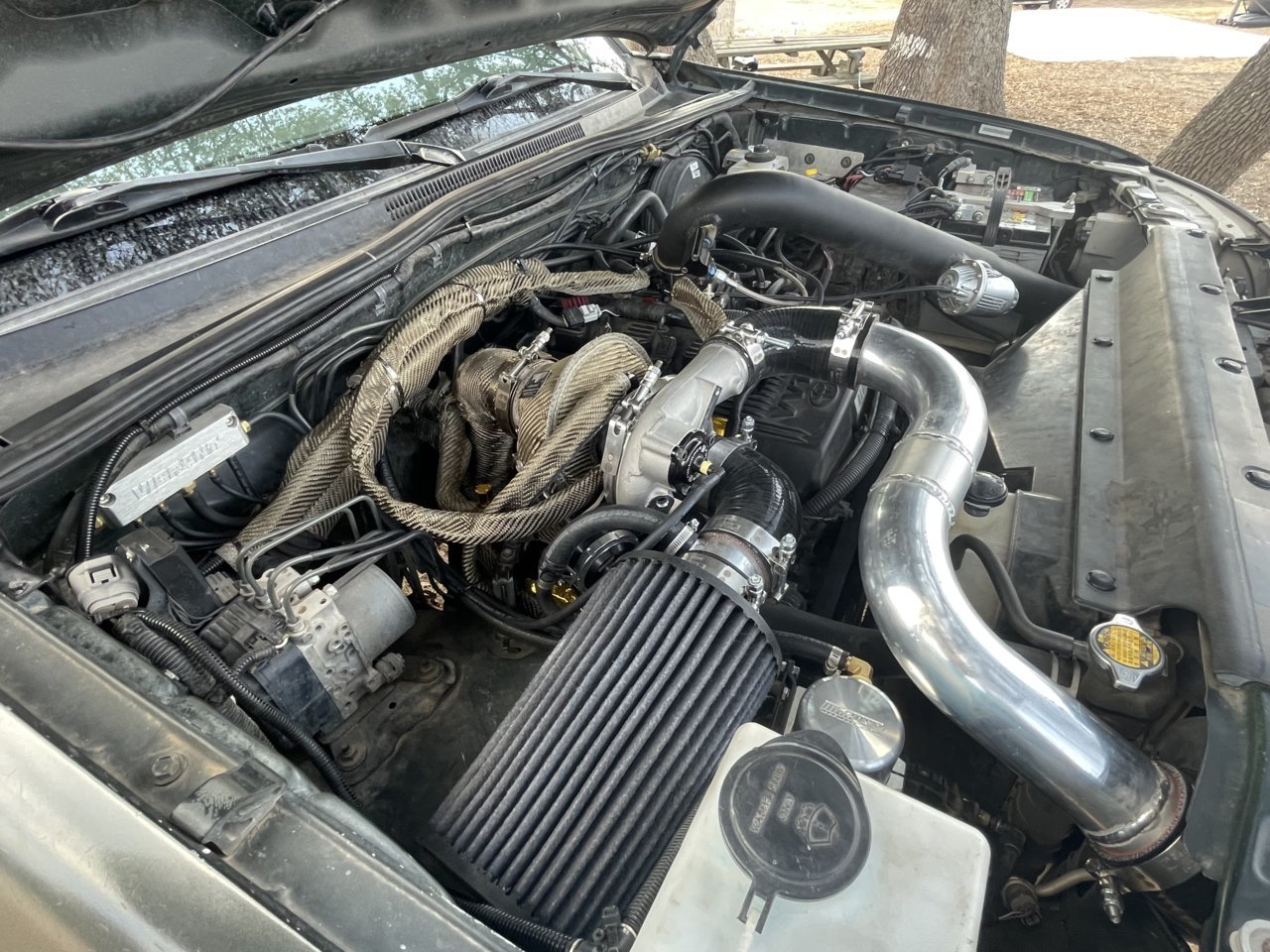

    I may end up doing that if I can find a flange for the MAF and the appropriate sized piping. I would like to eliminate the 5th injector as well so building a charge pipe would take care of that. Then like you said, whoever gets it would be that much closer

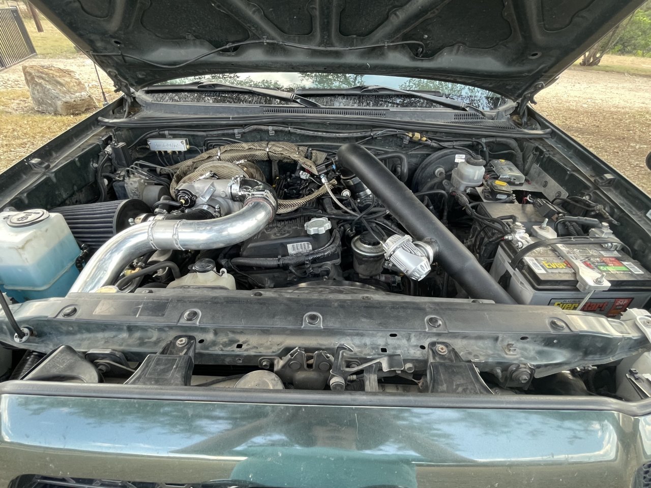

    Installed a PTP turbo blanket today for the single scroll BorgWarner (which is what the v-band housing calls for per PTP).
    Due to the way I had to clock the center housing, it’s rubbing on the wastegate actuator arm a little, but i threw it on anyways and we’ll see what happens. May end up trimming it later on if it starts causing issues.

    Leave the Maggy. Just pull the header and swap on a turbo. Twin charged FTW! (Then immediately build the engine.)

    I bet your IAT'S just dropped with that on, and your engine bay thanks you.

    I’m hoping so, they tend to climb quickly when im not moving, so maybe this will keep that from happening as much

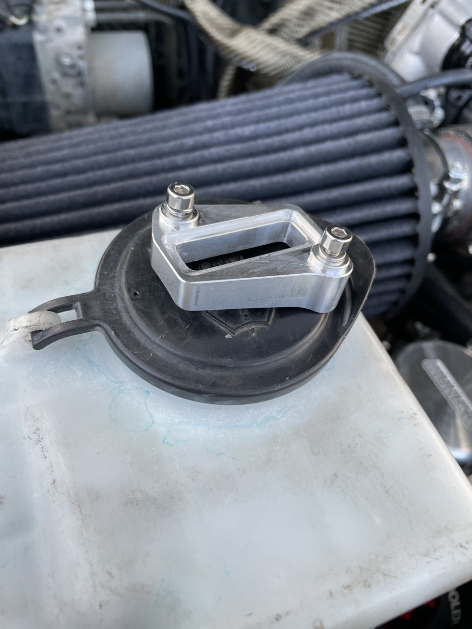

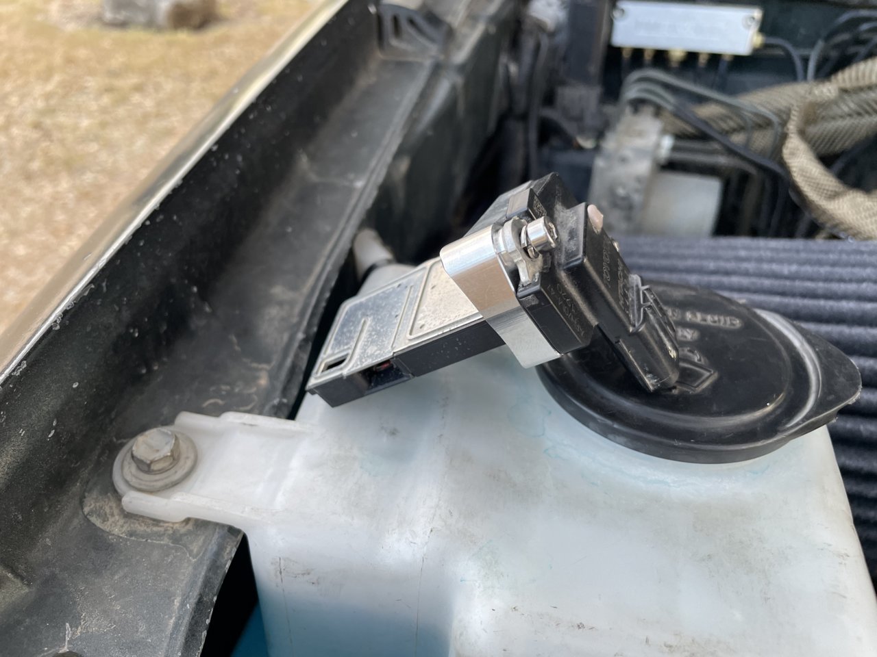

    Ordered a flange from MRP performance for the MAF sensor for a 5.7 tundra and it’s going to work perfect for the 2TR. Got some 2.75” aluminum piping and bends on order and I’m waiting on the 1/8 NPT bung for the water methanol nozzle. Then it will be time to fab up a cold side charge pipe.

    I’m sure you know more than me! I thought where the MAF sensor is installed is smaller than the rest of the intake tube? I remember reading it has to be a certain size for the air volume that flows pass the sensor. The intake tube on my supercharger is 2.75” OD. LCE used a piece of steel tubing. I swap the steel for Aluminum. One evening after a drive I pulled into the garage open the hood and leaned into the engine bay I placed my hand on the aluminum intake tube and almost burned my hand. I yelled out some F bombs! Now I have a piece of silicone tubing. I hope the silicone doesn’t heat soak like the aluminum and or steel. I swear I size of the pipe / tube where the sensor is, is smaller than 2.75”.
