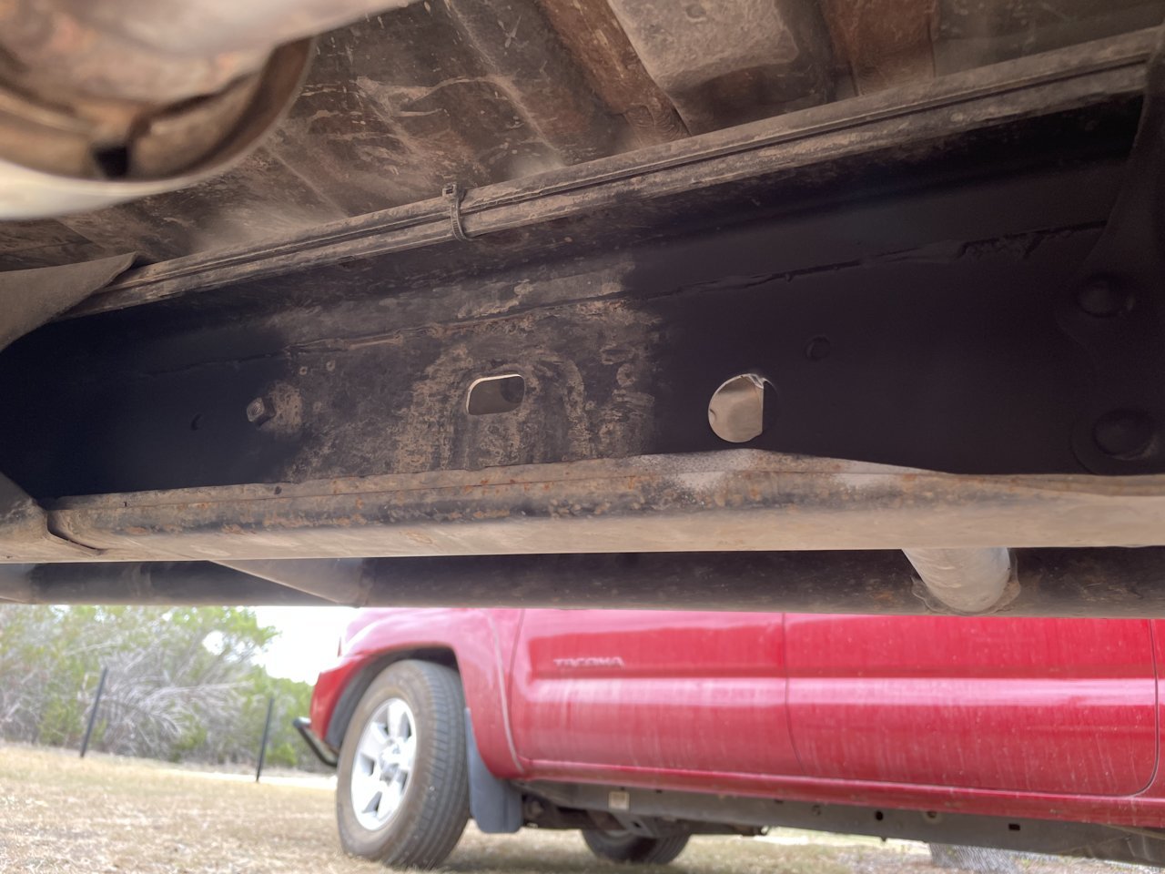

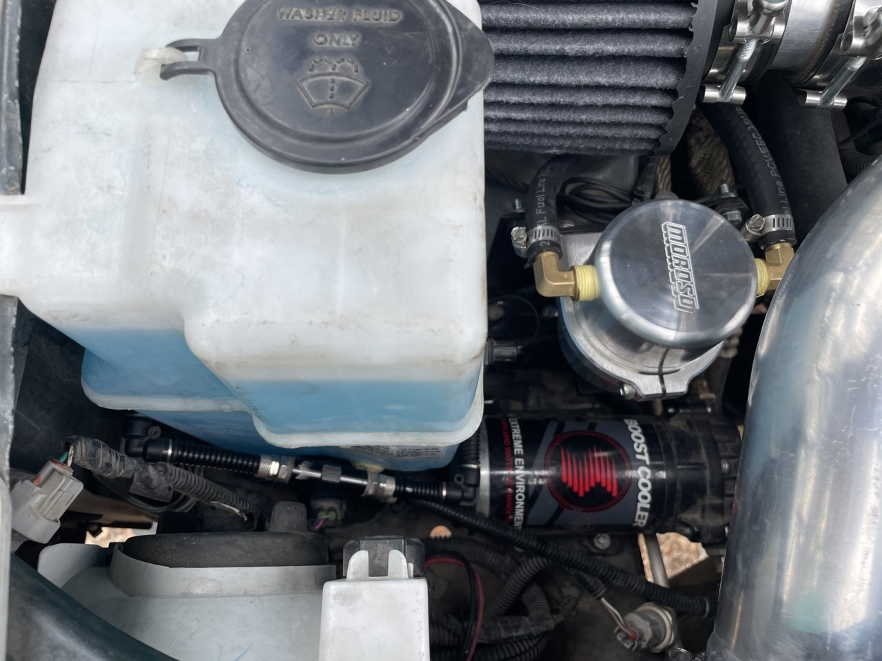

    Rerouted the water methanol tubing, and added the inline filter back that I had taken out at one point. Turned out much cleaner than I had it previously running it up near the back/top of the washer reservoir. It now runs behind/below it and is tucked away out of sight for the most part
    Also took a little time and cleaned up some surface rust on the inside of my frame rails where the sliders were welded on. Hit it with some primer and flat black rustoleum.

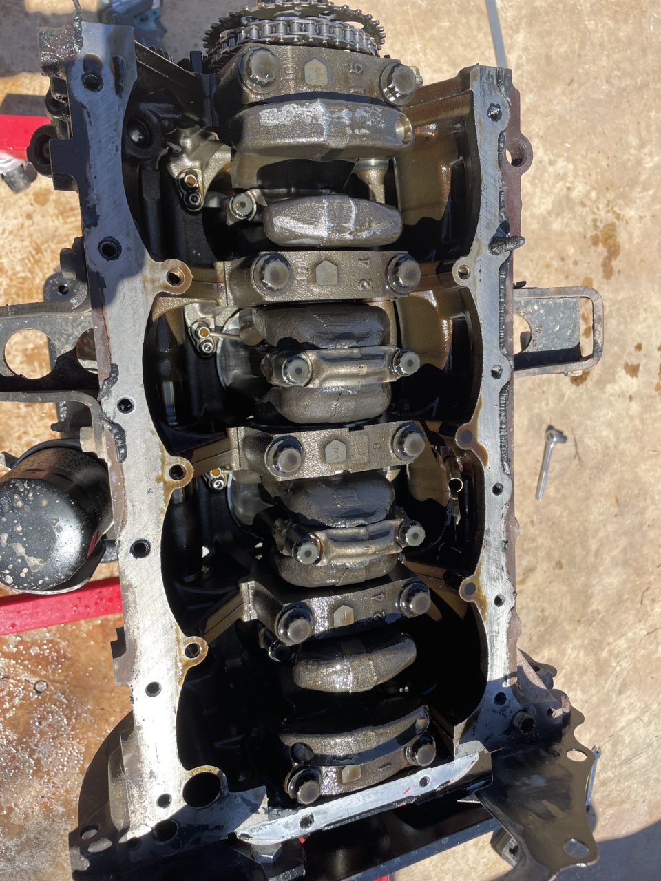

    Yeah there definitely is way more aftermarket support for the 2RZ/3RZ. We’ll see if the 2TR ever comes around in that regard over here in the US. I think they have tons of potential, but that’s just my opinion.
    oh and the 2TR has oil squirters as well, here’s a pic of my old short block. You can see the one in the top of this pic on cylinder one is missing. And hey man it’s all about the journey! It sounds like you enjoy cleaning things up and making them 100% again. You’ll have that thing turned around in no time:thumbsup:
