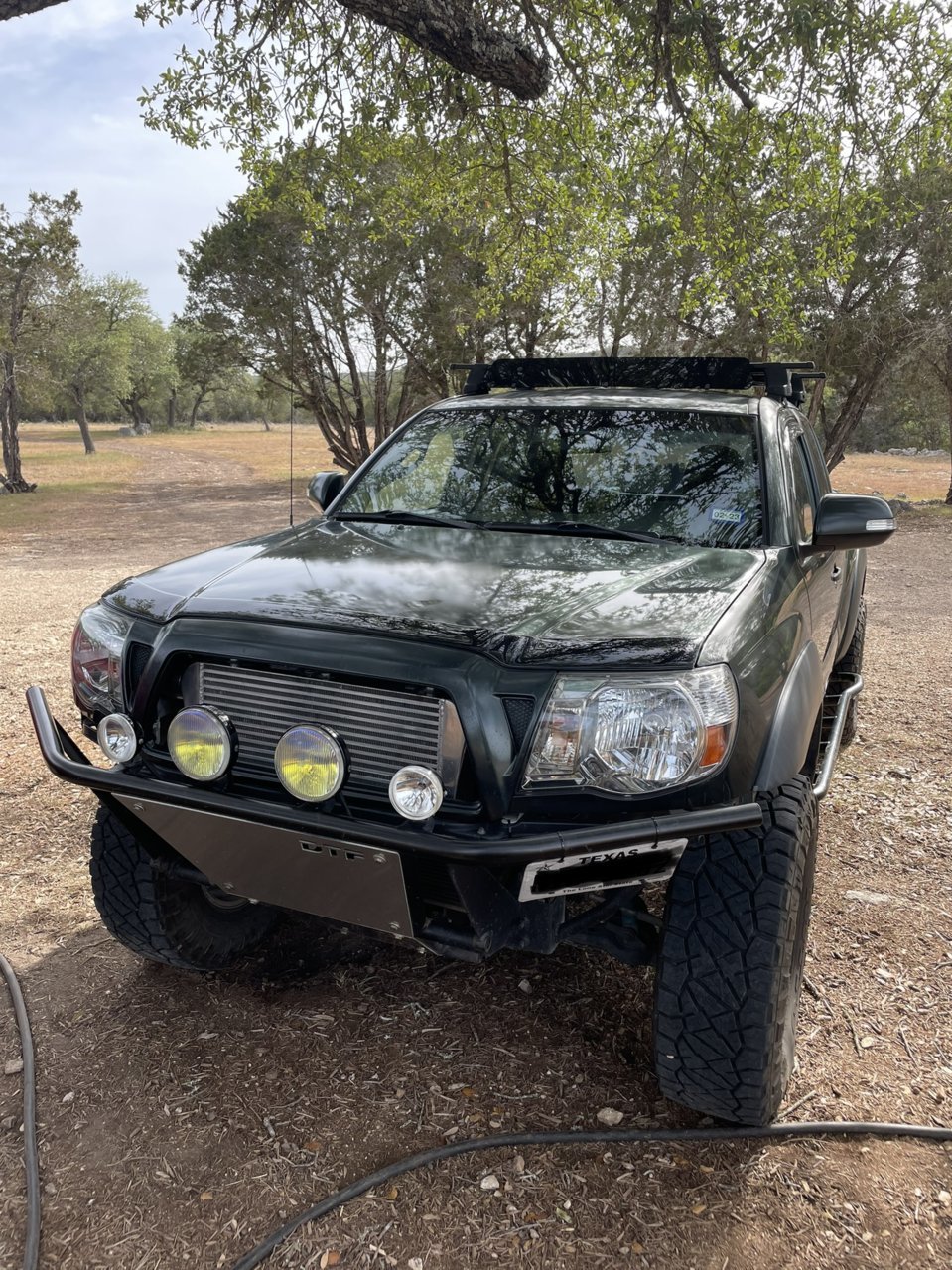

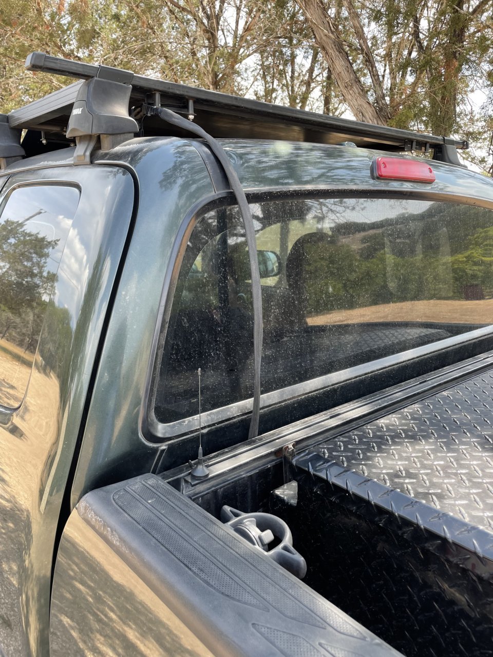

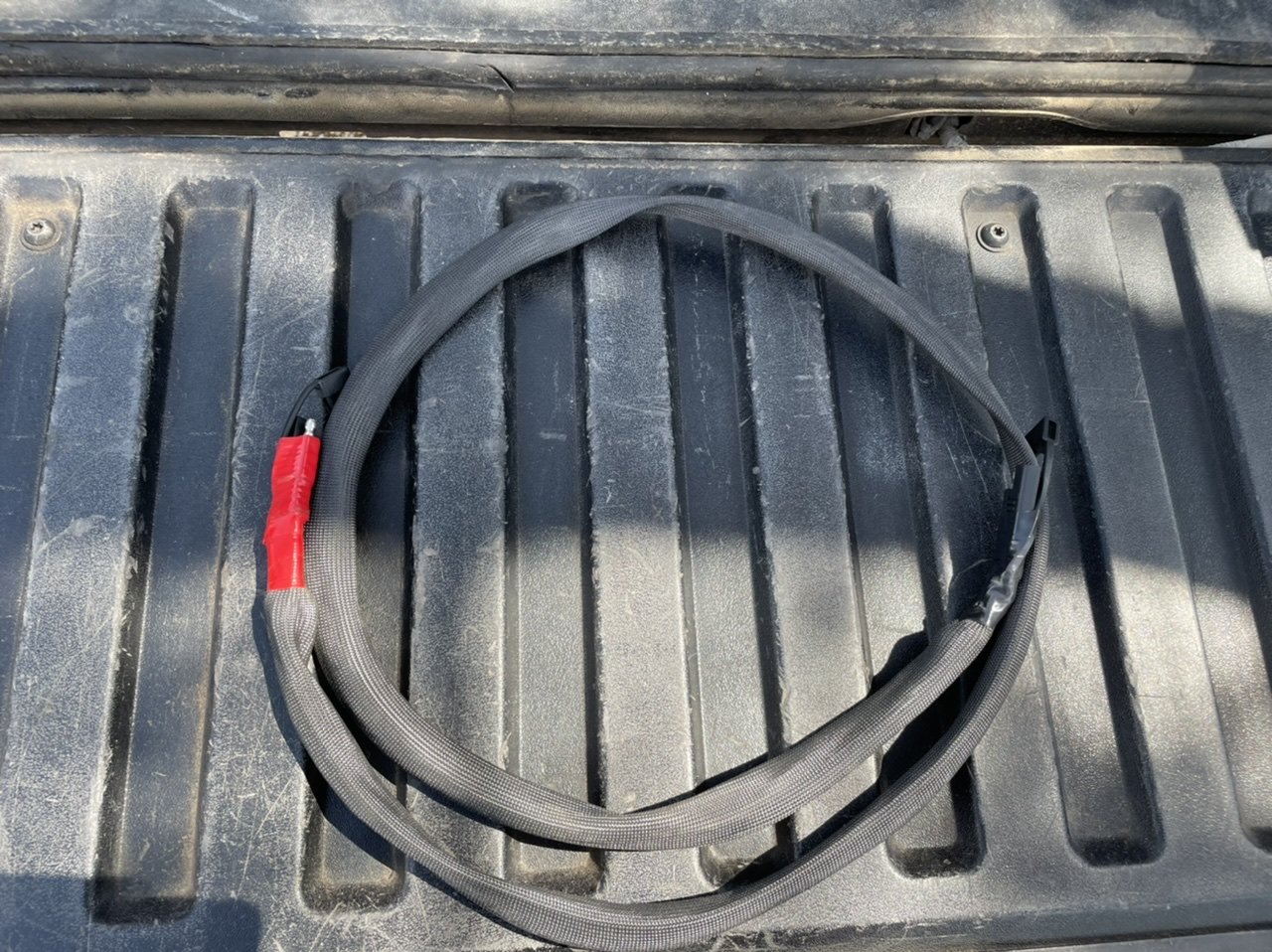

    General update for a few projects I’ve been doing here and there lately. Made a quick disconnect for my solar panel using some thicker plugs used typically for trailer harnesses. That cleaned up the ugly wiring running down the rear window quite a bit and now I can take it off completely if I don’t need it. Also wrapped it in a some fiberglass sleeve to clean it up more.
    Then I started pulling everything off the truck I could to save weight. Started with the camper, basket, grille, and metal cap I used to have on top of the tailgate.

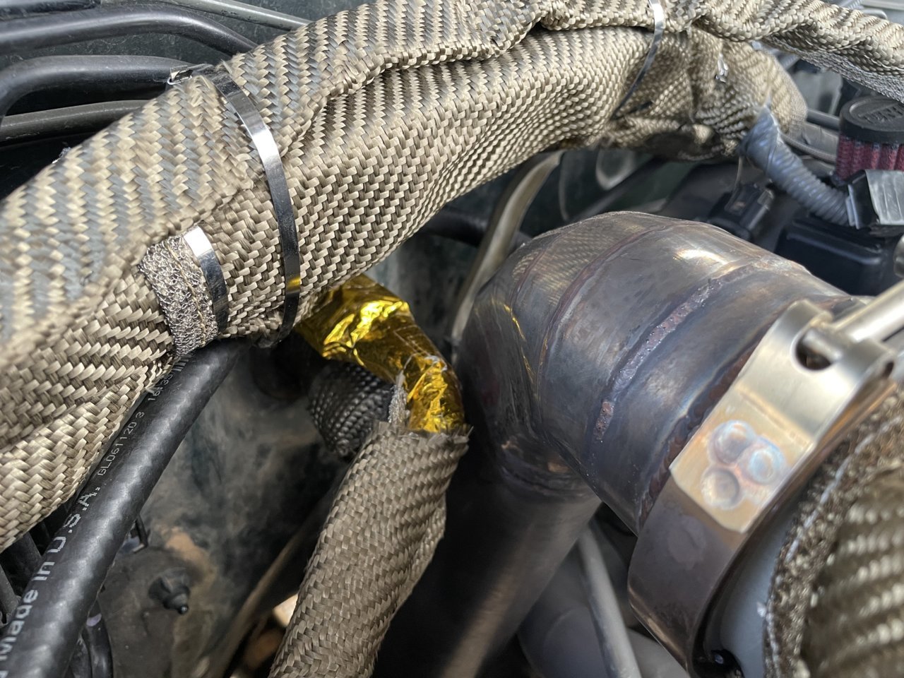

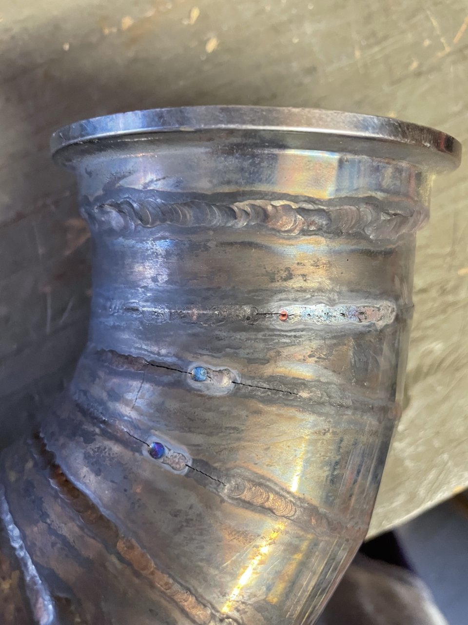

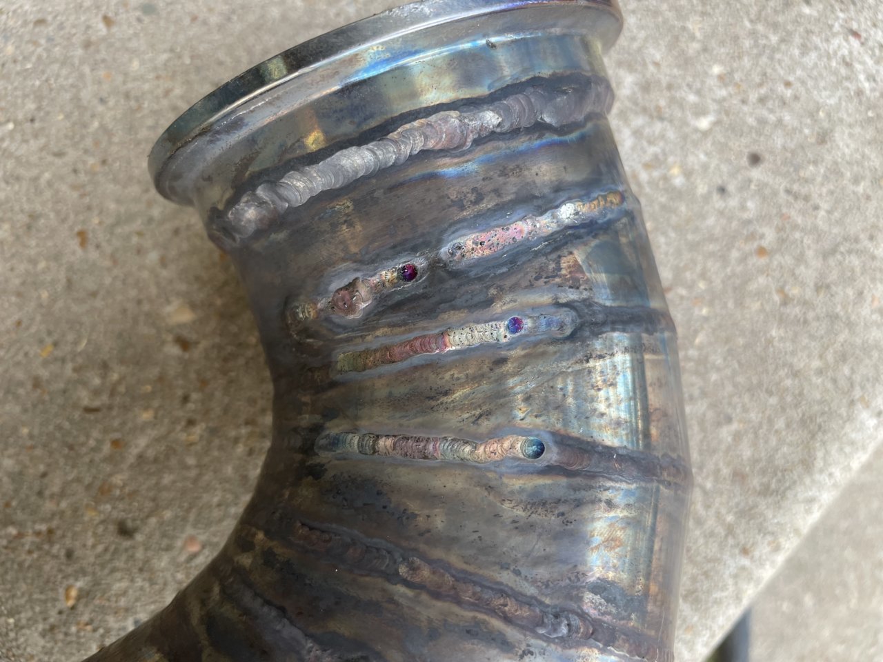

    Today I worked on getting some more clearance for the downpipe near the ac lines. It has been rubbing on that slightly which was mainly happening when releasing the clutch in first gear. I nearly rubbed through the ac line, but caught it just in time. Started hammering on that, and it cracked on the other side in three or four places so I welded that back up and wrapped the ac line where it had rubbed through the heat wrap/shield. I need to order some more heat wrap, but the truck is back in business now.

    Got to feel a lot lighter now, and much more responsive too!

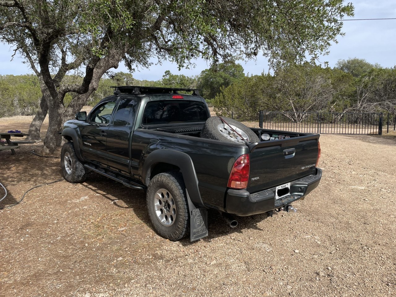

    Definitely feels better without all that crap on it haha. I weighed my spare wheel by itself the other day and it’s 29lbs so those are on the chopping block now too as much as I like them

    Hey there Randy, thanks for the suggestions! I did remove the rear head rests and one of the seats, but I have a platform for my fridge where the seat used to be. I may pull the other seat out today though as I rarely use it.
    i do tow on occasion so the hitch and the front bumper are here to stay.. wheels and tires for sure though once these tires wear out, and I probably do have a bunch of stuff in the tool box I don’t need. Thinking about a lighter battery as well

    No need for that amigo, i appreciate your input. I’m gonna be trying to keep this as light as I can since there are things like the sliders, bumper and hitch that have to stick around. So I’m going to try and shed weight in other places. Thinking a carbon fiber hood will help as well. Probably gonna do that and swap back to the 12-15 front end

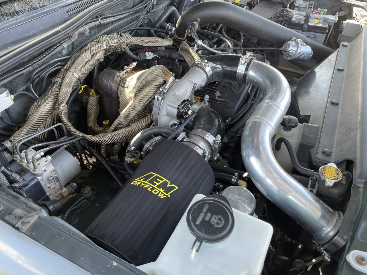

    Added an AEM pre-filter today since I drive on a dusty road everyday. Also pulled a bit more weight off the truck last weekend. Ended up taking out the toolbox & tools (~100lbs), bed mat (29lbs), spare tire/wheel (95lbs), n-fab tire carrier (~20lbs) and the receiver hitch (~50lbs) as well. The truck is definitely super light out back now, but im also down to around the 4,150lb mark, so its progress from where it was.

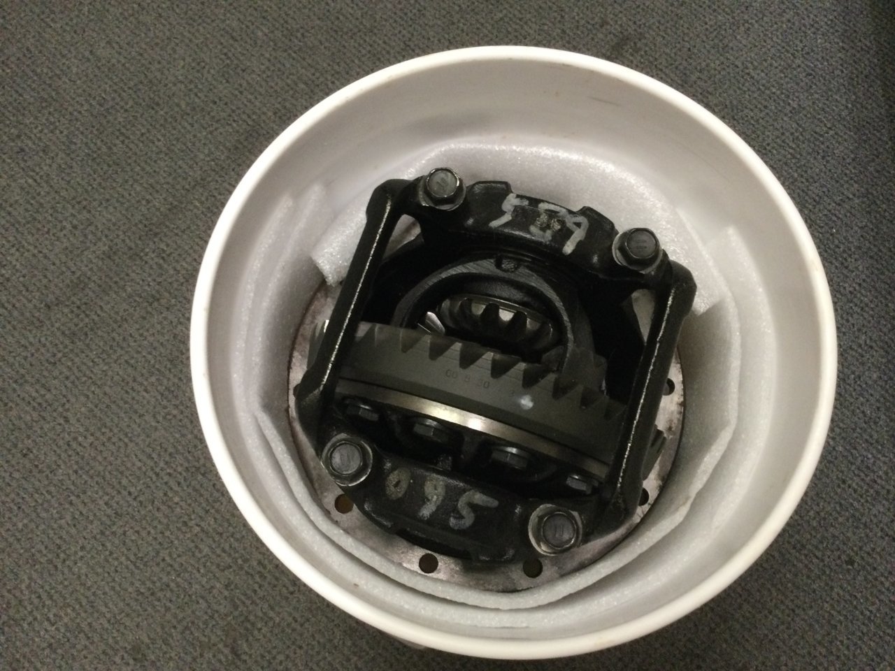

    Sir,
    I know you are now an 4x4 but I have a factory 4.30 setting in a 5 gallon bucket so I have no idea if you could use it. I’m pretty sure it’s from a 5.4 Tundra with the tow package and have no idea if you can find a matching front. I don’t know the history on this 3rd member but it has very little wear on the gears. Just an FYI…

    I will shoot you a PM about this!
