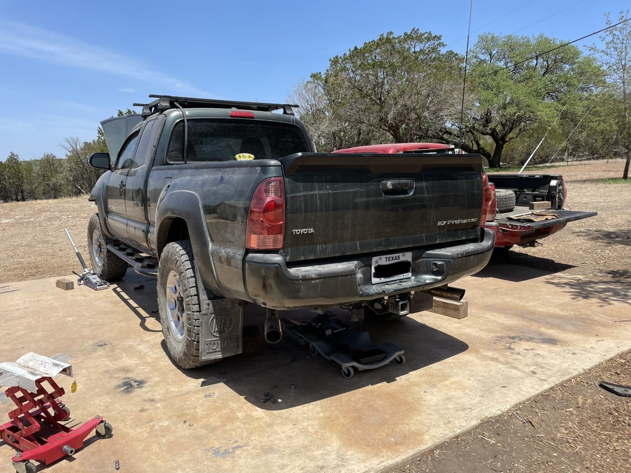

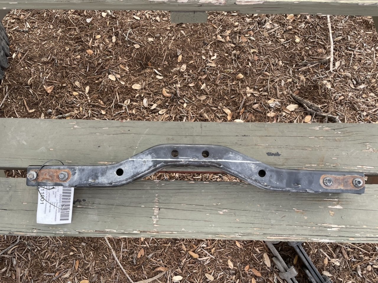

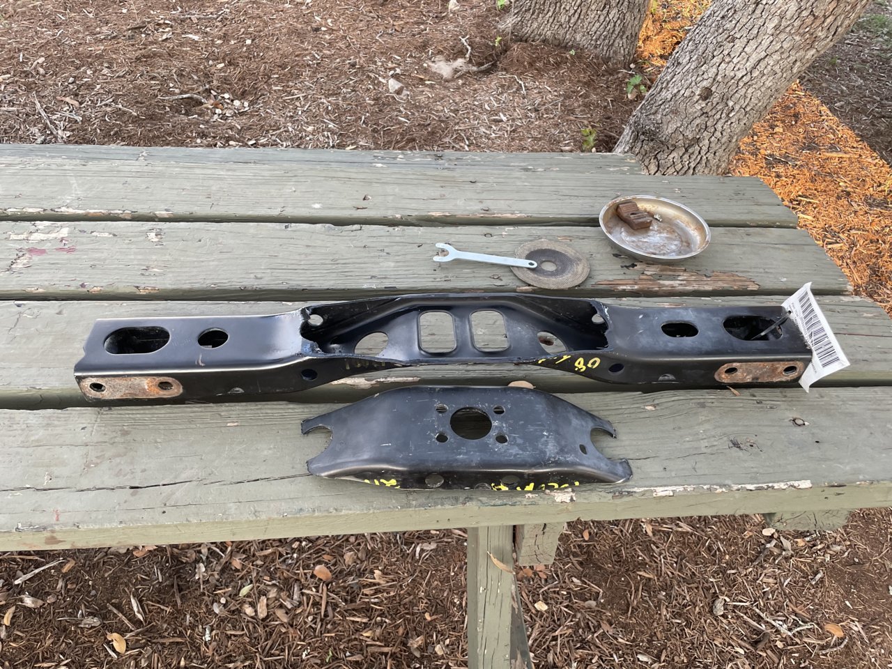

    Cut the prerunner crossmember tonight and got some 1/4” steel plate ordered to cap it up. I’m going to use some 1/8 flat bar to gusset the places on the sides and then im going to fully tig weld the areas around the edges where it is only partially welded from the factory.
    In other news, this truck is getting the 4.10 gears out of my red truck and the red truck is going back to factory 3.73s soon. Both will have TrueTracs out back and open diff up front for the time being. In my red truck this with the AWD has been sufficient for traction even with the magnuson, so i'm looking forward to how it handles the turbo :D

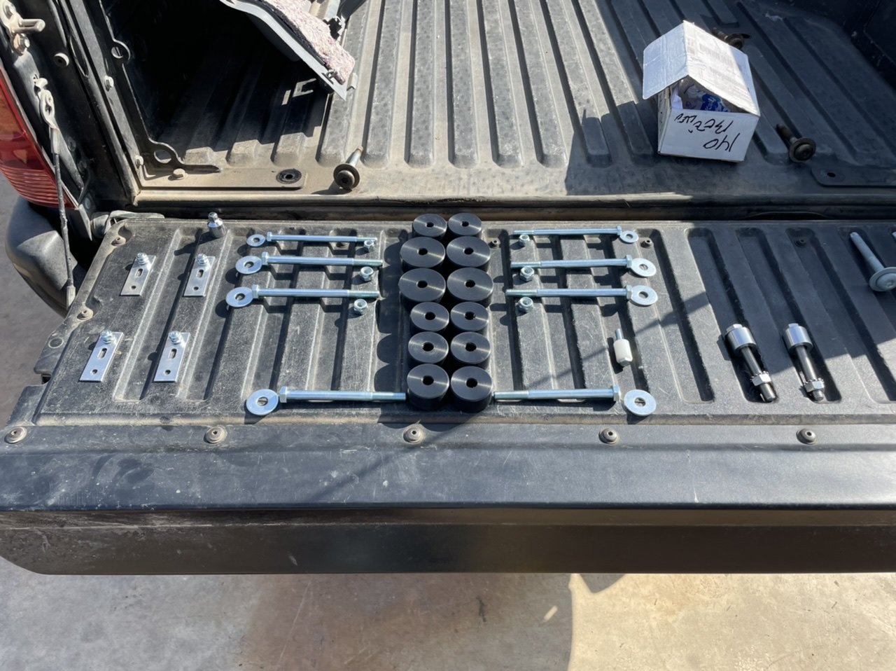

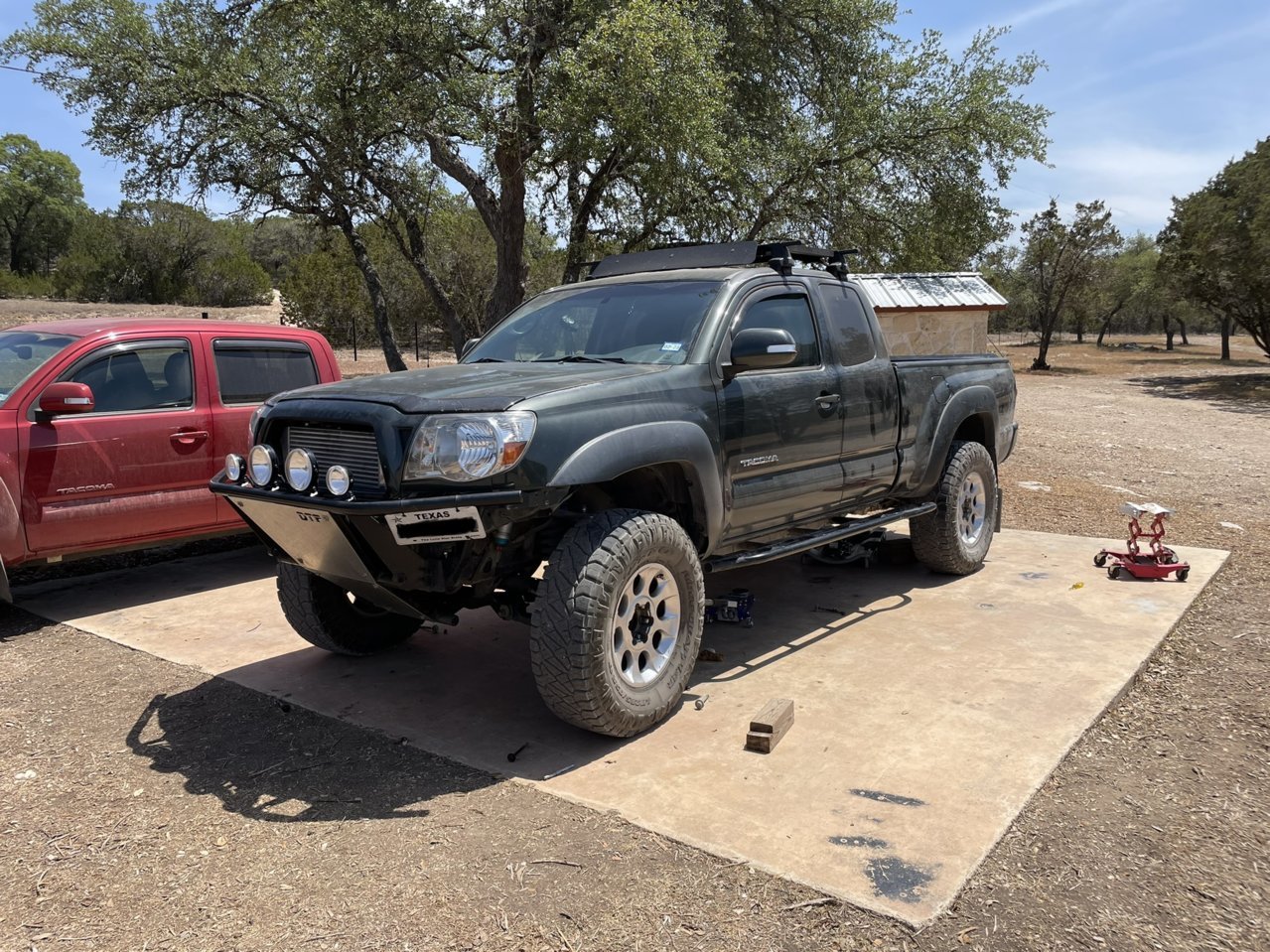

    The green one is going to end up with around 2” of lift up front over stock and somewhere around stock ride height out back. I have a +2.25 LT kit waiting to go on, but that’s another project still in progress.
    the red one is lowered just using the sos performance 2” front/3.5” rear drop kit. It’s okay for what it is, but there is stuff that will be improved on later. Here’s that build

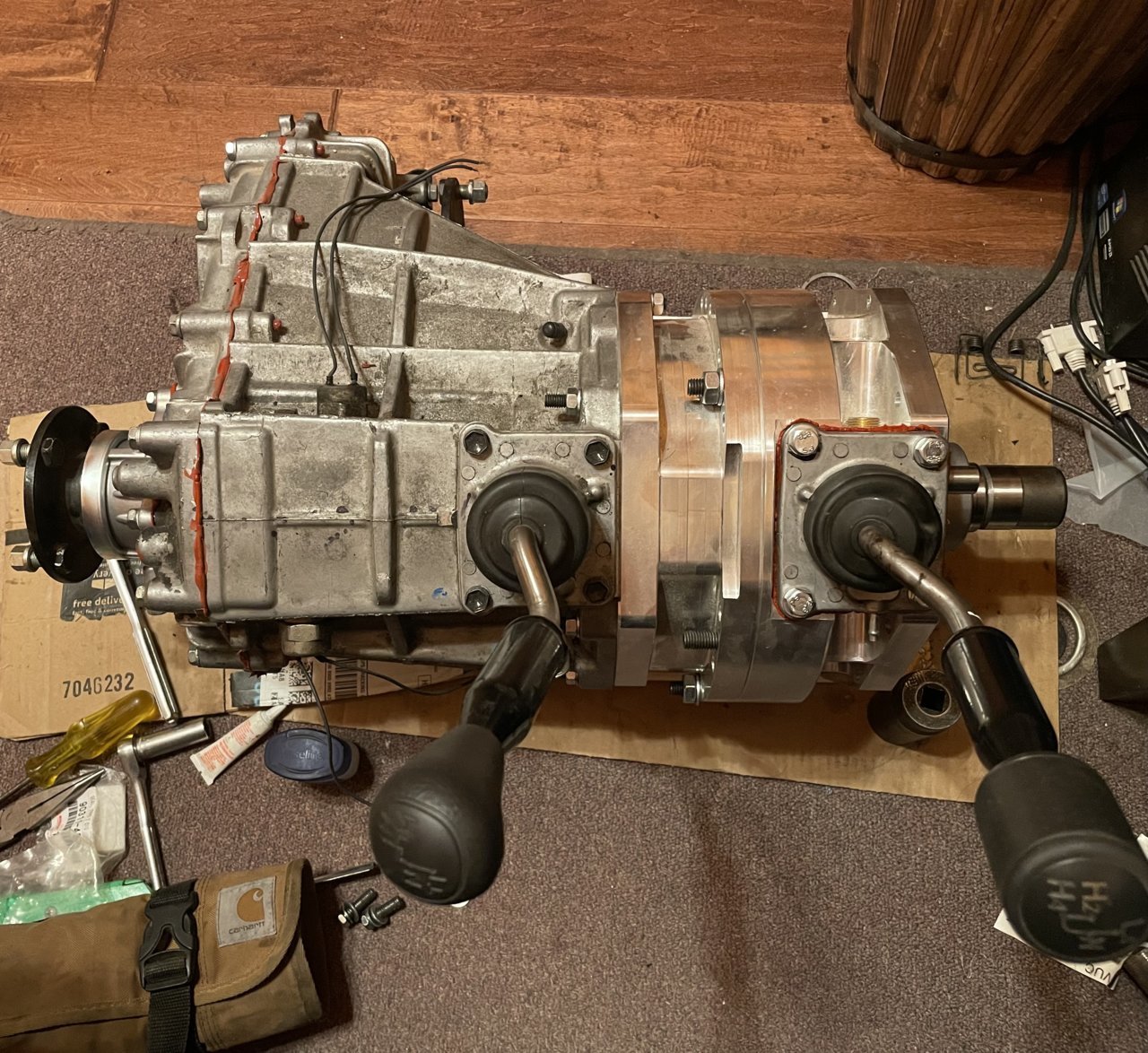

    Im gonna need details on the cral box, i was trying to decide between the that exact one and the LT kit. Guess which one won lol. Mainly cause i needed to rebuild my front end.

    Here’s what I went with. Very simple design that uses toyota t-case donor parts. A top shifted part time 4wd FJ case is what you’ll want for a donor that has all the parts you need. Pretty easy to build too, just very time consuming
    https://northwestfab.com/products/ecocrawler

    So basically just need to buy another tacase since i already have the part time fj case.? If i got same thing you linked no difference since yours is a manual ?

    You may want to give them a call as it looks like their site has changed since I ordered. But yes you’d just want to get another VF2A part time case out of an auto trans FJ for the donor. Mine is different than what you'll need since it's the manual torsen t-case
    The transmission pattern you need is VF4, and the t-case pattern is VF2. Also obviously it's top shift, but i think the auto version is "spade type". If you're about to pull the trigger, i'd just give them a ring to make sure you're getting it ordered right. There is quite a long wait time so you don't want to have to wait twice lol
