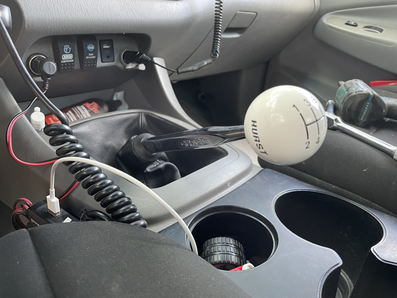

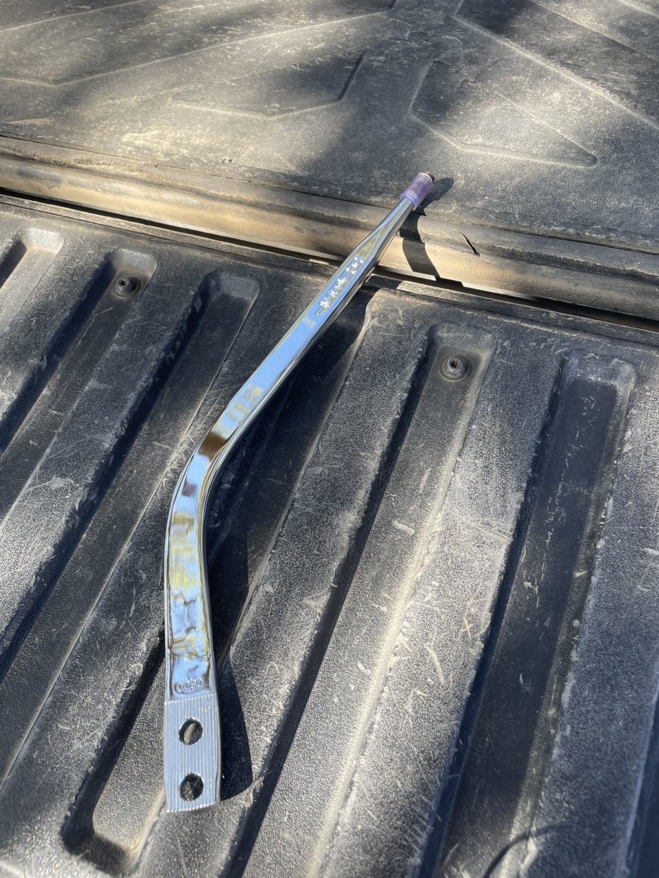

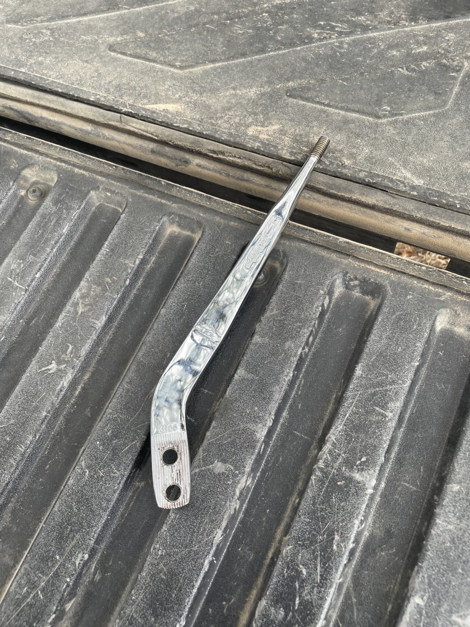

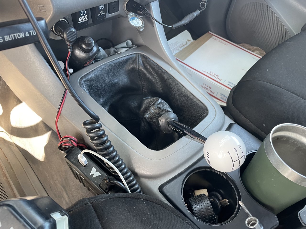

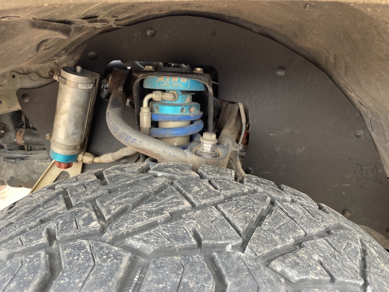

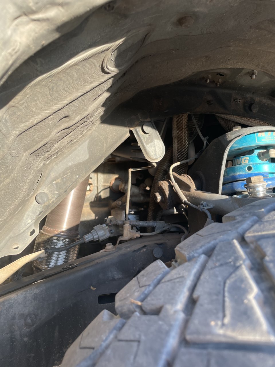

    Got the shifter swapped out for a Hurst 0090 stick today. Had to go with a taller stick after doing the body lift. It was hitting the console in 2nd, 4th and Reverse. Fits way better now, the one that came with the Core shifter always seemed a little short to me. Throws are a little longer and feels a bit more like a truck now, but it im liking it so far. Now just need to figure out how to fit two more shifters in there without sacrificing the cup holders
    Comparison
    After the 3” taller stick
    Greenbean, T.Barn and TodayWasTHeDaY like this.

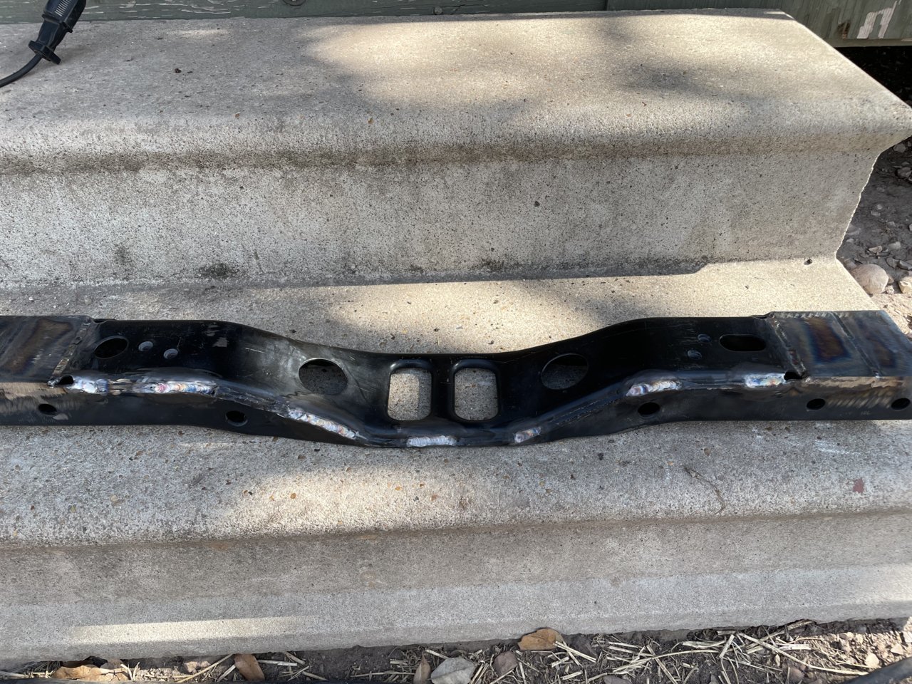

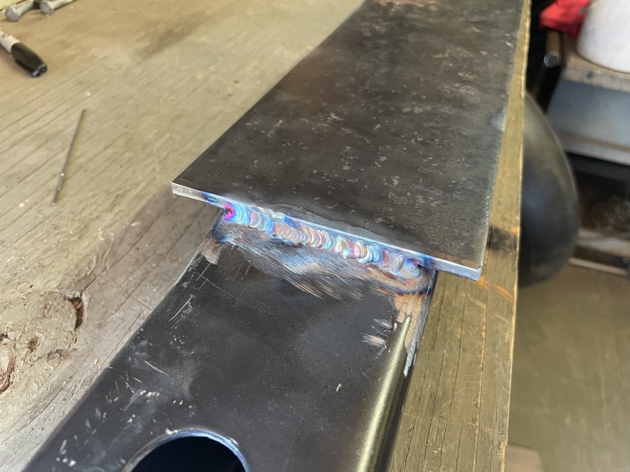

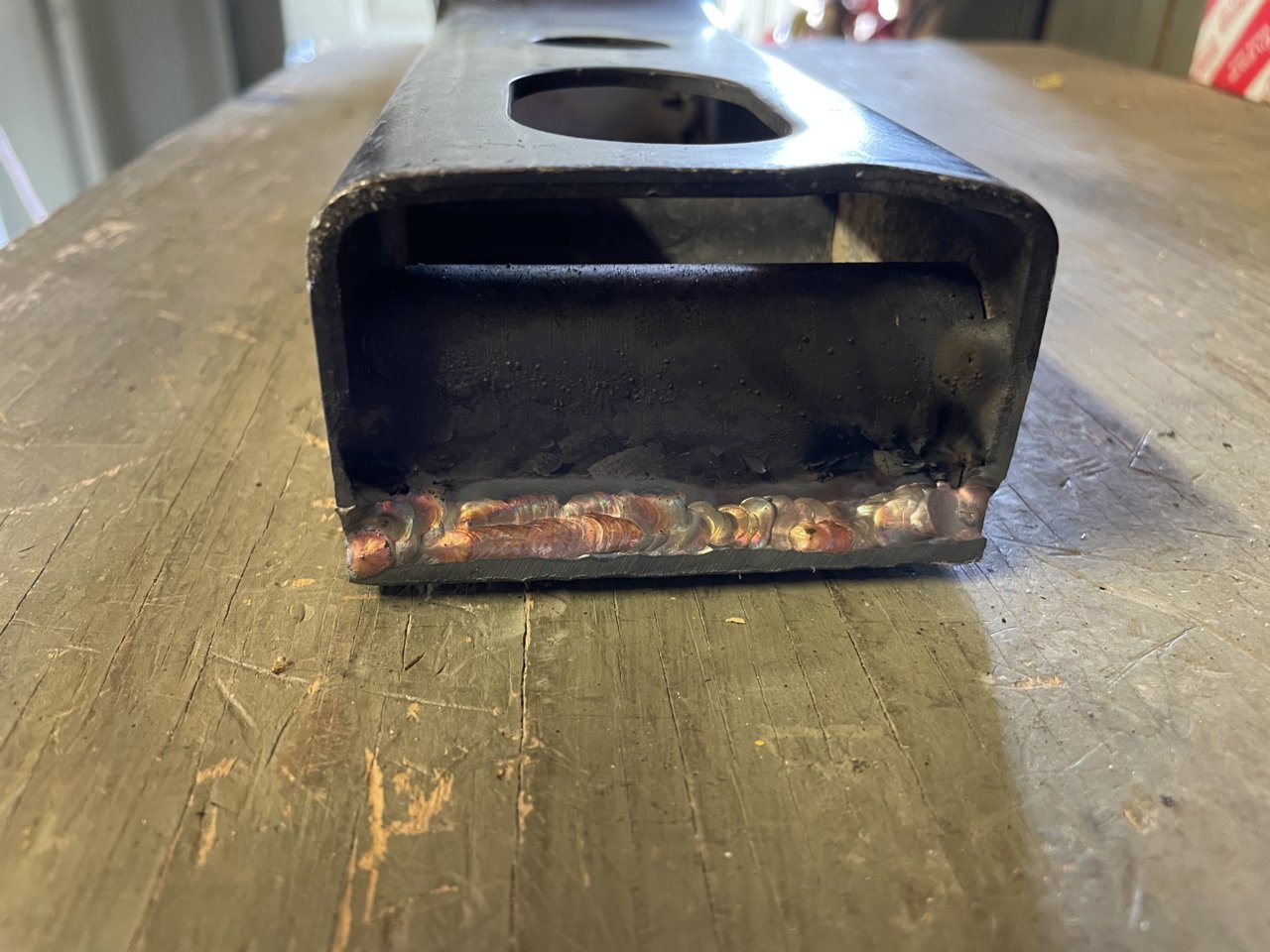

    Did some gusseting for the future 4wd trans crossmember. Capped the ends with some 3/16” flat bar and tig welded the areas where they did not from the factory. Still waiting on the 1/4” steel plate for the top cap to come in, but it’s coming along nicely so far

    What sorcery is this to ground your wooden table?

    Is that shifter in an even gear? If so, you could always cut a small v-notch in it, and bend it towards the dash to where you like it. Then finish weld it.

    Hahah nothing special here, i just clamped it on there while I was moving stuff around :rofl:
    Yes with the old shifter it was in second. That’s a great idea, I may have to modify when I add the other two t-case shifters so I’ll be keeping this in mind:thumbsup:

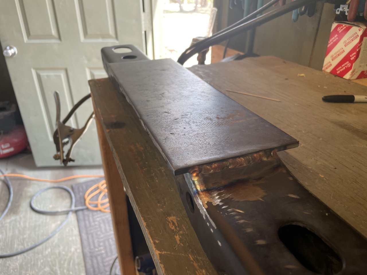

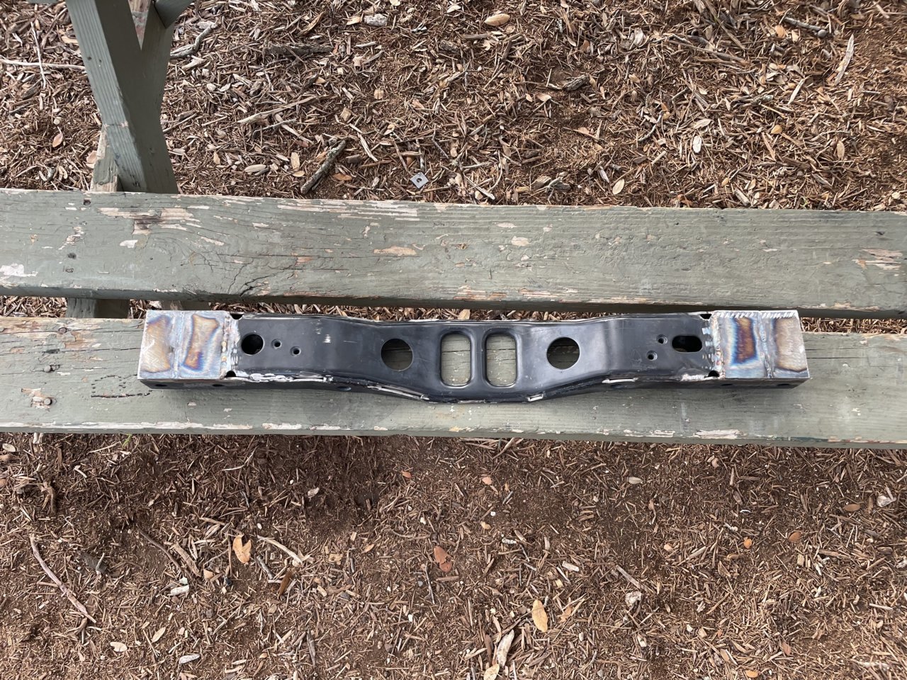

    Cap welded on, painting it now and then it’s time for transmission mount holes

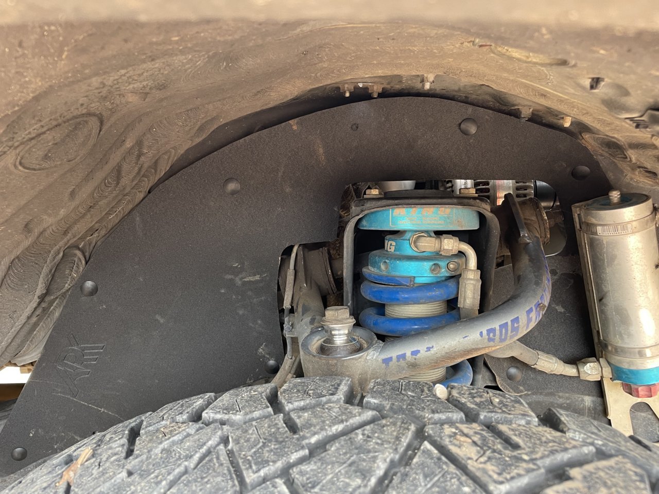

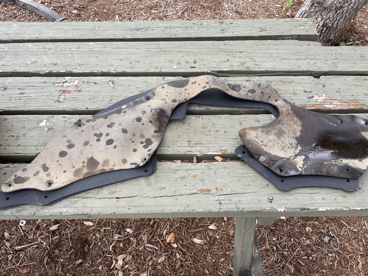

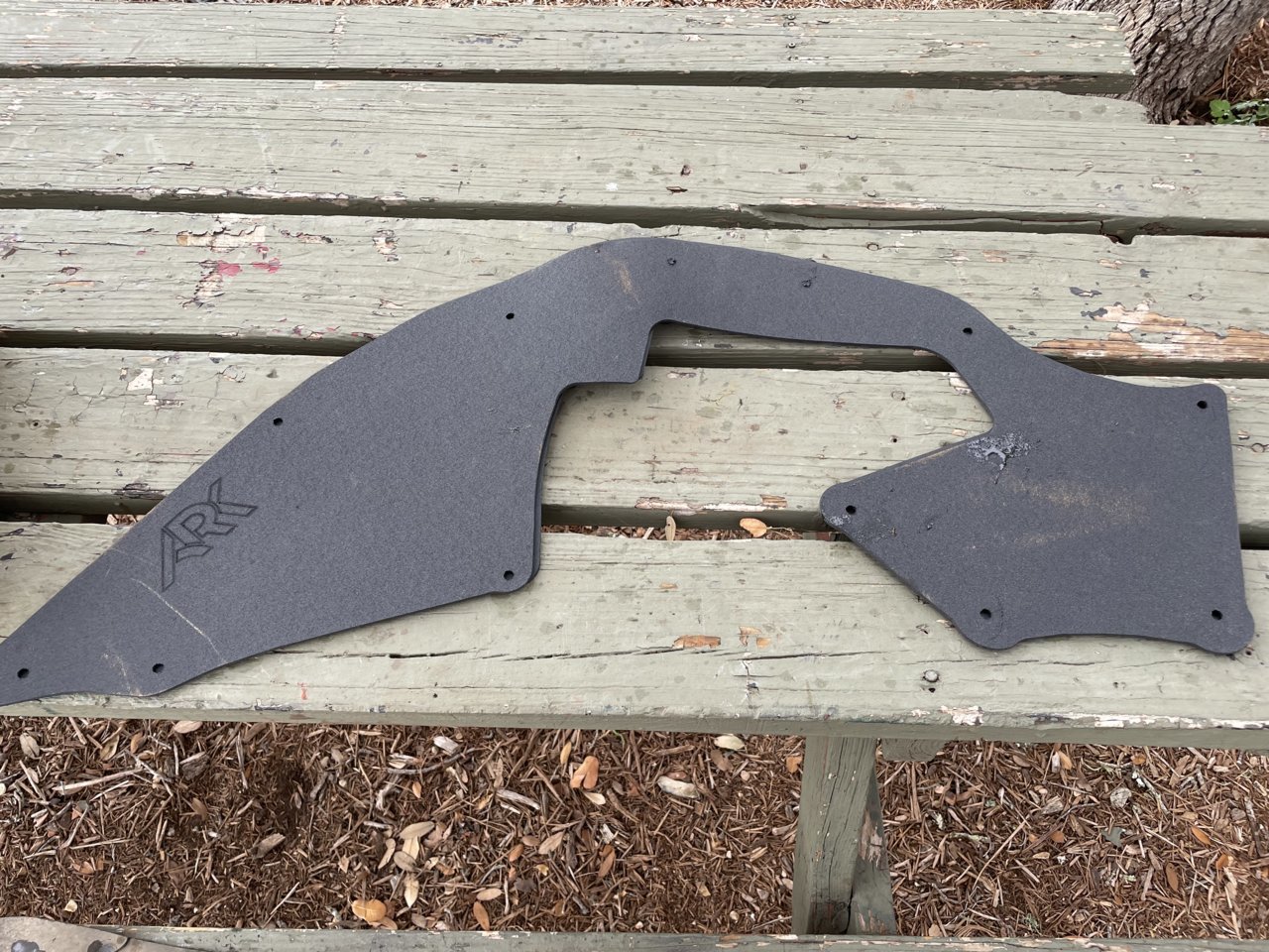

    Added some new Ark splash guards today since the old ones no longer fit after the 1” body lift. Pretty pleased with fitment and quality. We’ll see how they hold up over the long term.
    New vs old sizing

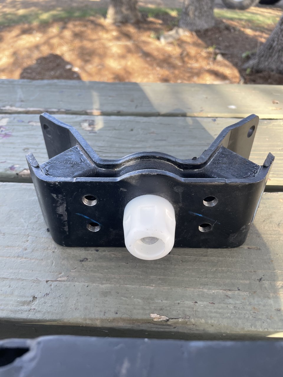

    @05Taco4x4 can you confirm the side facing up in the picture is the side that should be facing forward on the trans crossmember please sir? I am getting ready to drill the holes in the crossmember and I want to make sure I’ve got this right

    Hmmm I'd have to look, I won't have access to my truck until tomorrow afternoon/evening.

    Ok so I could see forward leading edge of mine is flat, couldn't really tell if back side was radiused like one in pic above. Thinking more about it, doesn't really matter since you're making a custom crossmember as long as everything bolts up.
