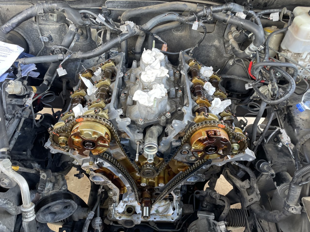

    Cams are all in, and engine is timed. Think I’m gonna call it a day. I’ve about had enough for one day. I’ll get started with the timing cover and accessory drive tomorrowE88FB73B-975A-4408-B9AE-772619DA6C3B.jpg

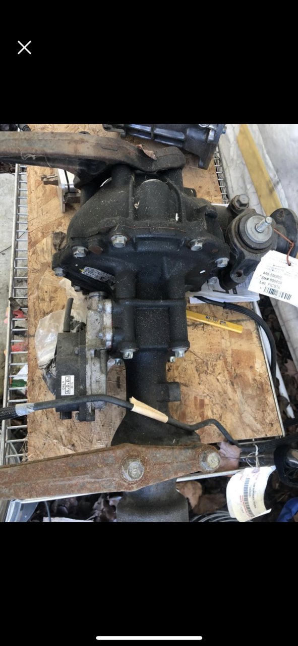

    I have brackets that might work from a 17 4Runner diff.

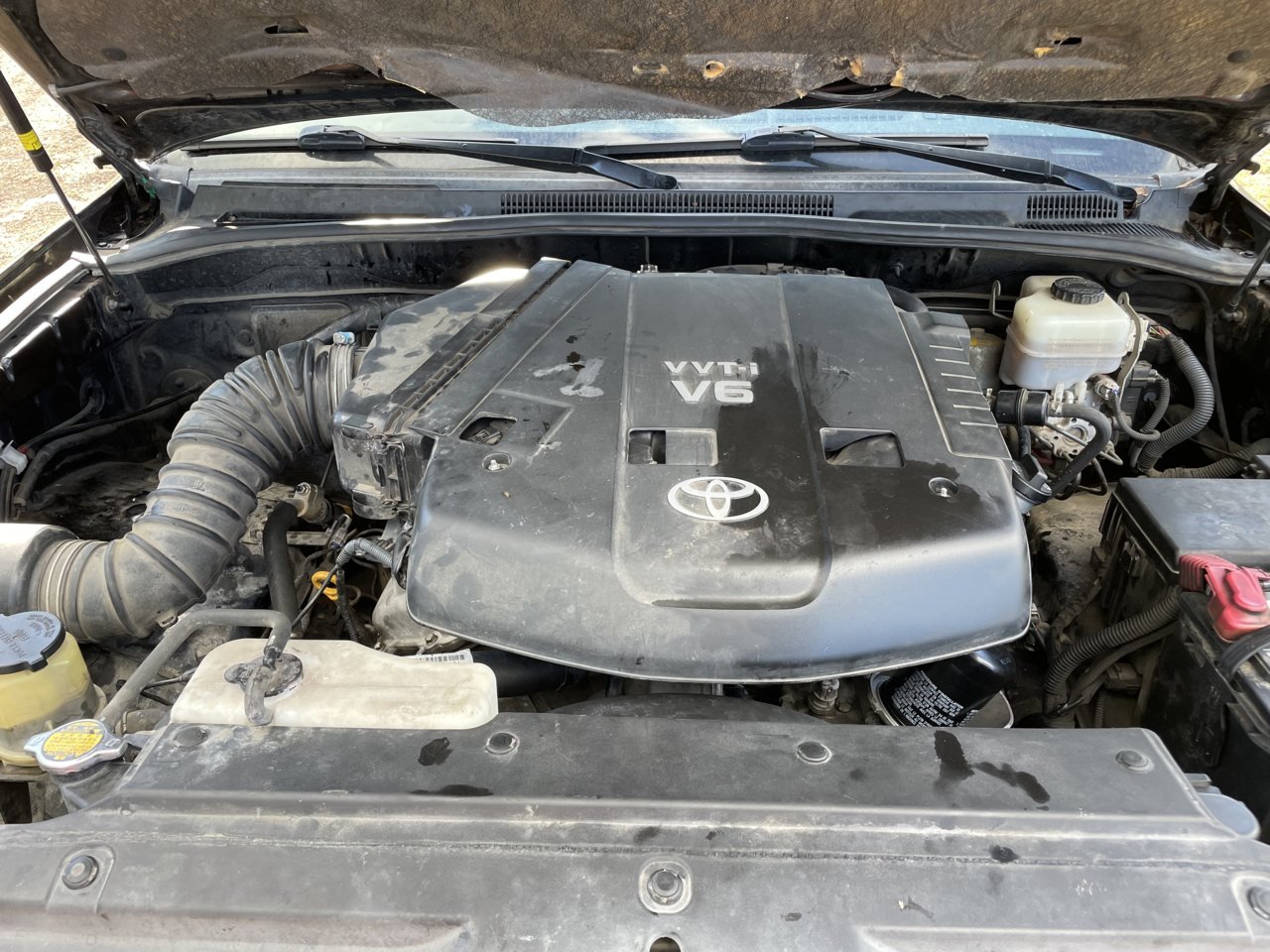

    I went from my 150hp 2tr to driving a 400hp 3ur and I still want to supercharge the v8....

    Thank you for the offer, but after doing some cross referencing, it looks like these will only work on 5th gen 4runners and 2010+ FJ cruisers. I appreciate you reaching out though:hattip:

    Lol yes, driving the 4 banger takes quite a bit less throttle input, so it feels like i have to get on the v6 to get it moving. Much more of a pleasure to drive the little 4 cylinder now

    @BassAckwards does the FJ manual AWD t-case's input shaft mount right up to the R155F? It's been a while, I forget.

    No sir it does not. It has the larger 22 spline male input shaft, whereas the R155F requires a male 23 spline input shaft.
    I went with a northwest fab EcoCrawler to use as an adapter of sorts to put the AWD case behind my R156F
