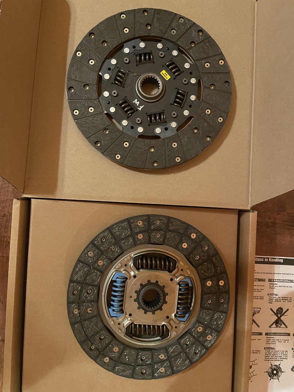

    From what i've seen, the performance clutch discs have more springs (5 or 6) and they're smaller. The stock style discs have four larger springs typically. I am not sure what other differences there are, but i will compare when it comes in and post up

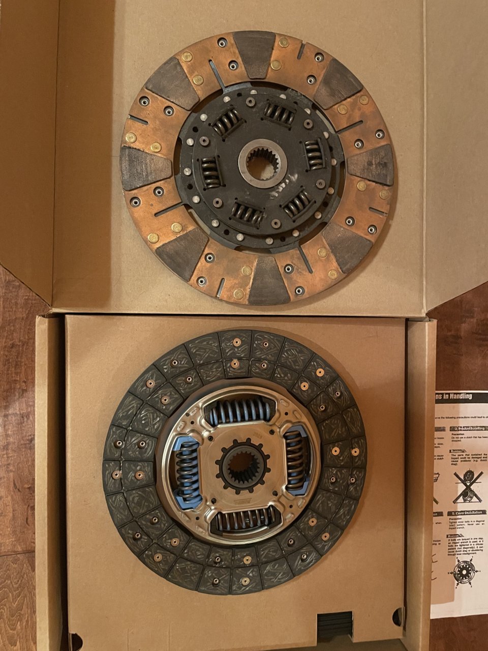

    New Aisin clutch came in. Here it is compared to the LCE dual comp

    Longer / Bigger Springs :thumbsup:
    Plus a shorter spring is stiffer…

    Pretty much the same setup on the stock style LuK clutch i ranch previously as well. I’m hopeful the stiffer pressure plate will keep this thing alive. The Aisin clutch kit is very nice quality though, comes with an NSK TOB and Koyo pilot bearing

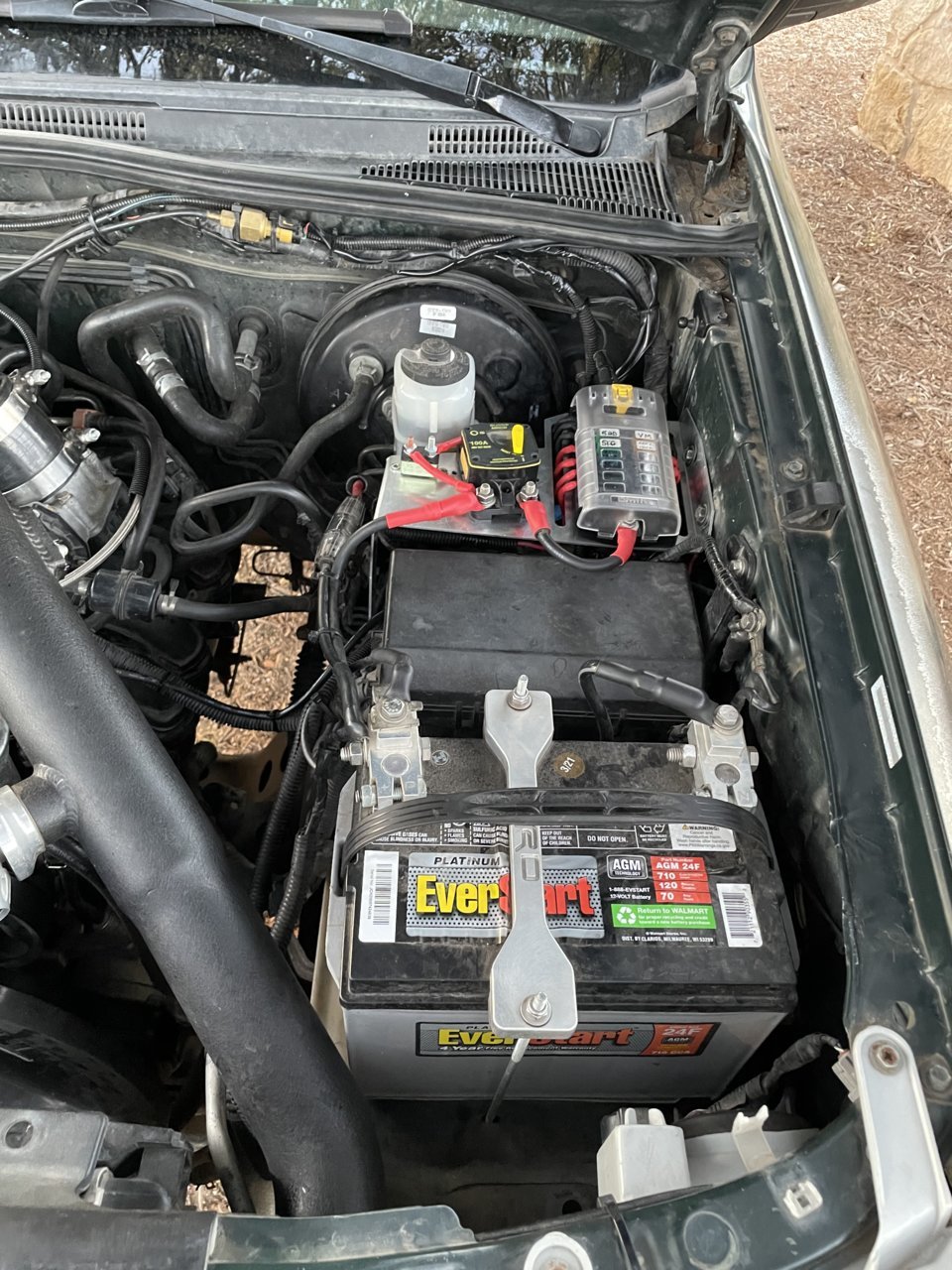

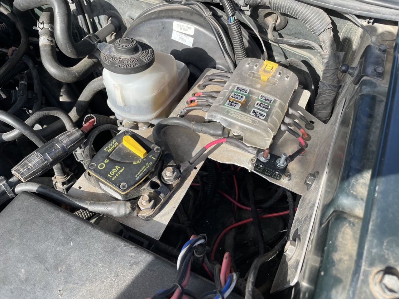

    Spent most of the day cleaning up accessory wiring, swapping out fuse panels, and upgrading to a 12 circuit blue sea auxiliary fuse block. I don’t particularly enjoy wiring projects, but this one definitely came out nice. The old one had a hole cut out of it from where the URD SC oil reservoir used to be, so it was time for an upgrade/cleanup.
    Before
    After
