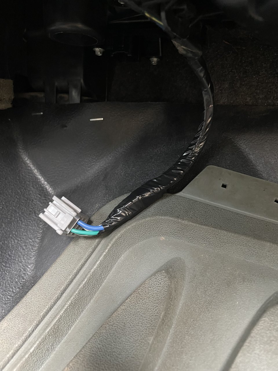

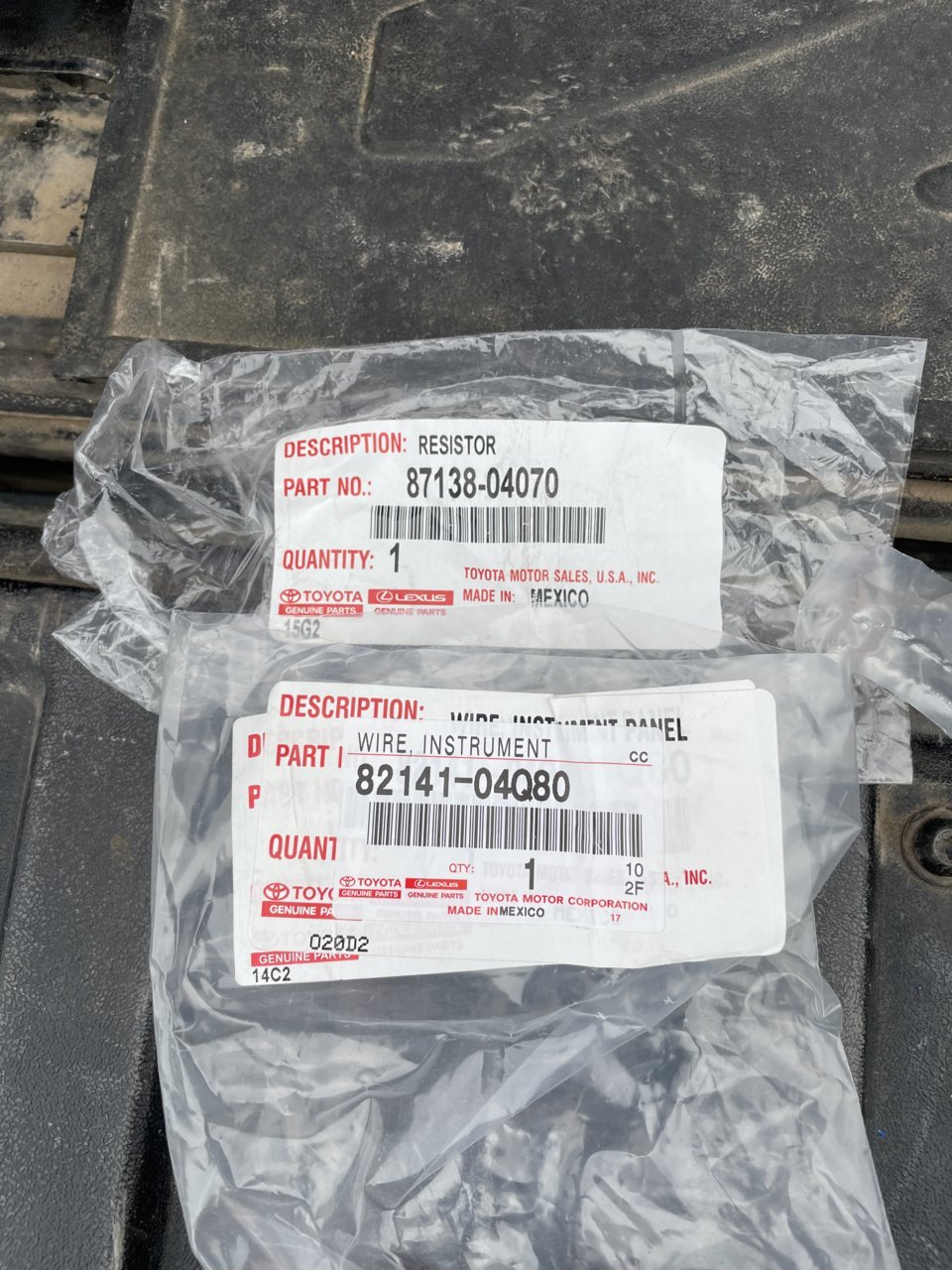

    Been working on a few things lately as time permits. Had an issue on and off where my AC/Heater blower motor would only work on high, so i upgraded that to the updated style resistor and plug. I started out with butt connectors, removed the insulation from those, and then crimped them, heat shrink wrapped, electrical tape each individual one, and then wrapped the whole bundle in electrical tape as well.
    I found the wiring diagrams and info here, but here's the short version for reference
    Old Harness -> -> New Harness
    White/Blue Stripe -> (Hi) -> Solid White
    White/Black Stripe -> (Lo) -> White/ Black Stripe
    Green/Yellow Stripe -> (M1) -> Solid Green
    Blue/Black Stripe -> (M2) -> Solid Blue
    That seems to have fixed the blower motor issues for now, so i moved onto other things. Got the tires rotated and greased the universal joints, and then installed a new Aisin CKT065 clutch disc as well. I left the high clamp load M-Pact pressure plate in there with hopes of keeping the stock style disc alive for at least a few thousand miles. I ran a LuK stock clutch with their pressure plate when the turbo was first installed and it started slipping after 40 miles, so i'm praying the heavier pressure plate will help with that issue.
    I've only driven it a few miles so far, but there are no more vibrations and i am able to leave the truck in gear while slowing down or coasting along, which is absolutely fantastic.

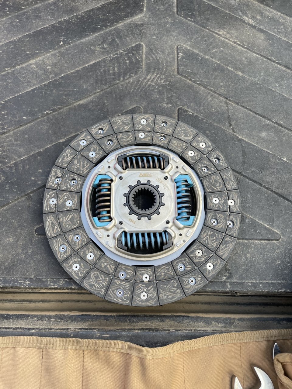

    Well a quick update, have about 350ish miles on the new Aisin clutch disc/M-Pact heavy duty pressure plate and all is well. It has held up to 4lbs of boost but i am afraid to give it the juice.. Sure does drive nice though! Something i've noticed so far is that the stiffer pressure plate makes even the stock style disc much more grabby

    I had mentioned my clutch slipping when really getting on it and was laughed at, as if it was all wishful thinking in my head.

    I have had the same exact thing happen on the stock style LUK clutch and PP. it would hold fine up to about 6-7lbs and then the RPMs would shoot up if it spiked above that. do you have a stiffer PP on yours?

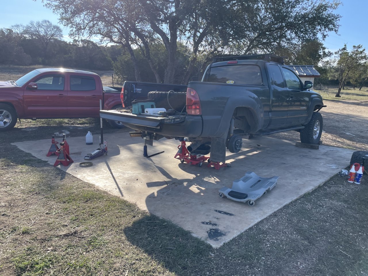

    I’m interested to see if the stiffer pp I installed helps the stock disc hang on at our power levels.
    Currently freezing my ass off in it installing gears haha.. maybe this afternoon?D95A674C-20D9-4A79-A751-EC6319ECB8D3.jpg

    Get a video/s!!!
