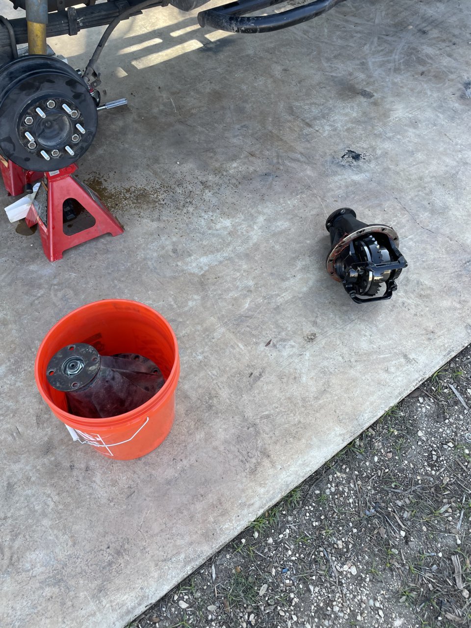

    Just got back from the initial test drive and it gets around just fine with the 4.10s, even with the larger tires. I got the speedometer dialed back in with the Hypertech calibrator so that is back on the money again too. The truck turns right at 2500rpms in 5th at 75mph now. I can tell I will be doing the 4-5 dance more often now, but it will be awesome to be able to cruise 80-85 again if I want
    The pinion seal was leaking on the old 5.29s so it was a good time to swap
