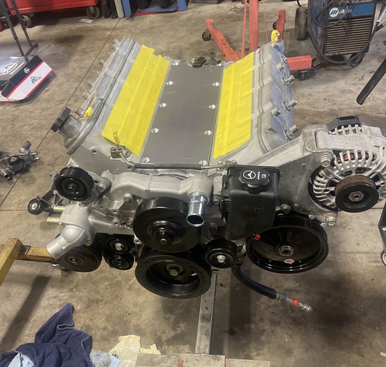

    You got it! Still buying parts… Goes to the installer in El Centro Cali. hopefully on the 21st of this month.
    Here’s my baby, she’s waiting on a few gaskets and she’s a crossbreed a 06 Silverado L33, 06 TrailblazerSS (not pictured) and 04 Vette. If there’s room I’m going to purchase CNC brackets to move the alternator below the power steering. Then I can use the 160 Amp truck alternator. Any contributors if I start a Go Fund Me?

    Which car did the front accessory drive come off of? And are you planning on keeping the tacoma rack?

    Front accessories are from an 04 Vette. And yes hopefully why please? God I hope they are compatible…
    Thanks my friend!

    Just based on my research from a while back, i am fairly sure the toyota rack and GM pump operate at different pressures. There have been people that adapt them and make them work though. I think Munkeywrench kept his stock tacoma rack, so i was just curious more than anything.

    Hmmm…
    @tacotunner06 and @munkeywrench never mention any issues with the power steering. Hopefully one or both can chime in.
    I know I’m installing an PS / transmission magnetic oil filter like the one on our old superchargers and a small oil cooler.

    never had any issues with the power side with a corvette pump that i originally ran. now i'm running a psc pump with a tundra rack and the p/s steering system works great.
