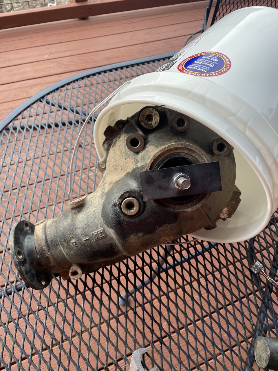

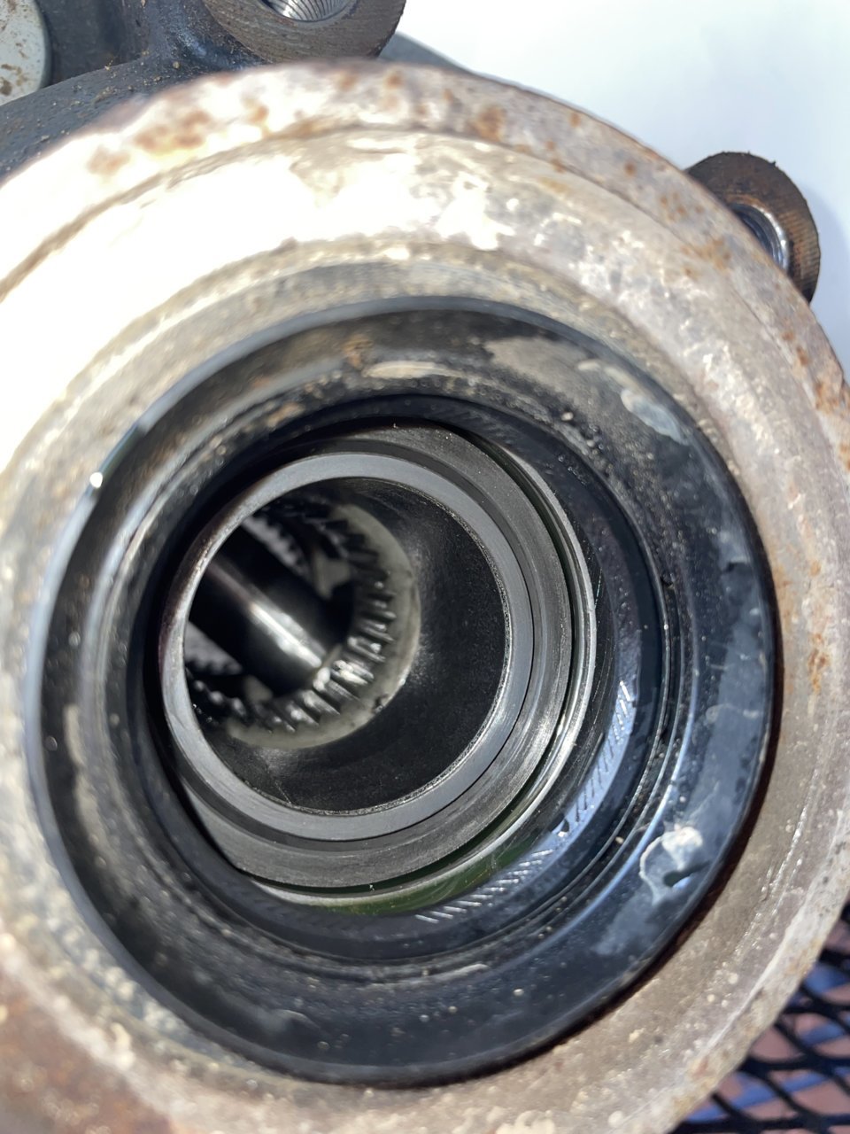

    Installed my ECGS bushing today in my 4.10 front diff. Everything is ready now for the AWD conversion so whenever I get some time to take the truck out of service, I can measure for and order driveshafts and then install everything.
    05Taco4x4 and BananaMan like this.

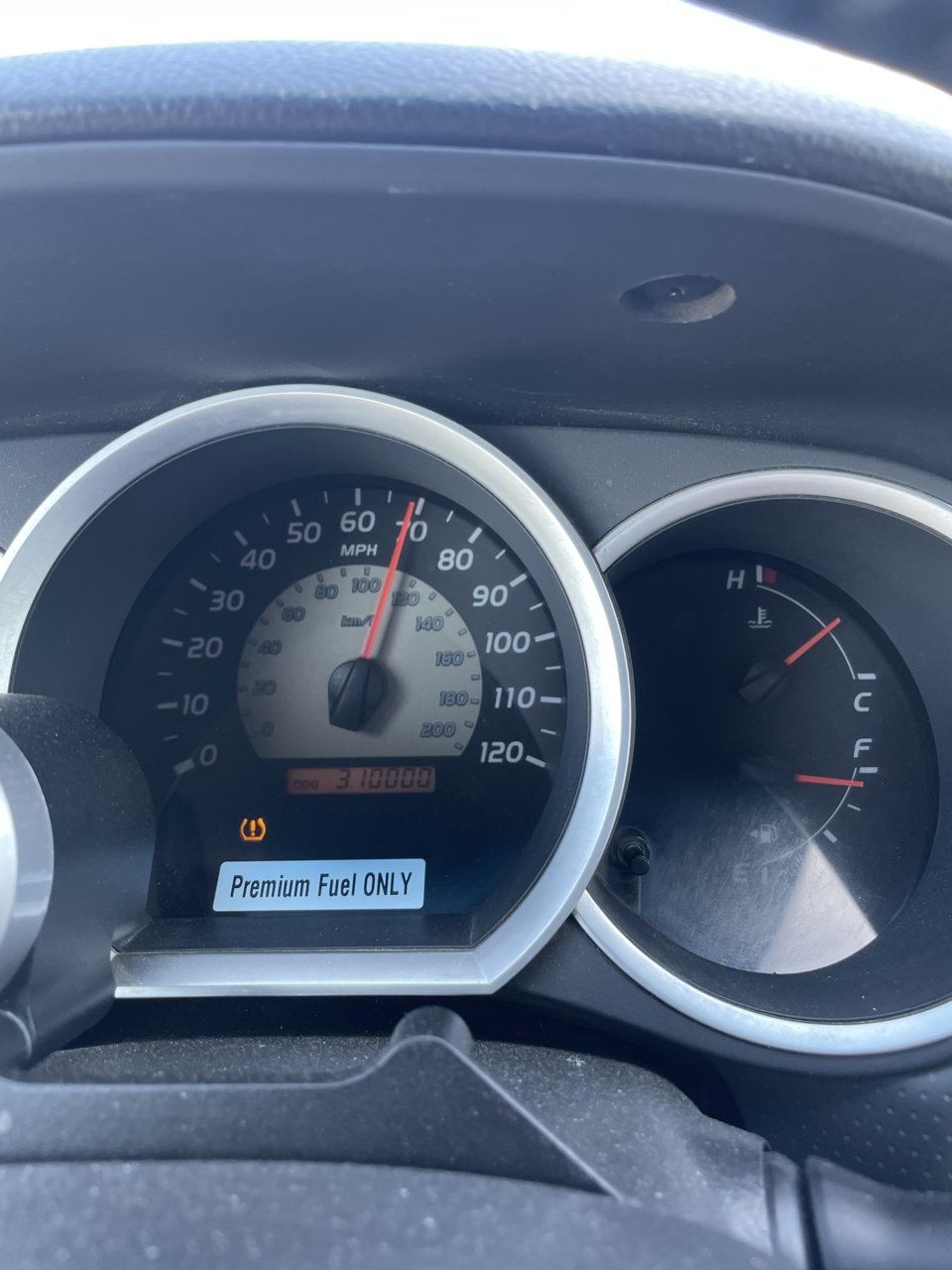

    It is the 3.12 out of an x-runner. I currently do 75 mph in 2nd, so I don't think I'll see much difference in that aspect. As far as the built block, if I don't score the engine from crowntown I'll be boosting my stock engine to 7lbs before upgrading to the full kit from LCE and trying to push 20+lbs

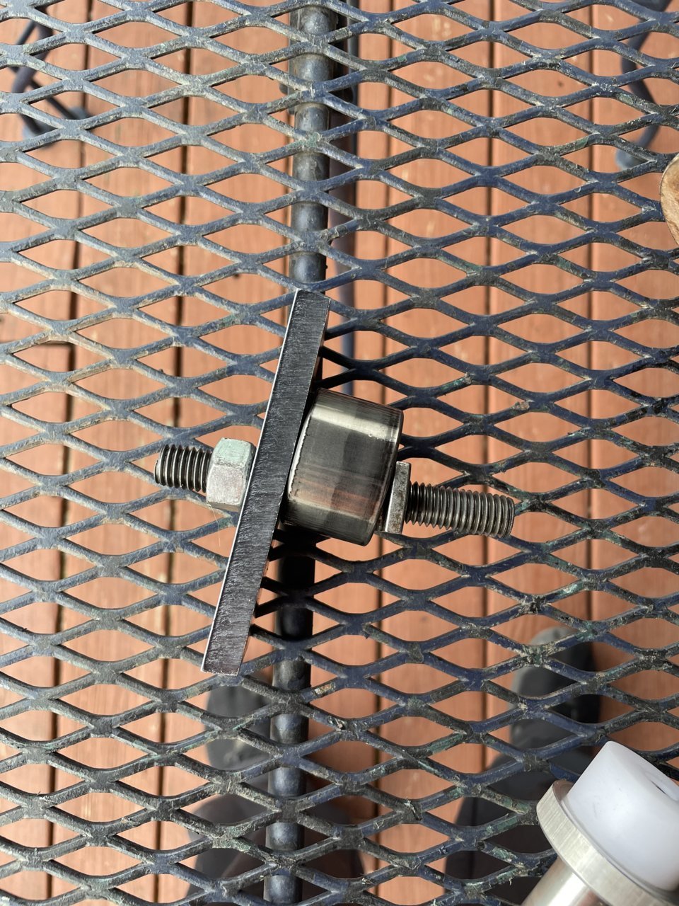

    I fully approve of the red neck bearing installer tool. I've made and used many of those in my few years of millwright experience.
  12. Feb 18, 2023 at 5:19 PM

    That is actually the tool ECGS sells! it worked okay for what it is but it took quite a few whacks to hammer it home
    Athlaos, Torspd and BananaMan[QUOTED] like this.
