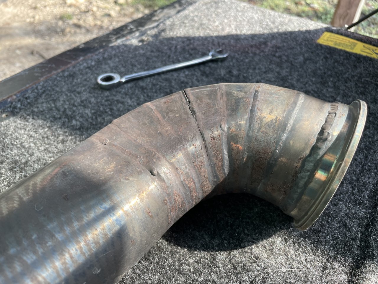

    Did you autogenously weld it last time, or use filler?

    No filler, just a fusion weld. Would that make it weaker?

    I’ve been told filler has additives to prevent the metal from getting brittle. I was talking to a guy on another forum about something similar, and he said his weld kept cracking. Someone else chimed in and explained in better detail why filler is needed everything it does. that’s the extent of my knowledge on the subject, someone or something on the internet told me filler is necessary.

    That purely depends on the penetration of the fusion when autogenously welding. Without a backpurge or solar-flux, it is hard to get a thorough penetration without causing opposite side oxidation. This may be where your problem lies. Being the location of post turbo, you can get away without backside of the weld. Filler will help though. If you don't want to back-purge, then the Solar-flux and filler would be the next best and strongest option.

    Sounds like I need to do some more reading on this! I appreciate the heads up:thumbsup:
    I will need to use filler for the repair lol, it’s tearing itself apart, so maybe that will help too
    I figured penetration would be pretty good since the metal on these pie cuts is so thin. I also think that may have something to do with it being weaker. These are ace race pie cuts. I did use solar flux on the insides while welding, but maybe I still got some oxidation going there even with that
    As it stands right now I don’t have a good way to back purge so I will do the solar flux like normal and try using some 309 filler

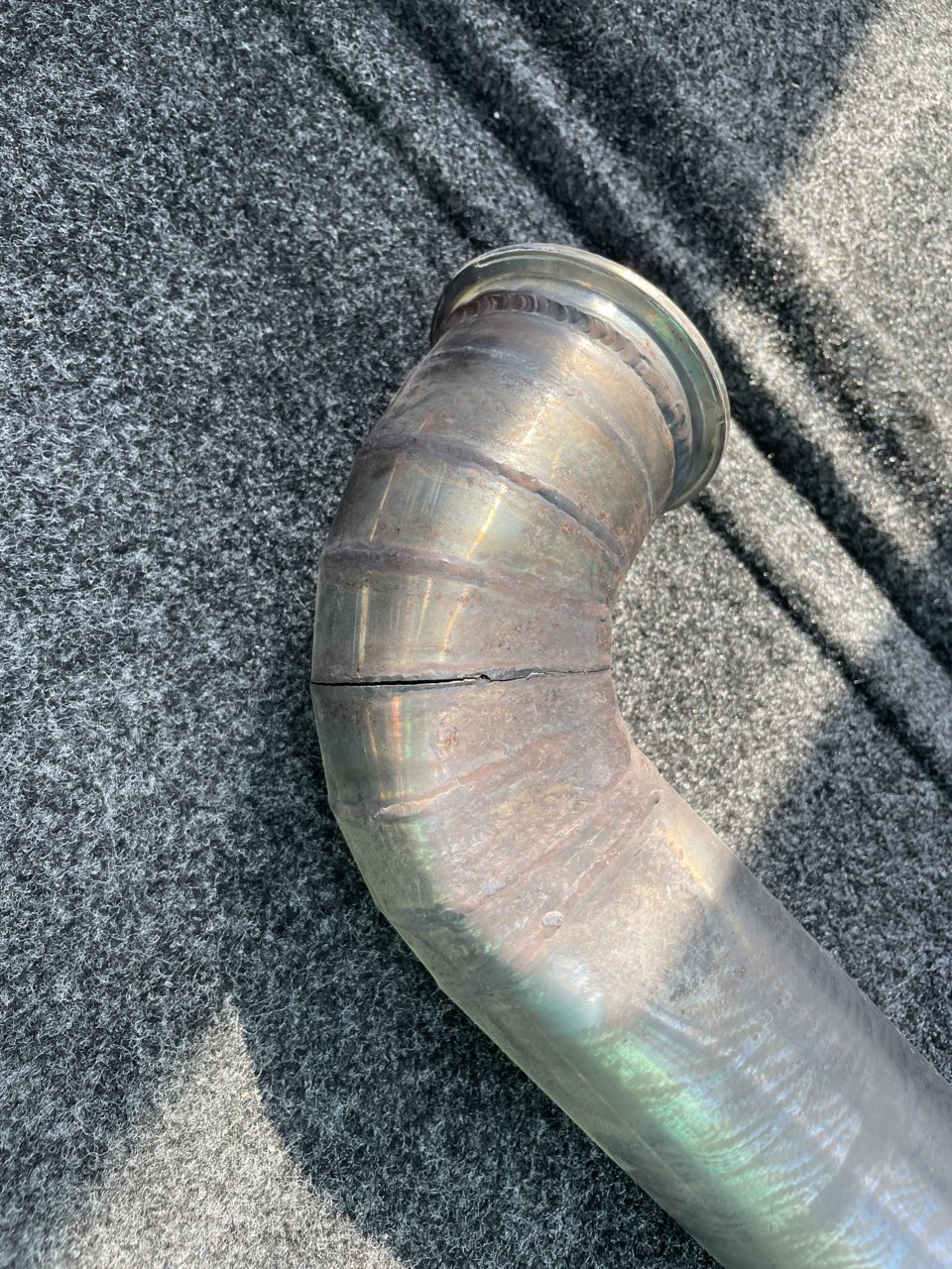

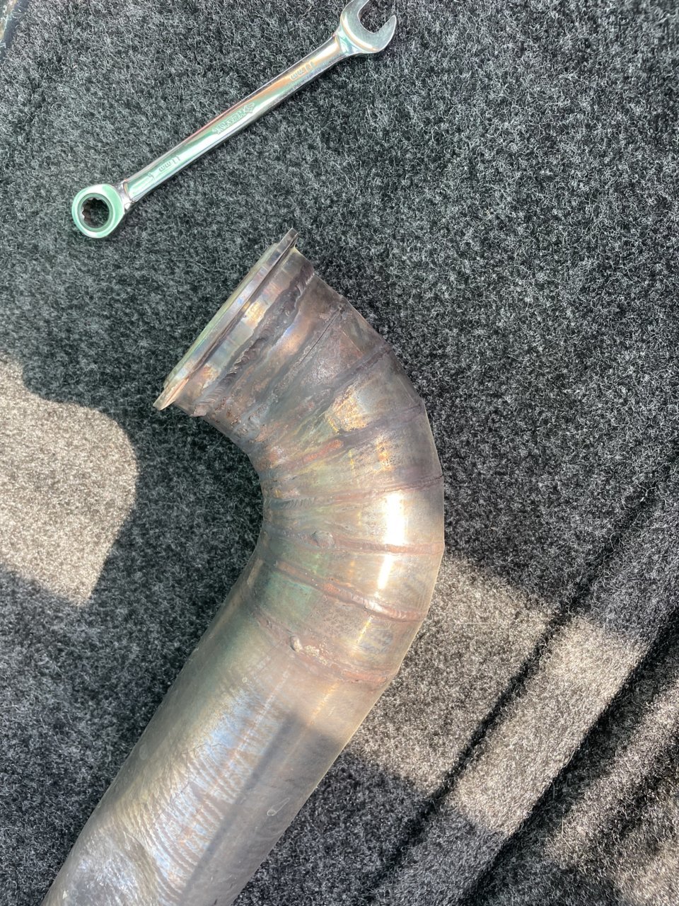

    One crack went about half way around, and then if you look closely, there is another one starting near the flange

    If you have time, order you up some 347 filler rod.

    I will definitely get some ordered but this sucker is getting melted back together so I can continue to daily it. If it breaks again before I rebuild it completely, the 347 will be used. Thanks for the suggestion :hattip:

    Oops I think I mentioned the wrong filler above. I will be using 308L
