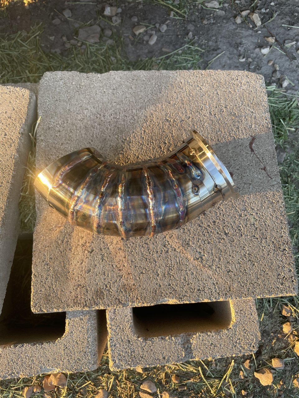

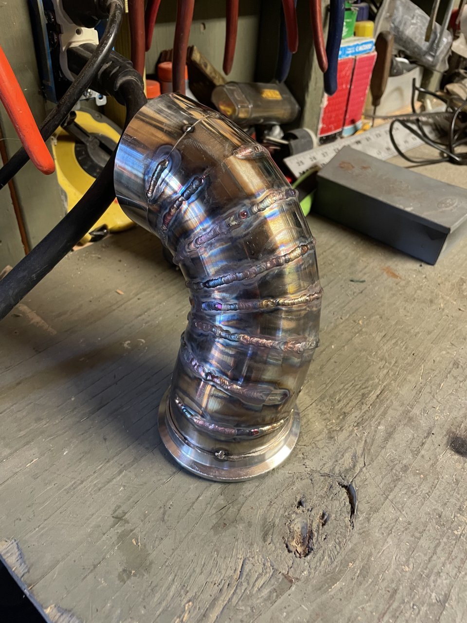

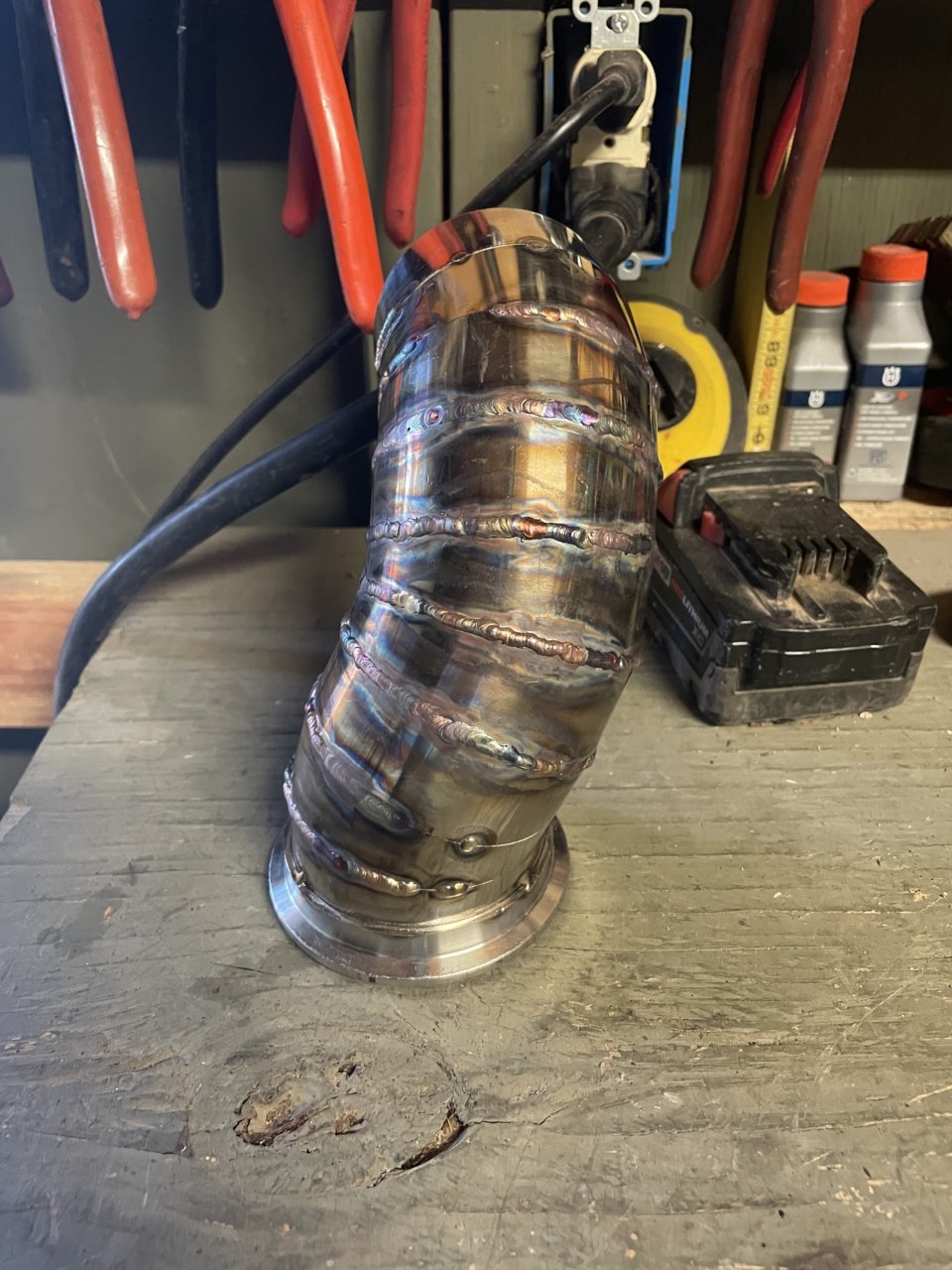

    Made a little more progress today after work. I switched out to .045” filler where I was using 1/16” before. It seems much easier to dab it in there without it bunching up like the thicker stuff. Also makes it easier to move more quickly so the project is going much quicker. I have most of it welded up now, just need to finish up the ends, and the flange, then I can move on to the next section

    If you have a grinder, all welds look good

    Your welds nearest the flange show the most improvement. Working on the straight portion now?

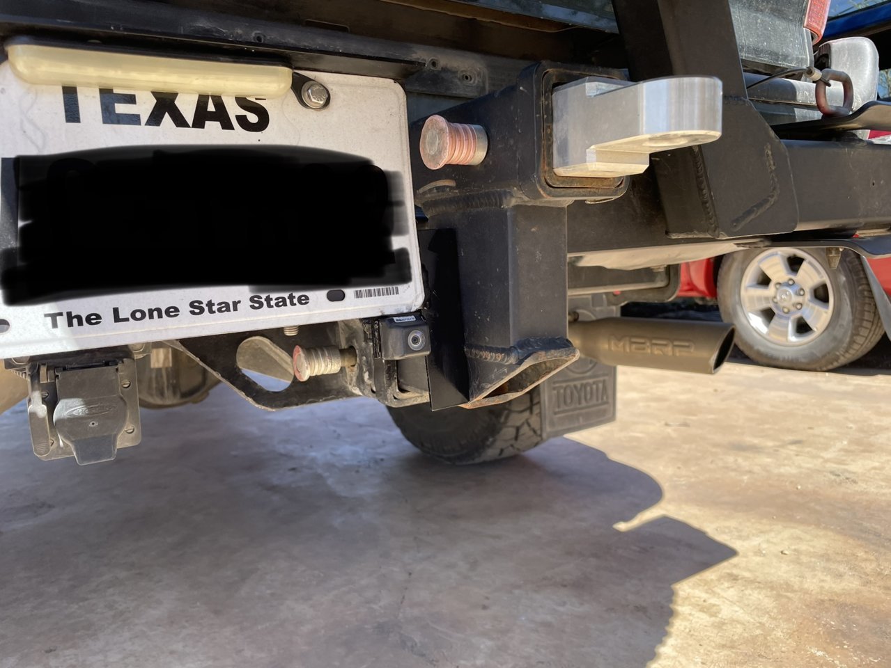

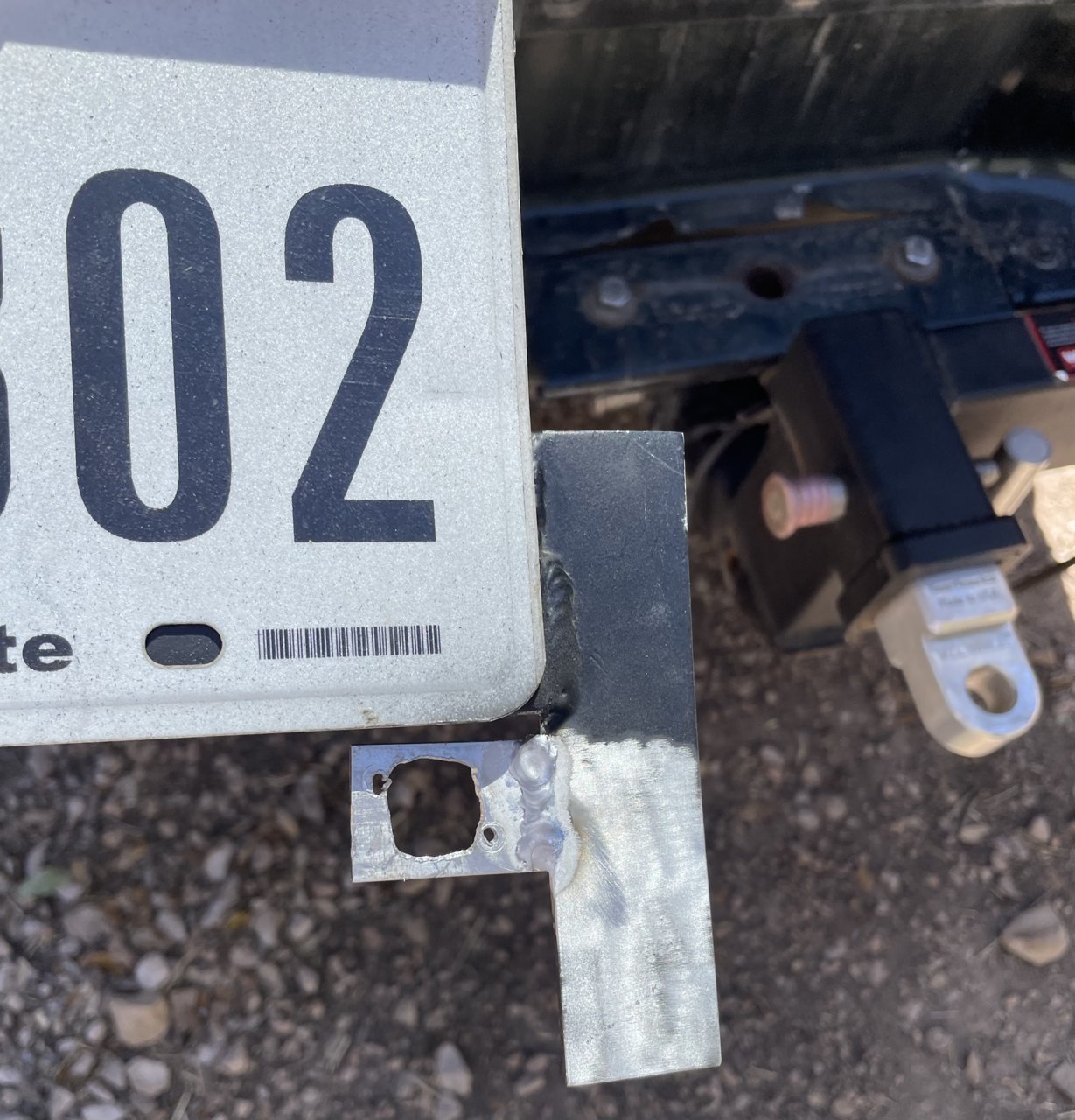

    Just finished up welding the flange today.. got a little side tracked though and relocated my backup camera. That involved a little AC tig though so got to get a little practice on that

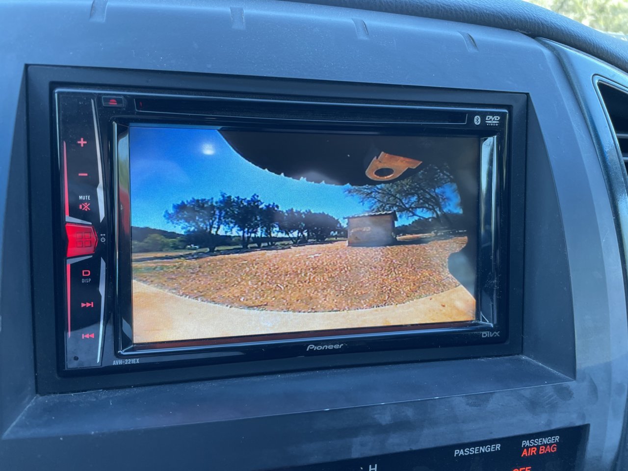

    Relocated my backup camera today. I ordered an OEM replacement camera for the tailgate so I could use that one now, and an additional OEM harness. I’m going to make it to where I can leave the one in my tailgate and then just plug in the relocated one when I have my tire carrier on the back like I do with my license plate light. Added a little Toyota FIPG around the camera before tightening it down, so hopefully it holds up out in the elements.

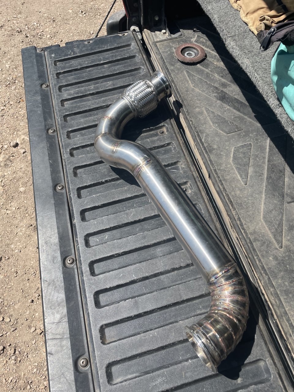

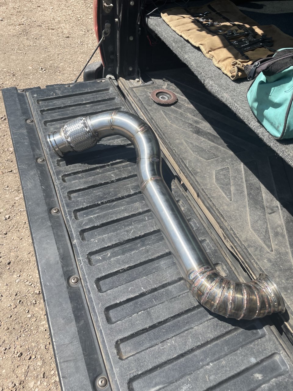

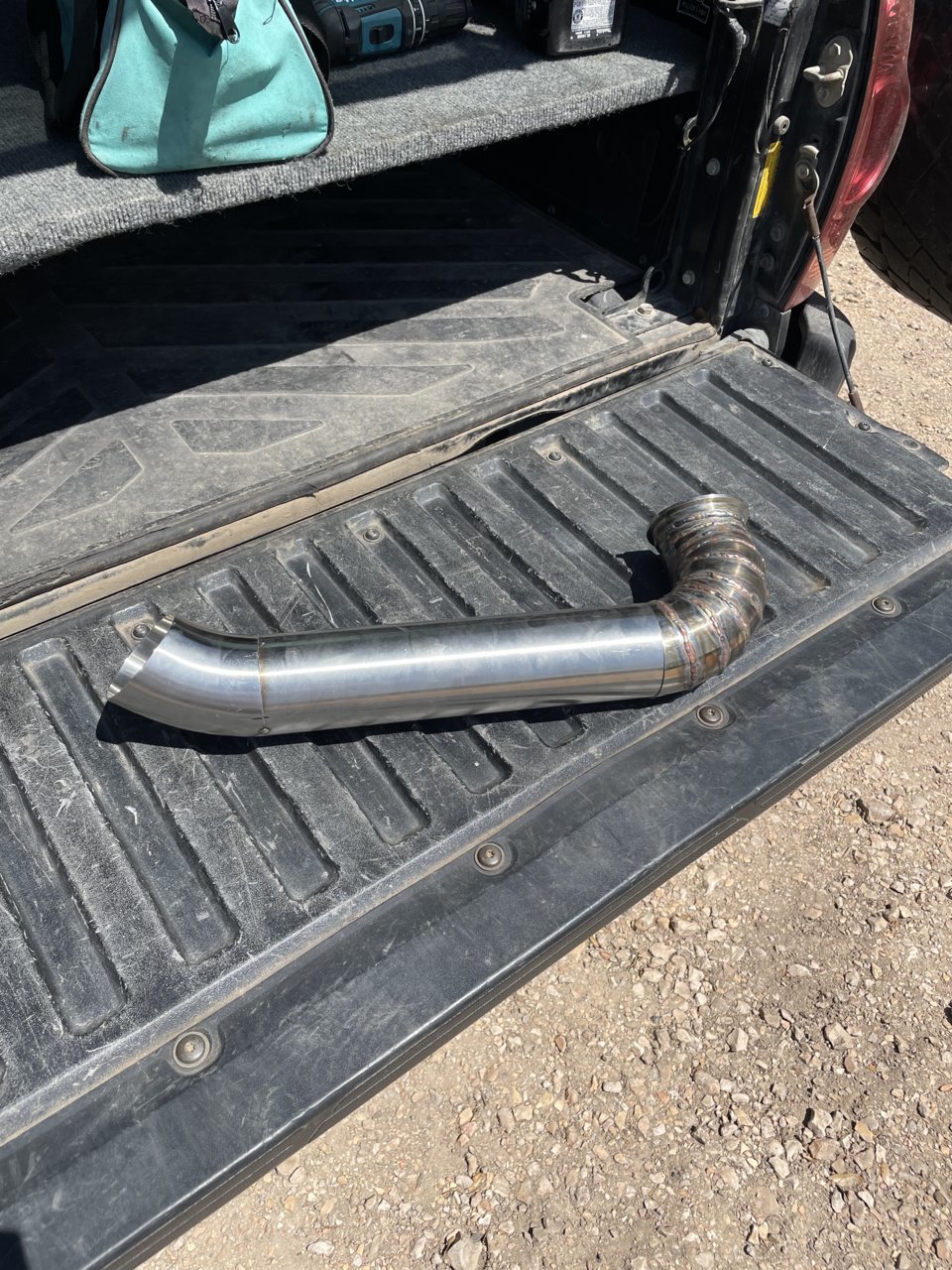

    Made quite a bit of progress today on the downpipe. Got final test fit done and now I just need to weld everything up and add o2 bungs. I’m also considering adding an EGT bung, but those appear to be a different size than the standard o2 bung, so I may wait on that.

    That looks damn good!

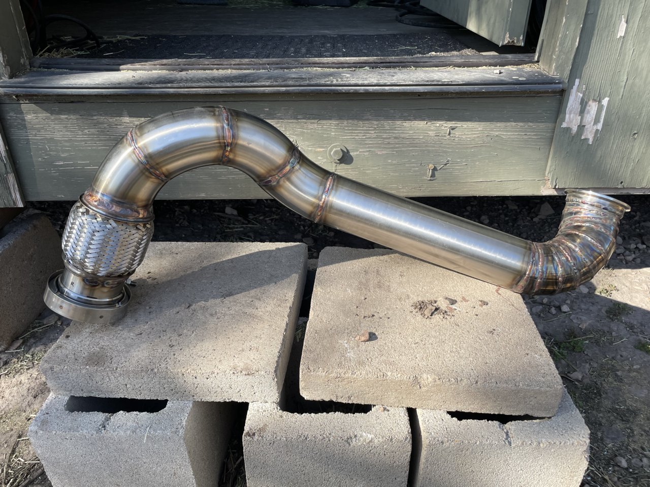

    Done for the day. Got everything welded up except the two welds near the outlet. I’ll try and wrap those and the o2 bungs up next weekend, then I can wrap it and throw it on.

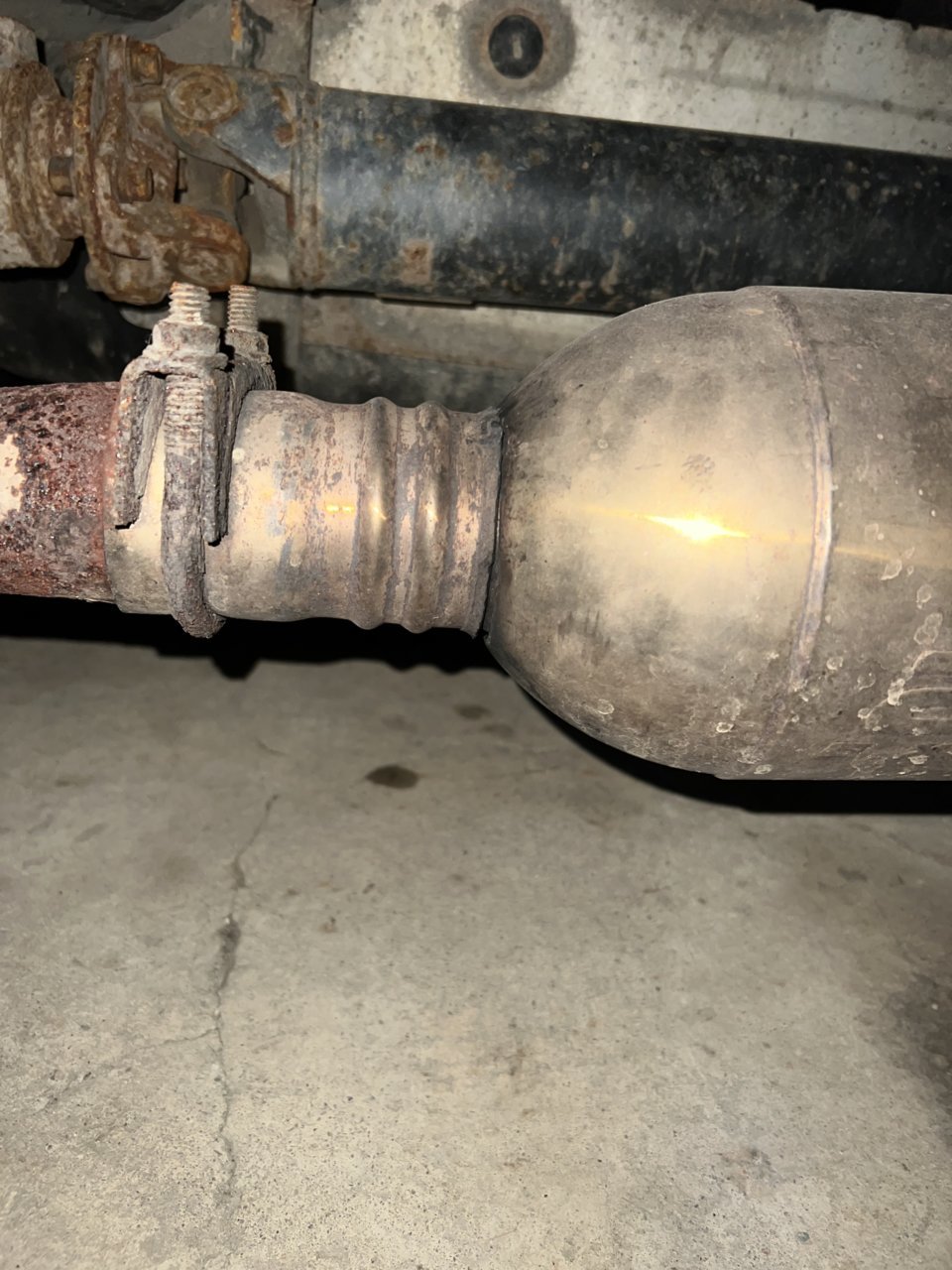

  14. Mar 26, 2023 at 5:12 PM

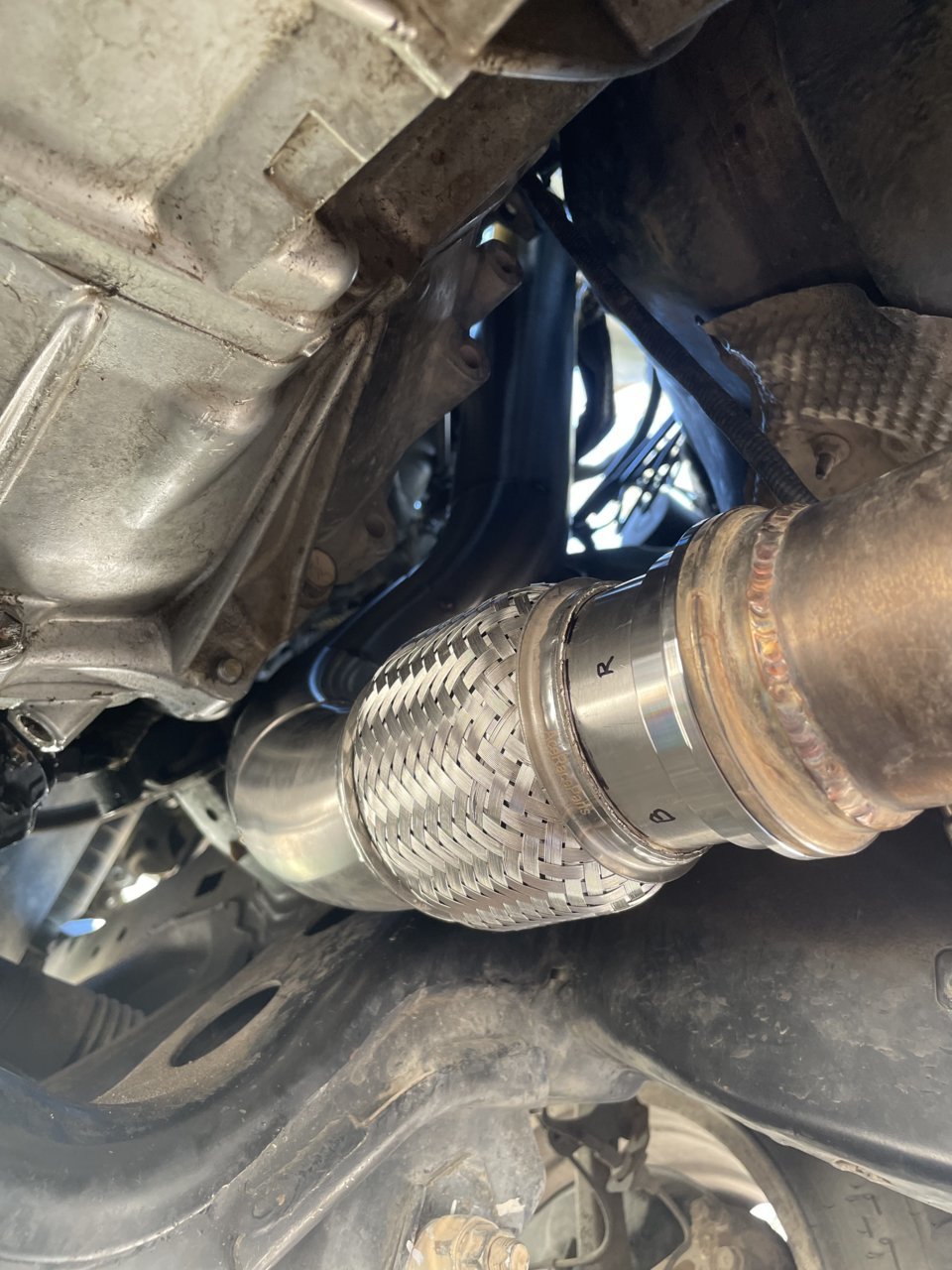

    That flex pipe and v-band is what I need to do to my truck. This is the third time this has happened. Granted it's a fleabay/cantazon muffler. It was also put on by the previous owner.
  15. Mar 26, 2023 at 5:36 PM

    A flex and v-band should take care of that problem once and for all. V-band is hard to beat if you ever have to take things apart in the future!

    Your downpipe turned out extremely nicely. Well done. :thumbsup:
