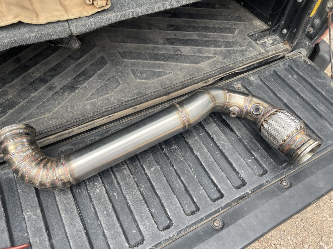

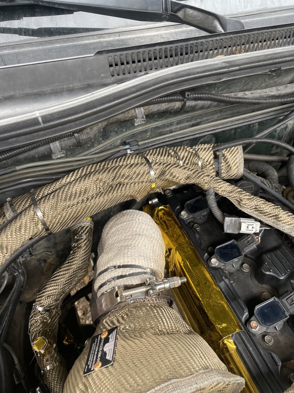

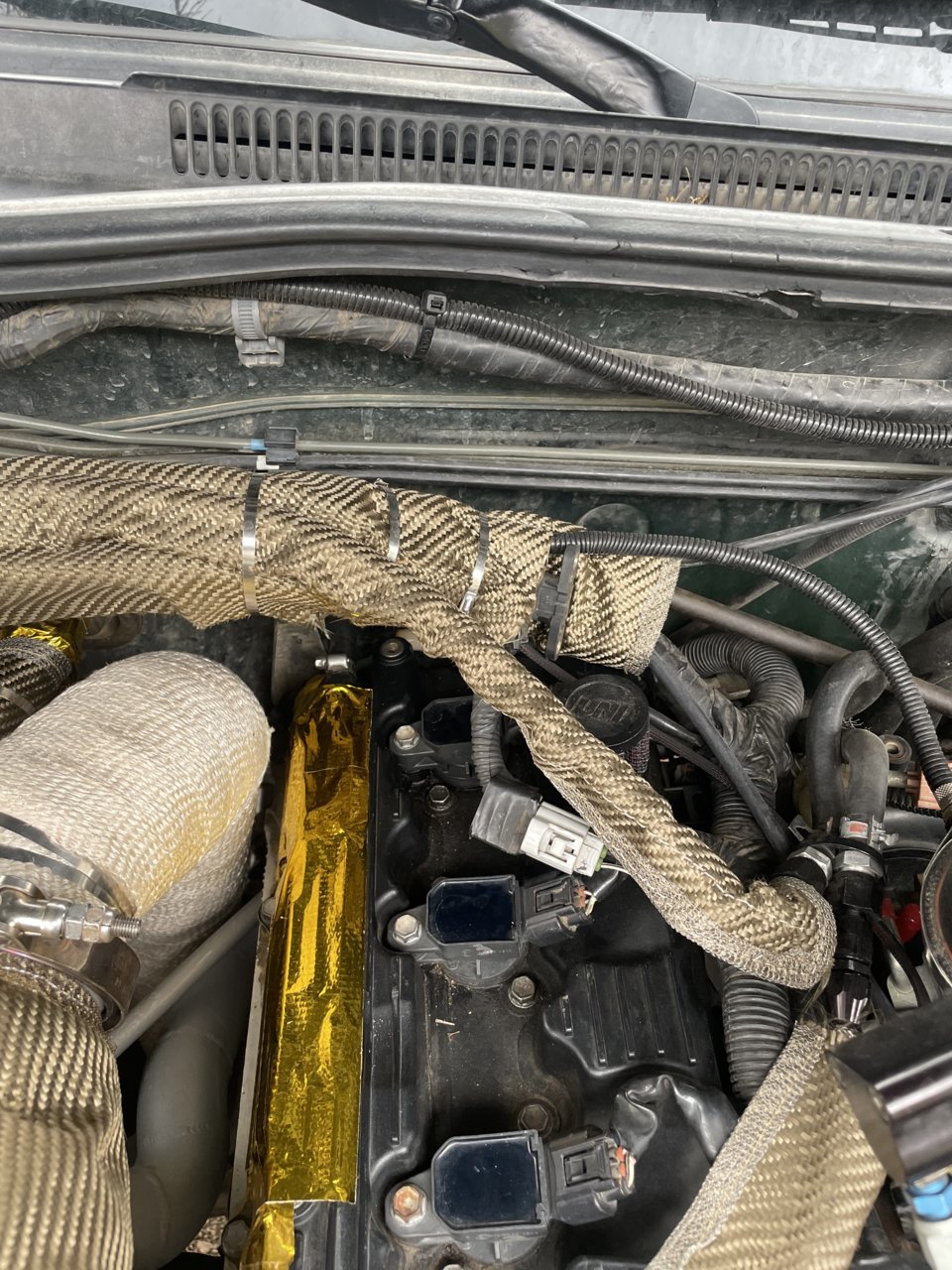

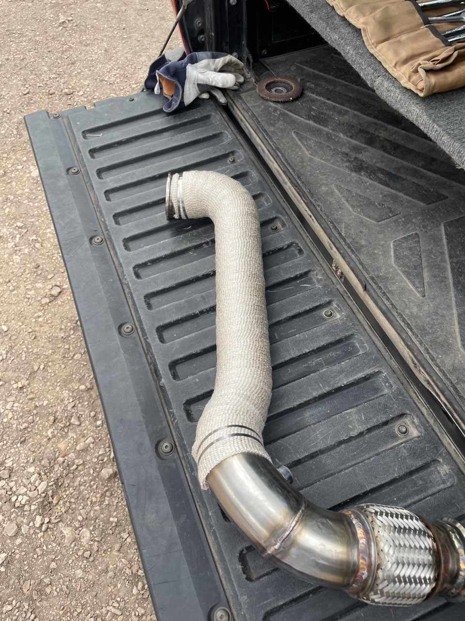

  6. Apr 1, 2023 at 1:54 PM
    #4086
    BassAckwards
    BassAckwards [OP] Well-Known Member
    May 3, 2016
    #186002
    27,954
    2009 Tacoma AWD Turbo 2TR-FE
    Full-time AWD & BorgWarner EFR 6258

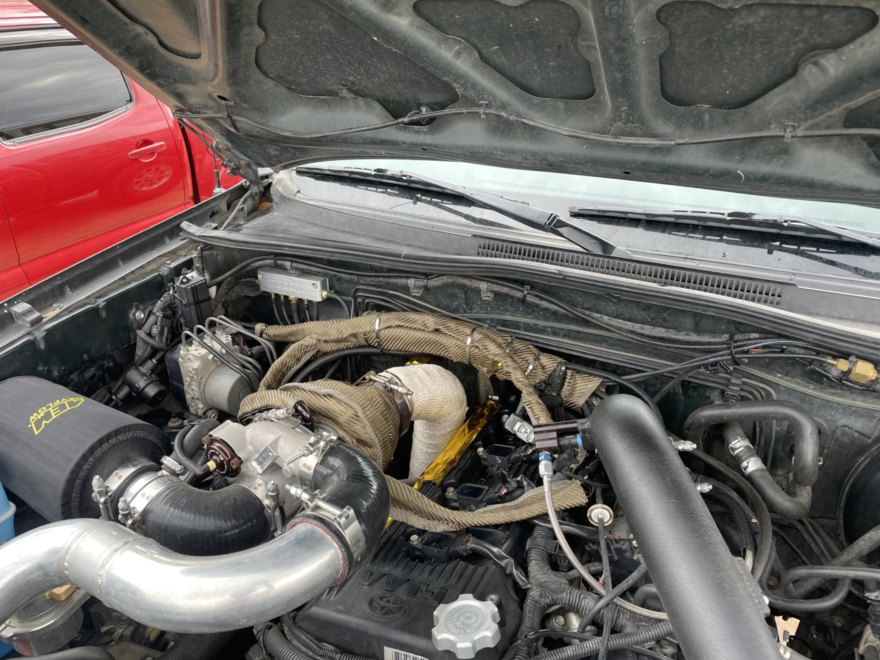

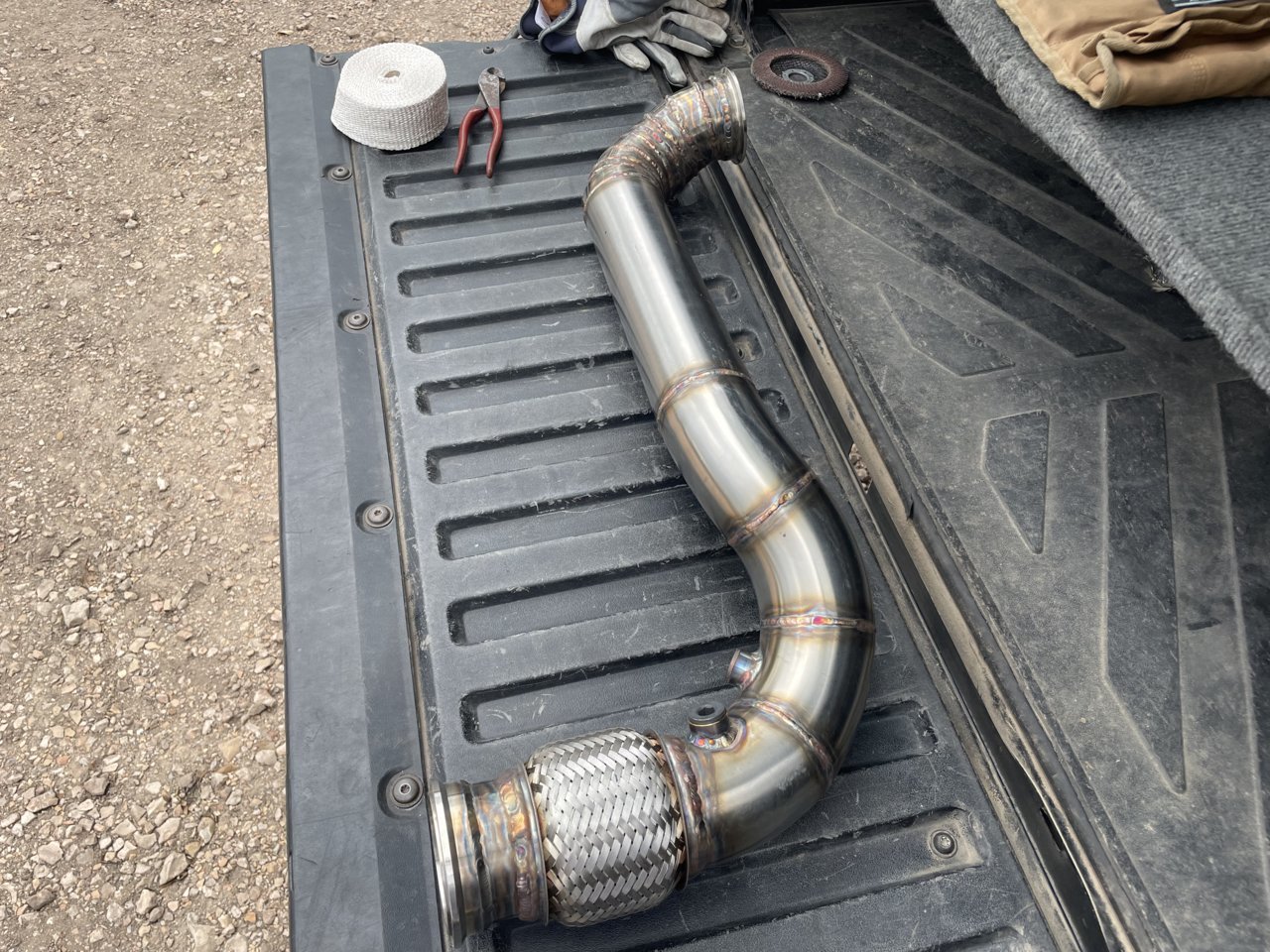

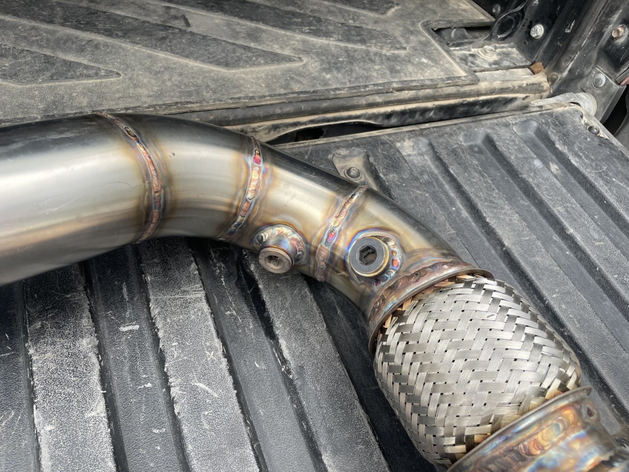

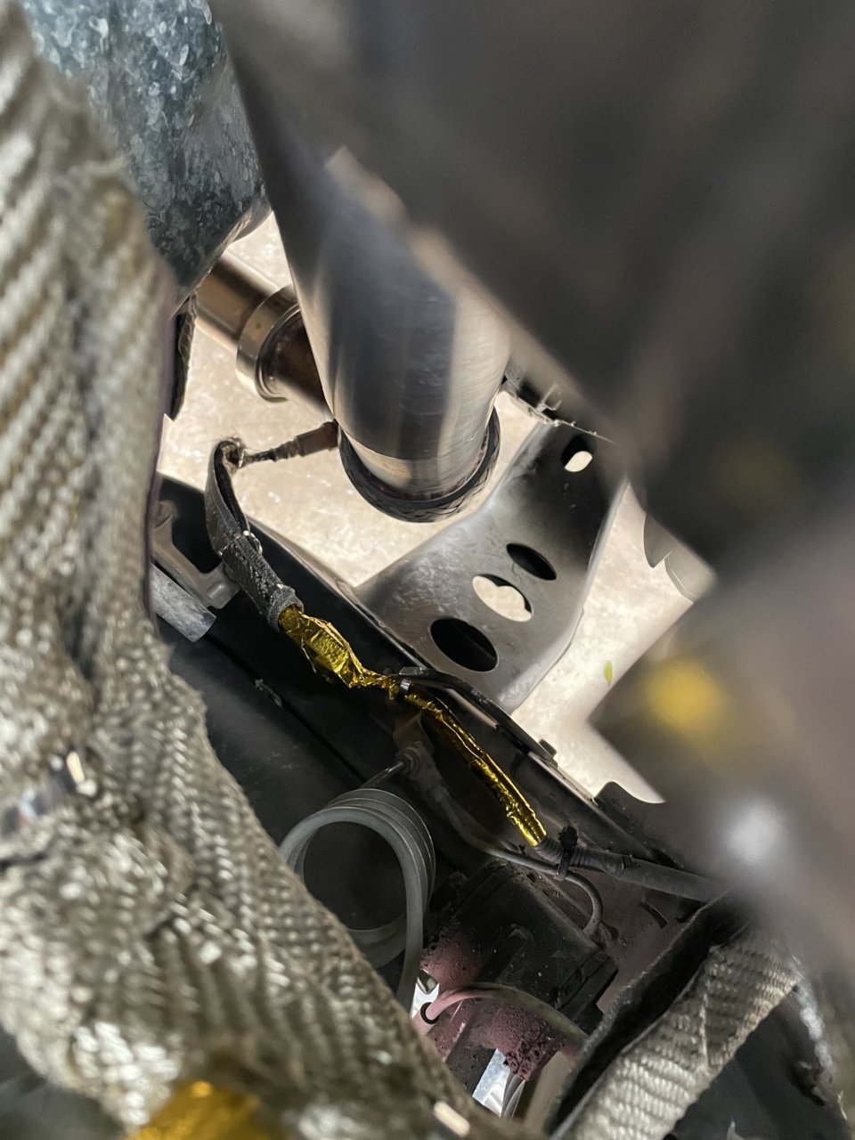

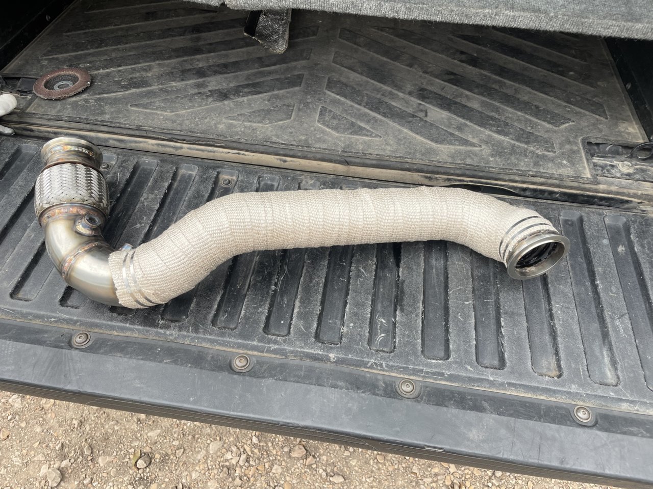

    Did some more heat minimization prep and finished up the down-pipe and wrapped it today. Seems to fit pretty well compared to the old one. I opted for PTP’s Quartz exhaust wrap this time since it’s good for higher temperatures even though it’s a little bit lighter in color. It’s good for 2000*F continuous and 3000*F peak. The lava wrap I had previously was good for 1500*F continuous and 2000*F peak temps.

    That looks really sweet! Good job!

    Thanks brother!

    You improved so very quickly. Impressive.:thumbsup:

    Thanks Mark! I feel like towards the end I was finally starting to get the feel for things

    That's always the way it happens with first time jobs. By the end you have the feel for things, made your mistakes, and know how to do the job better lol.

    Right! I need to just order some more pie cuts and start again lol. The third one may turn out quite nice

    That one will be a work of art hahaha

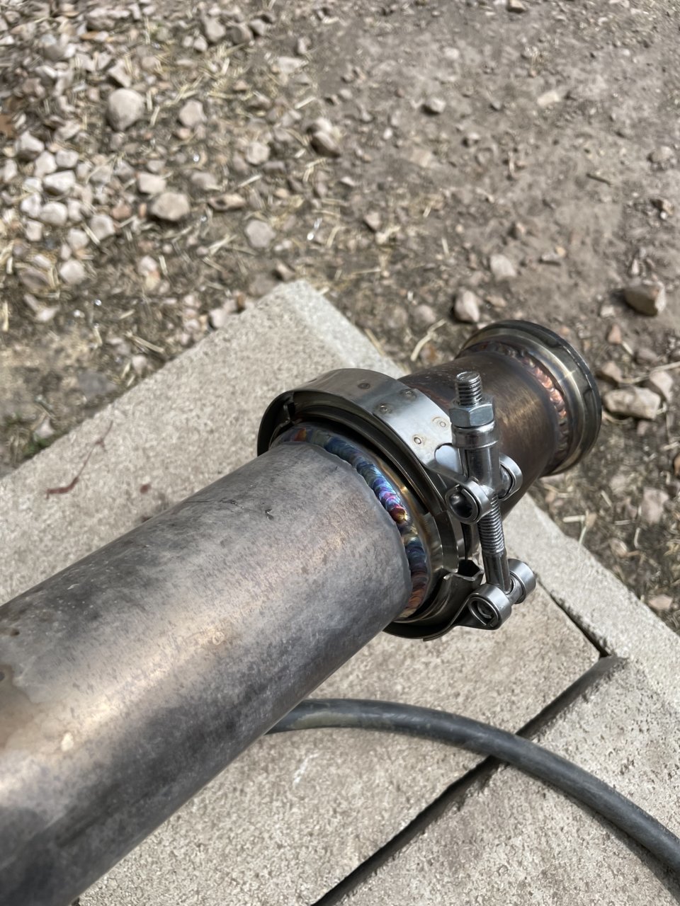

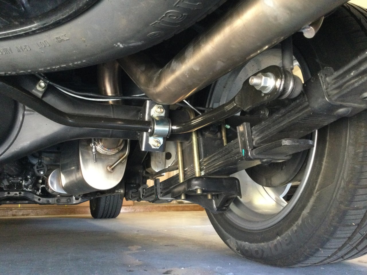

  14. Apr 2, 2023 at 1:45 PM
    #4094
    BassAckwards
    May 3, 2016
    #186002
    27,954

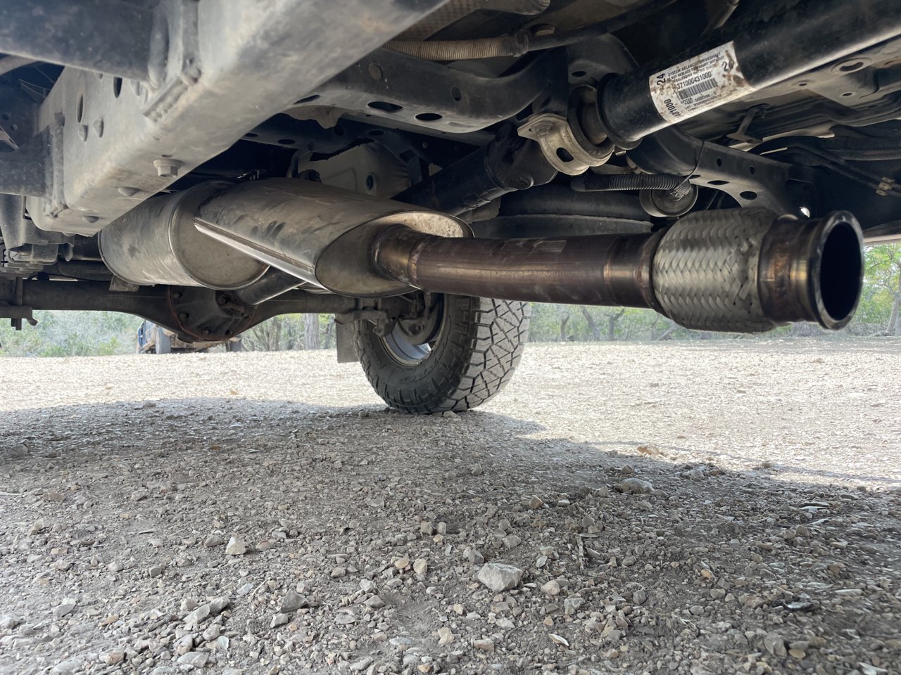

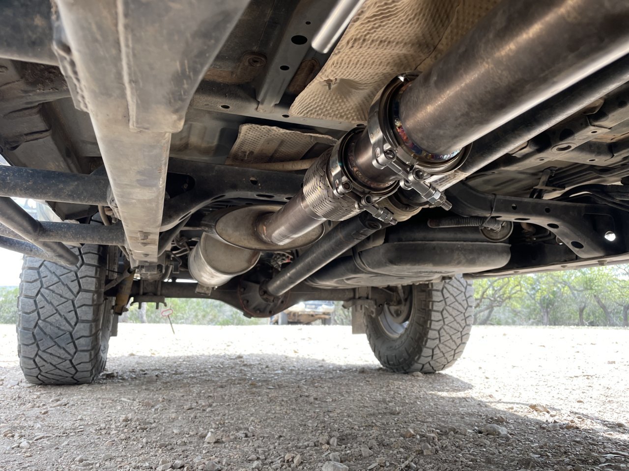

    Took some time today to shorten my midpipe to make my two v6 catbacks compatible with this truck. Got the TRD catback with an extra borla proxs muffler on there to start. It sounds pretty good and quite similar to the 3” catback I had on previously. I’m interested to see what the aFe sidepipes for the v6 sound like!

    Robert,
    I hate you. LOL
    God I have two Magnaflow’s, a 5 x 8 x 14 body w/ 2.5” in & out and a 5 x 11 x 22 body w/ 2.5” in & out with a turndown at where the rear bumper and bedside meet and the supercharger still drones…

    Lol from what i've found, superchargers make the engines much much louder.. The turbo quiets things down quite a bit. This same exhaust is much much louder and has some drone on my supercharged v6.

    Truth ^^^ I chambered muffler can help with drone. As well as various exhaust tuning devices. As in a Hemholtz resonator, for example.
