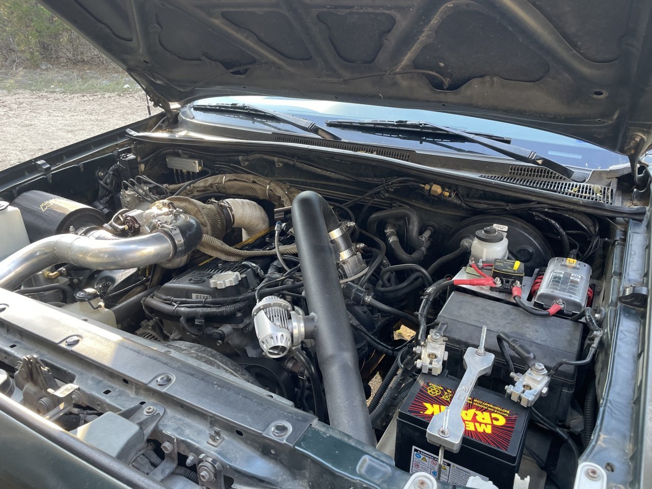

    Replaced my hardware on my Full Race BOV cover today. For whatever reason, they provided mild steel socket head cap screws to go with their nice billet BOV cover. Well due to the heat, they had already started rusting. These are M6x1.0x12mm. Stainless fasteners is this flavor were very difficult to find in my area so I ordered a pack off of Grainger. Added a dab of anti seize to be safe. If anyone needs a few shoot me a PM and I can drop them in the mail for you. Cough cough @Torspd

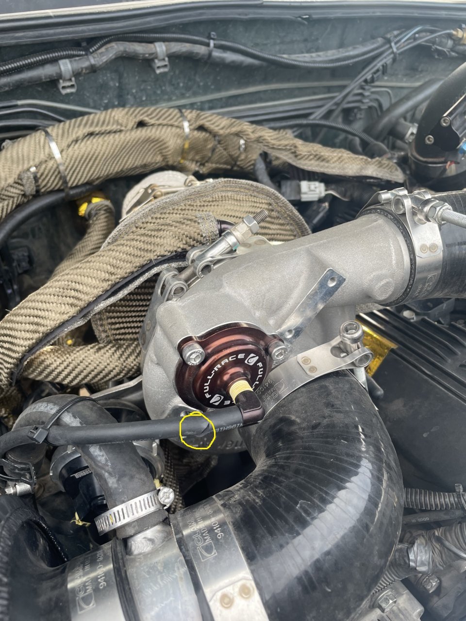

    Doh! Found this vacuum leak at 545 this morning. BOV sounded super weird instead of one pshhh it was more like psh psh psh psh when i would go to shift. Well i broke the line yesterday while swapping bolts for the cover lol. Fixed that baby in the dark and drove it to work today. I love it when there is a simple fix. And as usual, it looks like this was another self inflicted issue. I did manage to put the nut for the clamp back on, i just took this pic before doing so yesterday :D

    Good catch, I had this happen on my car, virtually exactly the same thing; cracked vacuum line from one of the recirc valves. Sounded exactly how you described too.

    Yeah definitely caught me off guard! I was only like half awake at the time, but that got my attention quickly

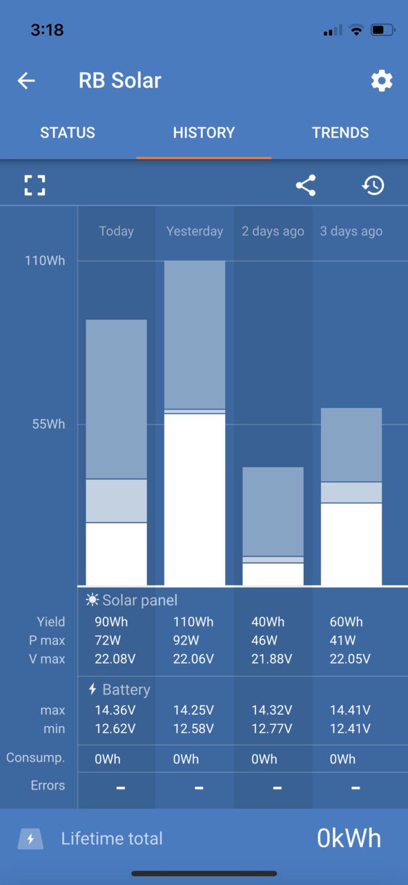

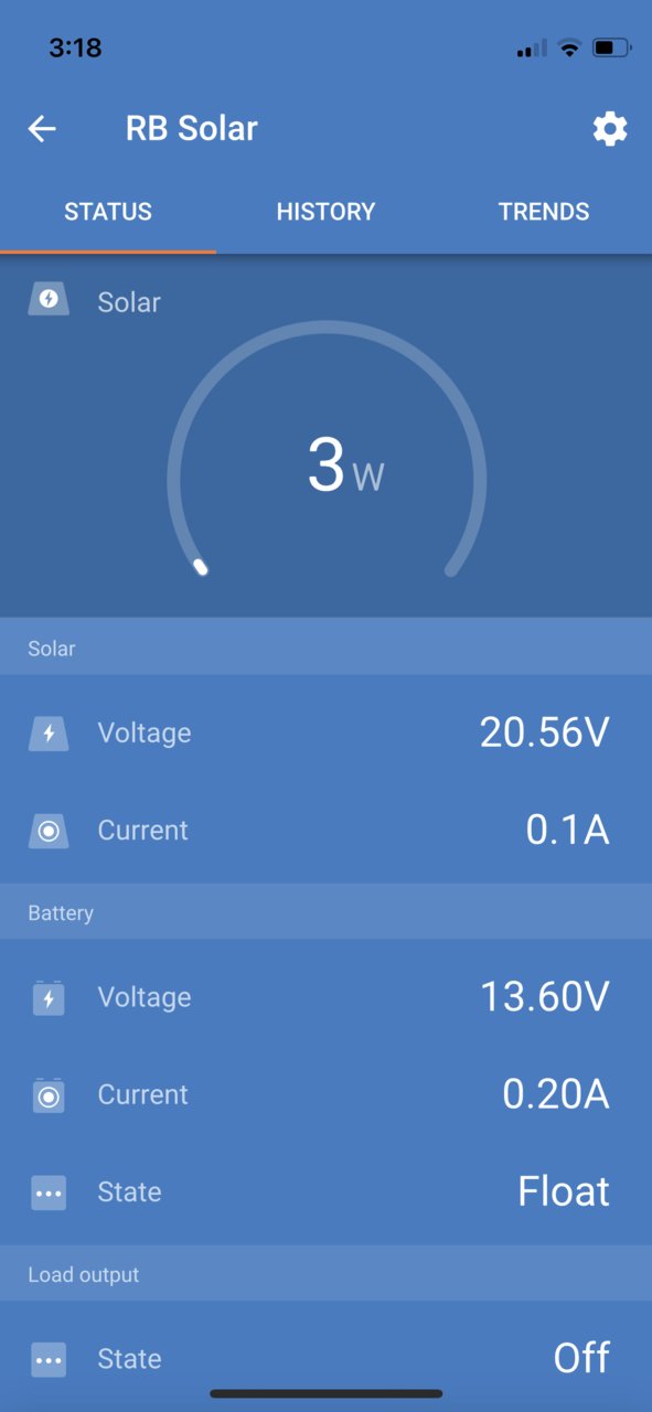

    I did have an issue with my 6 year old solar charge controller where it was overcharging the battery when it would get really sunny. The issue was that it wasn’t going into float mode and only staying in bulk/absorption causing it hit almost 17v, when it should see no more than 15v. So I ended up replacing my charge controller with a Victron SmartSolar 75/15 MPPT with Bluetooth so I can keep a closer eye on things, and have control over more of the settings/max voltage it sees. Here’s a few of the things you can view on the app 637FD8E3-6303-4A96-95A3-84B356B450B7.jpg

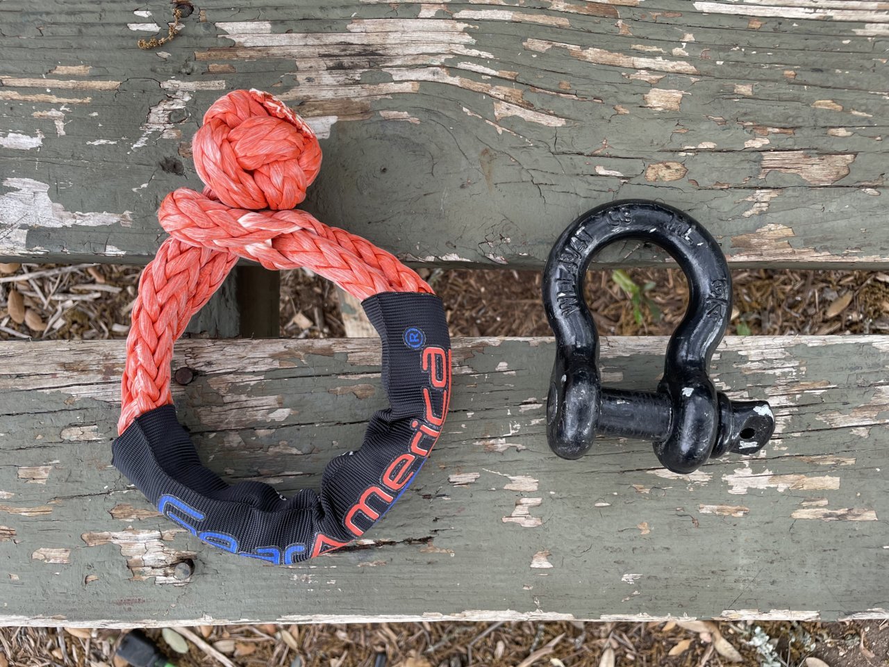

    I also bought a GearAmerica soft shackle to replace my steel one. Very pleased with the quality there. Last but not least, I ordered a 12-15 seibon hood and some OEM 2015 TRD pro headlights for a little facelift for the truck. AWD swap will be starting soon as well, weather permitting. There’s been a chance for hail here lately almost daily so that has been holding that project up unfortunately
