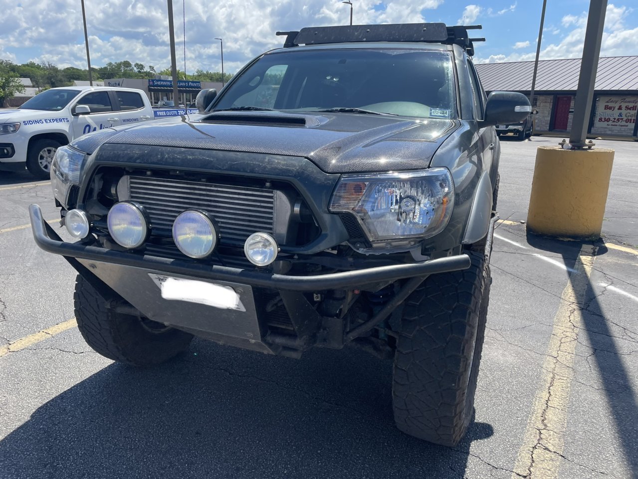

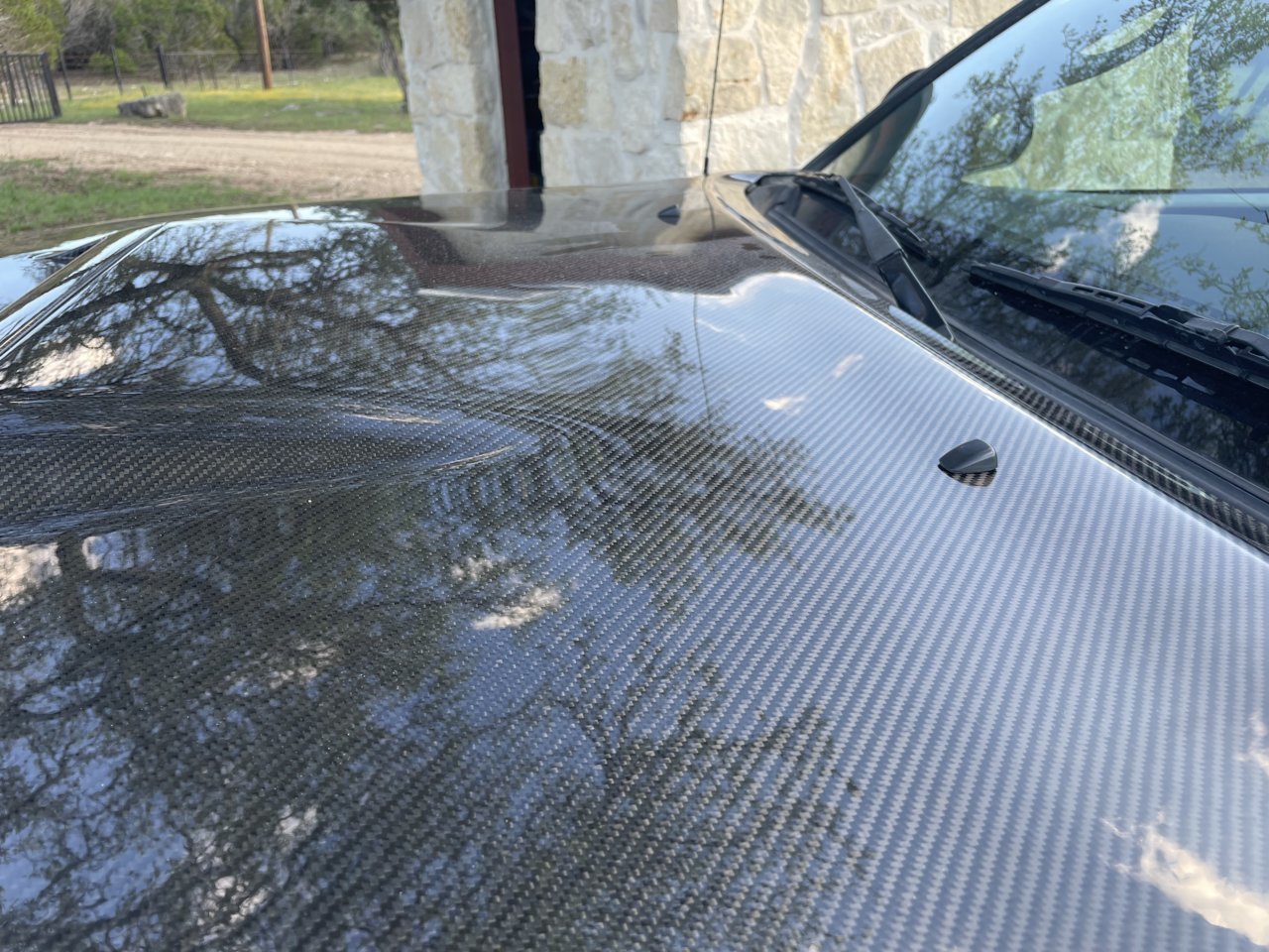

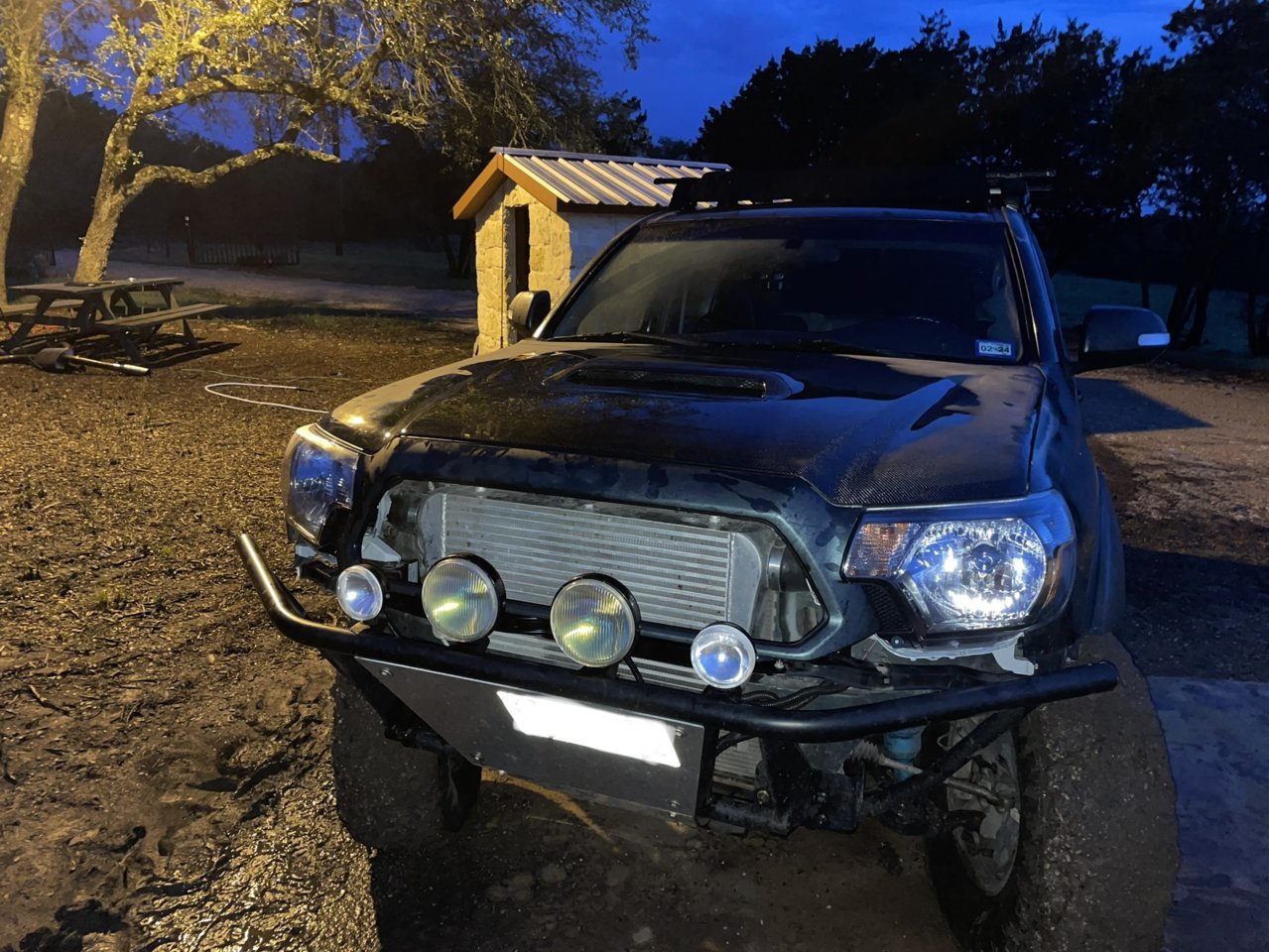

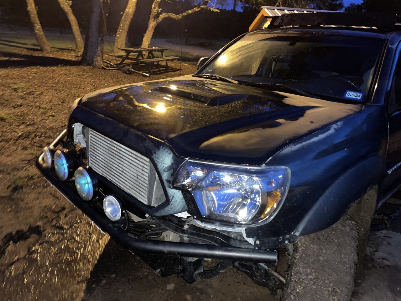

    Got my seibon carbon fiber hood, 2015 pro headlights, and 12-15 front clip conversion done tonight. I broke one of the clips that hold the lower headlight fillers in but it’s mostly complete for now. Those pieces have already been painted and cleared so I will pop them in once the new bracket comes in. Super stoked with how it turned out though. Just need some hood pins now.

    Looks mean, I like it!

    That looks fantastic even in poor lighting! Doing the hood pins is a bit nerve racking. I know this well. Take precautions and they will go smoothly.
    Now you're ready for some Rally Ready!!! :D

    Thanks Russ!
    Thanks for the offer Randy but i might have to end up buying another grille. The one i have now is painted chrome and it's starting to look a little rough in some places..
    Thanks! I will try to get a better pic of it today when the sun is out.

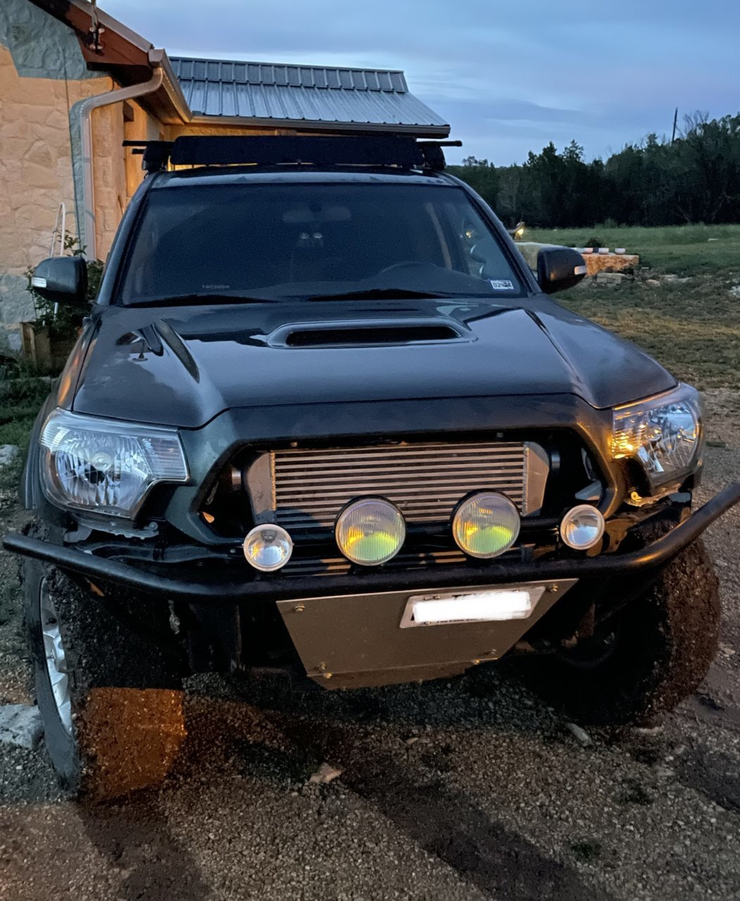

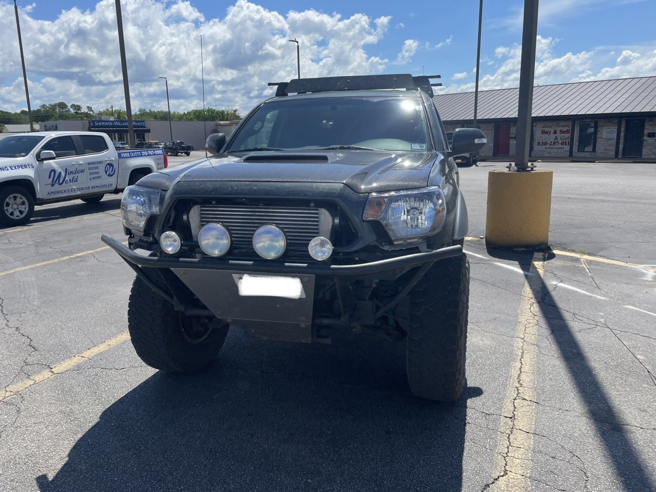

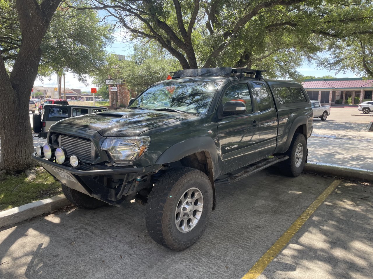

    Here’s some more pics

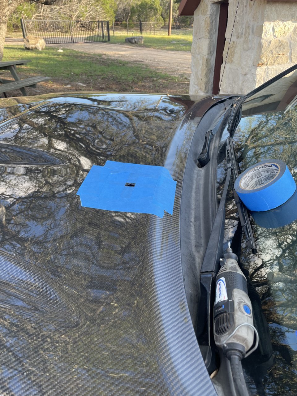

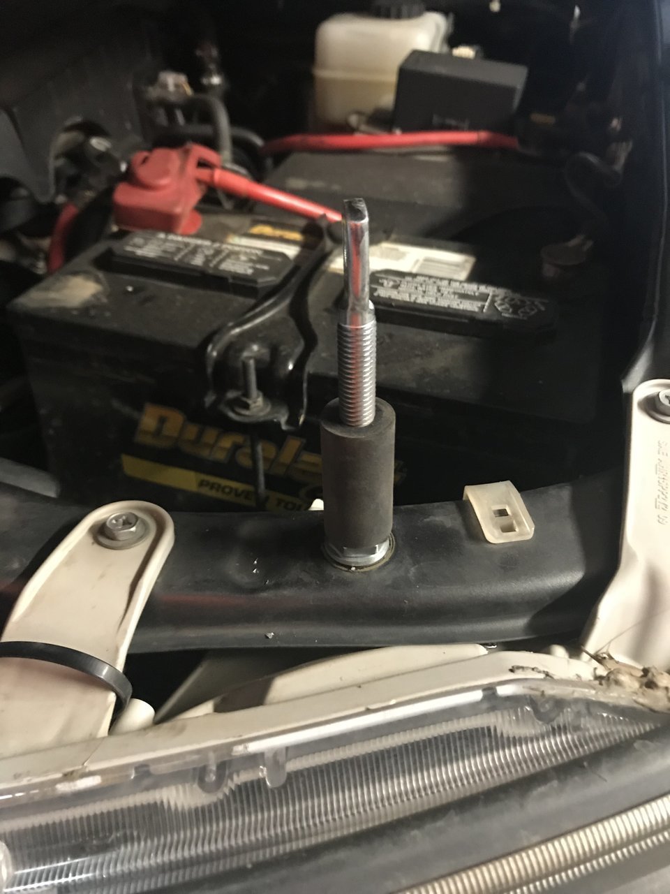

    Got the washer nozzles in today. Blue tape saved me from myself at one point lol. Glad I took the time to throw that down

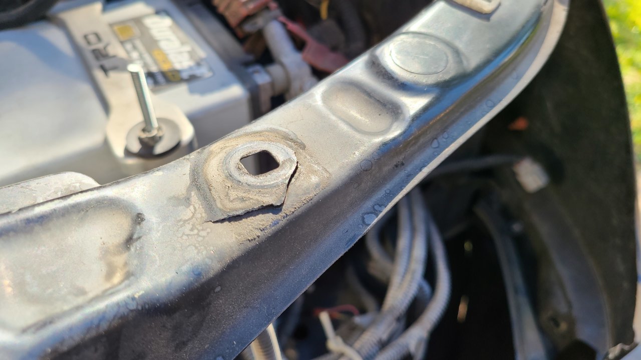

    Still doing some research, but I found this on TW and I’m leaning towards doing this. I might rotate the latch 90* though vs the picture. @Torspd what did yall use to cut the hood on Robert’s truck?

    Tape, and double tape even. That litter effort saves the purity of the parts. Well done.
    We used the dremel tool. I used the router attachment with a bit that is for plastic and maybe wood. It has a long open spiral flute.

    I also highly recommend using as large of washers possible to secure the anchor. The vibrations over time do affect that thin sheet metal.

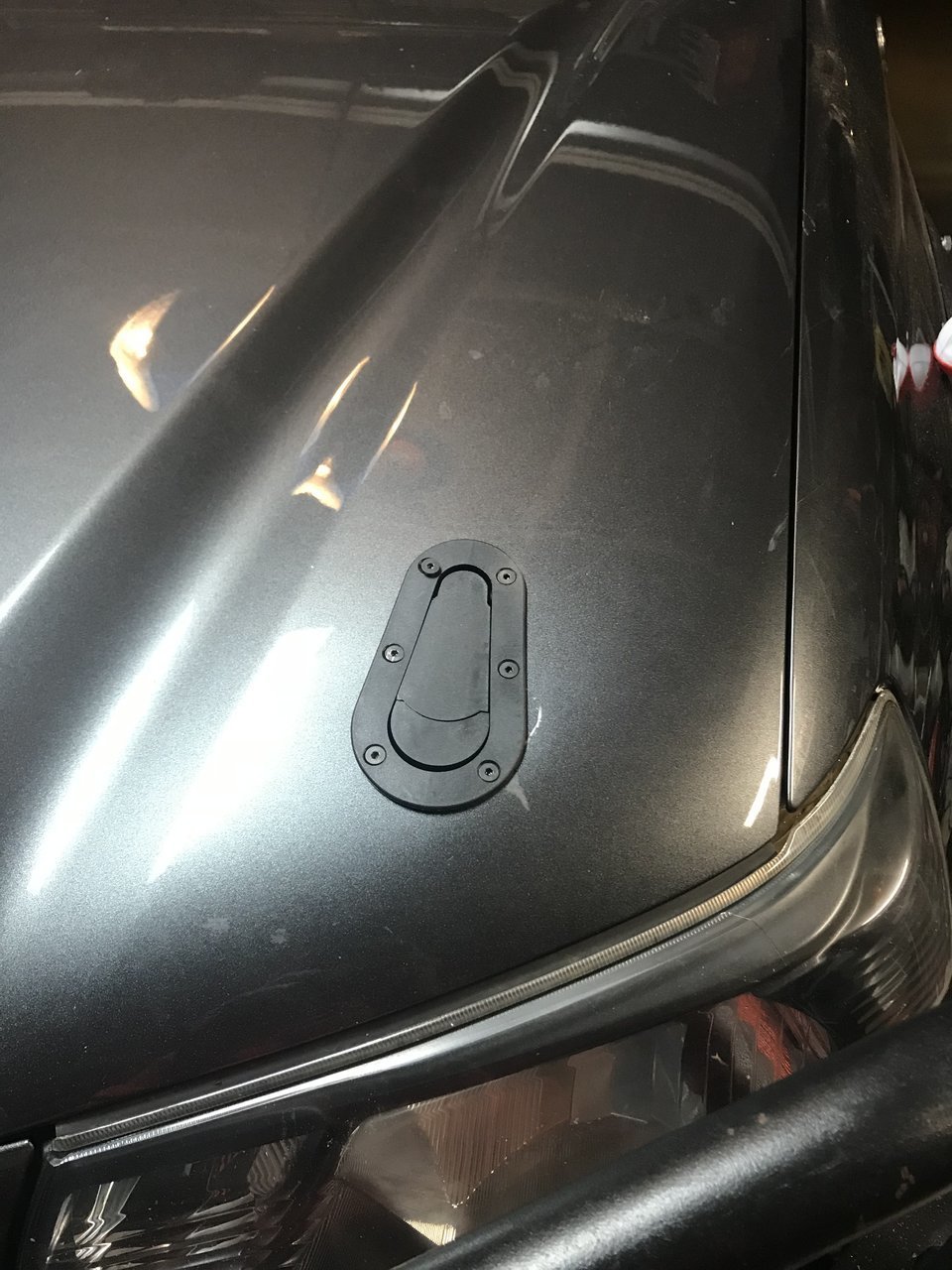

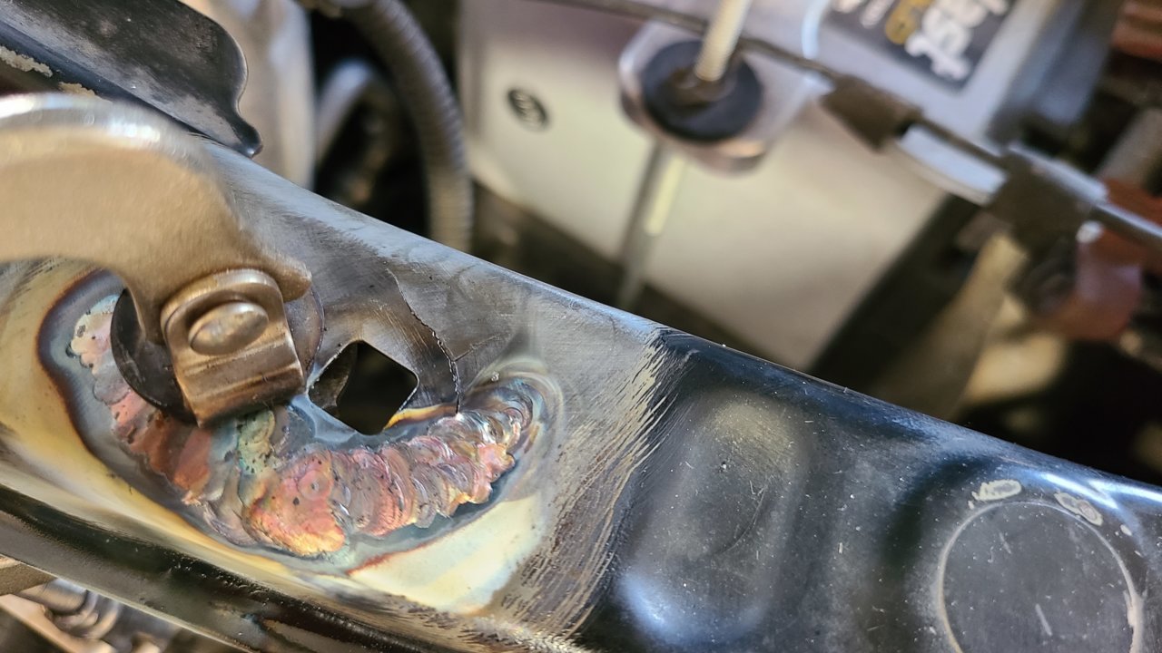

    Well other than some bigger fender washers, the Aerocatch hood pins are installed. Took me about 5 hours from start to finish. Boy I am glad that one is over with. I was about sick over having to cut into the hood and worrying about messing it up lol. So much relief now, and don’t have to worry about the hood fluttering around on the hwy anymore

    Nice work, that looks deadly! It's definitely nerve wracking cutting into anything auto body, especially a nice expensive carbon hood Hahaha.
