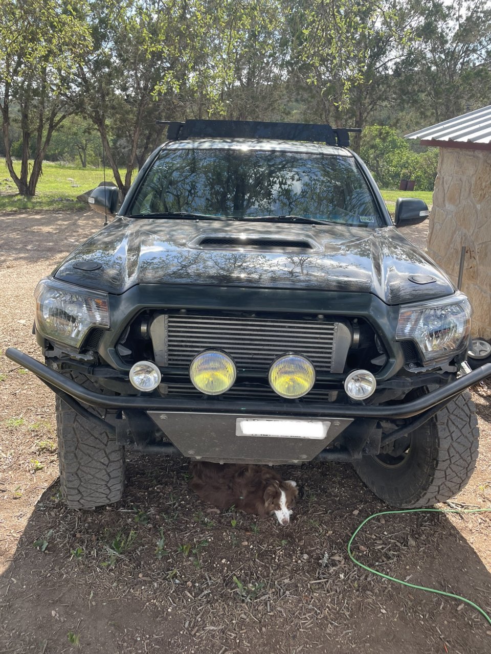

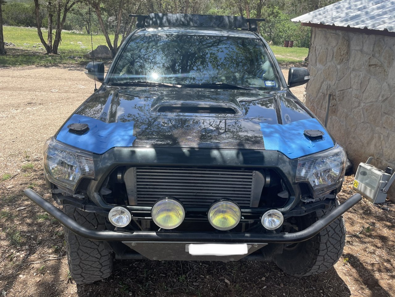

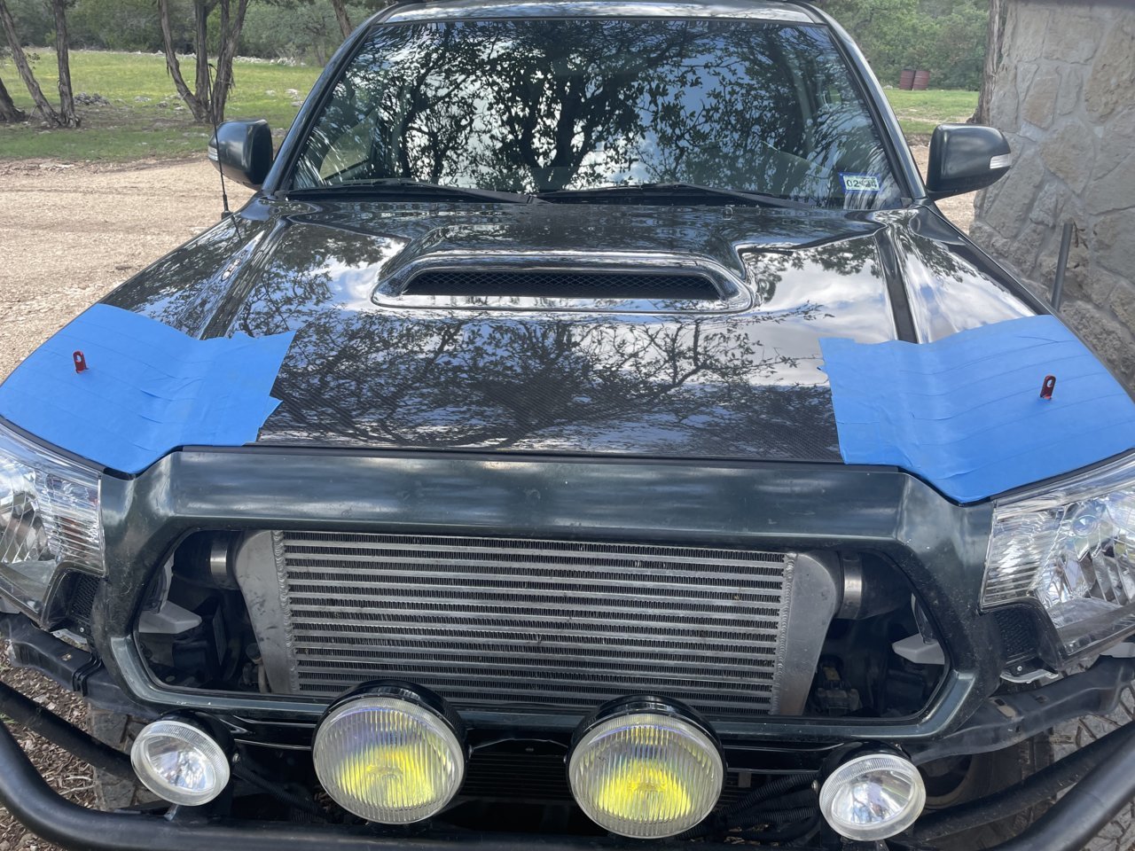

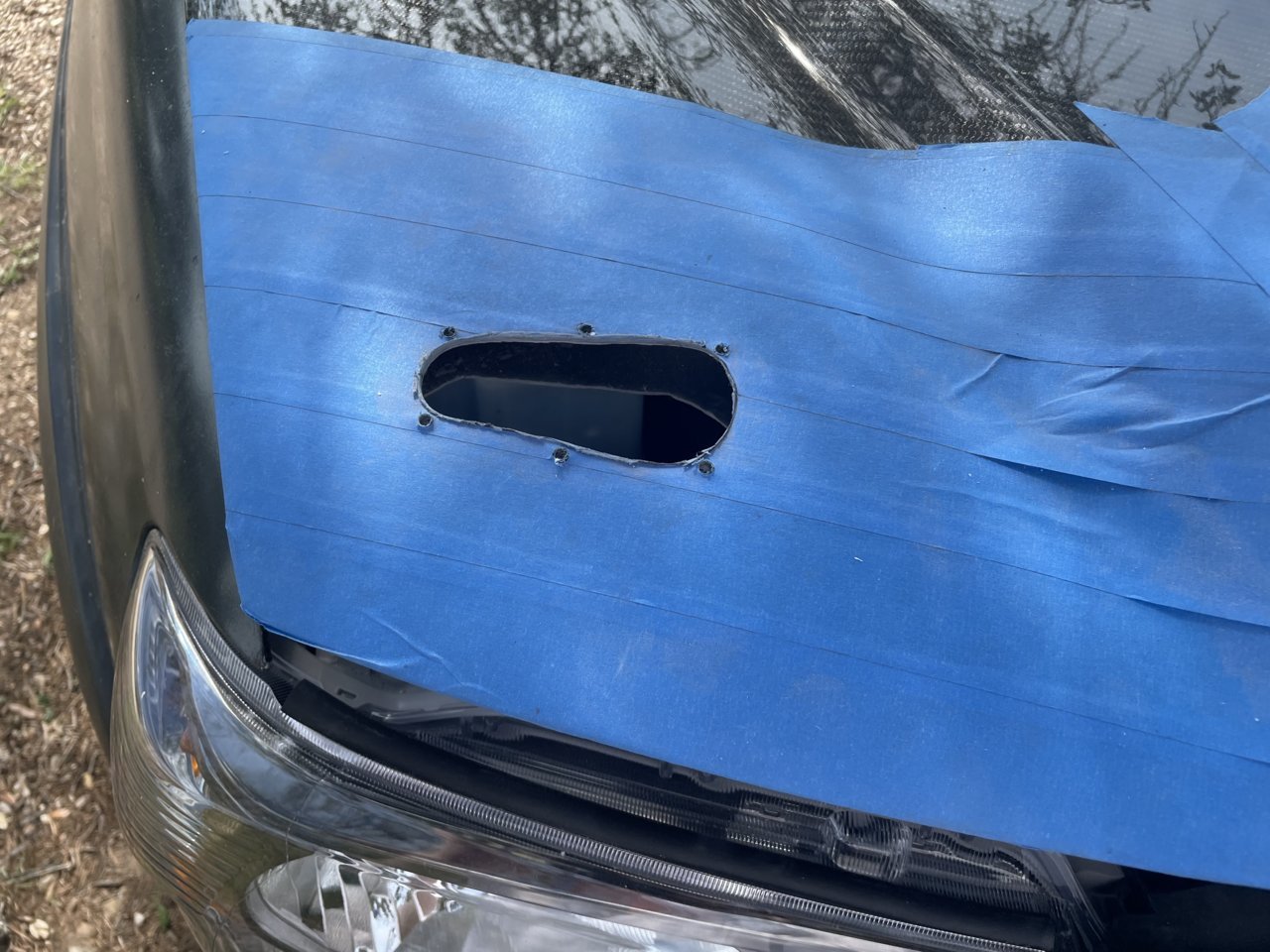

    Thanks buddy! And dude the pressure was on lol. One mod that I did not enjoy, but it needed to be done.
    The carbon was really easy to cut into. Similar to fiberglass, but without the itch. I used a dremel with a harbor freight diamond cutoff wheel. Used only one for everything.

    Even your pup likes the new hood and latches!

    When I did, @Lucario Runner 's, my anxiety meter was bouncing in the red. I had to internalize that to a dark abyss. Lol. So yeah, I think that applies to all of us at some point.

    Lol I think she was getting bored of me pacing back and forth hundreds of times. Sure was beautiful out yesterday. I’m glad I did the install then.

    Man I should have brought them to you for install. You’re starting to sound like a professional keeping your cool and all. I was sweating bullets:D

    Sounds like you both conquered mind over matter doing that job

    All the anxiety. But steady hand and good planning nets good outcomes.

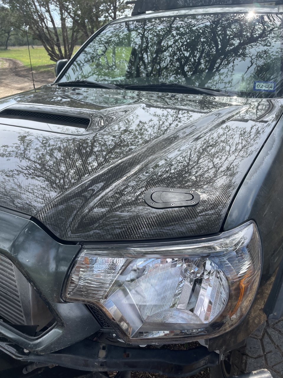

    That looks nice. I wish there was a carbon roof replacement, the paint on my 2005 is failing and will need a paint job.

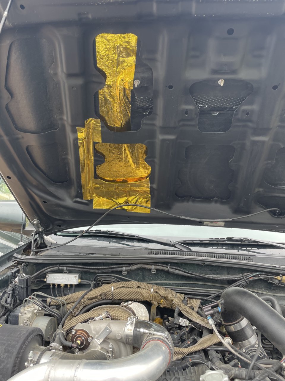

    Started working on heat shielding for the underside of the hood, but ran out of materials. Got some more on order from PTP.
    Also got the lower headlight filler pieces installed to complete the front clip swap

    So is the hood half stamped sheet metal and half carbon?
    Also that gold heat reflecting stuff varies quite a bit in thickness. The gold stuff I purchased was a big name brand and was crap as far as I was concerned. I then found this stuff in silver and it was a lot thicker with the fiberglass or whatever they use. I really don’t know but common sense would say the thicker the better for blocking heat. But I really don’t know! :notsure: Maybe someone can enlighten me?
    https://www.amazon.com/gp/product/B07JMHWCPG?ie=UTF8&th=1

    The hood is full carbon fiber from what ive seen after cutting into it.
    The stuff im using is 6mm thick. Here's a link to it https://www.ptpturboblankets.com/co...rs/products/ptp-gold-adhesive-thermal-barrier
    Im not sure how this stuff compares to the other stuff out there, but i can say it has saved my plastic valve cover from the heat of my turbo down-pipe running right by it. I figured it'd be good for the hood as well. I am not sure if thicker is better or if there is a big difference in the heat abatement abilities of the different materials.
