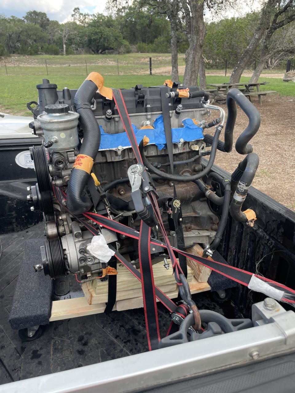

    Time to break out the engine stand! Thanks again @Hayrider :hattip:

    Sweet, she looks nice and clean. Good to be a built engine?

    It is super clean for sure. I need to track down some paint for the block but other than that it’s like new.
    This one is going to get a head gasket, ARP head studs, upper oil pan swap, and a general refresh and then it’s going in the truck. Then the plan is to pull my old block out and build that one for 20-25psi.

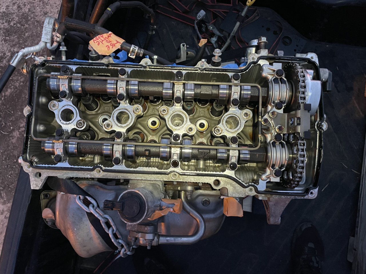

    I did not, but by the look of your truck and everything else that came out, I’ll take your word for it! Everything was super clean. No worries on the block being a little rusty, that is kind of inevitable. That’s easy enough to get cleaned up
    I will keep you posted if anything is missing but I think it’s all pretty complete.
    I’ll post up pics once I get the head removed, but I popped the valve cover off last night to have a peek. Still looks factory fresh!

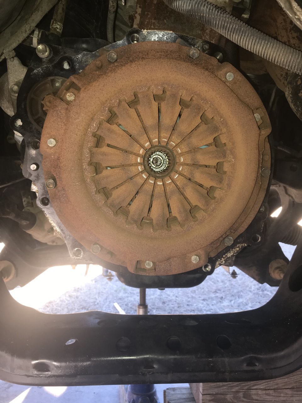

    Yeah, Andy sent me a photo of the Flywheel and it was fairly rusty too! Actually I was surprised it was that rusty.

    Yeah the R155 doesn’t seal up very well so there is moisture that gets in there. Here’s one I pulled out that looked like it had been under water lol. That dirt road did seem to go on for a good bit, if you aren’t used to it I bet it felt like forever! Don’t sweat it on the oil I will start out draining it once I get it on the stand. Both pans have to come off anyways for the turbo oil drain.
