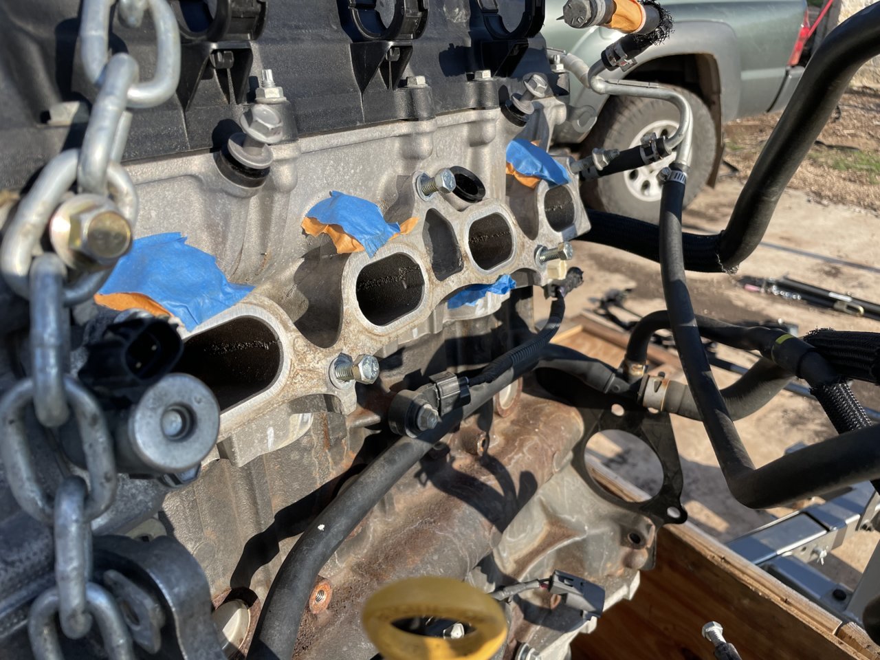

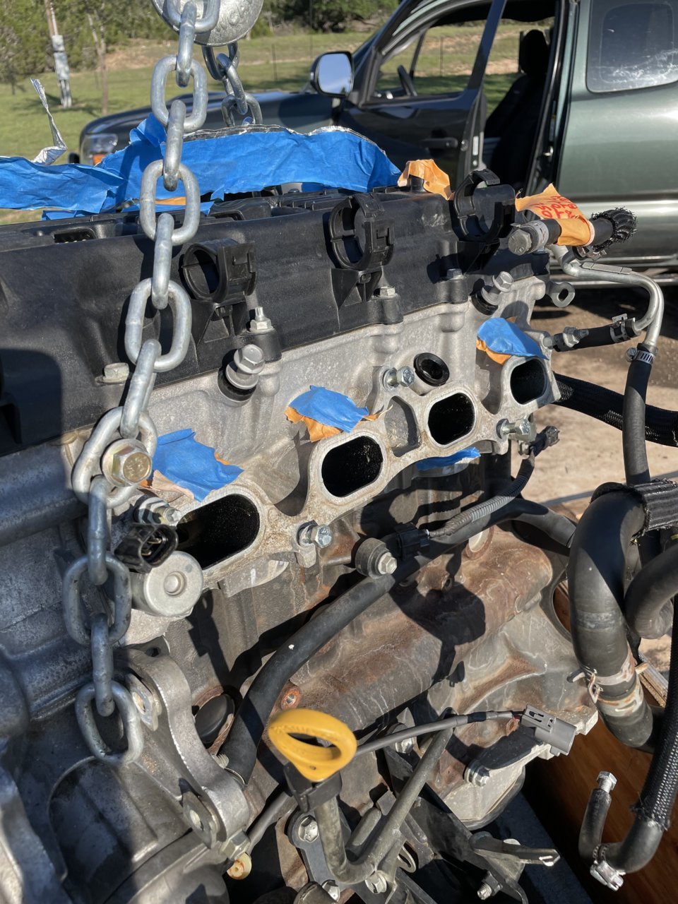

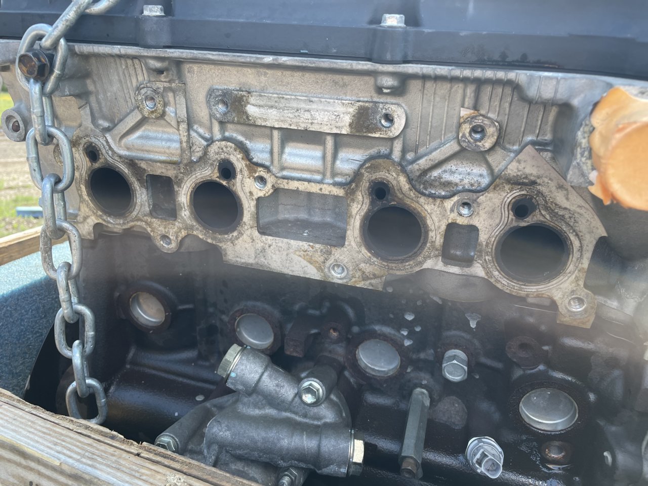

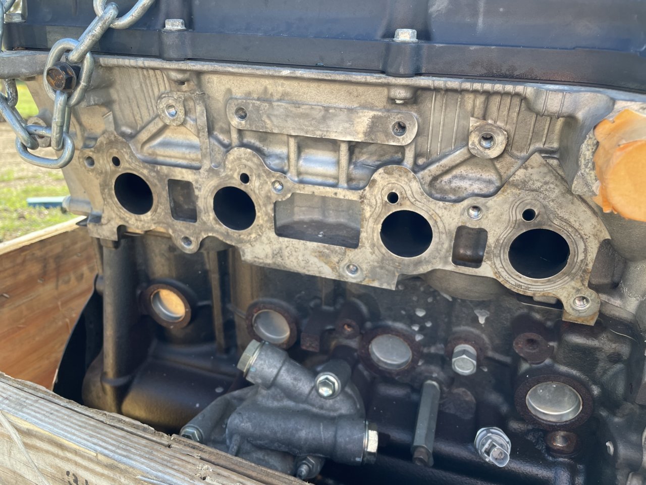

    Did some cleanup today where the head meets the header. Also removed all of the toyota exhaust manifold studs and chased them with a M8x1.25 clean out tap. Now they will accept LS1 ARP 4341301 exhaust manifold studs.
    Also cleaned out the oily grime from the intake tract that inevitably accumulates over time. Hoping my catch can and some water methanol helps to keep
    this tidy in the future. Took my time and used paper towels, brake cleaner, and a pick to get everything I could. Having the motor on the crane made it super easy to move it side to side and use the sunlight to my advantage. My slight ocd may have taken over here lol. Might smooth out some of the intake and exhaust ports when the head is off for a gasket. Some of the casting marks would be pretty easy to knock down and should help with flow. These can be seen in the last pic, but there are some around the exhaust ports as well

    So I intake ports were pretty oily still? o_O
    Yeah I’m thinking the meth & water mixture wouldn’t really clean oil.
    I’m really curious about the piston tops and valves? *I* would think it would or should have cleaned the carbon buildup a bit. But now thinking there’s not that many miles of running the mixture through the engine and as I told you an elderly lady was the original owner.

    Yes the intake ports did have a good bit of build up still. The tops of the valves look super clean on the intake side. I will let you know what the tops of the pistons look like after I have some time to pull the head. I do think the oily build up is normal, but I am betting with a catch can from the start and some water methanol, it will probably be minimized.

    I appreciate that, but i dont think there's anything to worry about. Everything i have seen so far has been immaculate for this engine's age. That oily build up in the intake was much heavier on the engine that's currently in the truck, and it's running like a top. The one in the truck ran without a catch can for like 280k miles so there was quite a bit more to clean up the last time i did the head gasket on it.
