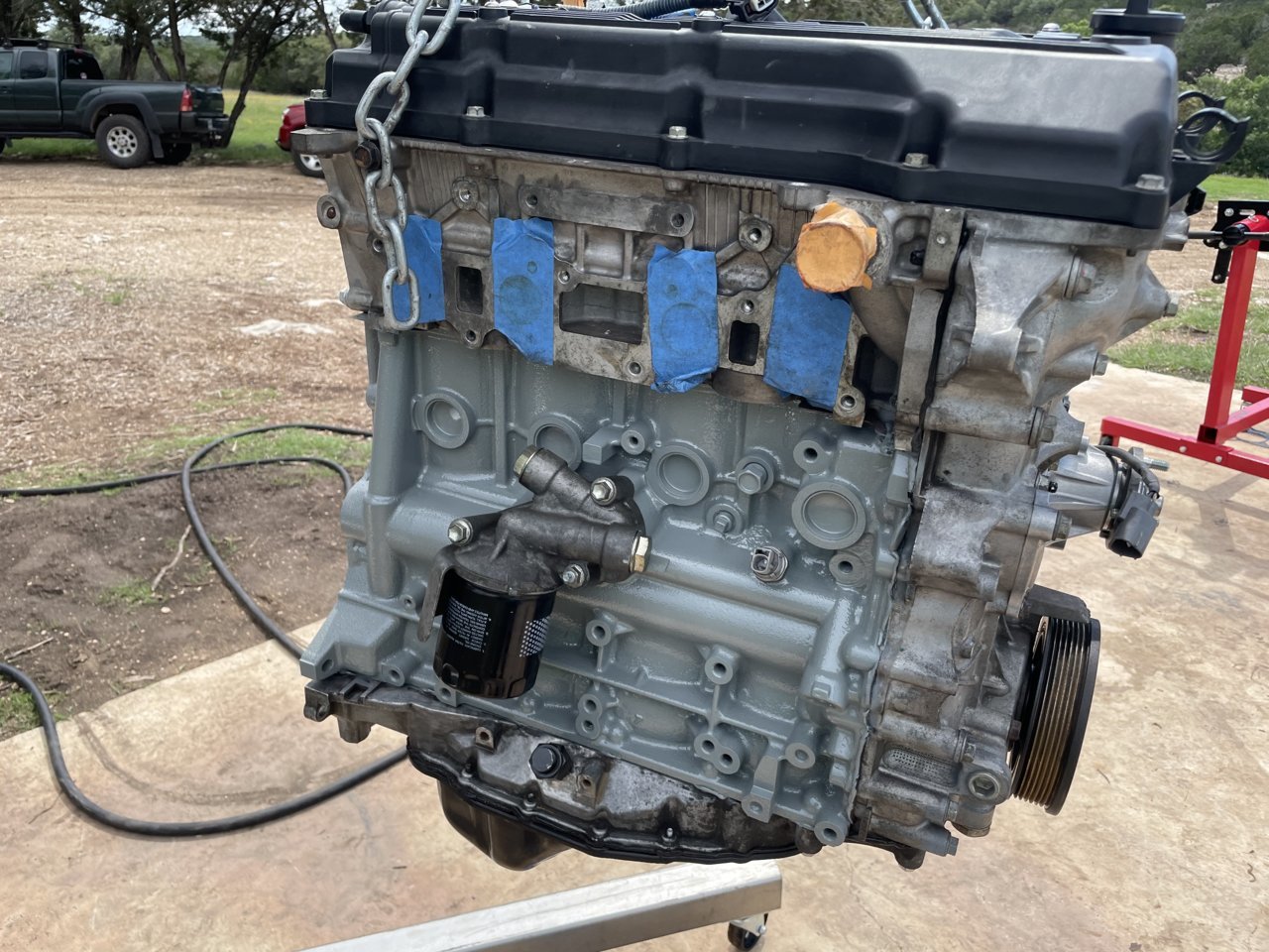

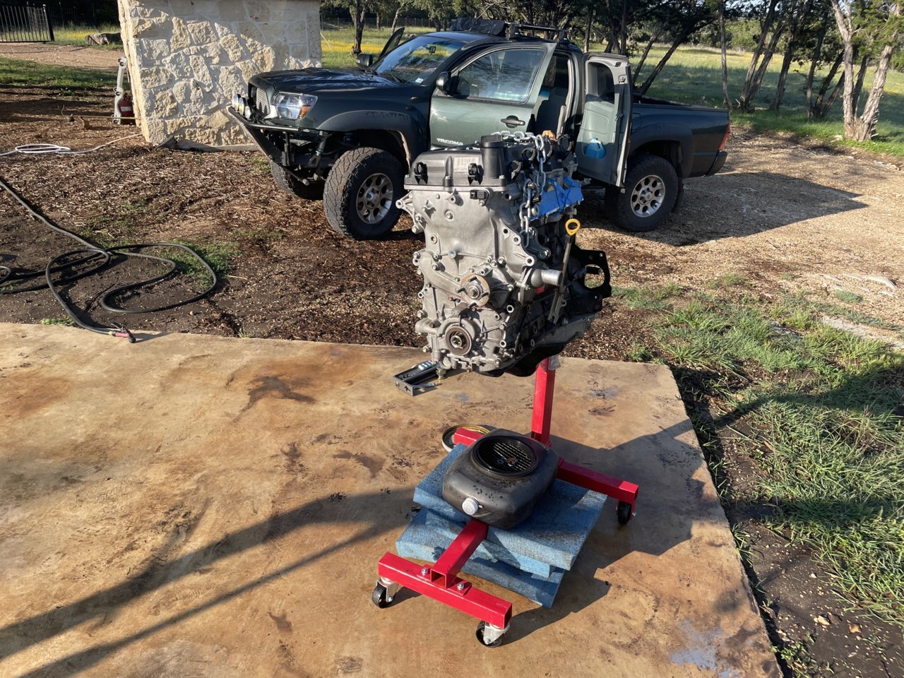

    This is @Hayrider ‘s old engine. Has about 36k miles on it, so it’ll be a big upgrade over the current one in the truck
    This was kind of a spur of the moment decision since I’m at the mercy of the weather. You’re welcome to come out and turn some wrenches though. There’s plenty to do!

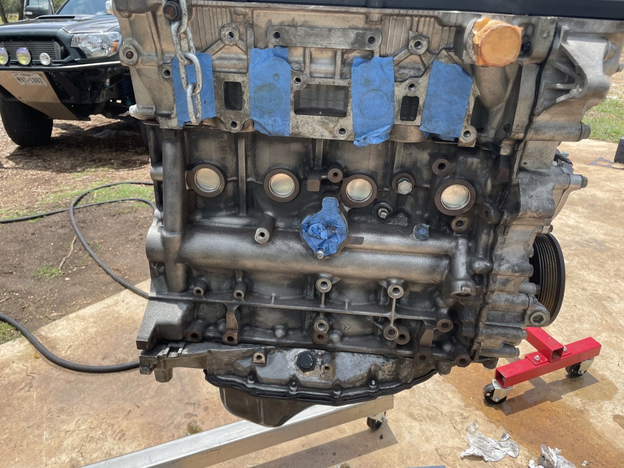

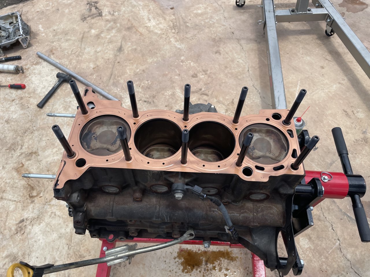

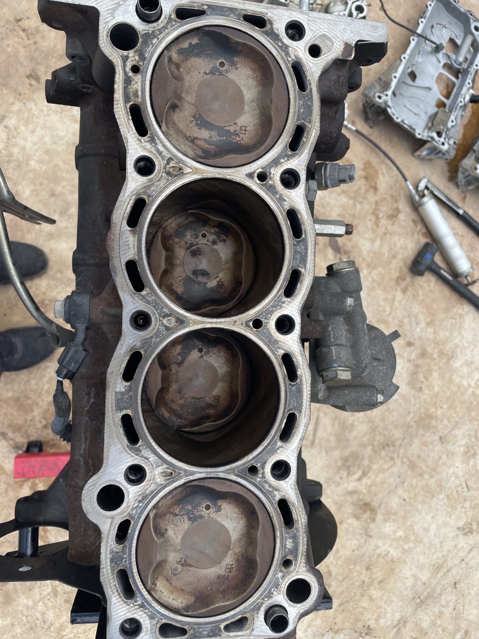

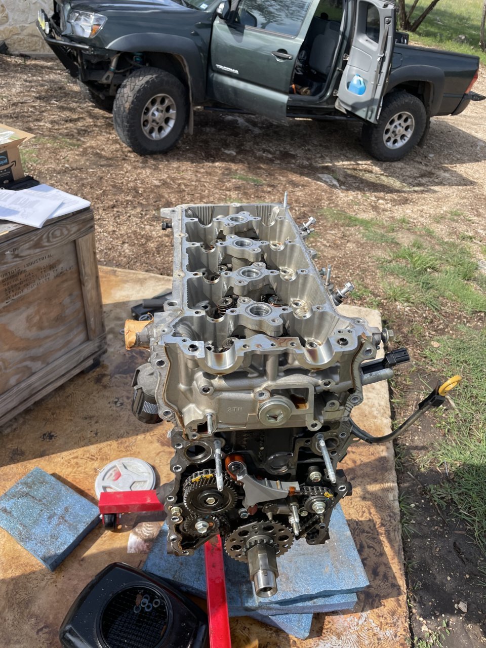

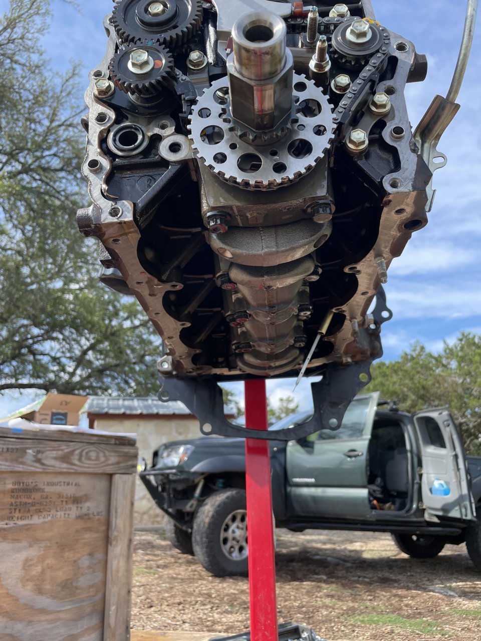

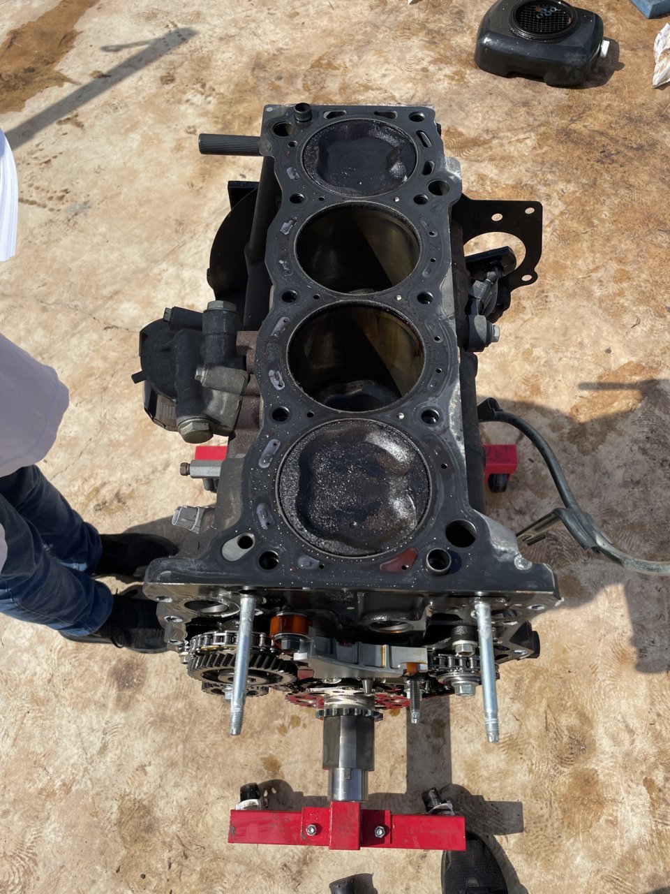

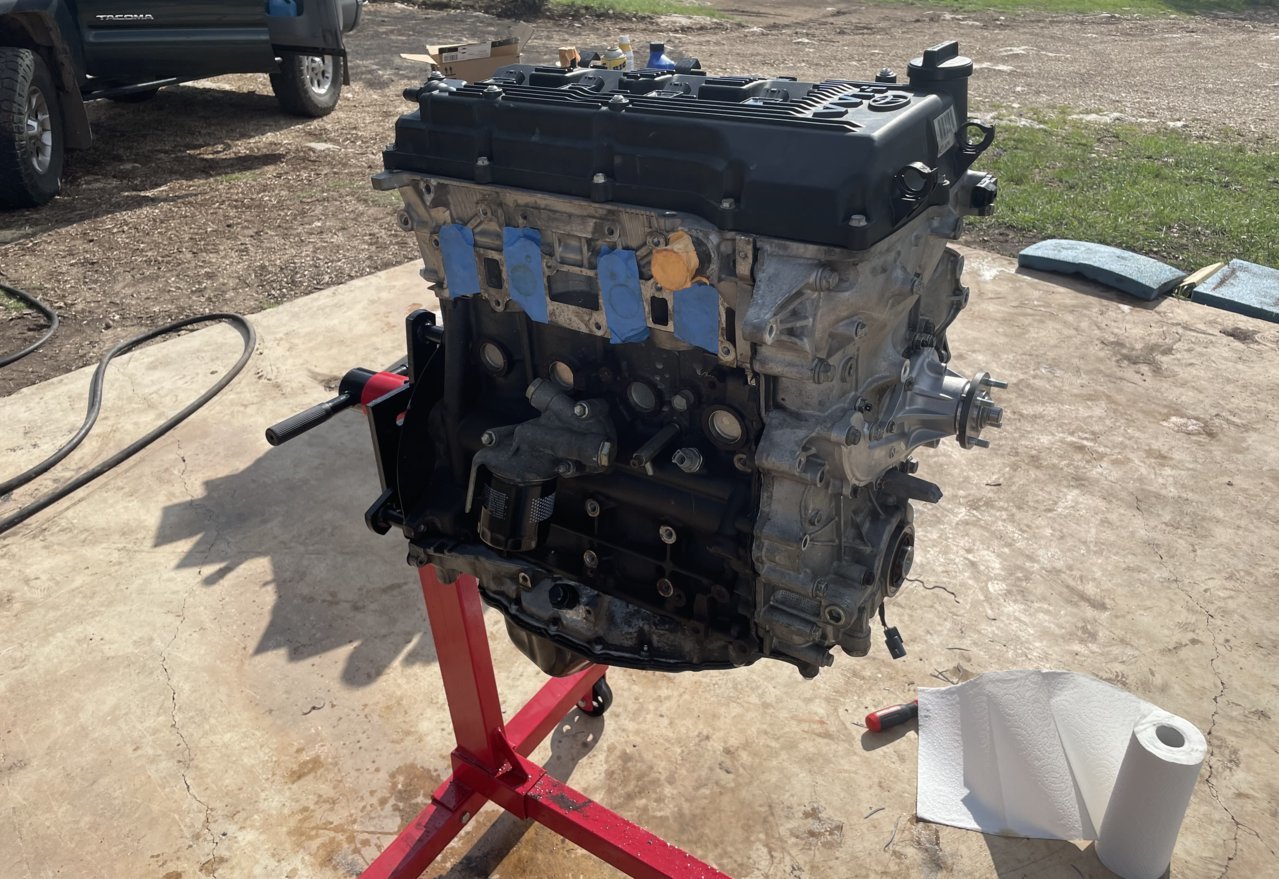

    Got it torn down to a short block in about two hours! Everything is looking fantastic so far. Head gasket wasn’t far from failing between cylinders 3 and 4. This is where mine have failed in the past running stock head bolts with boost, so I’m not surprised- this is why I recommend running ARP studs with any type of boost on the 2TR. I’ve had two head gaskets fail within 5k miles of adding boost and using the stock head bolts.

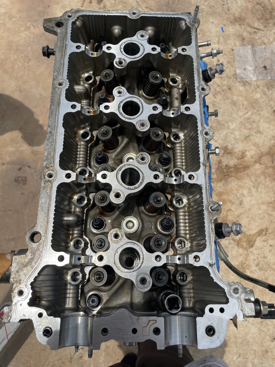

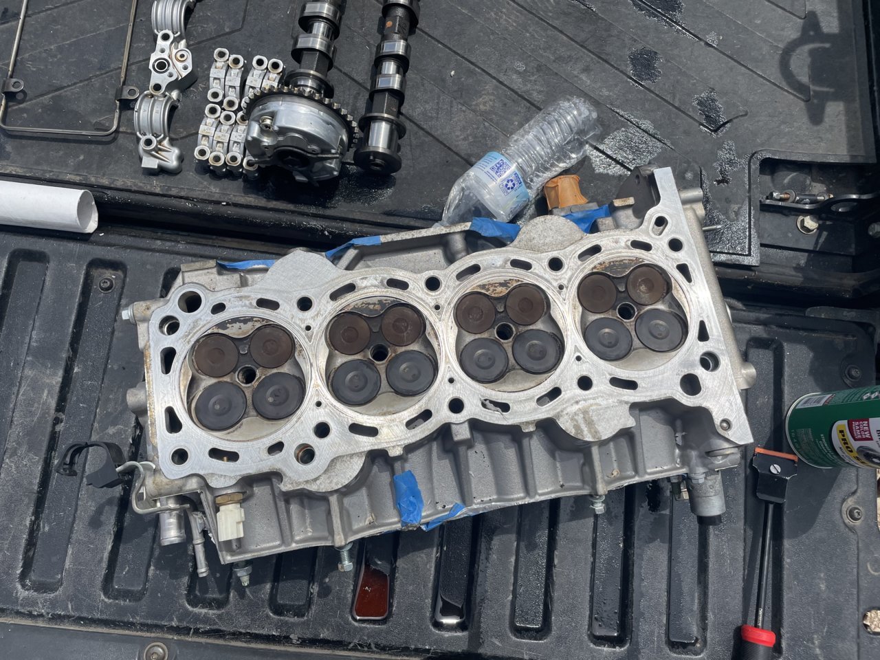

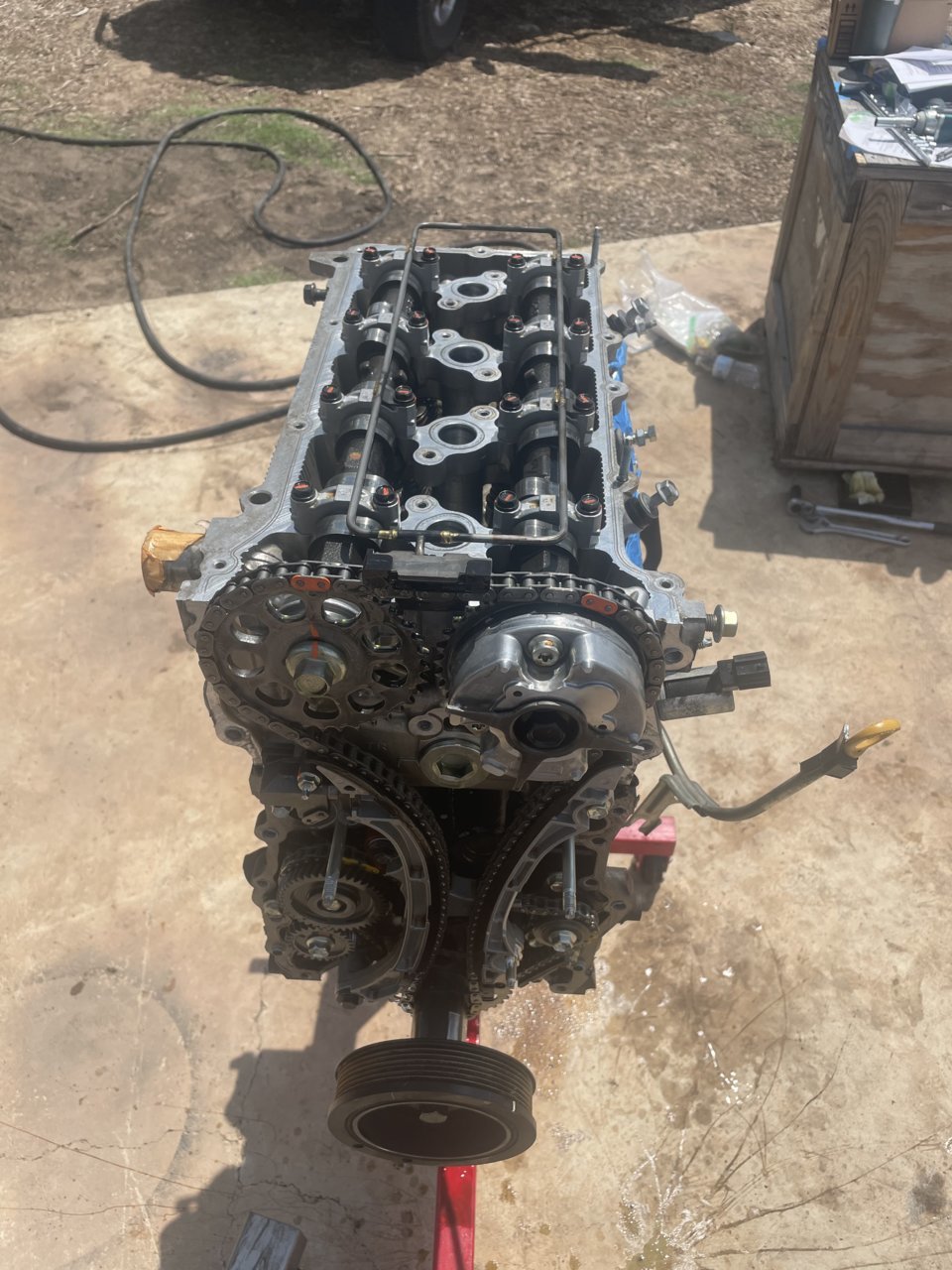

    Here’s the head. Working on cleaning up everything and chasing the block for head studs now, then reassembly will commence

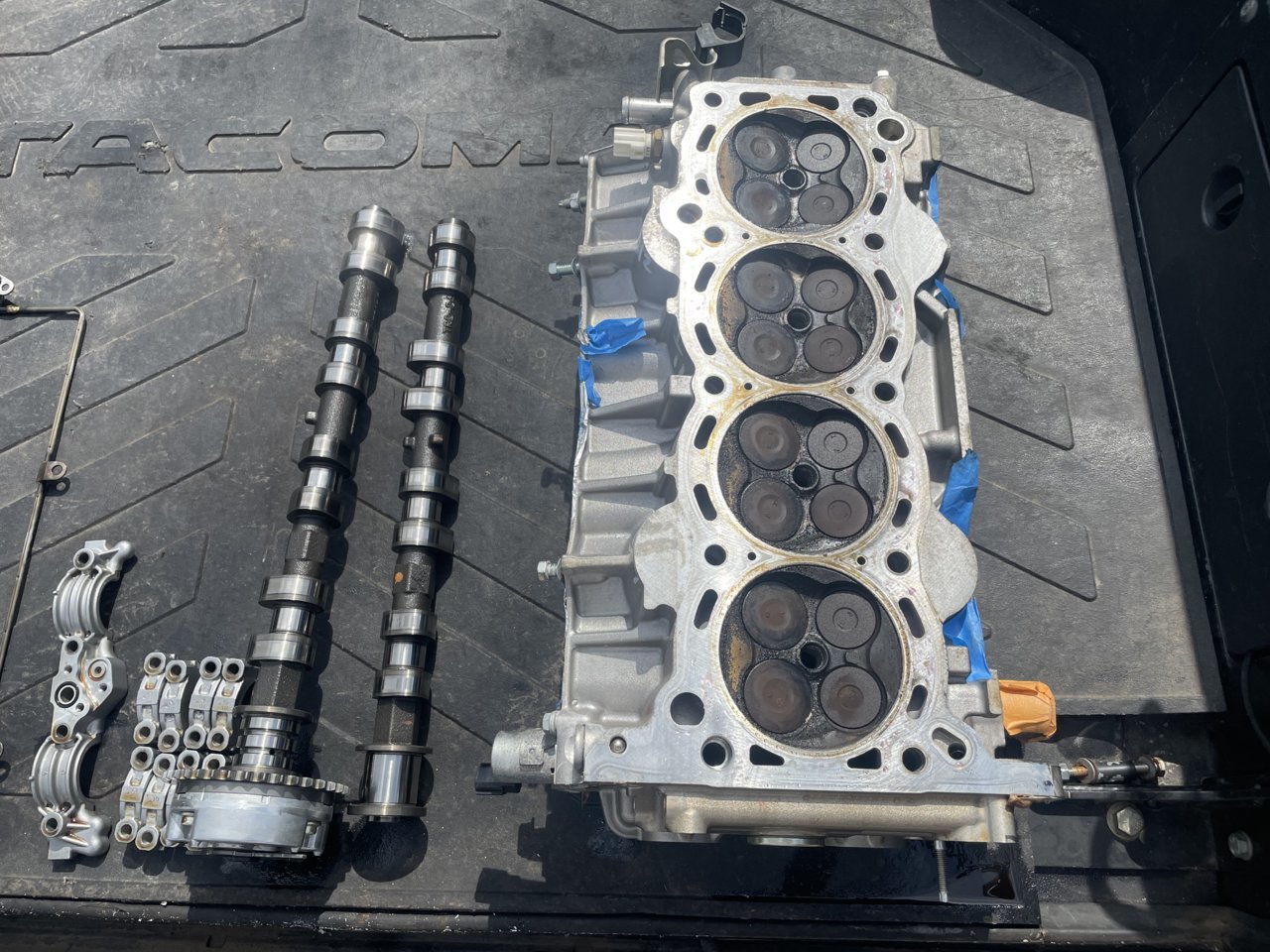

    Got everything cleaned up the best I could. Some of that carbon was really cooked onto the piston tops.
    head on and torqued down to 80 ft/lbs. time for reassembly now

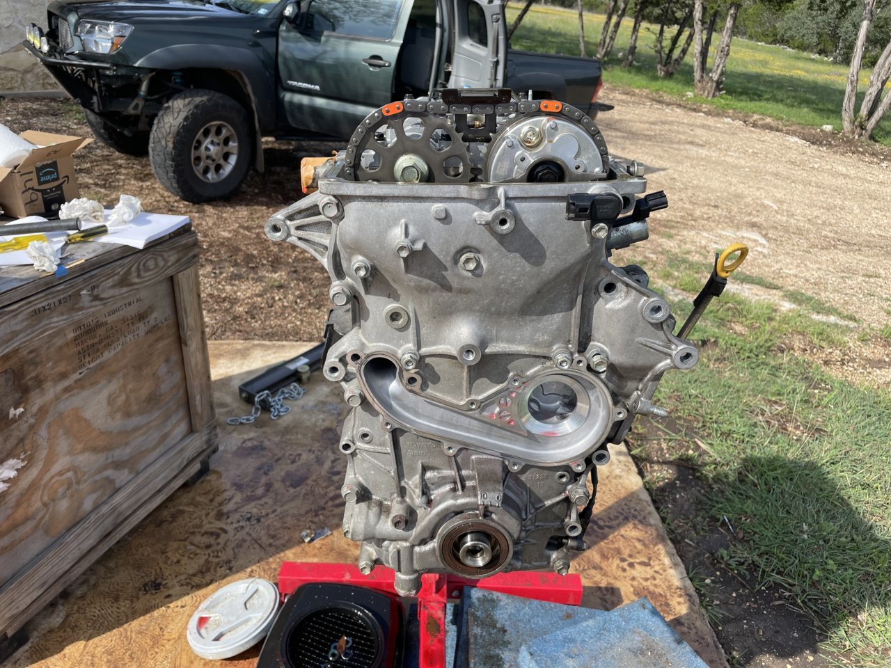

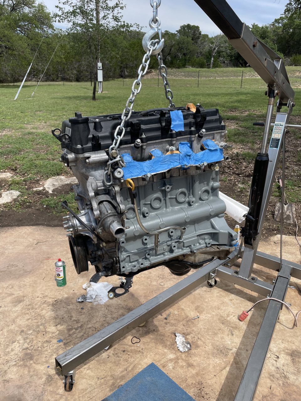

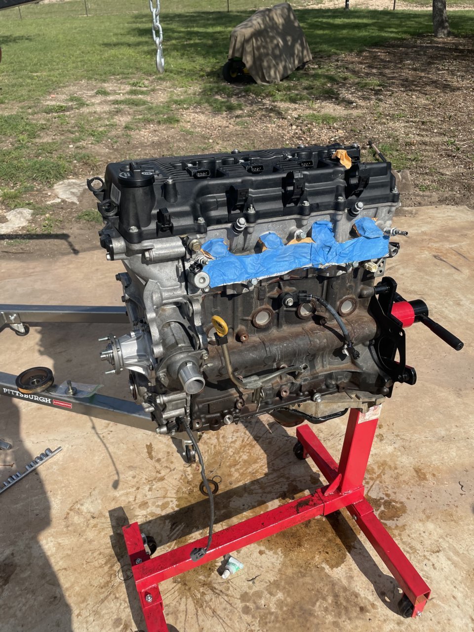

    Long block is finished up now. Going to work on cleaning up the block and painting it tomorrow and then start the process of swapping things out if I have some steam left. I threw on a new Aisin water pump, OEM thermostat, and front main seal. Need to do the rear main tomorrow too. Also got the oil pan swapped over today that I welded a drain bung in for the turbo too, so other than valve cover, coolant bypass pipe, and manifolds, oil filter housing, and clutch/flywheel this thing should be ready to swap in. Ill be changing out the motor mounts for some new OEM ones at the same time

    Practically a brand new engine. @Hayrider was right. From what I could see, it was in very good condition.

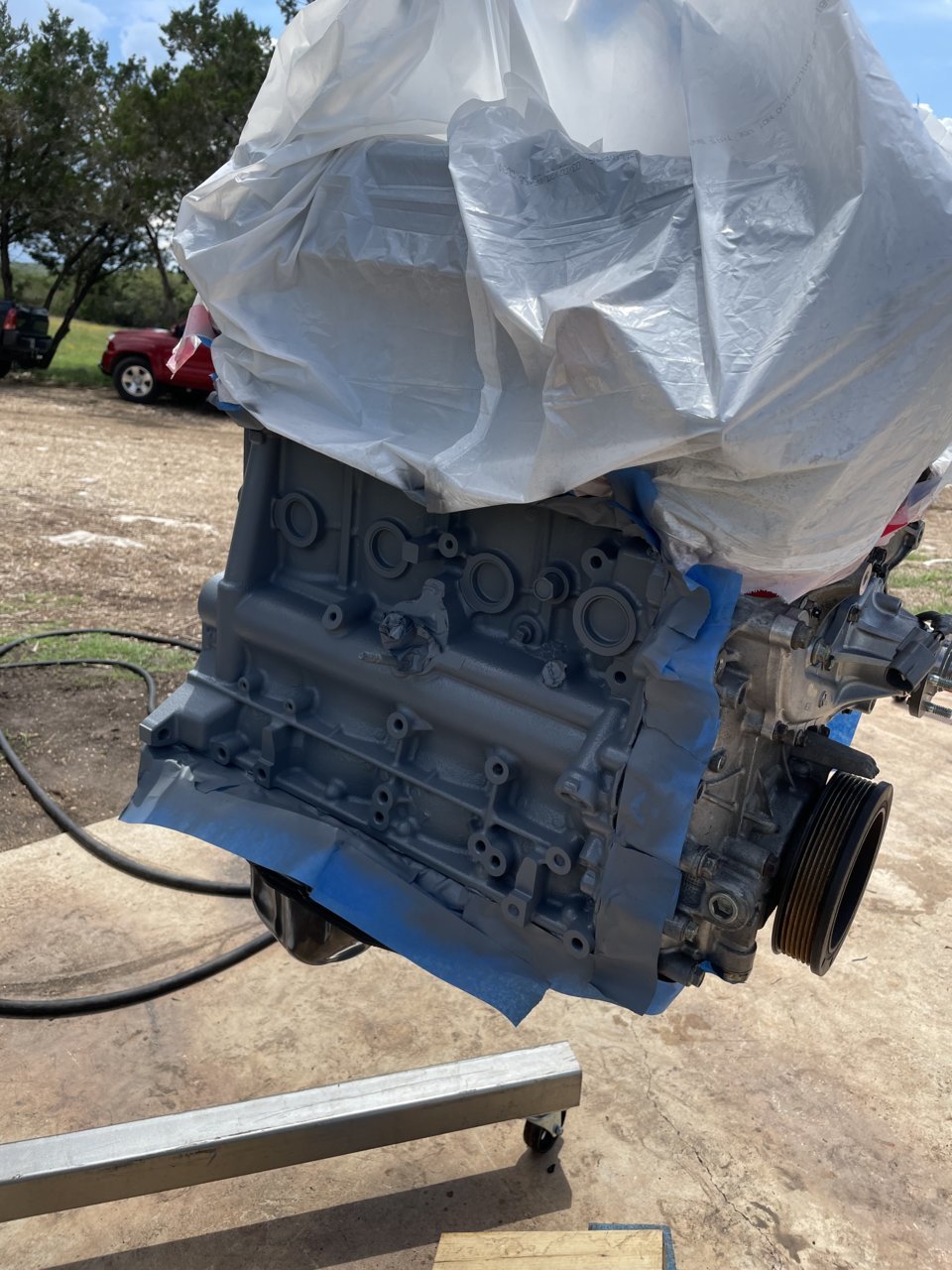

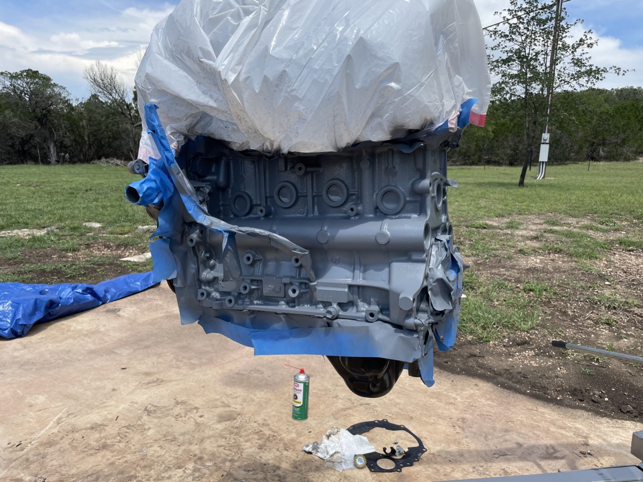

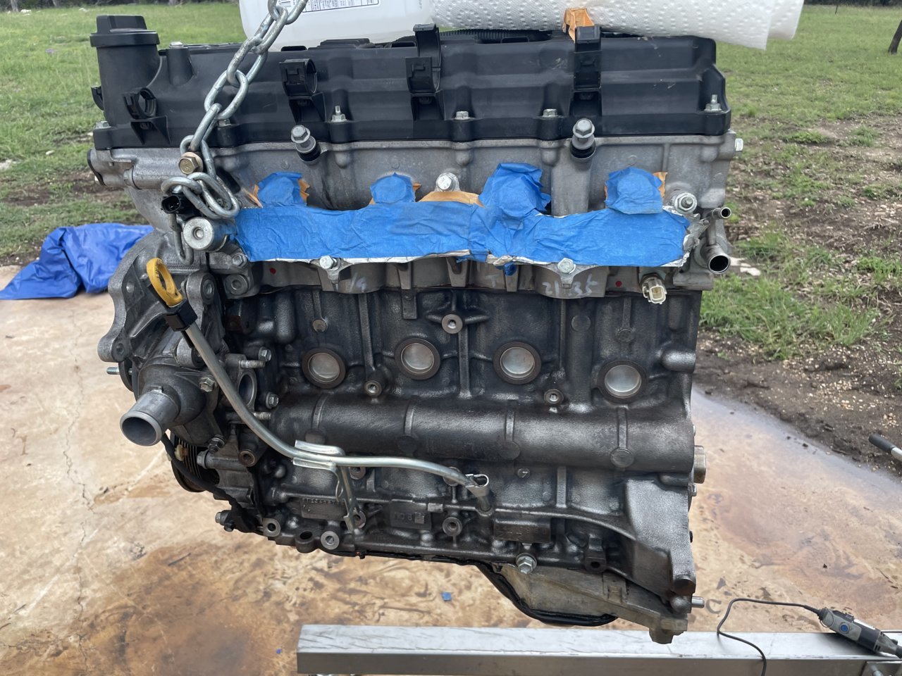

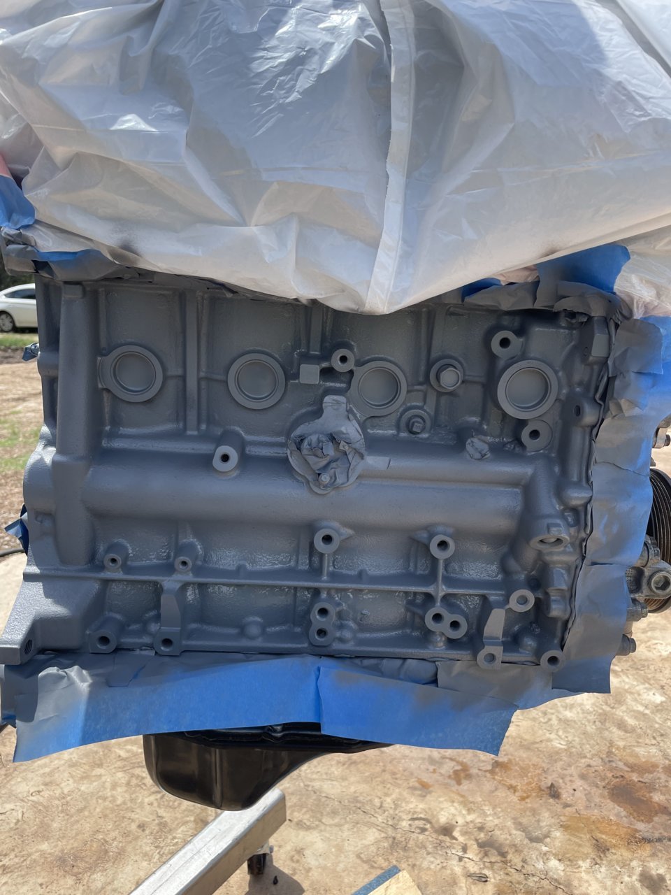

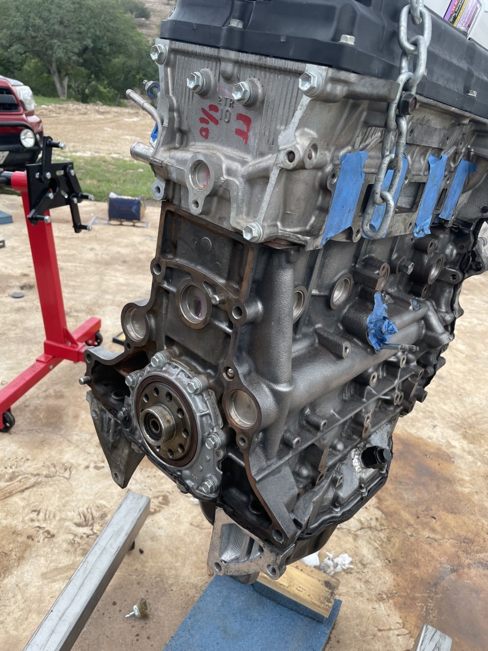

    Cleaned and painted the block today. Used a combination of wire wheels that fit in a drill and a dremel with stainless brushes to get into the tight spots. Went with rustoleum grey engine primer and VHT grey paint. 2 coats of primer and 3 coats of VHT
    The finished product! Now I can start bolting on the goodies and get ready to pull the truck apart. It’s looking like we may have severe thunderstorms tomorrow so I might be saving the swap for Friday
