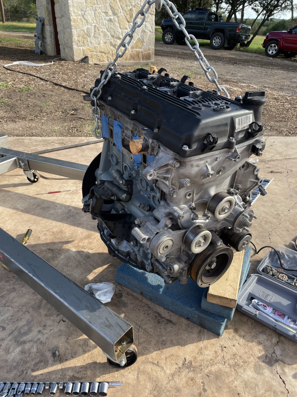

    Filled with 6 qts of oil and no leaks so far! Also started dressing her up for the big day. Got the idlers, ac compressor bracket, tensioner, and motor mount perches back on. Everything else will happen when the other one comes out of the truck

    Damn near new!

    Catch cans help a lot at reducing that carbon build-up. So does the occasional flogging. :D

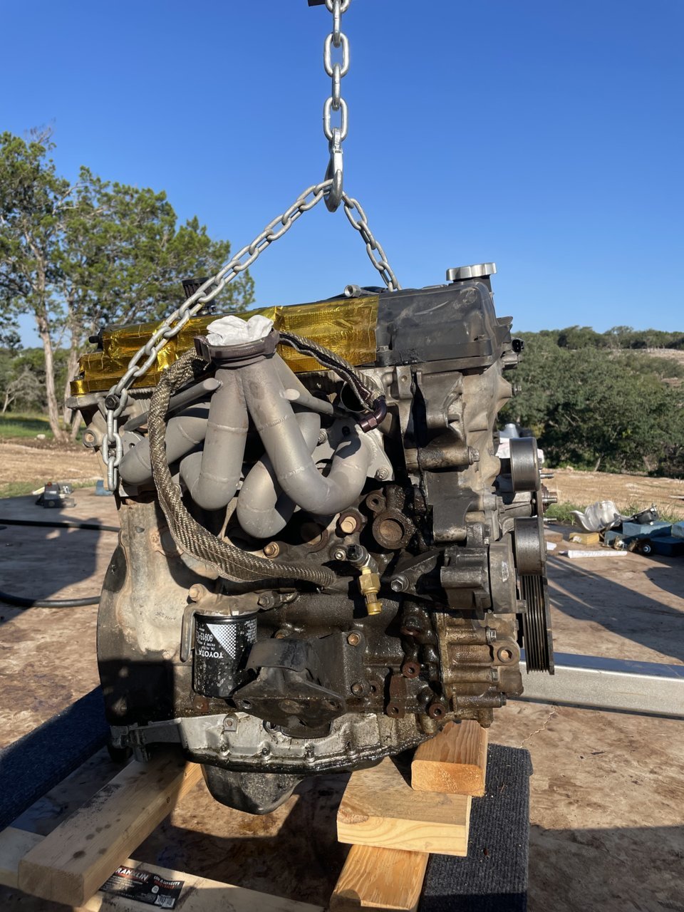

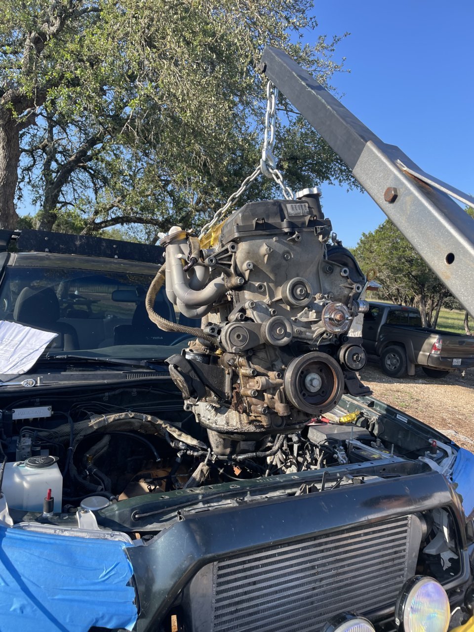

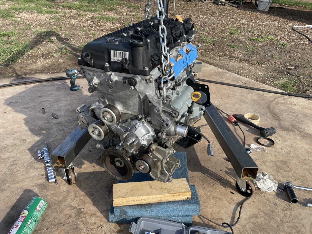

    Engine out! Looks like it came from under the ocean lol. I went heavier on the FIPG on the timing cover this time to hopefully prevent this

    Torspd Custom Turbo kit [] Borg Warner 9180EFR Turbo [] Haltech Elite 2500 [] TiAL Q BOV [] TiAL V44 Wastegate @ 15psi [] CP Pistons [] CP Carrillo Rods [] ARP Head studs [] ARP Main Studs [] ARP Header - Head Studs [] Ported Heads w/ 1mm oversized valves intake/exhaust [] Brian Crower Forged Stroker Crank [] Darton M.I.D. Sleeved Block [] Kelford Camshafts [] Torspd 160* T-stat mod [] APR Large Fuel Rail [] Walbro 460 LPH E85 Fuel Pump [] FueLab FPR [] APR T56 Conversion Kit [] KP RACING Built T56 [] McLeod Racing Custom Twin Disk Clutch [] One Piece Aluminum Driveshaft [] MGW Shifter [] Custom lowering kit [] Ohlins Front Coilovers [] QA1rear shocks [] Custom Ron Davis Radiator [] Dual SPAL Electric Fans []
    Well, you've done two things well. Gotten the engine out quickly, and prevented the iron block from rusting.
    That Polydyn ceramic coating is holding up extremely well. :thumbsup:

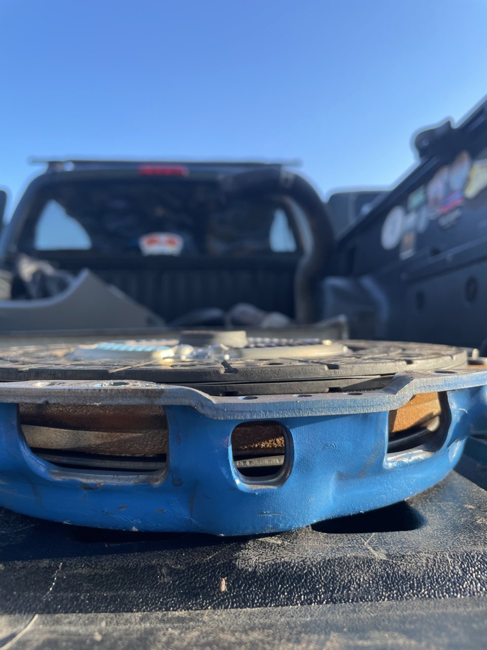

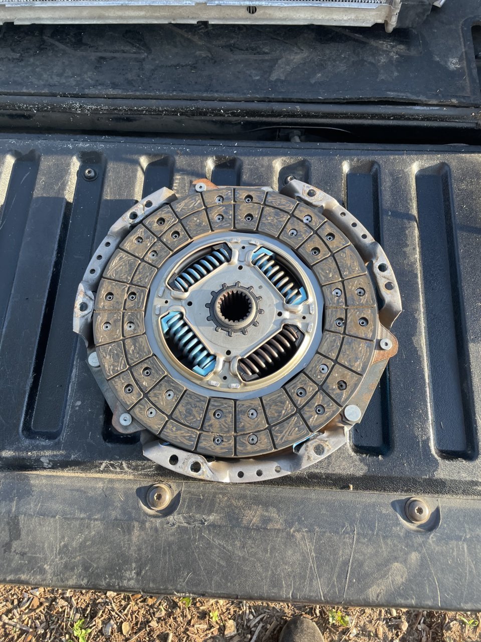

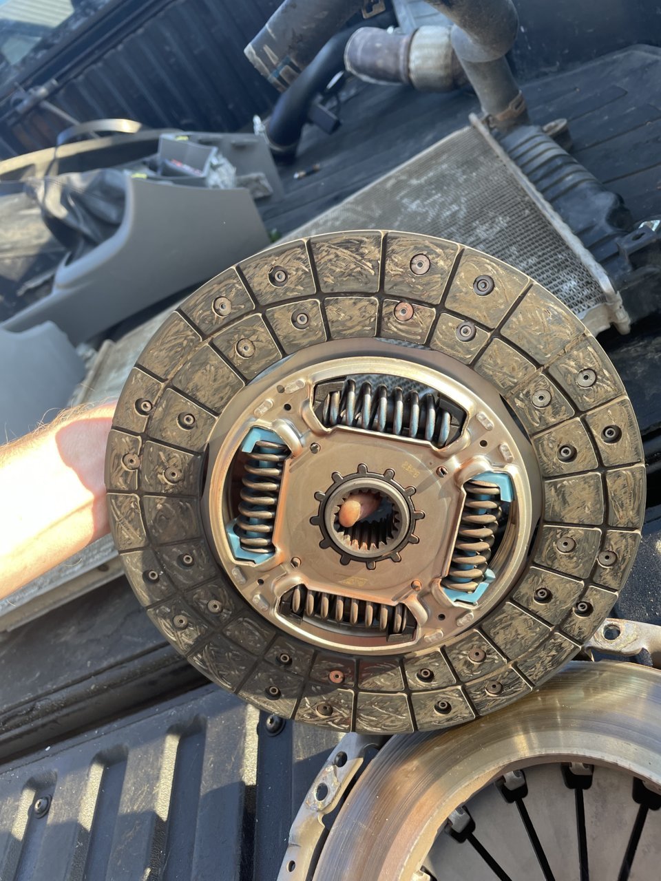

    Here’s what the Aisin disc looks like after being paired with an M-Pact pressure plate for a few thousand miles. Id say this combo is a winner
    Impressive! So the other engine tear down had already started, and we're all waiting for you to post the pics right? :boink::D
    It really does seem that for the power level that you are, that clutch combo is holding up way better than anticipated. That's a pretty important find.

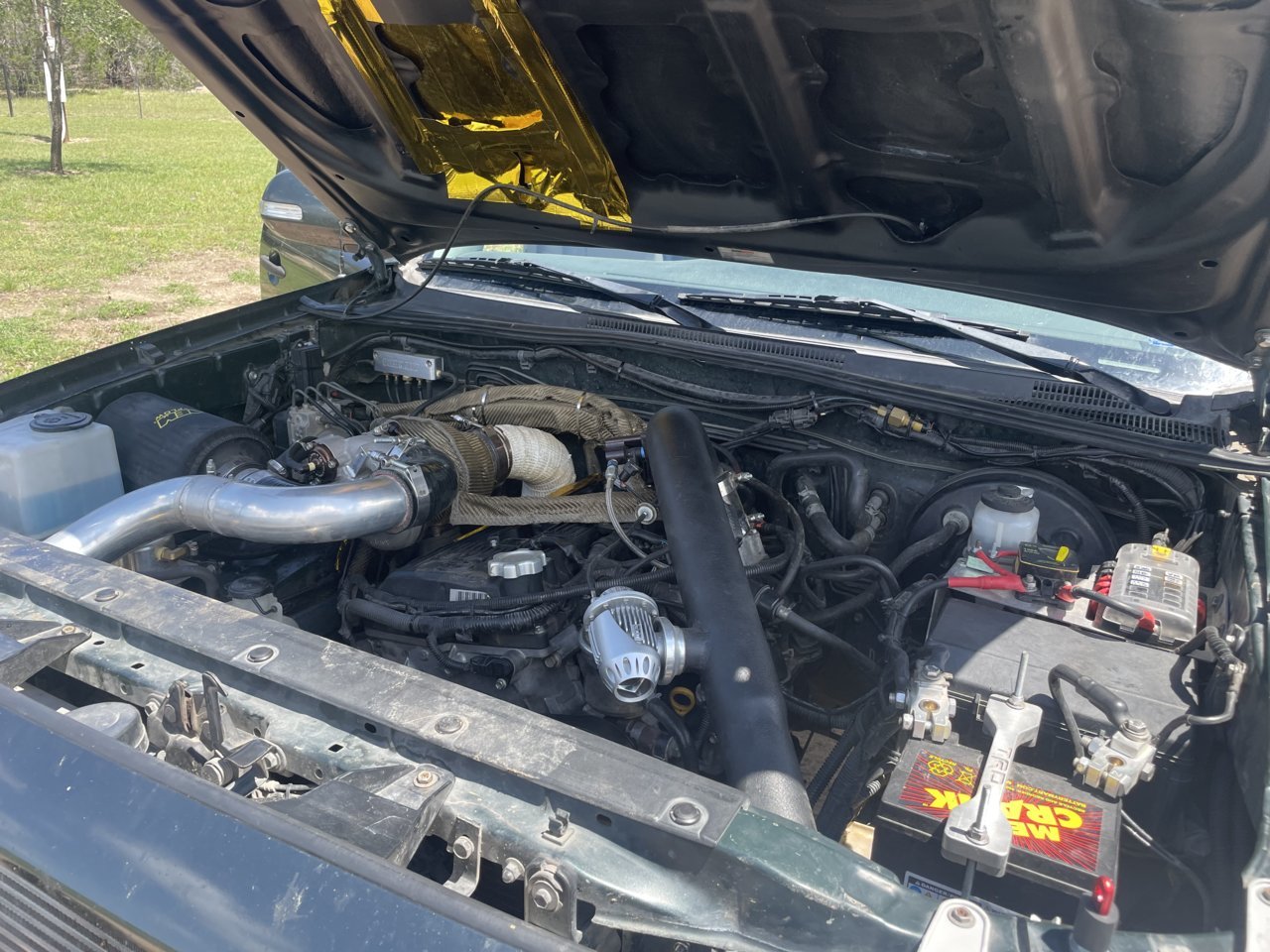

    Drove the truck about 50 miles yesterday and another 10 or so today. I noticed yesterday that the operating temps were 199-204*F which is a little warmer than I would like.. the old engine ran 186-194 and the only cooling system components I changed were the water pump and thermostat. I used an Aisin water pump and an OEM Toyota t-stat, but it would appear that the new t-stat wasn’t opening up all the way. After swapping my t-stat for the one out of my old motor, operating temps are back in the 186-190 range. Seems like a rare chance to get a bad part from toyota new out of the box, but I guess that’s how it goes sometimes.

    Mine stays around 199 and rarely gets above 200. I do have a bunch more weight than you though....

    That sounds about right for a heavy truck like yours. And yeah after swapping back to the old t-stat it’s back in the 186-194 range. I guess I just got a dud out of the box.
