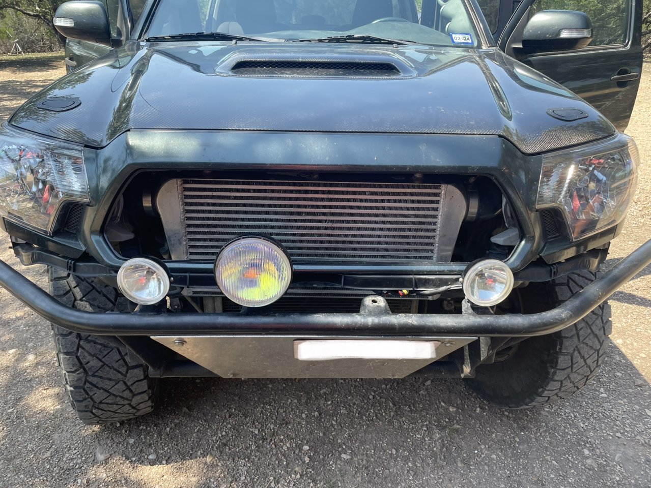

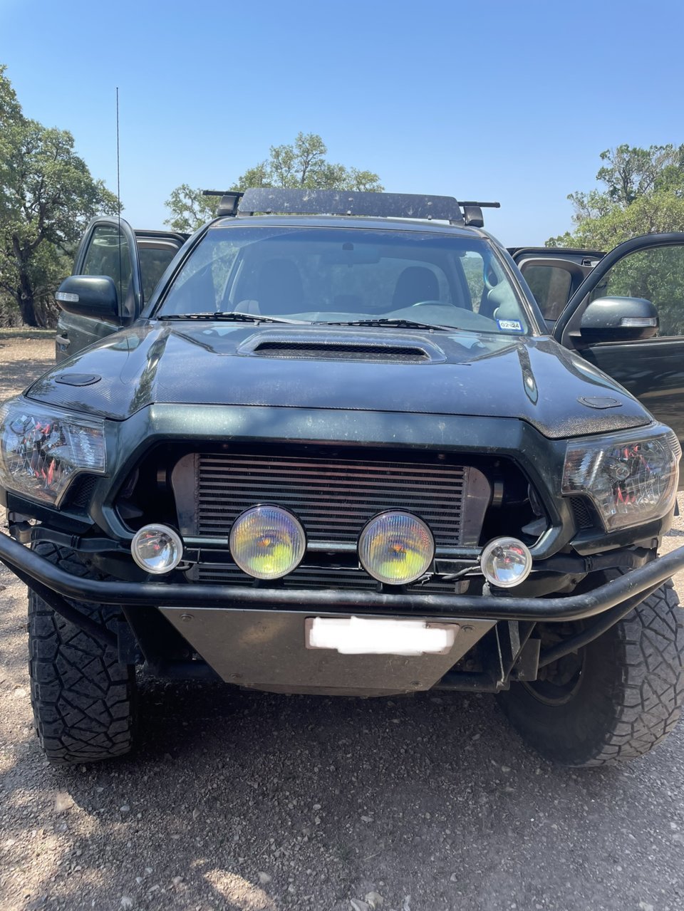

    One thing that hasnt been mentioned that i missed on my original list, is you're going to want some sort of a front mount intercooler to help keep intake temps to a minimum. I can grab you some measurements later off of what mine has on it from the URD SC kit.

    The urd used a big core and then had mounts modified to fit in the taco. I can get you some measurements on dimensions later if you’re interested in something similar.
    if you go with the BW EFR, it has a recirculation valve built in, so nothing additional needed there. I am running the HKS BOV that came with the URD SC kit and the one in the Turbo just for a little added redundancy in case something fails. Only one is needed from what I understand. They help to keep air from traveling backwards in the intake piping whenever the throttle closes suddenly, which is not good for the turbo

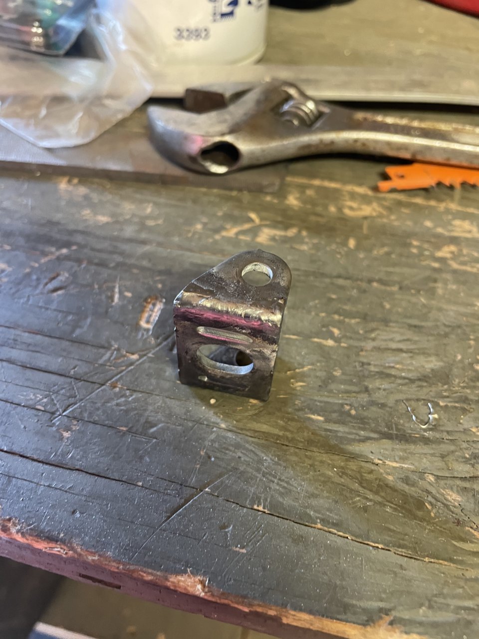

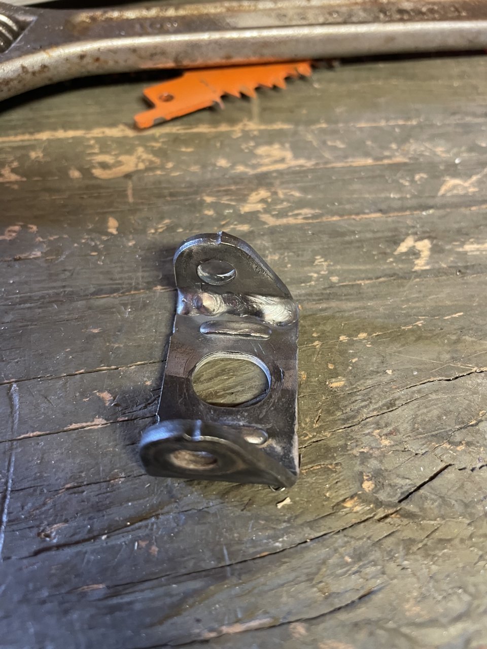

    Had an issue with a bracket for my light that sheared off on one side recently. Broke out the tig today and got that fixed up.
