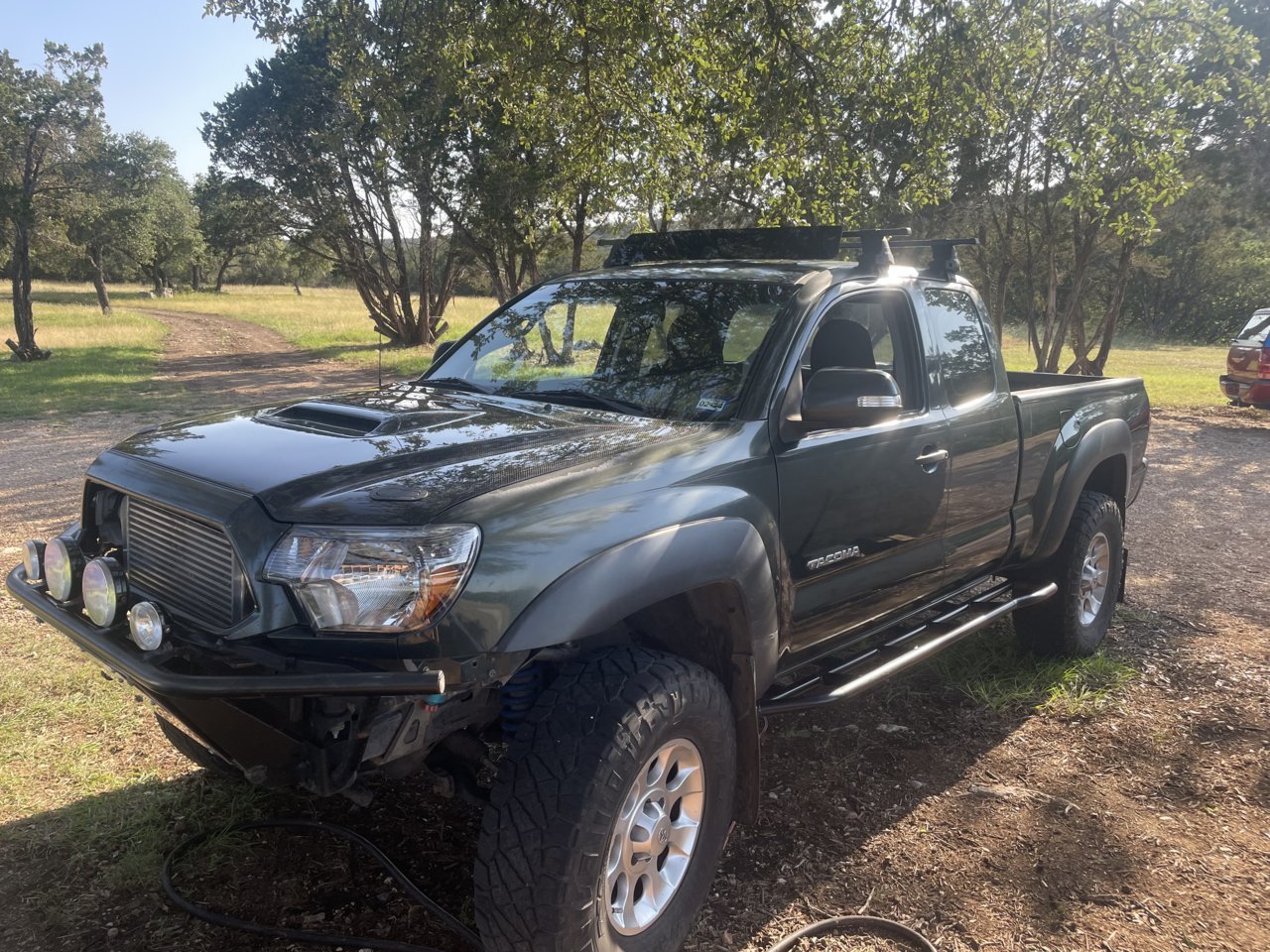

    Gave the truck a wash for the first time in probably 6 months or more. Detailed the interior too. She cleans up pretty good for a 14 year old truck other than the seasoning on the paint!
