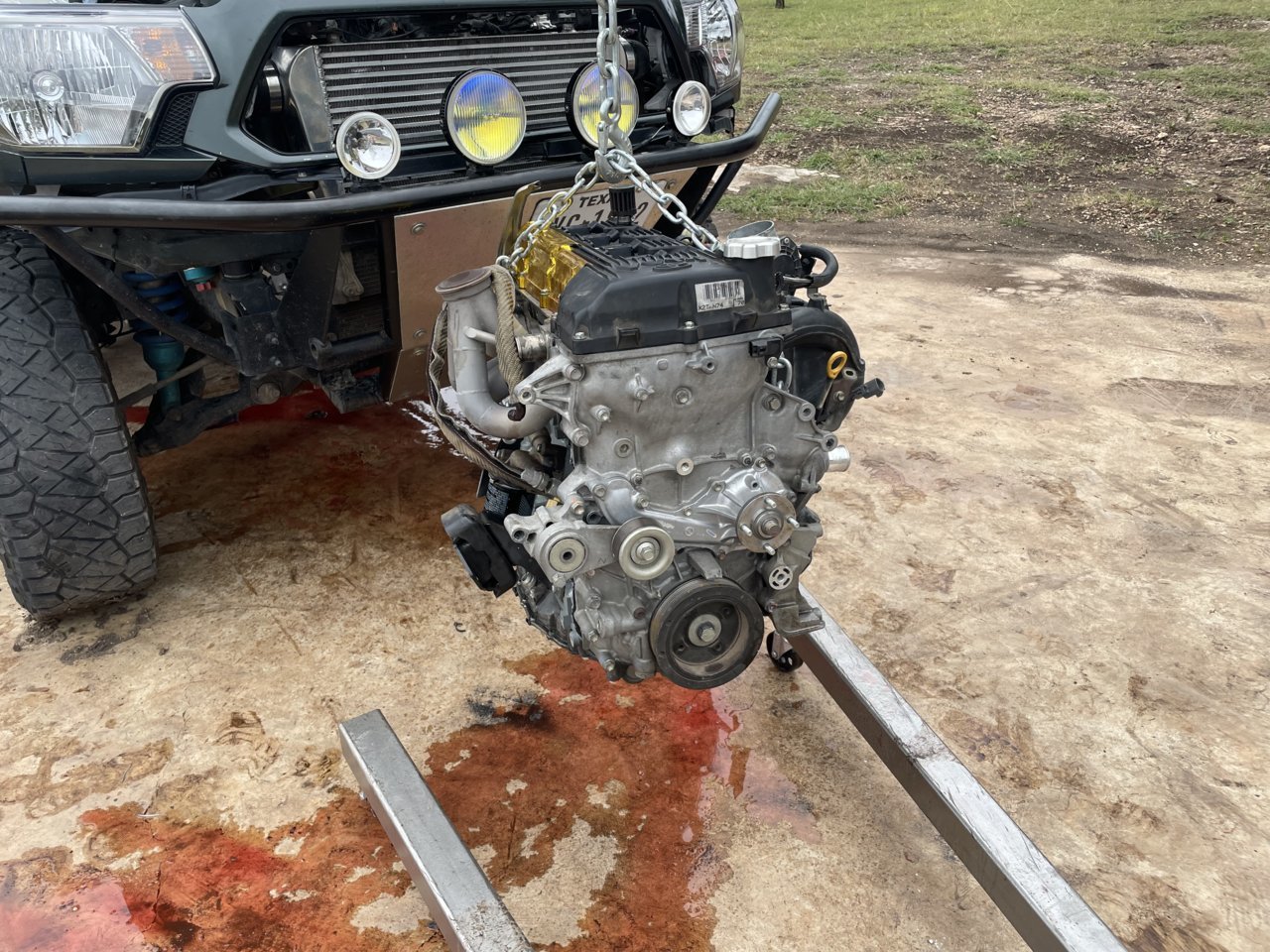

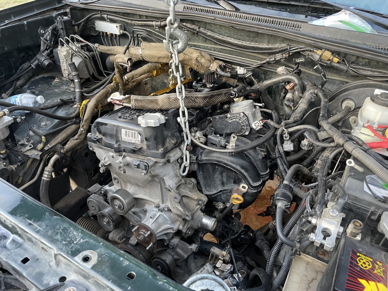

    Just throwing my old motor back in there for the time being. I am not sure what the long term plan is with the newer motor, but I doubt it’s going back in the truck.
    It would be good to fix the issue but parts are a couple weeks out, and I need this thing running again.

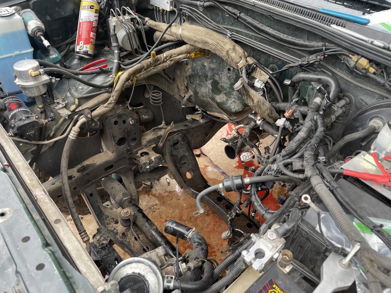

    Everything swapped over and motor back in. Need to button up all the wiring harness, plumbing, transmission, and accessory drive tomorrow

    Yes sir, trans got dropped. I thought about trying to pull them together but I can get that out in 30 minutes or so, so I just removed it. Not looking forward to the install though that thing always puts up a fight

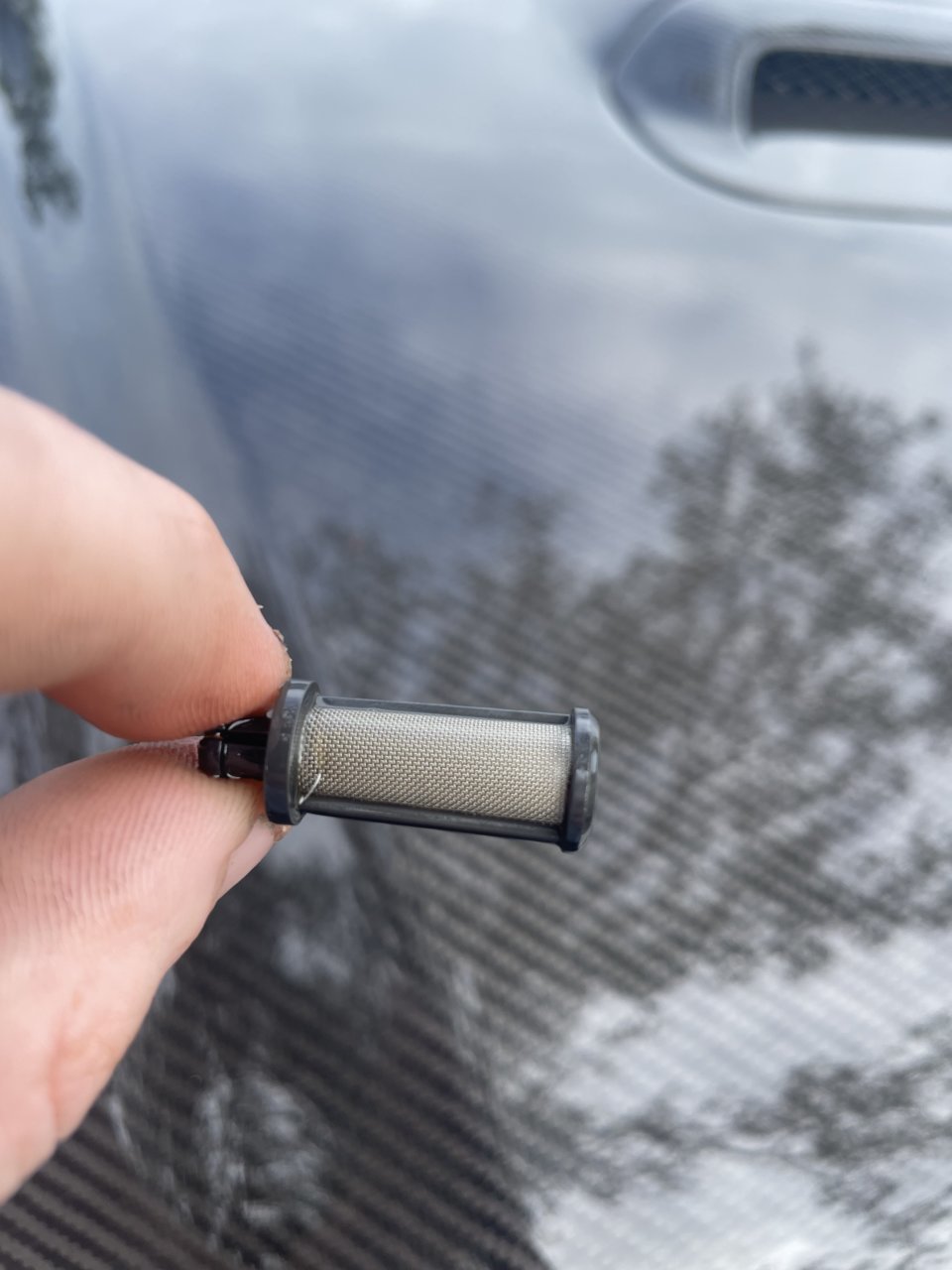

    Yes, they looked good before and I pulled the valve cover and found at least a couple of collapsed lifters on the intake cam.
    I personally think there is a bearing issue or something else responsible for the metal in the filter and lower oil pan, and that’s what ruined the lifters. The cams didn’t look bad, maybe a little bit of wear starting from the excessive lash, but it’s not like they were wiped out or anything. I might throw it on the stand though and take a closer look once the truck is wrapped up

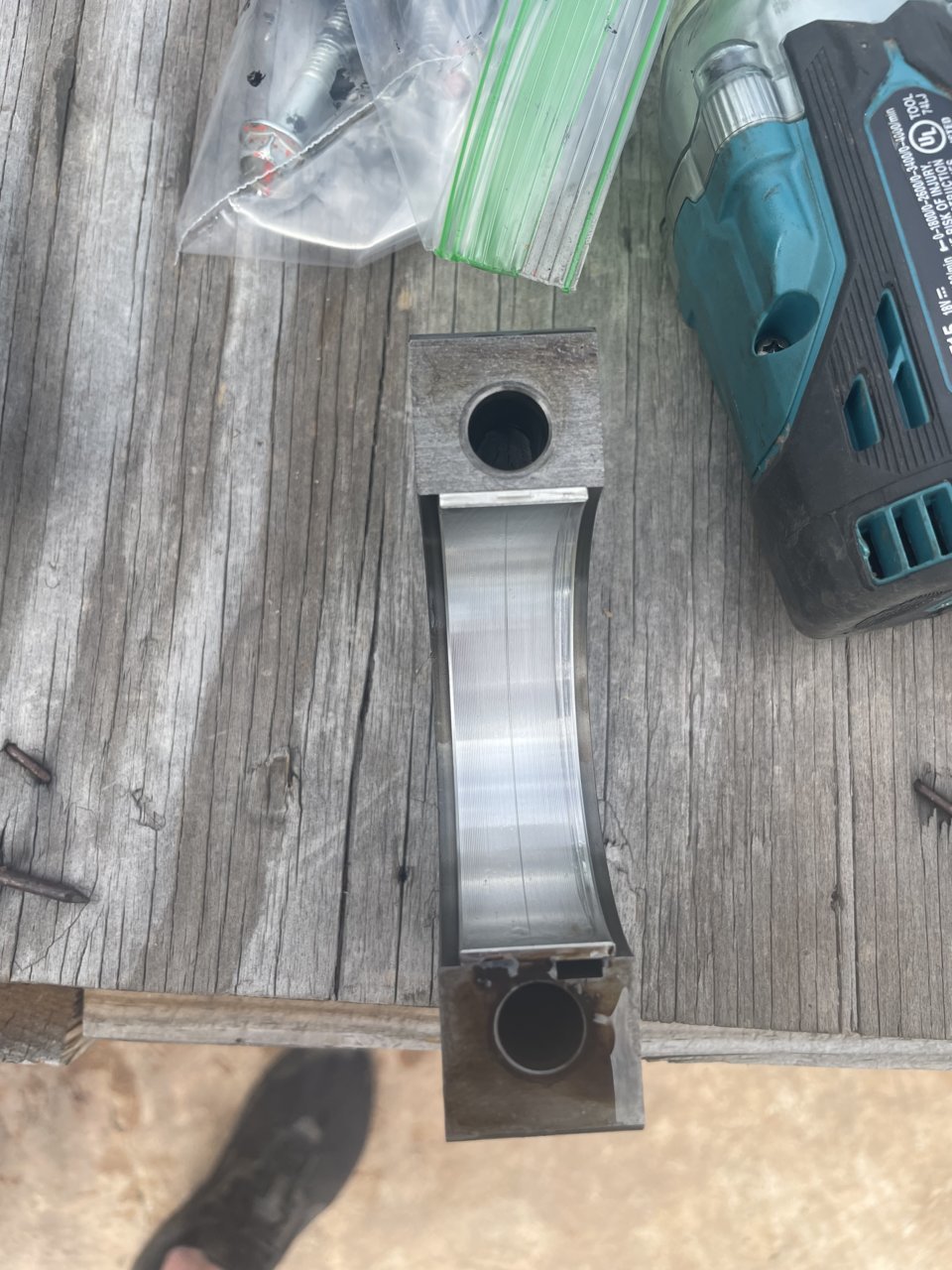

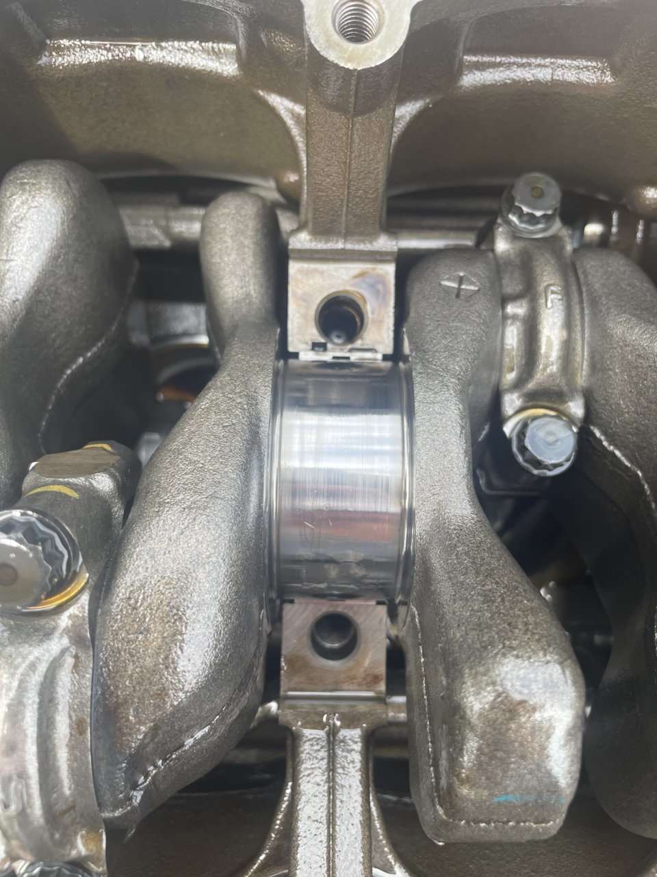

    Found this in the vvti filter this morning so I put the engine on the stand and dug a little deeper. Didn’t take long to find wear on the #2 main bearing after tearing it down. Unfortunately I think this is the end of the road for me and the 2TR. After my original engine dies, I will be going another route.
    #2 main bearing

    Robert,
    Now I must have to admit I’m no expert by any means! But that doesn’t look like a wear issue, looks like something foreign inside the engine. :notsure:
  20. Jul 4, 2023 at 11:05 AM
    #4360
    Speedytech7
    Feb 20, 2014
    #123587
    58,156
    FCQM+VG Cheney, Washington
    It's less Tacoma and more mod
    That a really abnormal scar on that bearing, doesn't look like enough wear on it to be making that noise either... usually mains don't make the tapping/knocking noise, check rod bearings.
