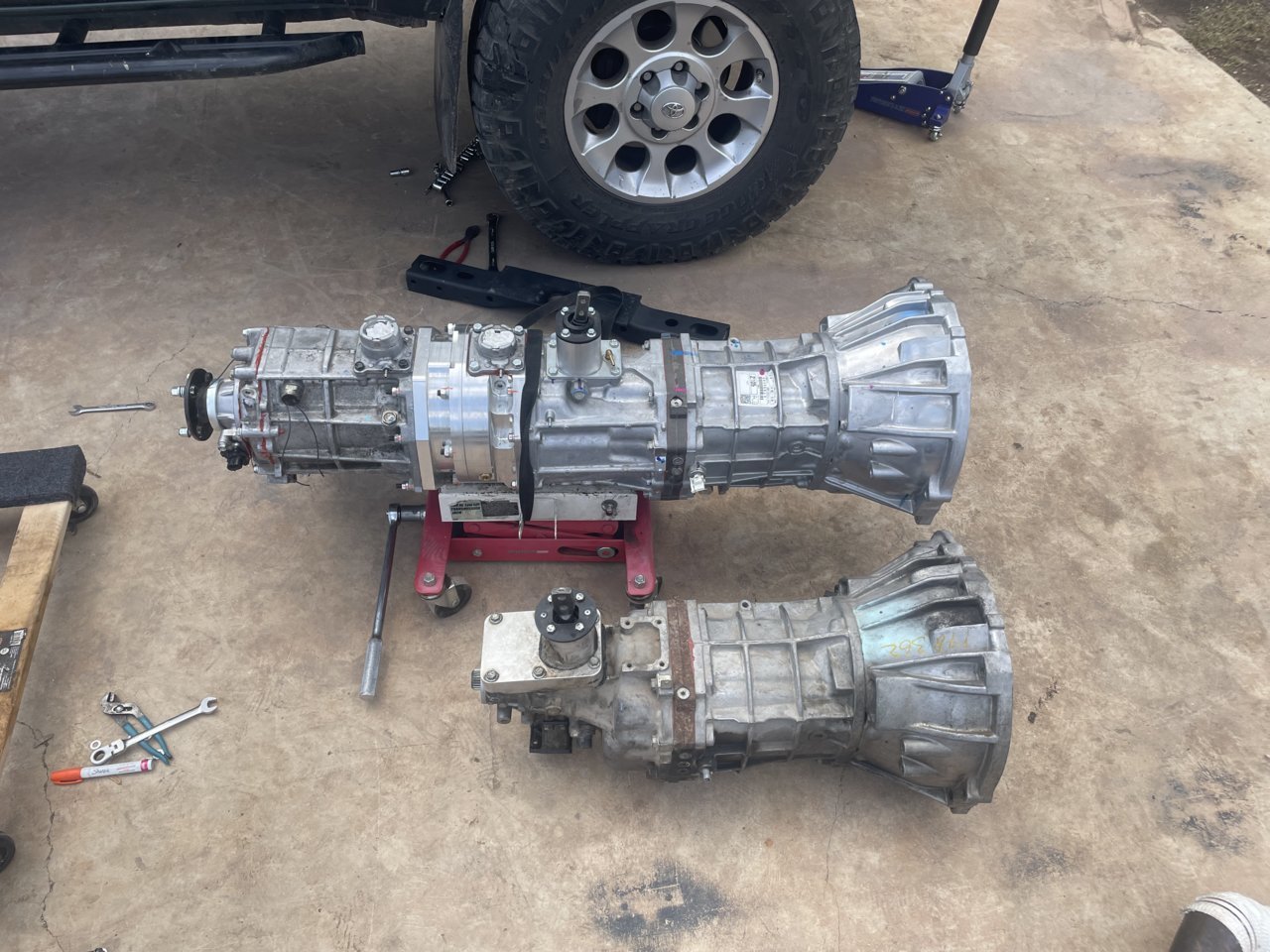

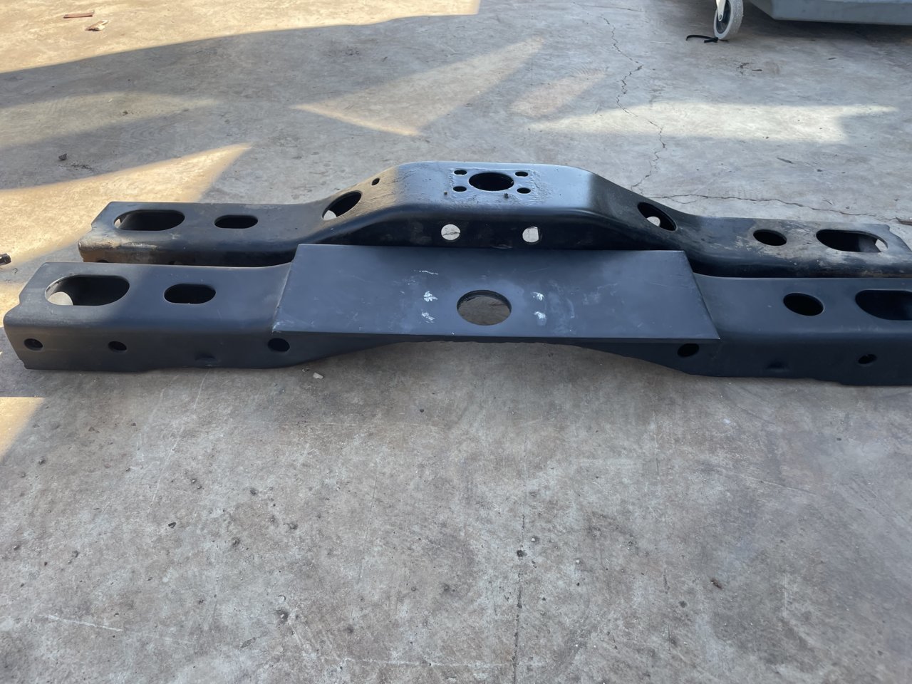

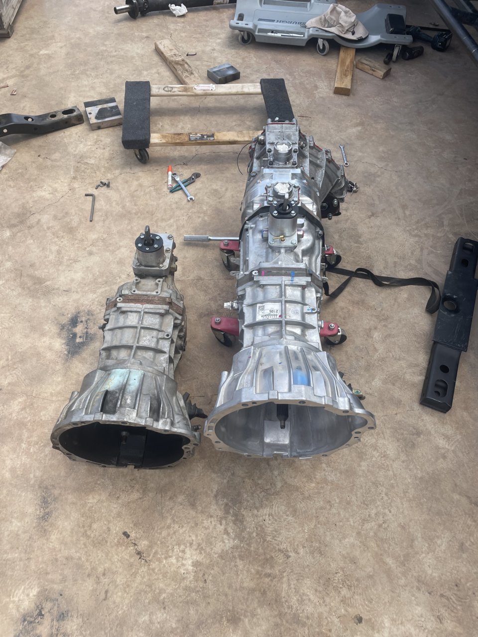

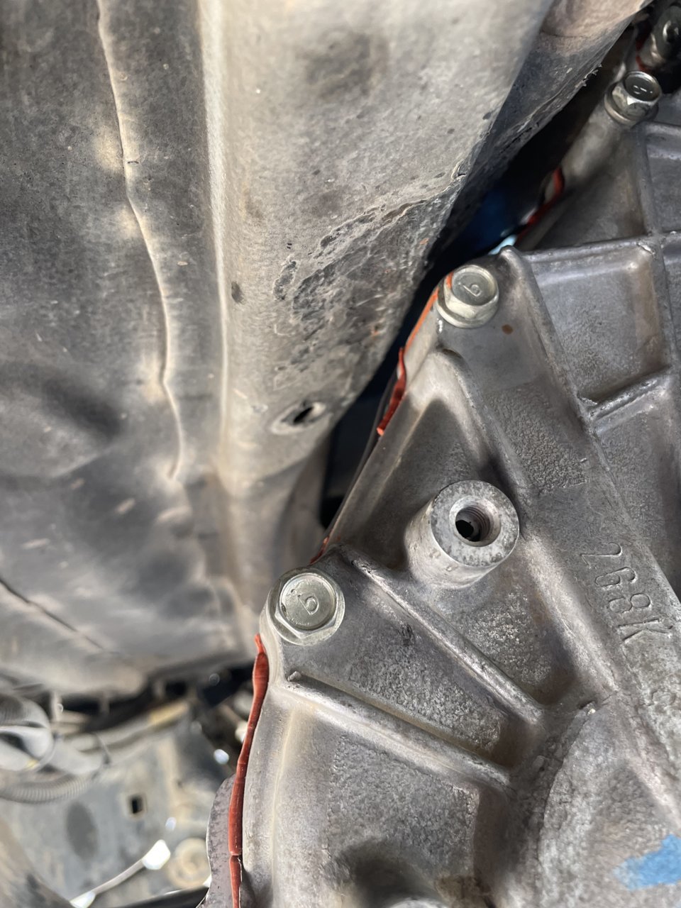

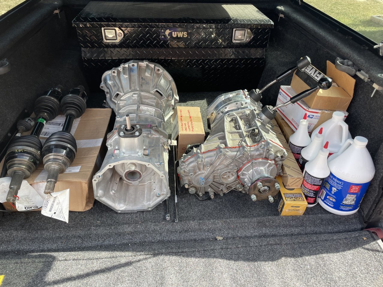

    Got the old 2wd trans out and stabbed the new R156F, crawl box, and VF4B t-case. Need to modify the crossmember I built a little bit, but then it will be time to measure for driveshafts and figure out the shifter situation.

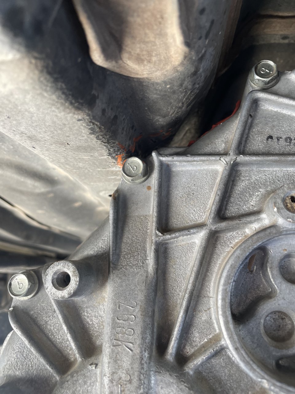

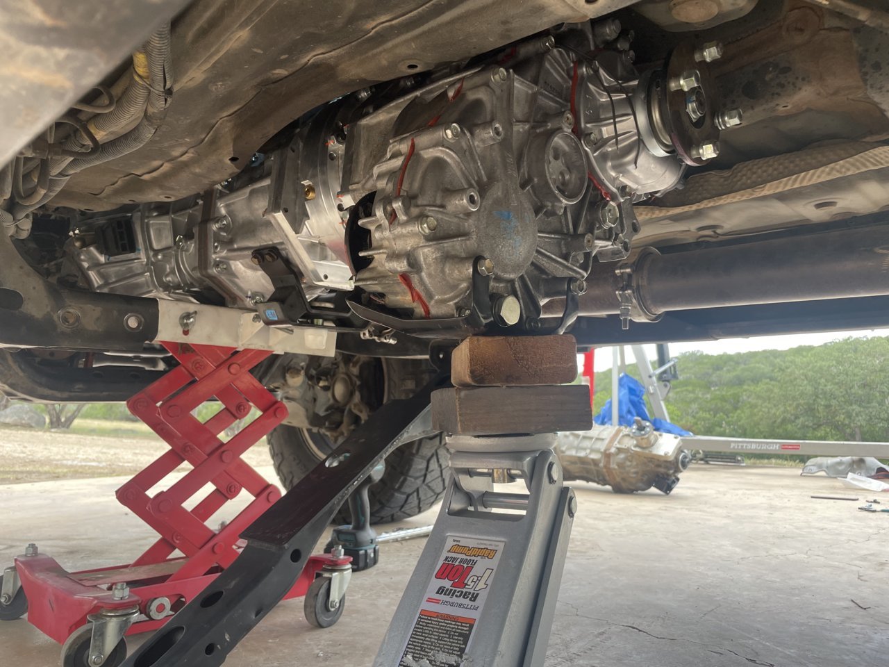

    Transmission and cases are in and mounted for good. Got the driveshafts ordered this morning, so those might be here later this week. Had to pull everything back out and bash the floor for clearance for the AWD case, but got that wrapped up a little while ago. Also got holes for the shifters cut last night. Missed my mark a little on the back one:bananadead:
    Before the VF4B was up against the floor
    Bashed on it for a while and still didn’t end up with much room to spare. Hopefully this is enough

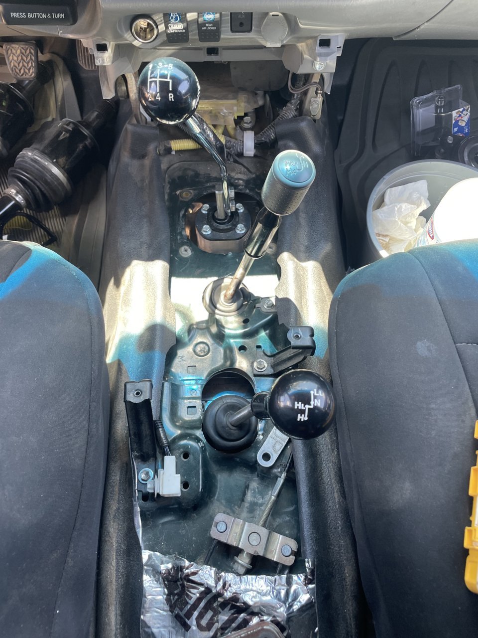

    Shifters/console will need a rework but for now I’m just trying to get it drivable. All that’s left is CV axles/seals, 4wd front wheel bearings, filling everything with oil, and some wiring for the speedometer, and high locked and low locked
