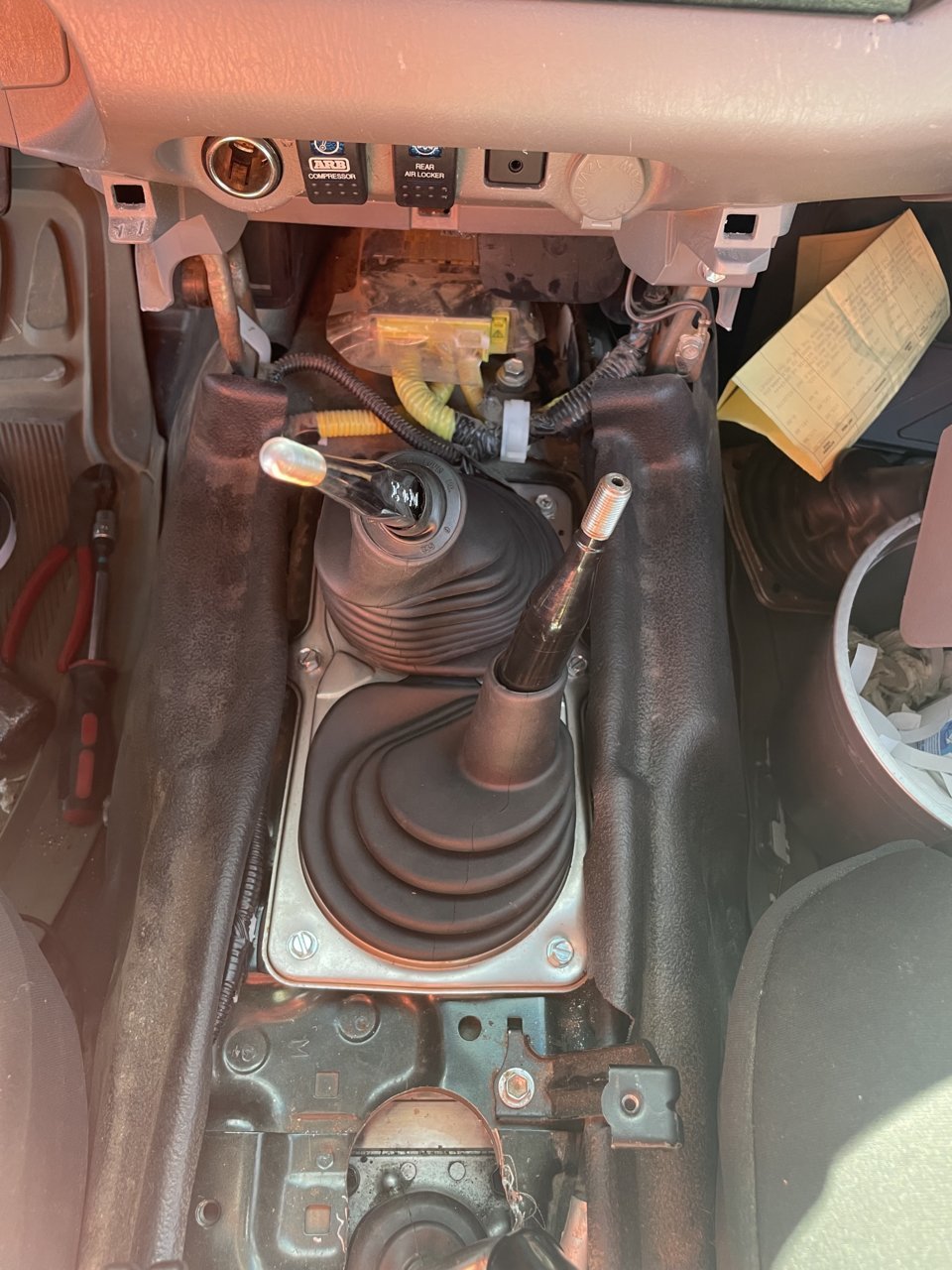

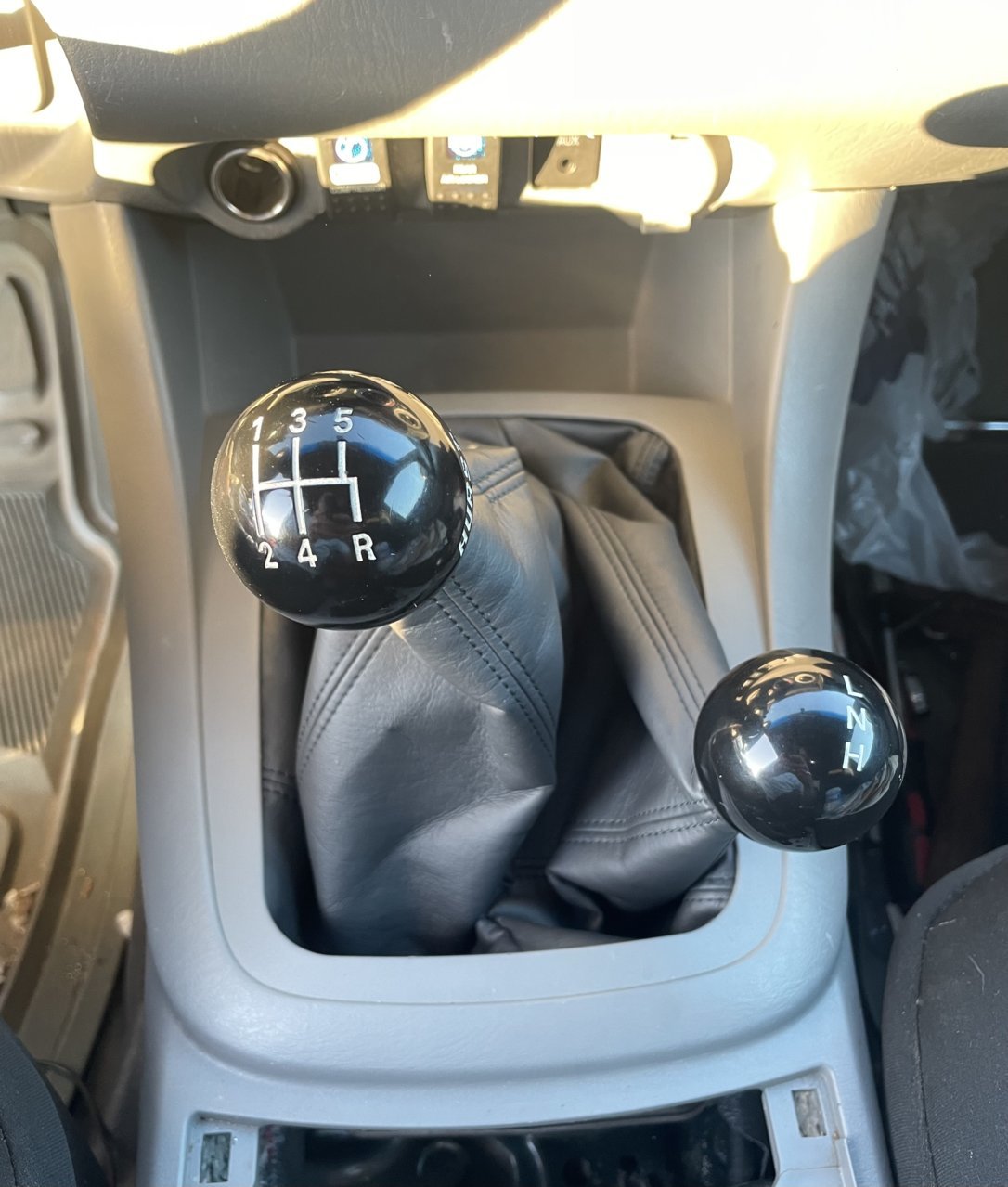

    Front shifters are complete. Also swapped out my trans crossmember mount bolts with some made for the 3rd gen trucks. The stock R155 mount bolts were a different thread and pitch. I ordered a 3D printed cup holder from Blue Dog Design Works for the rear shifter. The plan is to use A/T FJ cruiser t-case upper and lower shift boots for the rear case.
    I also ran the three breather lines from the cases and trans forward to the driver side area where the diff breather is. Since there is no ADD on the truck, there was an extra port open on the bracket that mounts on the front diff for the breathers, so I just used that. Still waiting on my rear driveshaft. Hoping that turns up sometime this week, but im not holding my breath

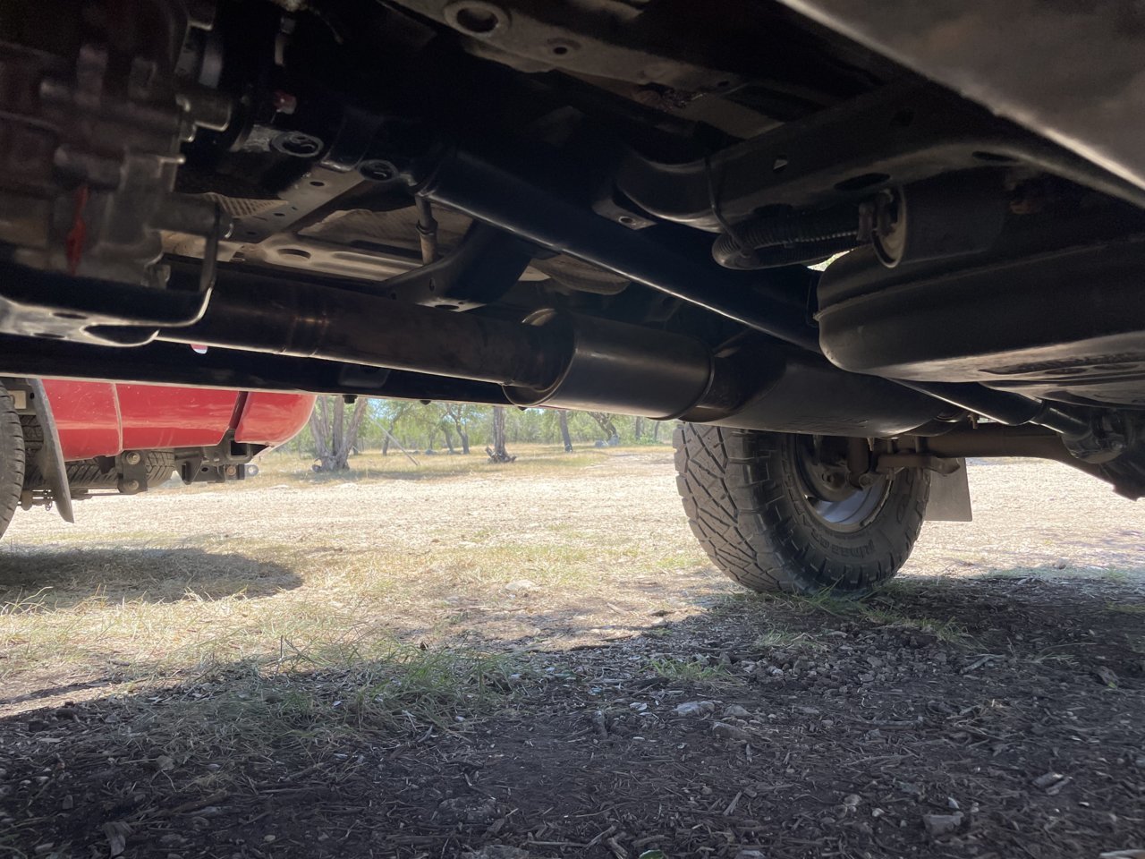

    The rear driveshaft came in today. It showed up in great shape, so that’s a win. I went with a one piece with a double cardan joint. Took it for a couple of test drives and so far so good! Need a little clearancing on the carrier bearing crossmember but that will hopefully be minor.

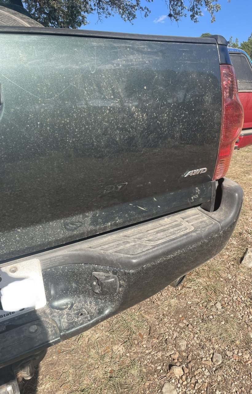

    Also threw on a badge from a RAV4. Time to sort out all the little things, and enjoy this thing some. So far it’s pretty sweet imo:D

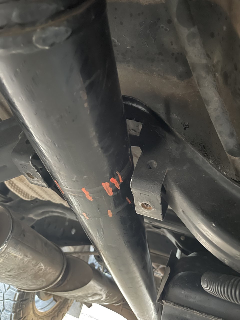

    Had to break out the death wheel for some additional crossmember clearance yesterday. I wasn’t getting anywhere with the grinder so it was time to go for the gusto. Problem solved now.

    If you don't want to weld a plate back in that cut out section, then I recommend adding a bolt on loop, where the carrier bearing used to be. It'll add back rigidity.

    I will have to look into one of those, or maybe you could help me weld in a plate the next time i'm down. I dont have a mig welder but i keep finding more and more reasons to buy one..

    Maybe something like this depending on width...so long as it can articulate enough with the suspension:
    https://alscoplastics.com/products/...-galvanized-pipe-strap?variant=43586901311747
