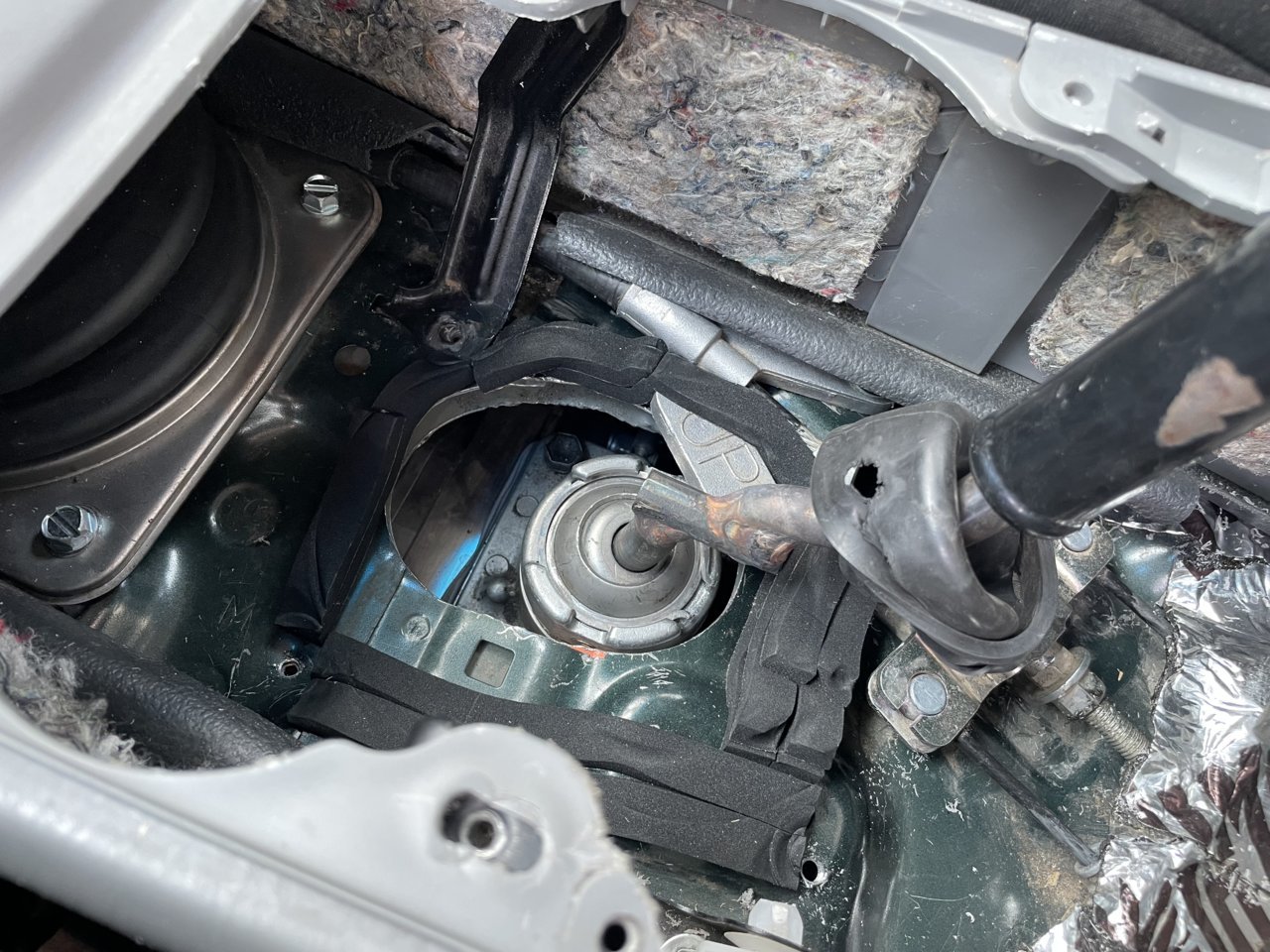

    It’s definitely not necessary, but at the end of the day I’d feel better if I knew it was done right. The hole I cut in the floor will haunt me for the foreseeable future:rofl:

    I've gotten rather used to looking at the ground through the holes I cut for my short throw install in the truck. There was no way in hell I was going to drop the trans to do that

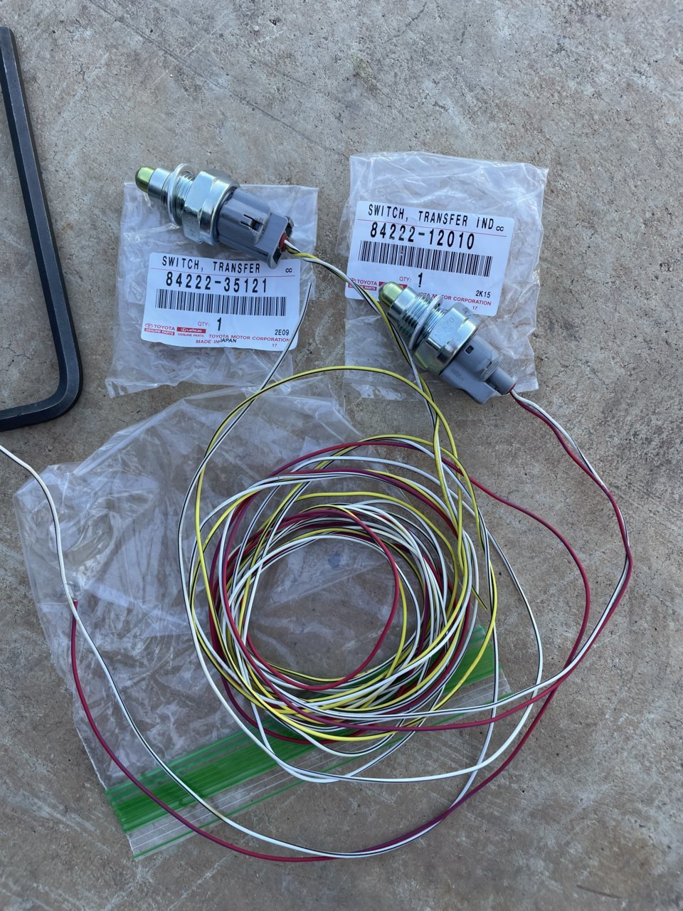

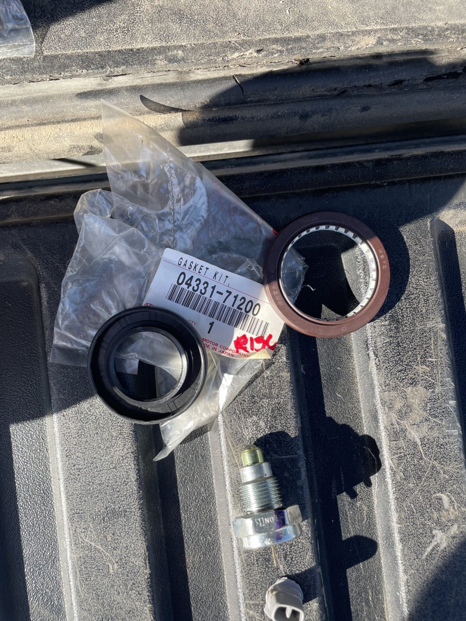

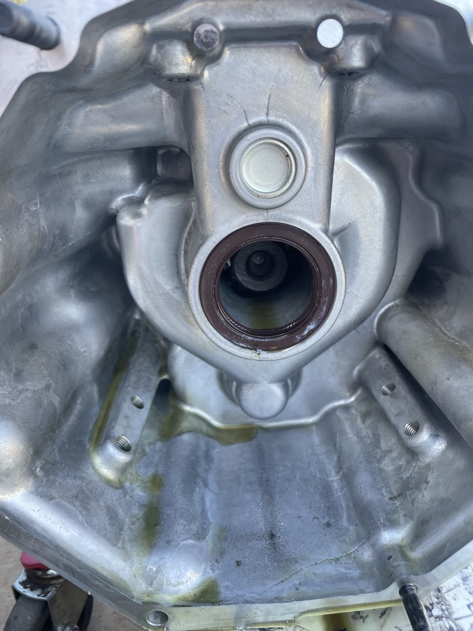

    Trans is back out sorting out another leak. This time it is the output shaft seal of the trans. This is starting to feel like deja vu lol
    Here’s the output shaft seal I found for the R156F. Had to buy a seal kit that came with these two and two aluminum washers for the fill plug and speedo sensor. For some reason I couldn’t find the seal by itself for this the 3rd gen 5spd trans
    Also swapped in the new Tacoma transfer case indicator switches.
