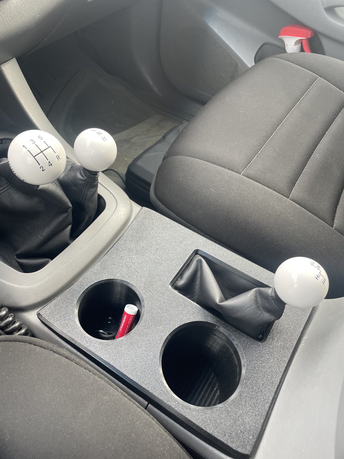

    Got my matching shifter for the rear AWD case finally!

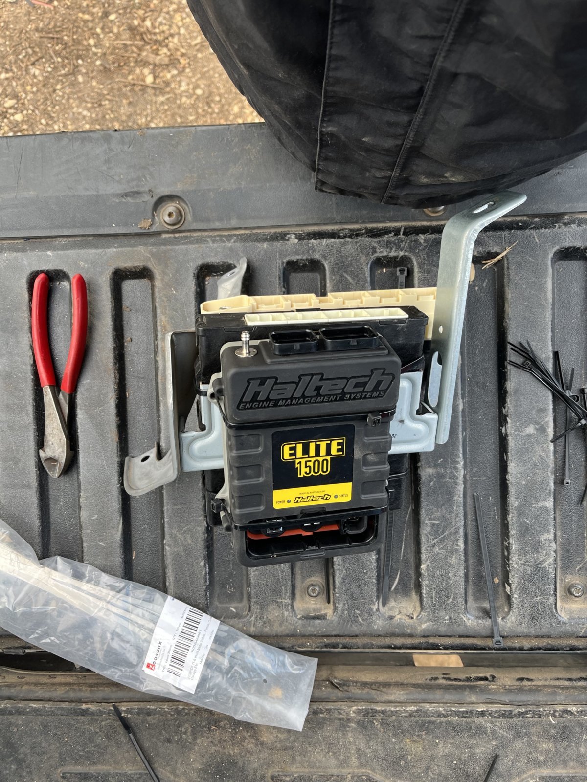

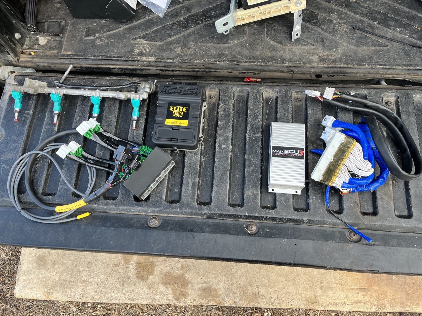

    Installed my haltech elite 1500, boomslang harness, and FiveOMotorsports 750cc injectors today. A big thanks to @05Taco4x4 and @Torspd for helping me with the tuning/setup. I still need to buy the wide band module for the haltech, but I was able to get it to start up and idle earlier, so we’re making progress!
    For the install, I pulled the entire ecu out and used sticky Velcro and zip ties to secure it to the side. The fitment turned out pretty good and had just enough room to leave the usb for the Haltech plugged in.

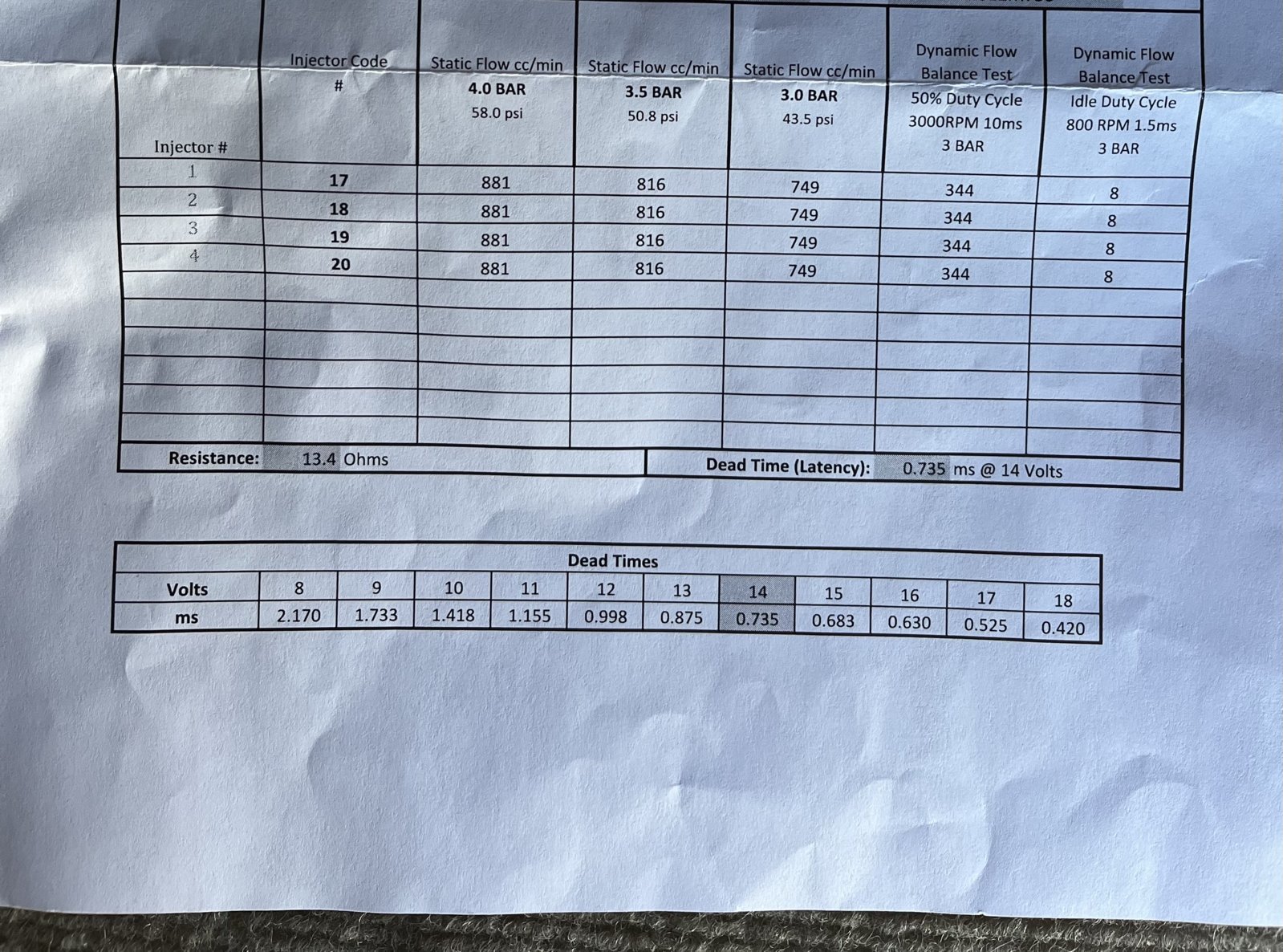

    Here are details on the injectors. These are the 750cc flow matched set from FiveOMotorsports

    Nice mate. Now you can do some great tuning.

    Should be a vast improvement once I can figure everything out. I am looking forward to building a good tune finally

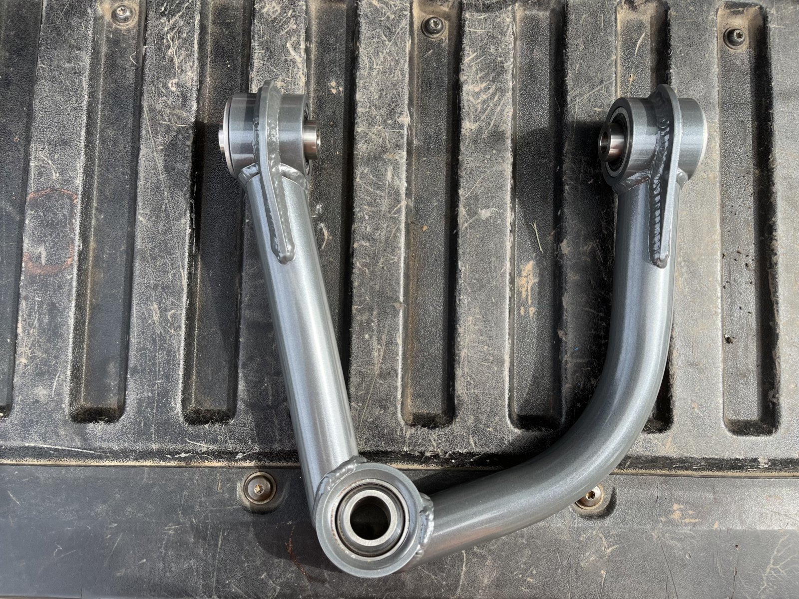

    Swapped out the emfs in my +2.25 JD uppers to 1” uniballs. I’ll be using the dirt king misalignment spacers for the Tacoma spindles, just waiting on that to come in. The lowers got the same treatment. The new coilovers have 600lb springs- it has 700s right now so I’m hoping the ride quality improves some. I also am looking to go from 3” of lift to the 1.5-2” range, but we will see where things end up

    Damn that look nice.
    It will be considerably smoother a ride.

    I’m looking forward to having some time to install everything in the coming weeks. I’ve had these parts for a while now so it will be good to see it all come together.
