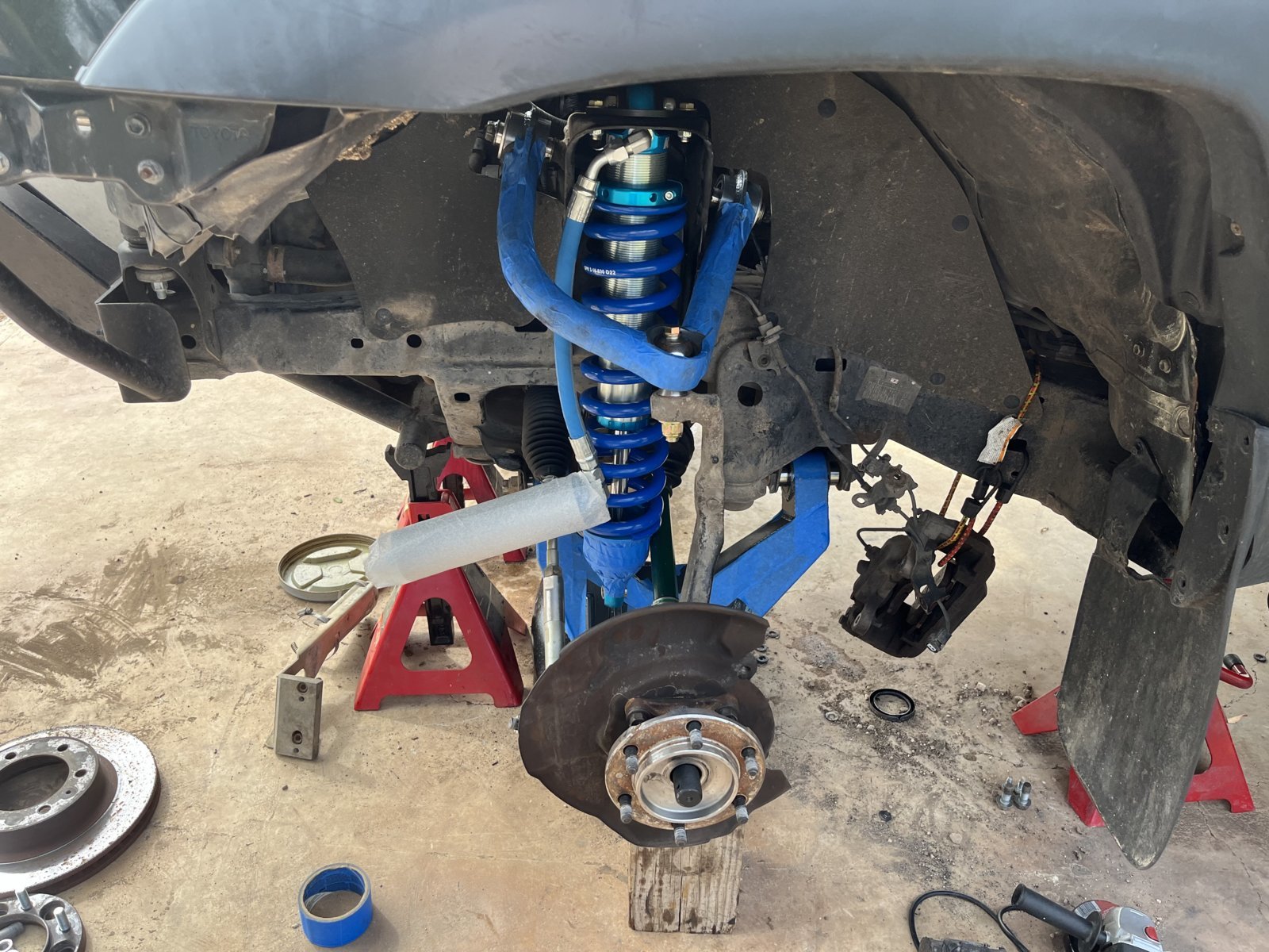

    Getting started on the front end rebuild today. Turned out to be a beautiful day, couldn’t ask for better weather. Looks like my old mid travel reservoir mounts might work as well

    That's great stuff man, I dig the use of protection

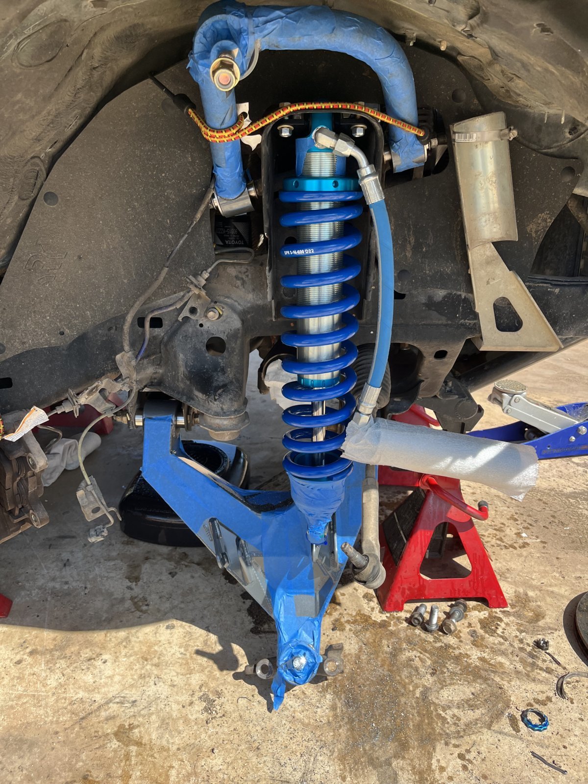

    The blue tape has served me well on past projects. Taking it all off is going to suck but should keep things looking nice :D

    Blue tape costs less than new paint/powder coat...

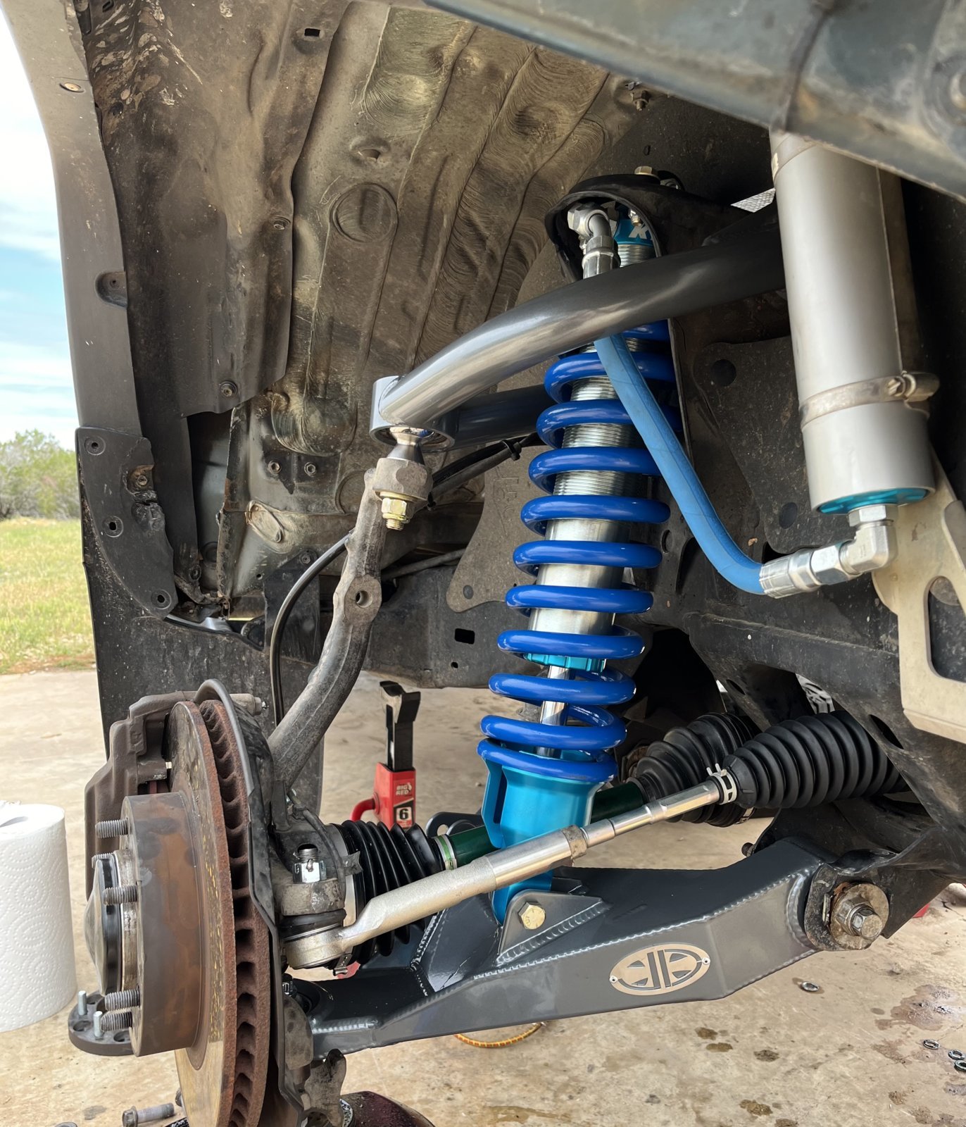

    Got moving today and wrapped up both sides except for limit straps and an alignment. Needs one pretty bad, there’s a good amount of positive camber on the driver side. Getting closer now though. I took the 3/4” bora spacers off the front so it’s 1.5” wider than it was before. Fit and finish was great overall, I am very happy with that.

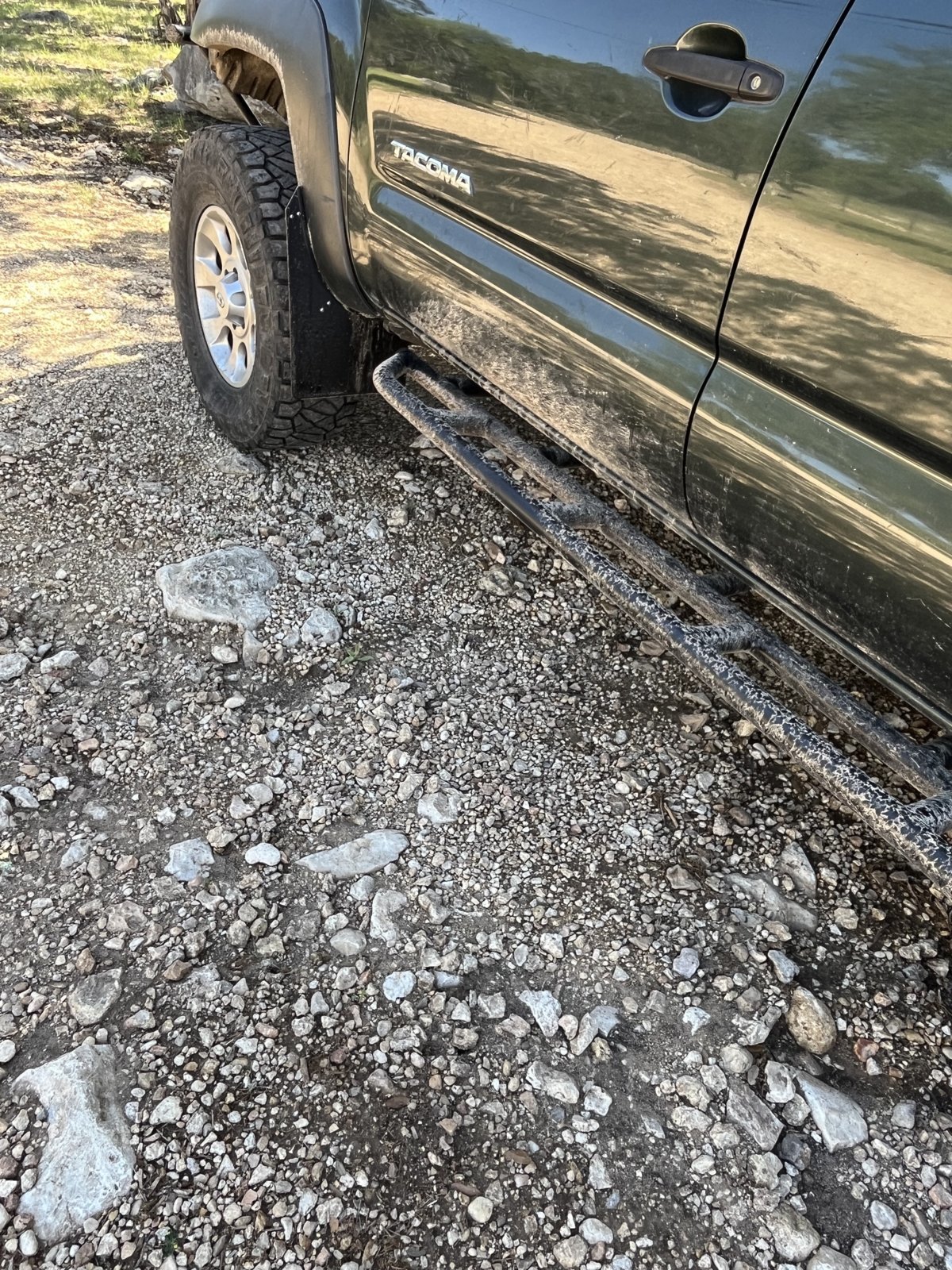

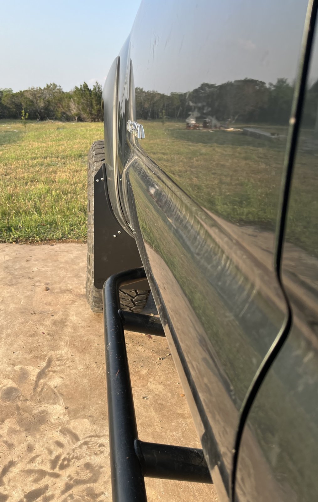

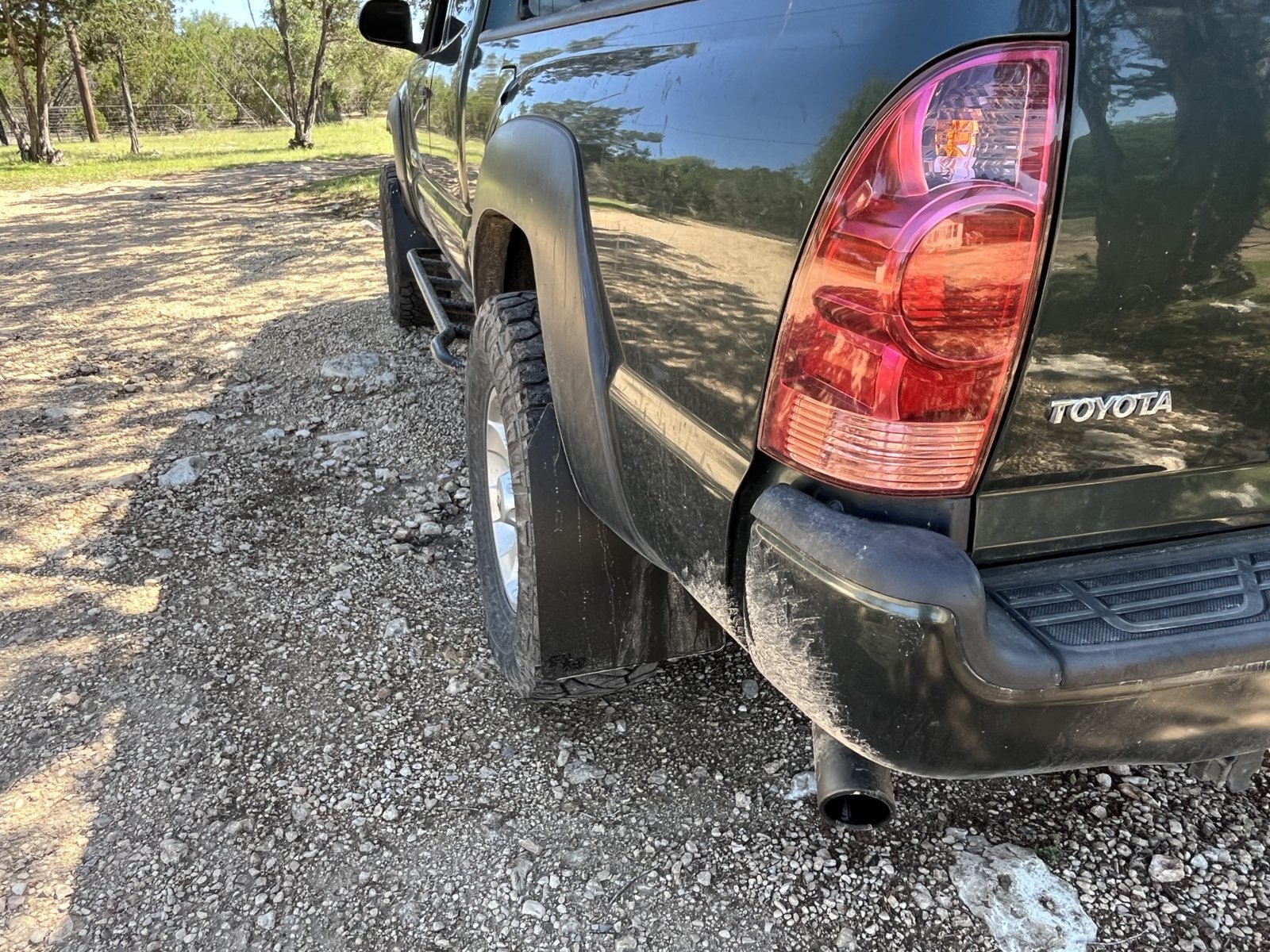

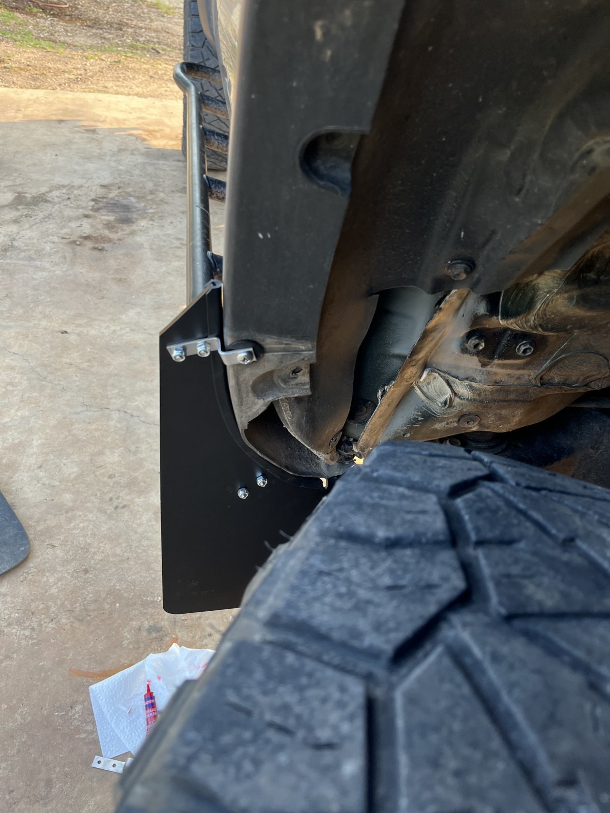

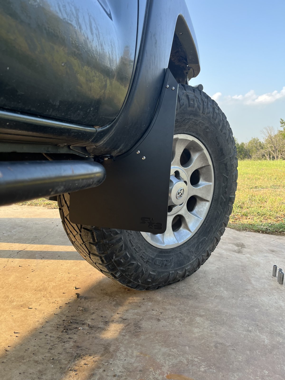

    Been doing a few little odds and ends lately. Got a temporary driveshaft safety loop on. I used a 17” limit strap mounted to the stock carrier bearing location. I plan to build one out of aluminum eventually but this will do for now. Also did an alignment since the truck has settled a little up front.
    Got a set of Rokblokz mudflaps installed for oversized tires today in an effort to keep the rocks from blasting my windows. They fit great up front even though my flares had been trimmed on the bottom. I just used two of the mounting points provided instead of three. I plan to make a bracket for the middle to take care of that though. Also ordered a PrimeWeld MIG welder and that should be here soon, so I’m pretty excited for the next few months
