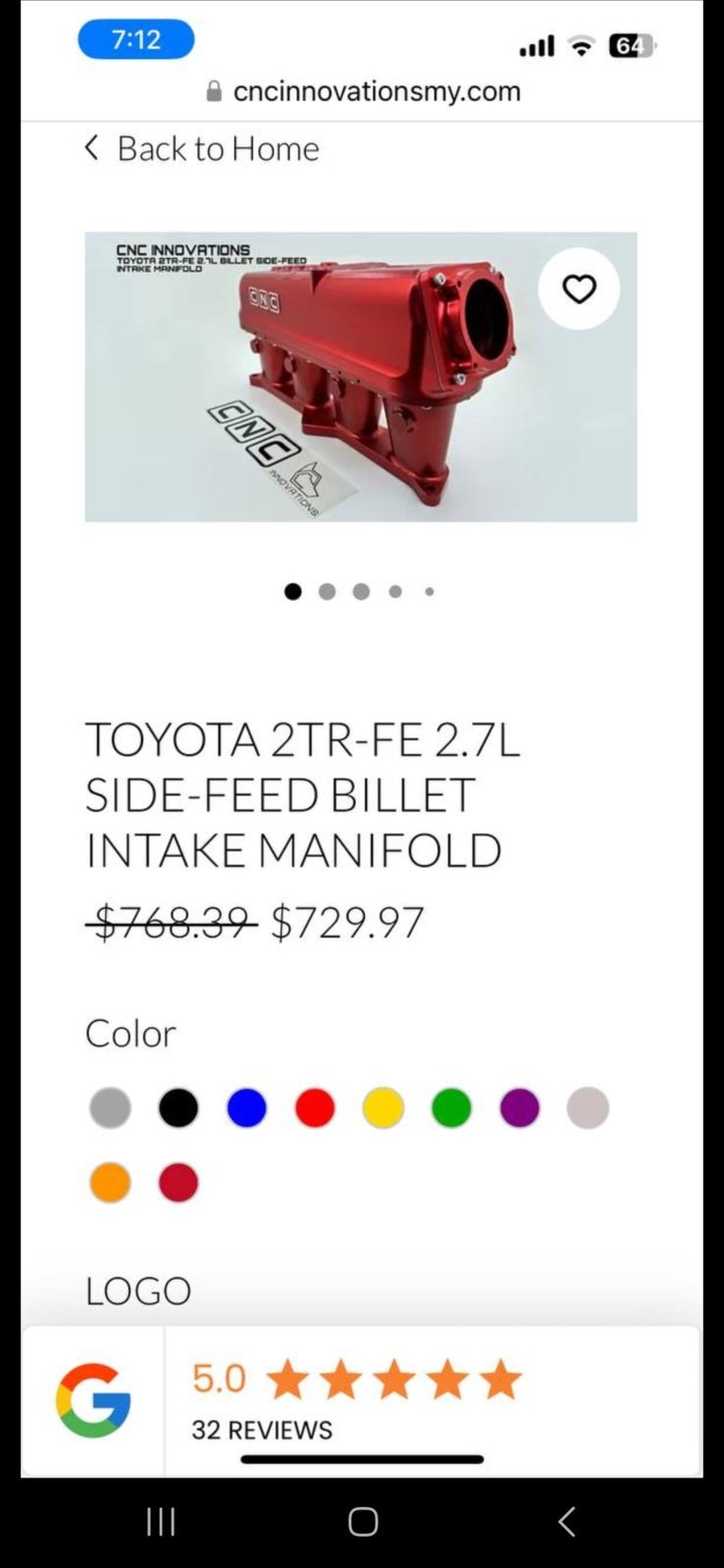

    Here is but one manifold, from Malaysia.

    Not a bad price considering you get a fuel rail too. I wonder what throttle bodies this is made to fit. That valve cover could be your crowing jewel for your built engine.

    I was wondering that as well. To me it looks like there are provisions for a larger throttle body or you can use the adapter to use the stock one.
    I love that billet valve cover other than the top cover/logo. But I did realize that it won’t work with my setup, as my downpipe occupies the spot where the AN lines come out of it.

    Haha it’s been tempting me, but not as of yet. I already have a billet fuel rail and I am wondering if there might be clearance issues with the one I have. It might be better to go with the one Mike has since it was designed around that one

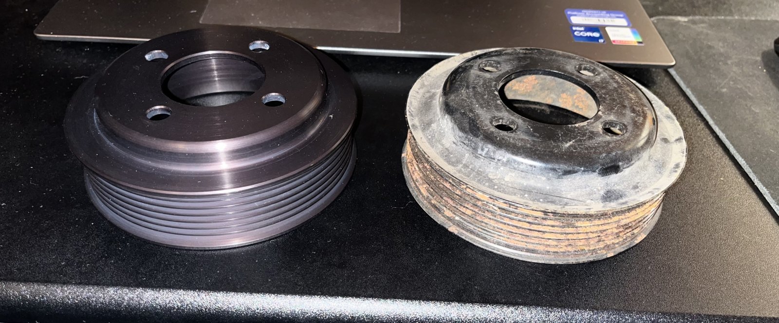

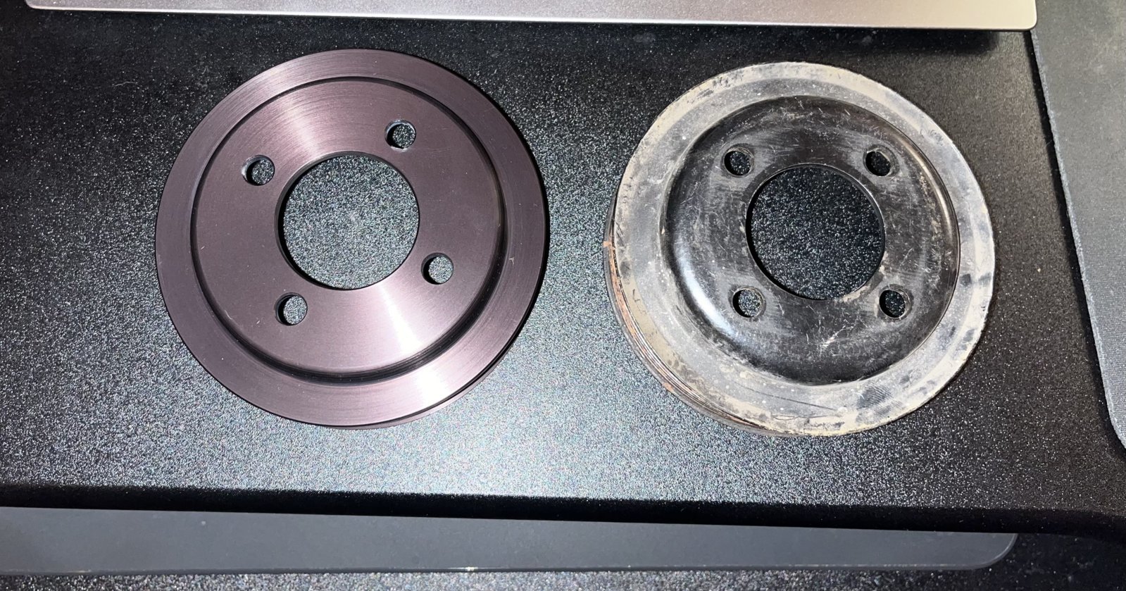

    Installed my NST aluminum water pump pulley today. I ordered this 8/17/23 and the first one they sent me was for a 1st gen 2.7 taco. I sent in my stock pulley so they should have the dimensions now if anyone else is interested. Cost me $150

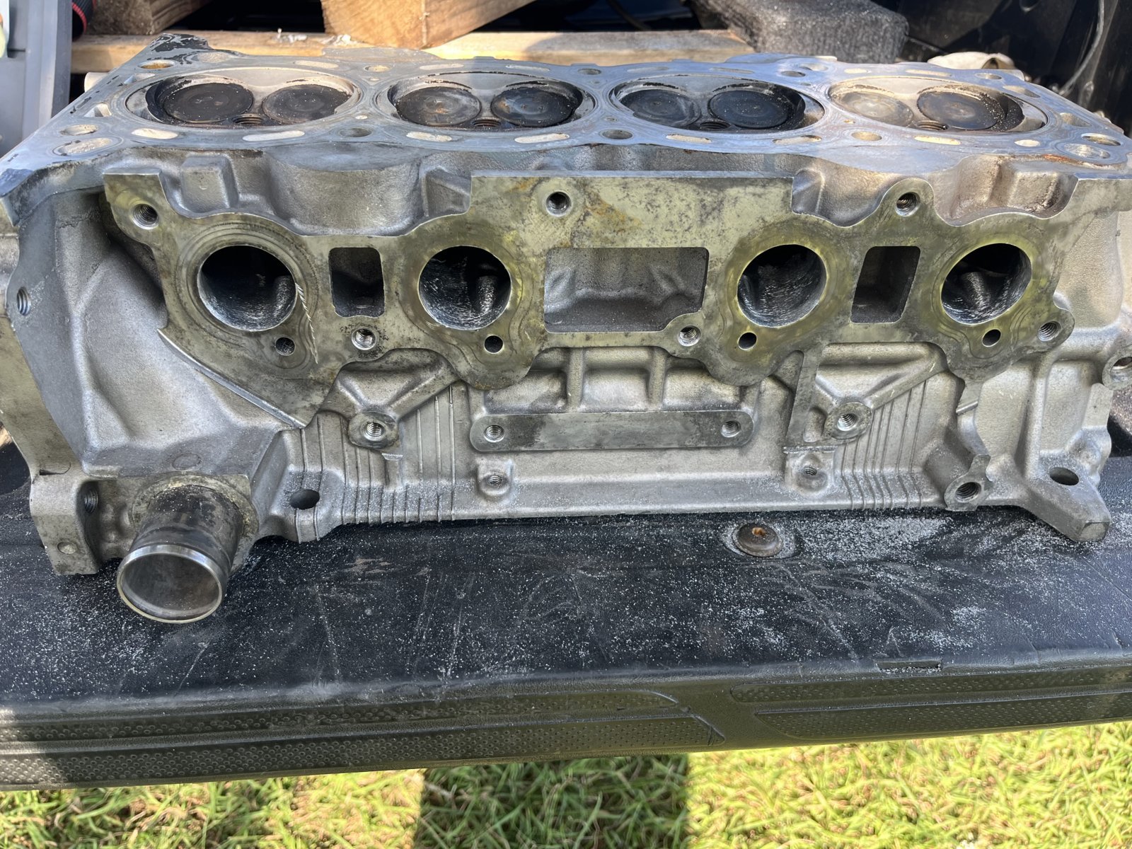

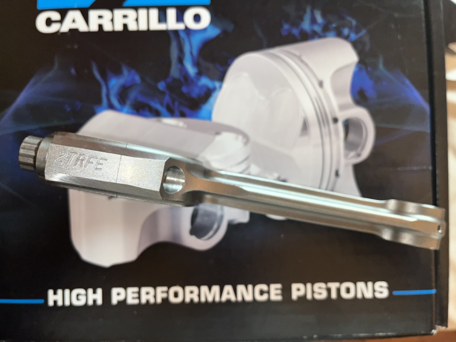

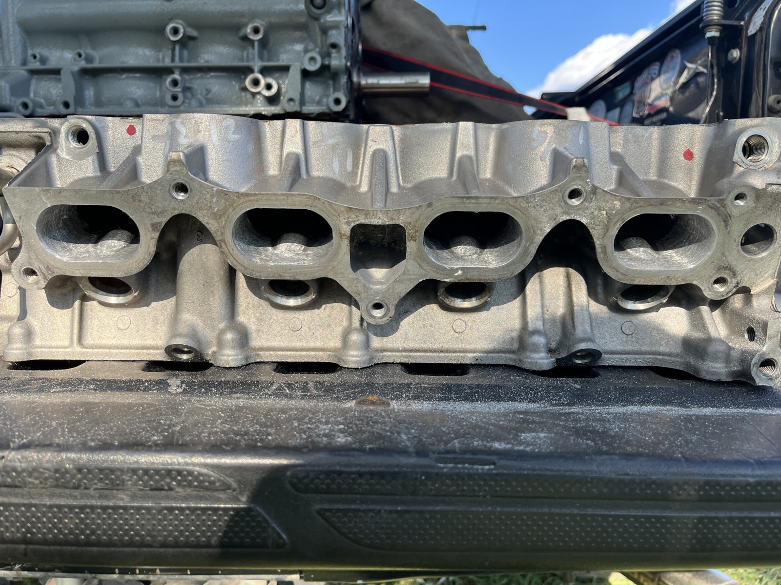

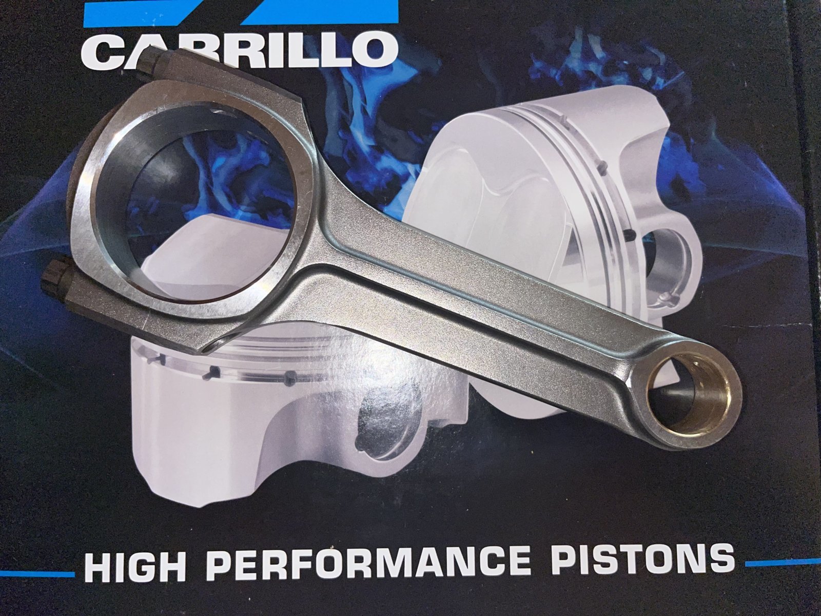

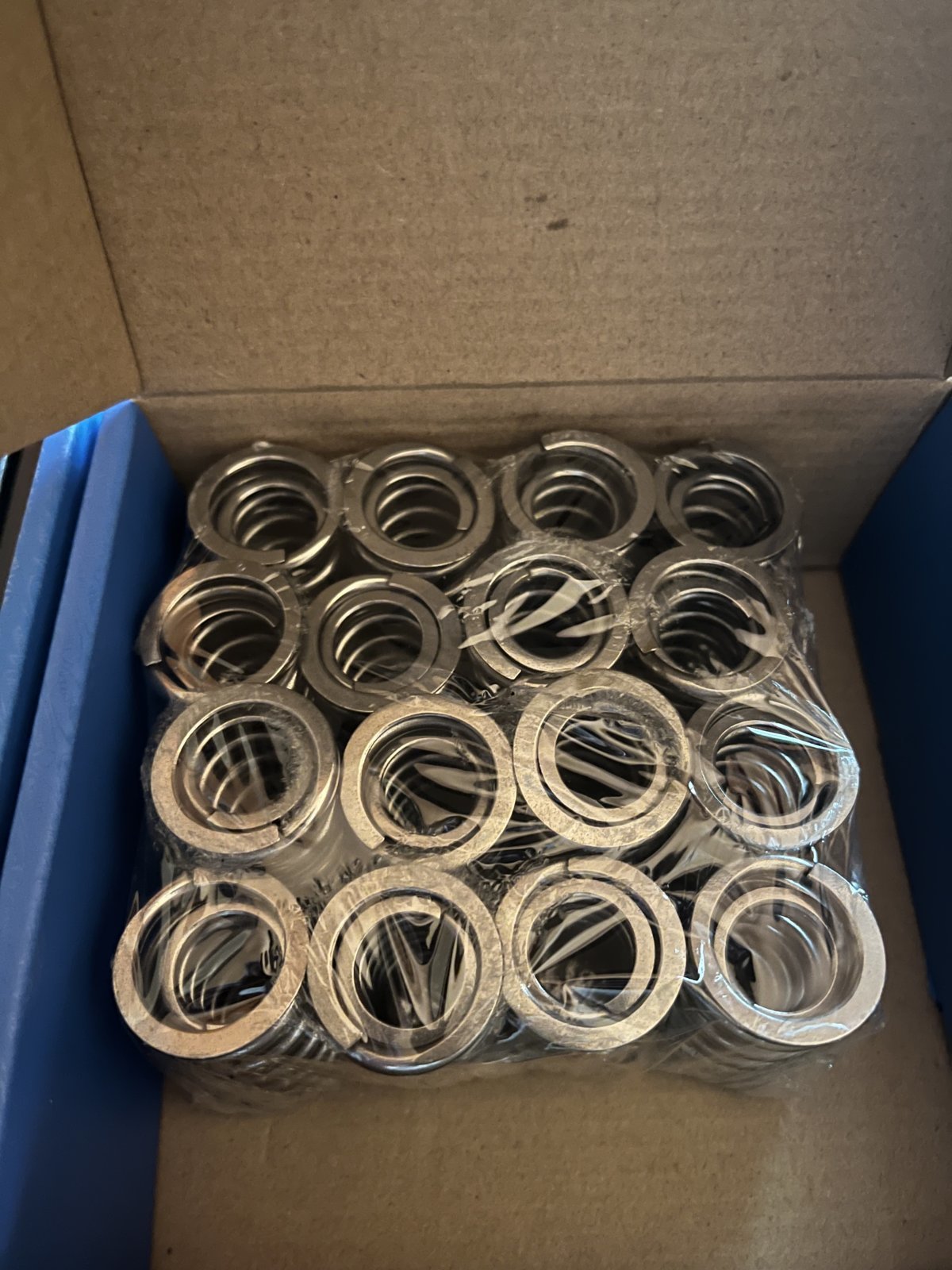

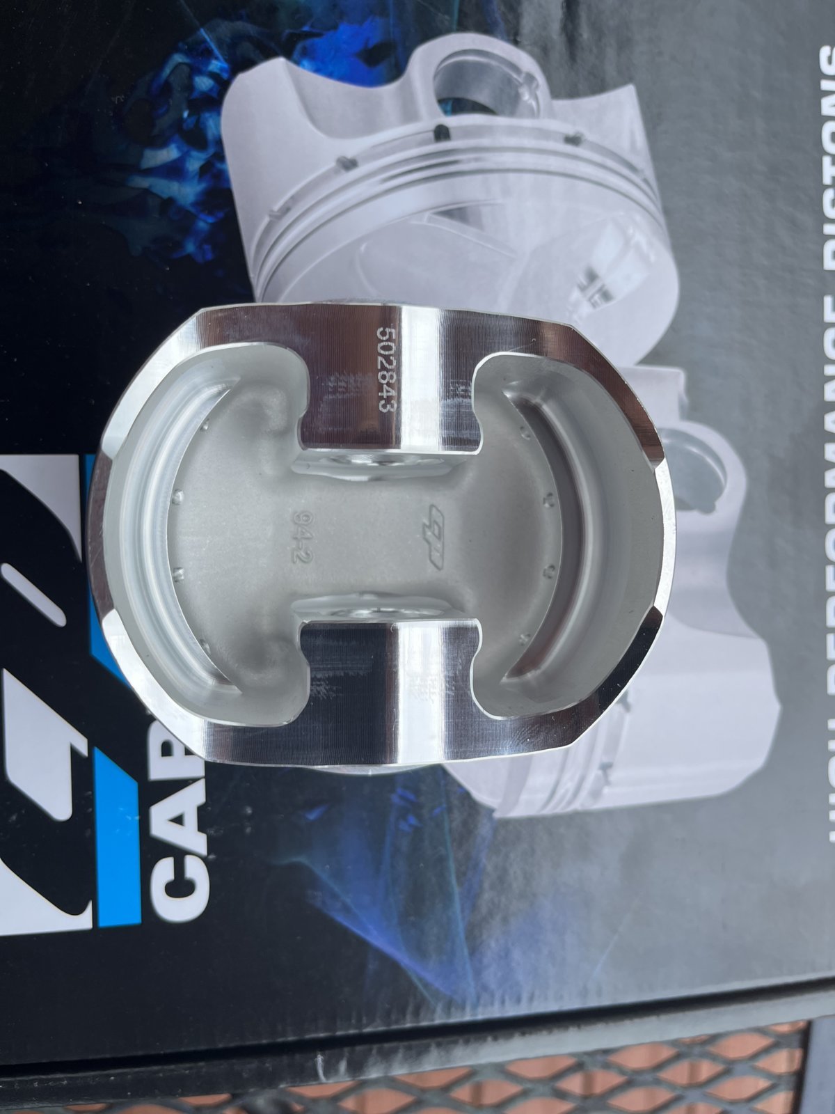

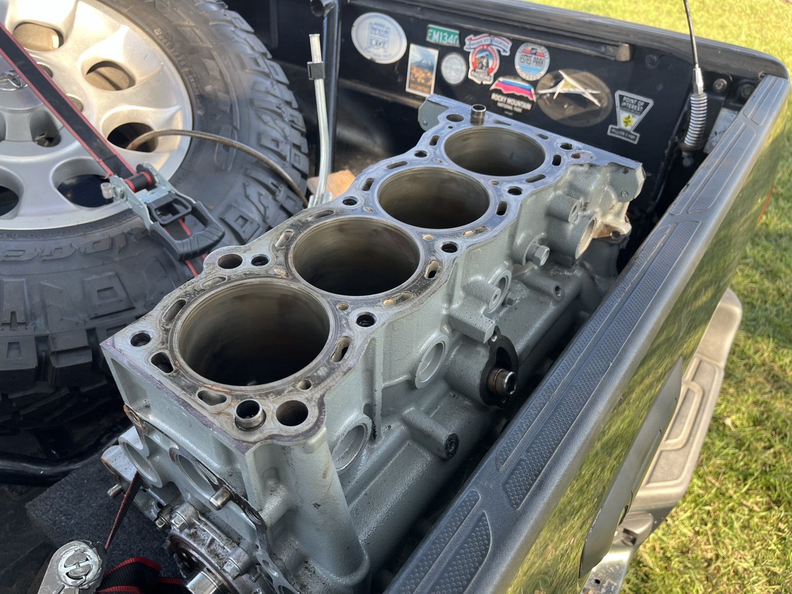

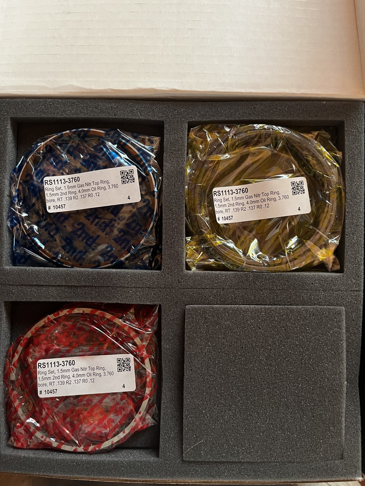

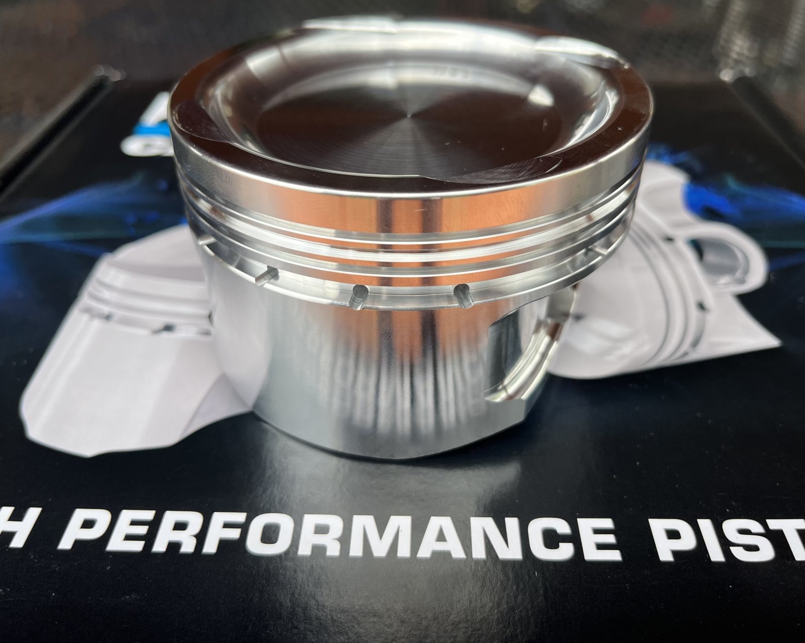

    Dropped my block and head off at the machine shop today. Went with with 9.0:1 CP Carrillo pistons, Pauter chromoly rods with ARP bolts, ARP main studs, balance shafts have been deleted so the rotating assembly will be balanced, +1MM intake and exhaust valves, Viton valve stem seals, and dual valve springs with titanium retainers. I smoothed out some of the casting on the head yesterday as well.

    Definitely looking forward to the next phase of this build. The pistons are +.020”/95.5mm so the block needed to be bored out, one of the main bearings on the crank was starting to go so the crank needed to be checked and the appropriate bearings ordered too. Also the larger valves require the head to be machined so everything was already there.
    I’ll be doing the rest of the assembly when it comes back. I chose a machine shop to do a short block and a valve job for me because of the specialty tools required to do it right
