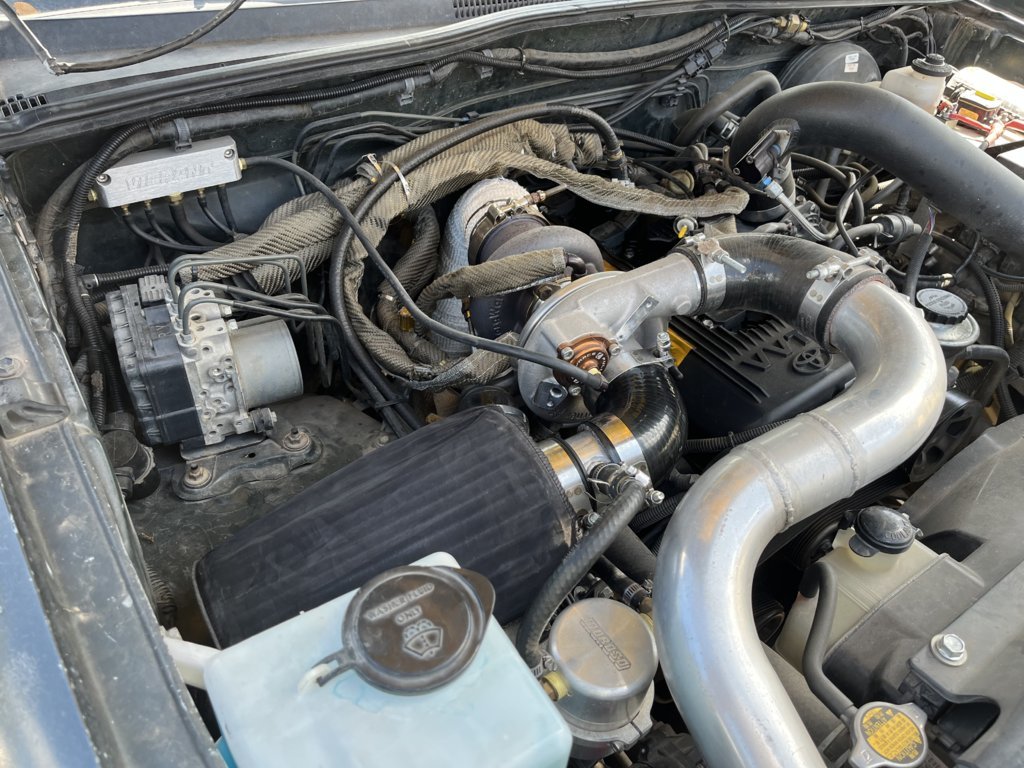

    Removed my 3rd gen tacoma air box/filter today. The stock air box worked well, but I prefer the louder turbo spool and BorgWarner BOV noises with the conical filter. Also capped off the HKS BOV as the pshhh every time letting off the throttle was getting old.

    Lol I’m glad it’s no more or I’d be thinking of that every time I shifted now. It kinda reminds me of a subaru wrx. It’s okay for that car, but im less of a fan on a truck

    Obligatory sound clip. A little partial throttle with the windows down. Sounds so much better. There isnt much exhaust noise since i have so many mufflers
