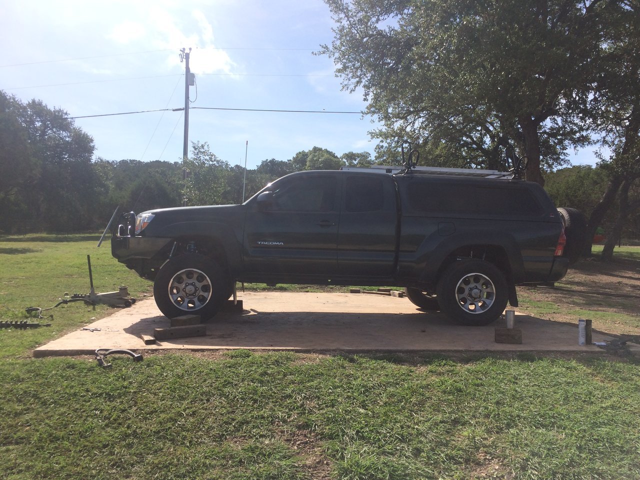

    Bro lean engaged:headbang:

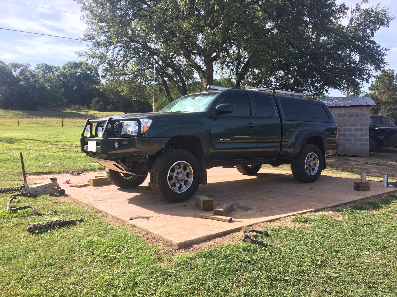

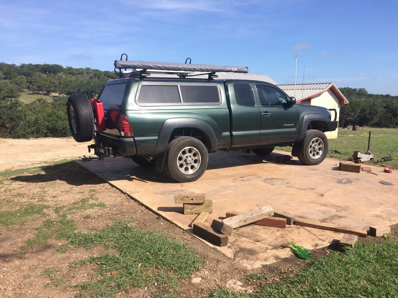

    Center of hub to fender measurements:
    Before: driver- 19.5"
    Before: passenger- 20.0"
    After: driver 23.5"
    After: passenger 24.0"
    Im expecting the front to settle a little but i ended up with about 3.5-4inches of lift with the 700lb coils on my prerunner 2.7L.
    The ride is firm on the road but not harsh by any stretch. Offroad on the washboard roads it rode great earlier today!

    Got my truck aligned this past weekend. got 3.4 degrees caster on driver's side and 3.8 on passenger side. The toe was out, which was causing the truck to wander, so the tech got it toe in just a little and then set the camber to .3-.4 IIRC. Truck drives great again and there is no more play in the steering wheel! I'll add a picture of my print out later tonight if I can remember.

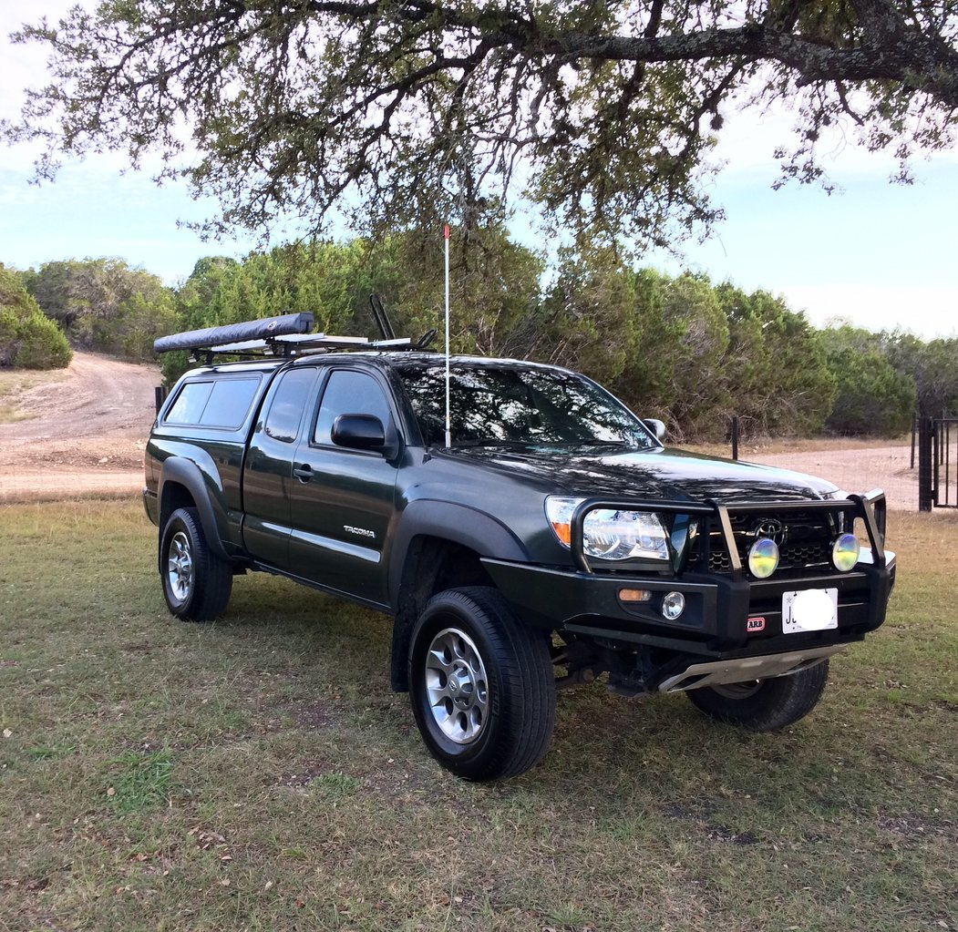

    Washed & waxed the truck, and color matched my grille emblem the other day. Also took it to coffee & cars in SA this past Saturday. Haven't done much other than that besides drive it! It sure cleans up nice for a truck w/ 220k miles on it

    Sucker looks mint!

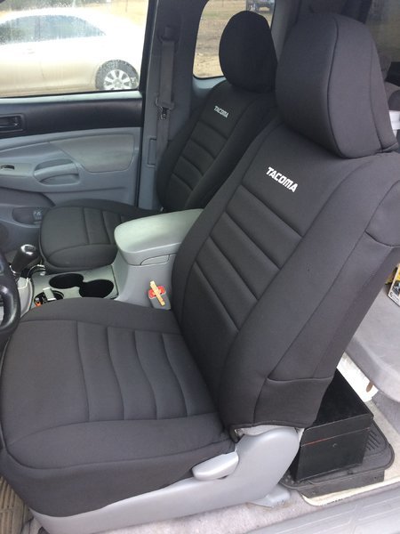

    Nice Rigs!
    What are those seat covers inside Turtle?

    Thanks man! Theyre wet okole seat covers. I actually just recently added a set that are nearly identical to my red truck as well (just a red imprint)!:D I would highly recommend them, pricey but absolutely worth it!
