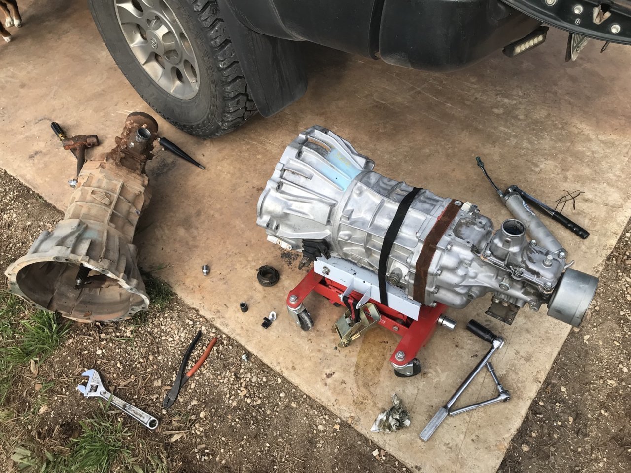

    2wd trans swaps are way easier though.. actually not dreading it this time around. I think last time i dropped it to replace the pilot bearing i had it all back together in maybe 3-4 hrs. This time will be even quicker since all i have to do is swap the clutch fork & tob over.. hoping this solves the vibrations:fingerscrossed:
    Tail shaft/output shaft on my trans is leaking anyways so its time for some maintenance
  17. May 17, 2019 at 7:24 PM
    #797
    BassAckwards
    BassAckwards [OP] Well-Known Member
    May 3, 2016
    #186002
    27,954
    2009 Tacoma AWD Turbo 2TR-FE
    Full-time AWD & BorgWarner EFR 6258

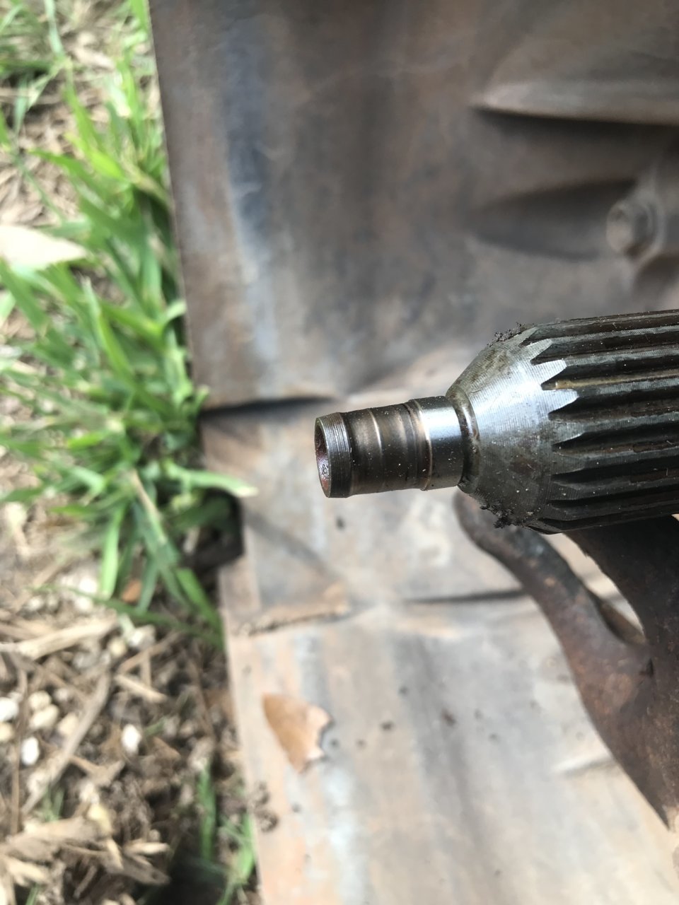

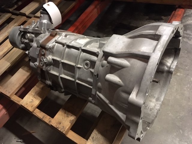

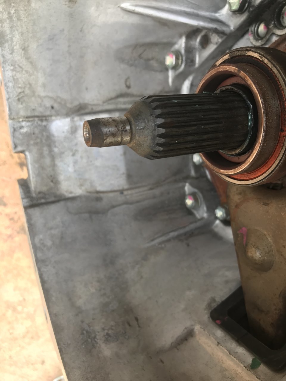

    Replacement trans went in tonight. Took me 2 hrs and 45 minutes from start to finish. The input shaft on my old trans looked pretty worn compared to the new one. Good news is that the vibrations i was getting while accelerating appear to be gone. Bad news is the vibes during deceleration are still there. Drivability is improved though so id say it was a success. Also pulled the trigger on an aFe intake today. Its one that is discontinued, they claim 10hp and 12ft lbs of gains, hoping it improves throttle response a little
    Old trans input shaft
    New trans input shaft
